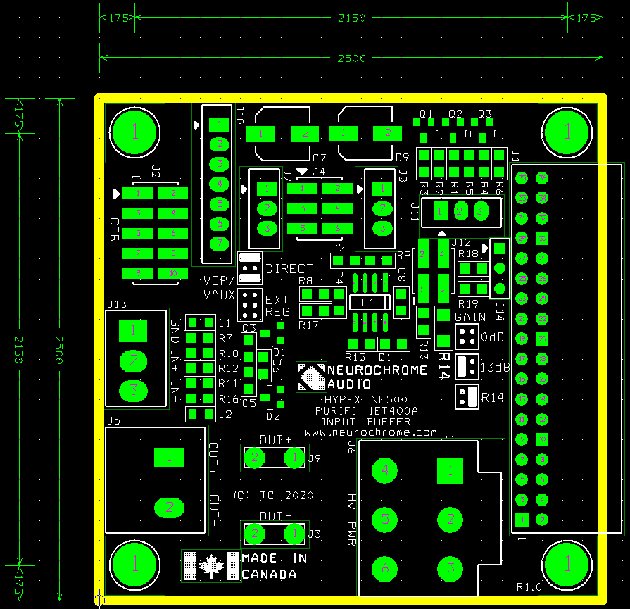

I did my best to design a buffer that would be useful on its own and allow for tweaking (and not eat too much into Universal Buffer sales).
The Purifi/Hypex buffer will work with both the Purifi 1ET400A and the Hypex NC500. It is intended for use with the Hypex SMPS1200 (and future Purifi) power supply, thus will have the appropriate control connectors in addition to the 6-pin high-voltage connector.
The Buffer allows you to experiment with external voltage regulators should you so desire. The opamp power supply can also be passed directly from the SMPS1200 (or other supply) to the opamps. This is configured by jumpers.
The Buffer allows for the following gain settings (jumper selectable): 0 dB, 13.2 dB, and custom. With the 12.8 dB of the Purifi 1ET400A, you'll get 12.8 dB, 26.0 dB, and custom, respectively. "Custom" means you can set the gain by a resistor (same as for the Universal Buffer). The Buffer is based on the LM4562/LME49720 and features appropriate RFI/EMI filtering and ESD protection.
Also, should you prefer to use the Buffer board as a break-out board, you can disconnect the Buffer output from the NC500/1ET400A altogether by removing two 0 Ω resistors. I've provided a 3-pin connector footprint for you to solder wire to should you wish to go that route.
The Buffer has output for two LEDs: READY (supported both by the 1ET400A and NC500) and CLIP (supported only by NC500 as the 1ET400A does not bring out that signal). You can use any LED you'd like. The LED is powered by +12 V through a 3.3 kΩ resistor, so it'll work with a wide range of LEDs.
The speaker output is provided on rising cage screw terminals (same as on Modulus-86) and on 1/4" Faston/Quick-Connect spades. I've routed the remote sensing traces such that you get the full benefit of the remote sensing regardless of which of the two connector types you use.
The input is connected to a 3-terminal rising cage terminal block (same as used on my Modulus-86). The input impedance is 48 kΩ, differential. If you prefer a single ended input, connect Pin 1 to Pin 3. Connect Pin 2 to RCA centre, and Pin 3 to RCA shell (which should be isolated from the chassis).
The Buffer measures 2.50 x 2.50 inches (63.5 x 63.5 mm).
I don't have the price figured out fully just yet. I'm hoping to be able to offer it for around $100. Maybe $125 @ QTY 1; $100 @ QTY 4 or something. No promises.
The Buffer will only be available as a fully assembled module. The reason for this is simple: I can offer everybody better performance and lower prices by focusing on the fully assembled modules.
I expect to open for preorders in about three weeks.
Tom

Tom, does this have any on-board regulator for the buffer op amps? I think I get that it supports supplying op amp power from the SMPS1200A400, or an independent supply, but that there is no further local regulation.
There is no local regulation. You can add that pretty easily, though. In fact, I'll offer an ultra-simple regulator board that will plug straight into one of the jumper blocks on the board. That board will be DIY and will support the Hypex HPR and HNR, as well as the LM7812/LM7912 and LM78L12/LM79L12.
The SMPS1200 by default comes configured to deliver ±12 V for the opamp. You can use that if you don't want to mess with regulators on the buffer board.
