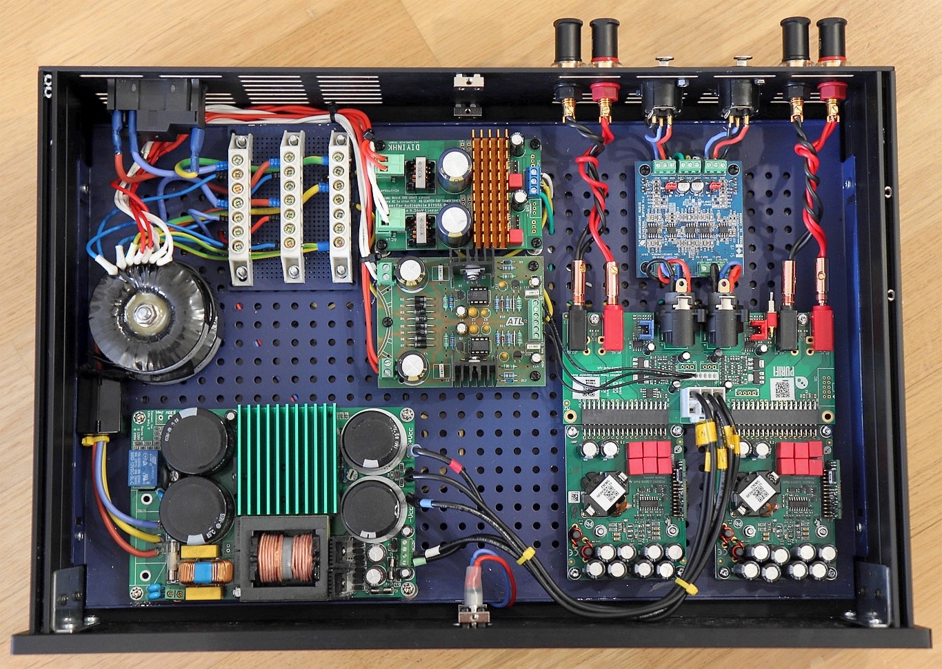

This morning I finally got the MODU case.
And ... finally the amplifier is mostly complete – some cleanup to be done.
I use a light blue plexiglass cover, internal perforated iron baseplate spray painted matte cobalt blue, added some "mounting cubes". There are venting slits on the bottom plate, and as you can see I have venting slits also on the rear plate.

Look beautiful. Proud accomplishment!
Do you have a class ab that you directly compared to ?
Yes and no. I have a Naim NAP250 clone, still, at home, but I just sold my Abrahamsen V30UP+V40UP combo. I also have a TEAC integrated, not something to scream about. What I can say, even though you must take it with a pinch of salt, is that there is much less colour and more detail than any other amp I have auditioned at home, except perhaps for a loaned Lavardin IS, and the Apollon NC500 monoblocks (also just sold) which, while fabulous, did not have the sweet treble of the Purifi.
Too bad I am no longer in the position of making a direct comparison, but one condition from my best half was to put the other "big" amps on sale to support the build of this one, and I did not expect them to sell so quickly...
Roberto
Does anyone have the NC500 Evaluation board sch. ? It looks fairly simply and would allow for monoblock arrangement. We are still waiting for Tom's adapterboard so perhaps that one is even better.
And congratulations mocenigo 🙂

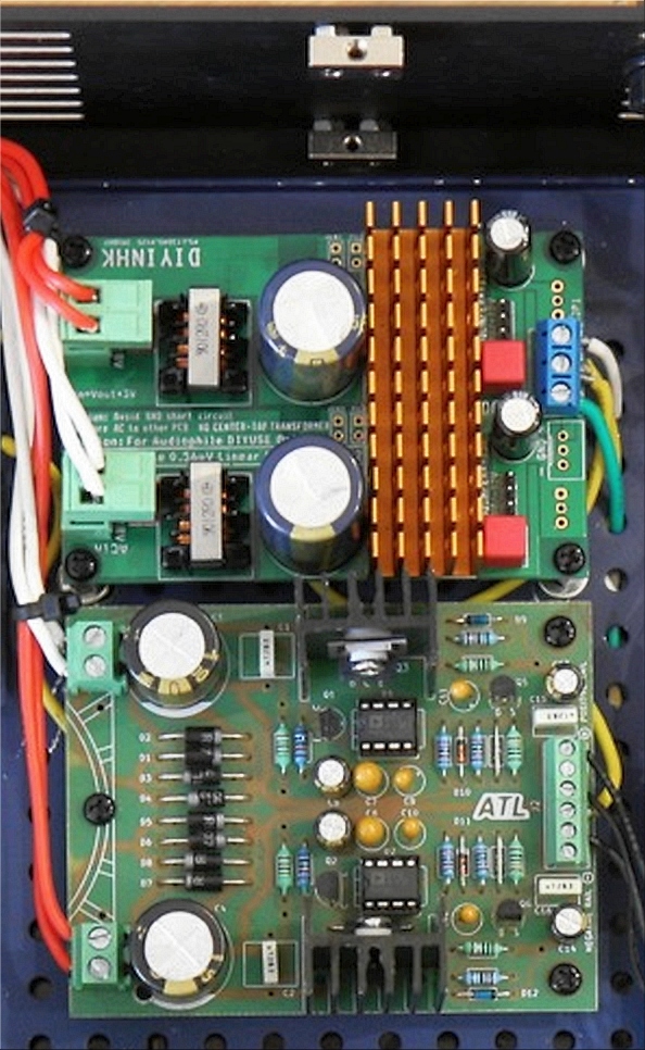

Thank you very much. I put some effort into making a beautiful case for these modules, because they deserve it. I also attempted to put the audio circuitry as far as possible from the IEM generating parts of the power supplies: AC on the far left becomes DC to the centre, and then audio boards on the right. There is no audible interference, whereas, for instance, my old Abrahamsen had a higher hum on one channel because that channel was closer to the huge toroidal.
My wife, that works in finances for a laser manufacturer, while she was complaining at all my partial expenses, did not complain one bit about the cost of the case (around 290 EUR with all customisations and additional parts): "I know how much cases for professional stuff cost, and they are nowhere as beautiful as that one." Well, if my wife did not complain, what did I do wrong?!?
