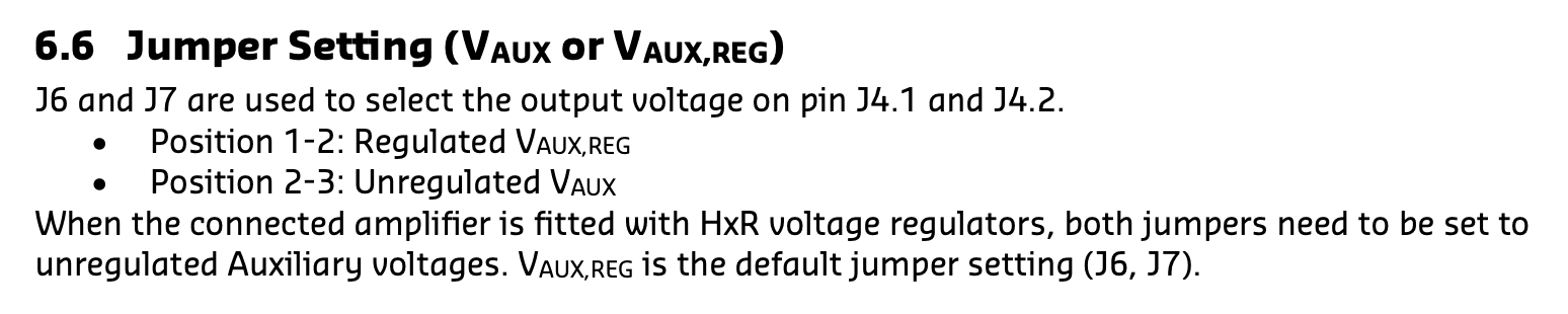

The SMPS1200 by default comes configured to deliver ±12 V for the opamp. You can use that if you don't want to mess with regulators on the buffer board.
Tom
Hi Tom,
Are you sure ?
According to the datasheet, auxiliary voltages outputs are around +/- 20-22V and not +/-12V. And at least it is what I can measure on my samples...
Jean Claude

Your values are for UNregulated output. One can get +Vaux from the Hypex SMPS1200A400 either regulated (default), or UNregulated, set by a jumper configuration. That is what Tom was describing. With the EVAL1 set, since there IS a local regulator, you want to use the UNregulated output from the SMPS1200. For Tom's board, as-is, you use either your own external supply, OR the regulated output of the SMPS1200. Alternatively, he says he will offer a means of adding a local regulator. In that case, one could (I presume, pending specs) use the UNregulated output of the SMPS1200. From the datasheet:
J6 and J7 are used to select the output voltage on pin J4.1 and J4.2.
• Position 1-2: Regulated VAUX,REG
• Position 2-3: Unregulated VAUX
When the connected amplifier is fitted with HxR voltage regulators, both jumpers need to be set to
unregulated Auxiliary voltages. VAUX,REG is the default jumper setting (J6, J7).

Y. From the datasheet:
You are right, in fact I built several years ago a pair of SMPS1200 with NC1200 power amplifiers and I wrote my false comment from memory.
Sorry
Jean Claude

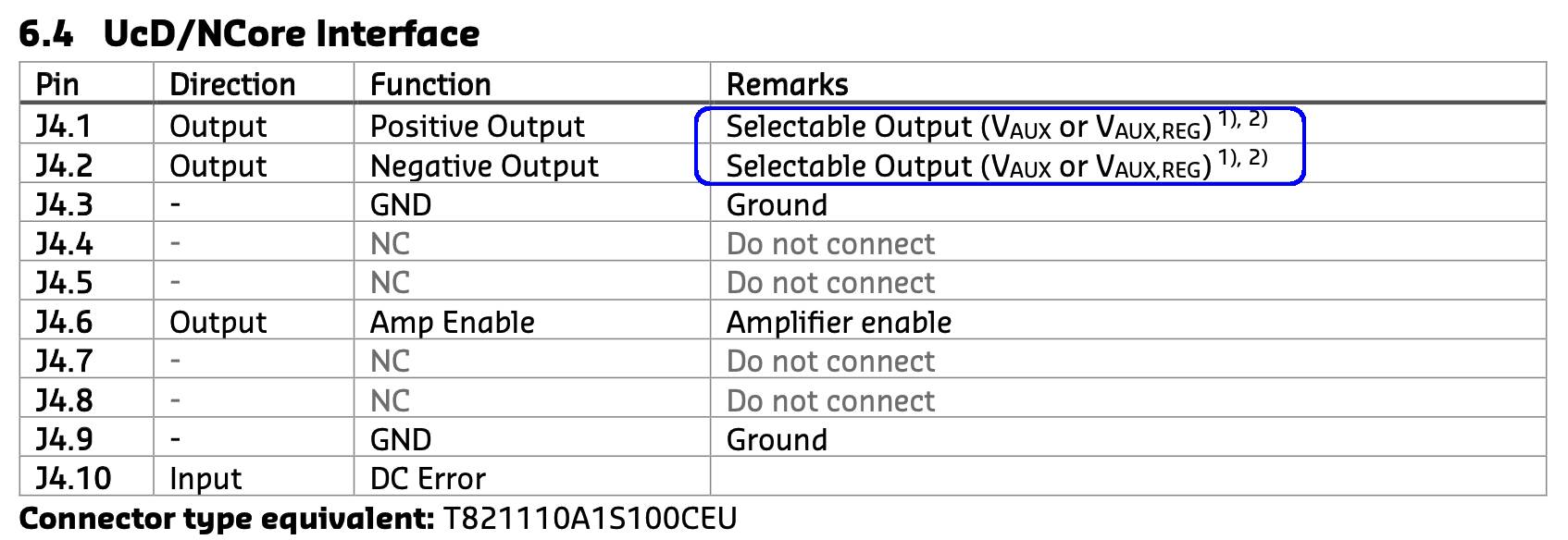

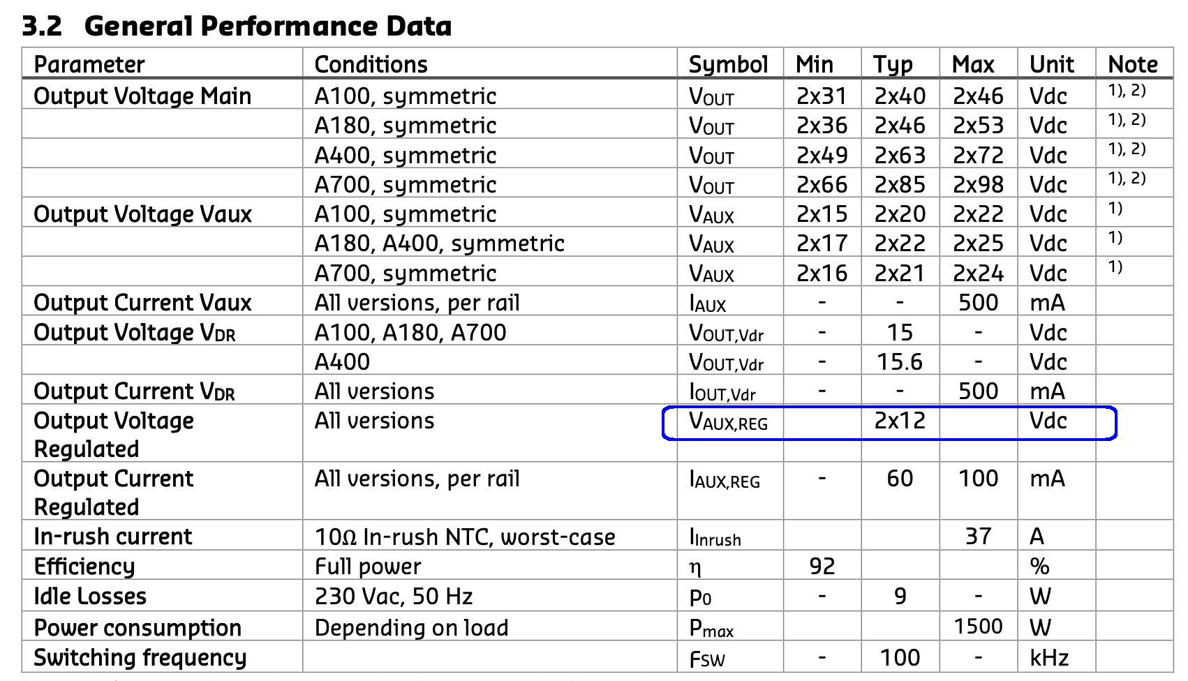

Are you sure ?
Yes.
Really? Attached figures are screen shots from the SMPS1200 data sheet. I'm curious how you arrived at the conclusion that a regulated supply is not available. In particular as the SMPS1200 ships with the regulated supply enabled. This default setting is also specified in the data sheet (and the one I received was set from the factory to provide the regulated supply).
To me, the data sheet is pretty clear. You can select between the unregulated (±15 V to ±24 V, depending on condition) and the regulated (±12 V) supply using a pair of jumpers (J6, J7). That has also been my experience with the SMPS1200.
