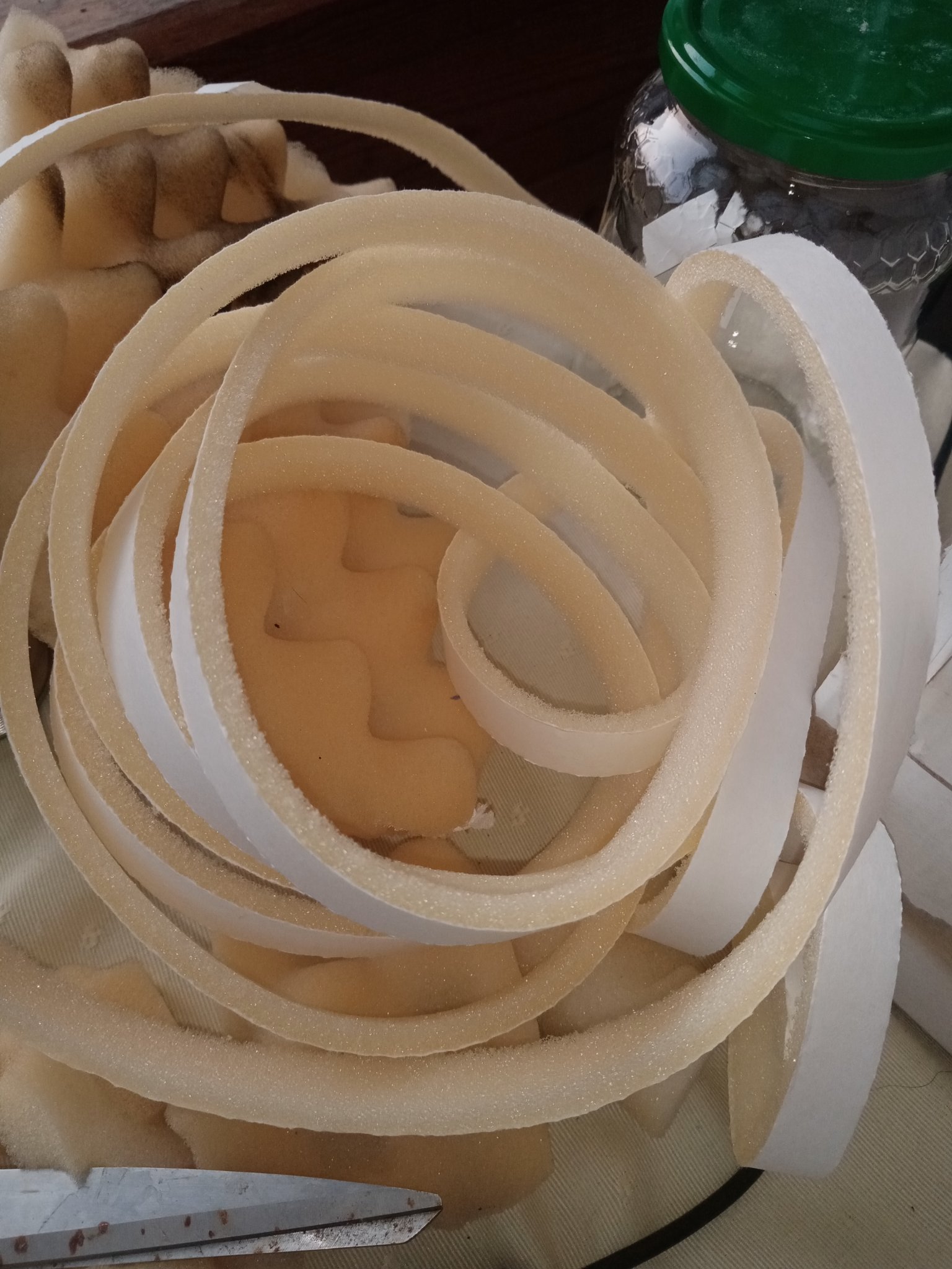

3M VHB double sided tape is viscoeleastic material. Easily sourced and cheap.Also, Turbowatch2 makes the correct claim that any sandwich material needs to be viscous. Sorbothane is an obvious material but quite expensive. But finding information on the viscoelastic measures for neoprene, butyl rubber, etc, is difficult. I thought I had found at one time that neoprene was not viscous and butyl was, but I have not been able to confirm that.

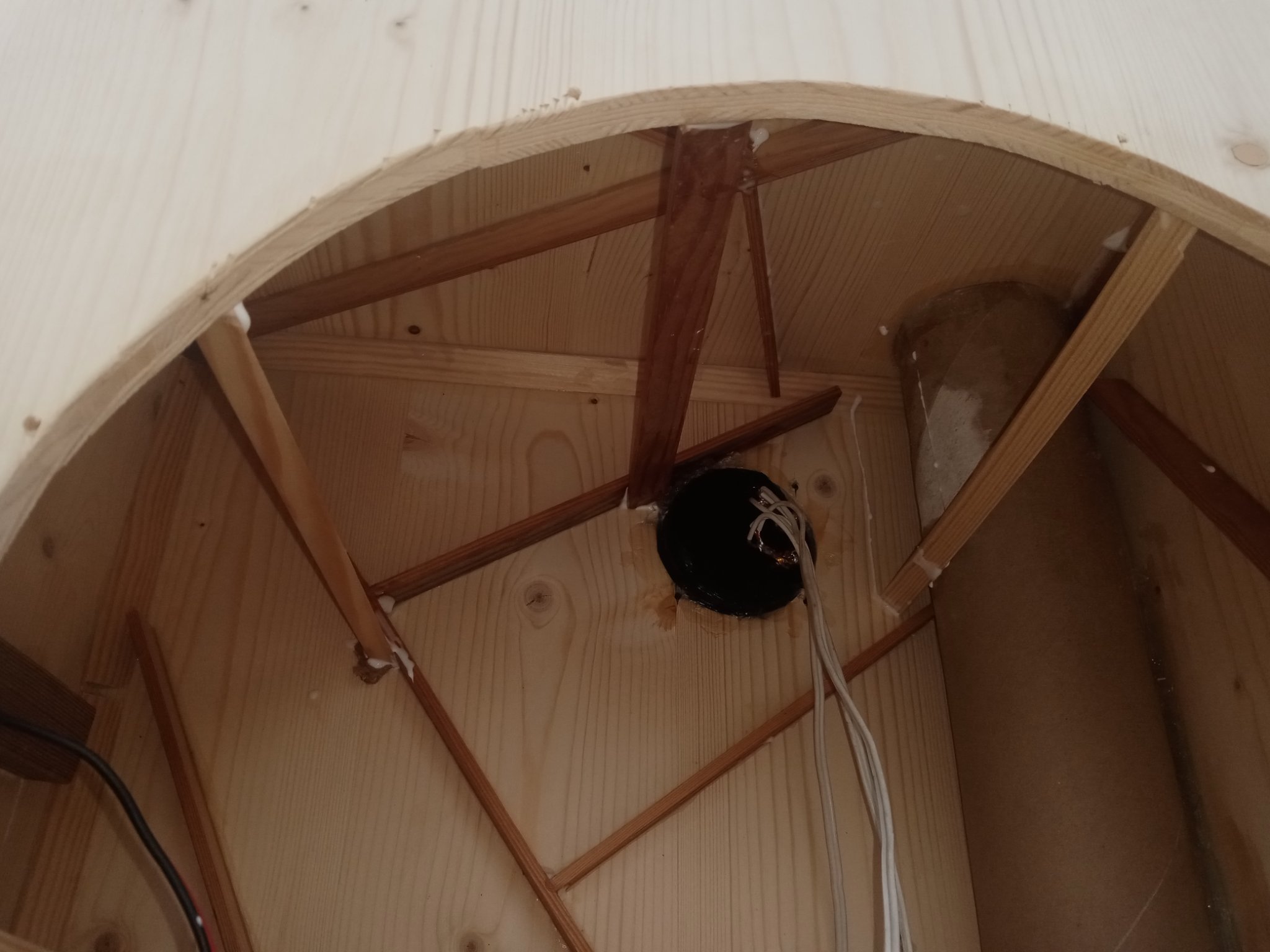

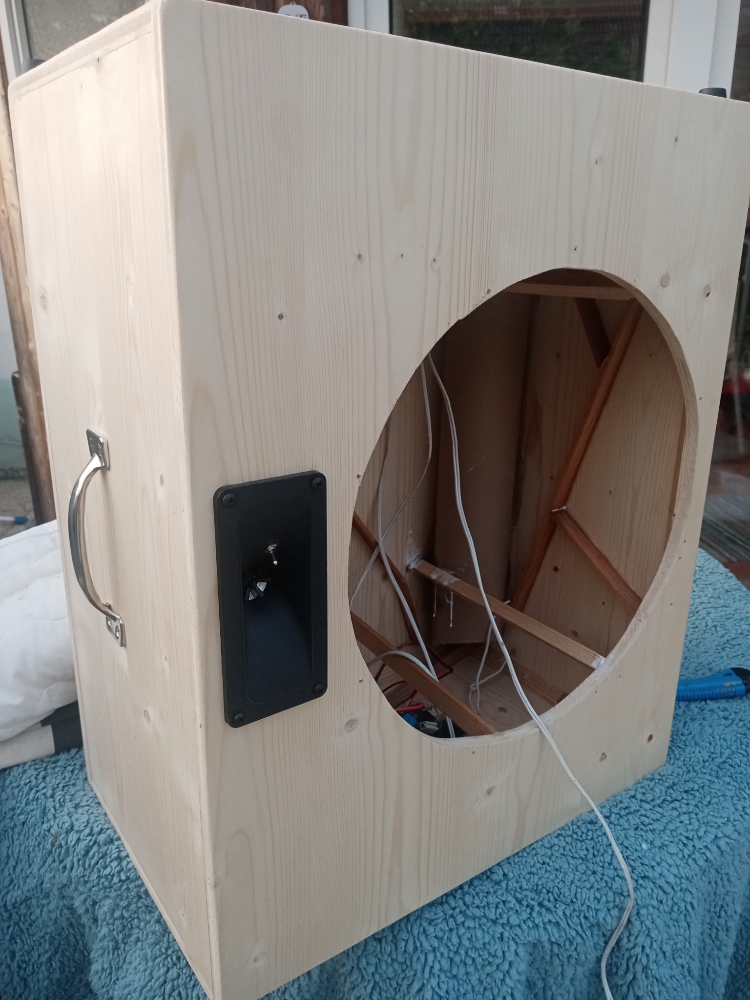

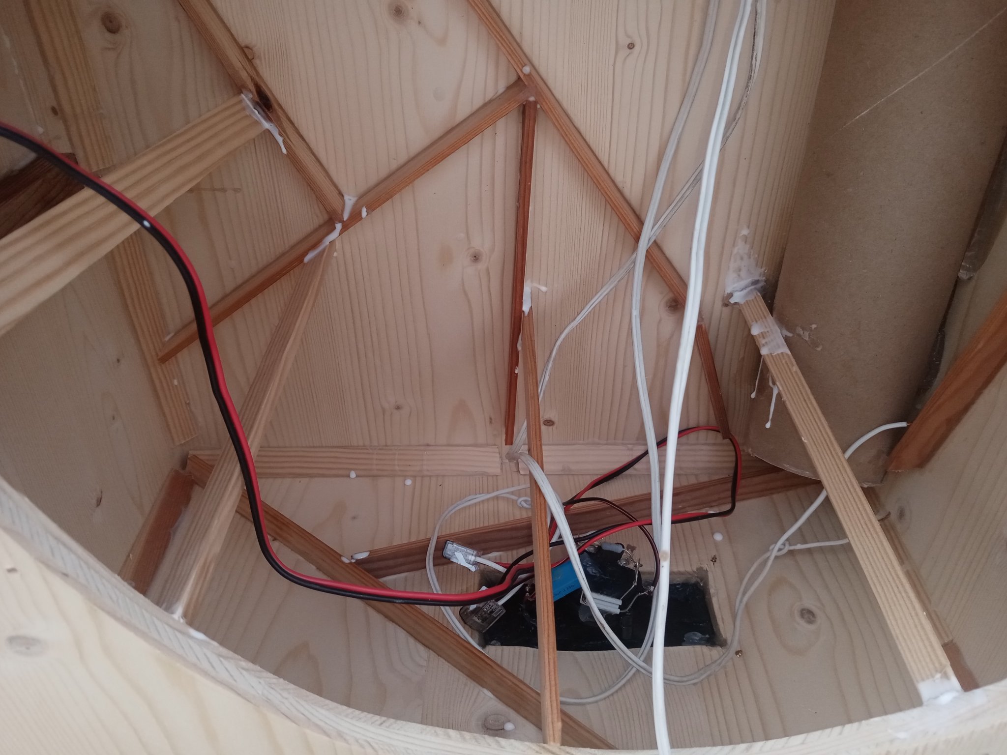

The bolt with rubber washer is a good idea and makes sense to me. I don't think I'll need the rubber as the bolt will be secured to the brace but the brace will be elastic itself. I'm going to see if I can find an adhesive that will bond TPU and wood as I think that is the simplest, most elegant, solution.

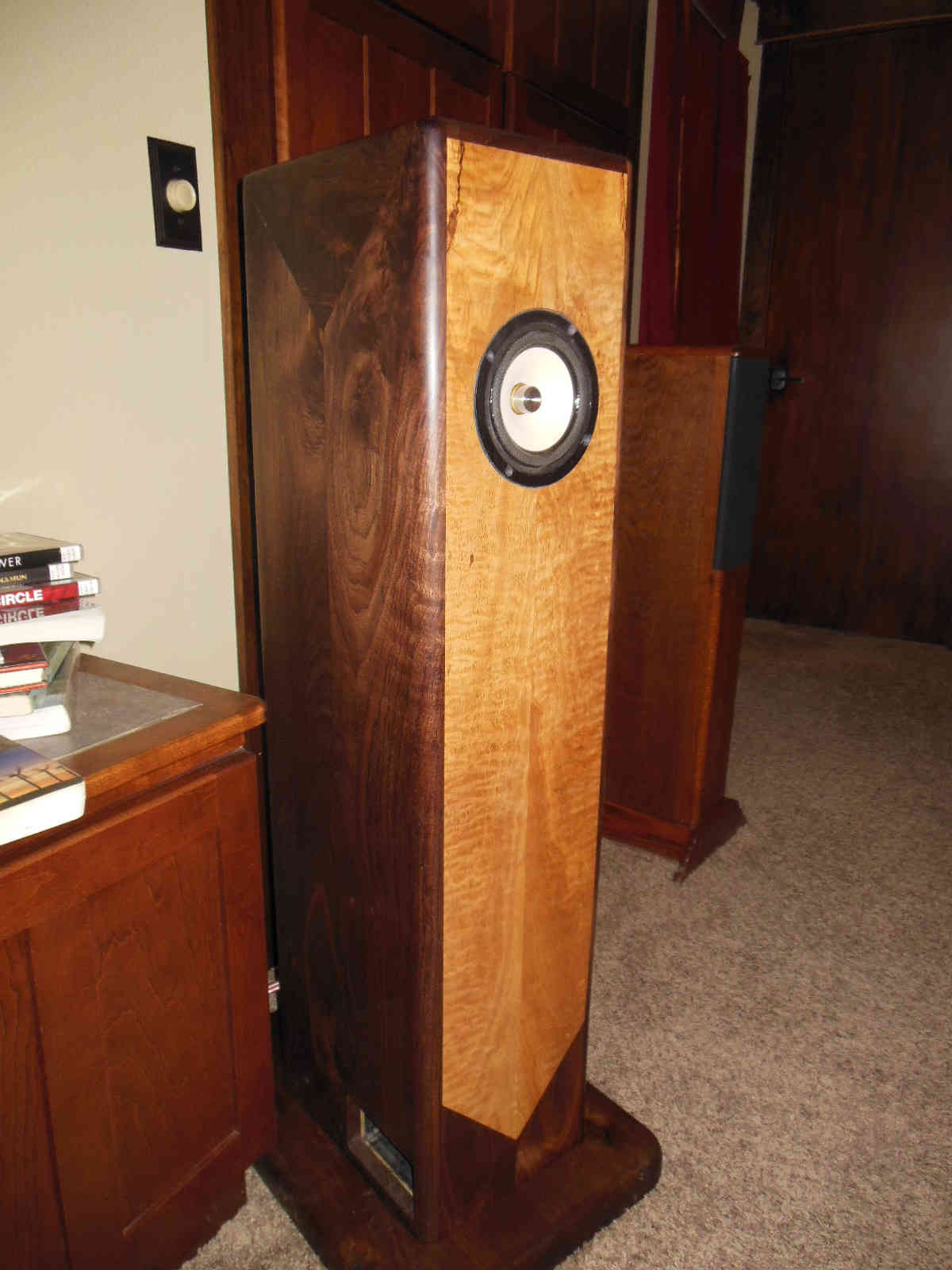

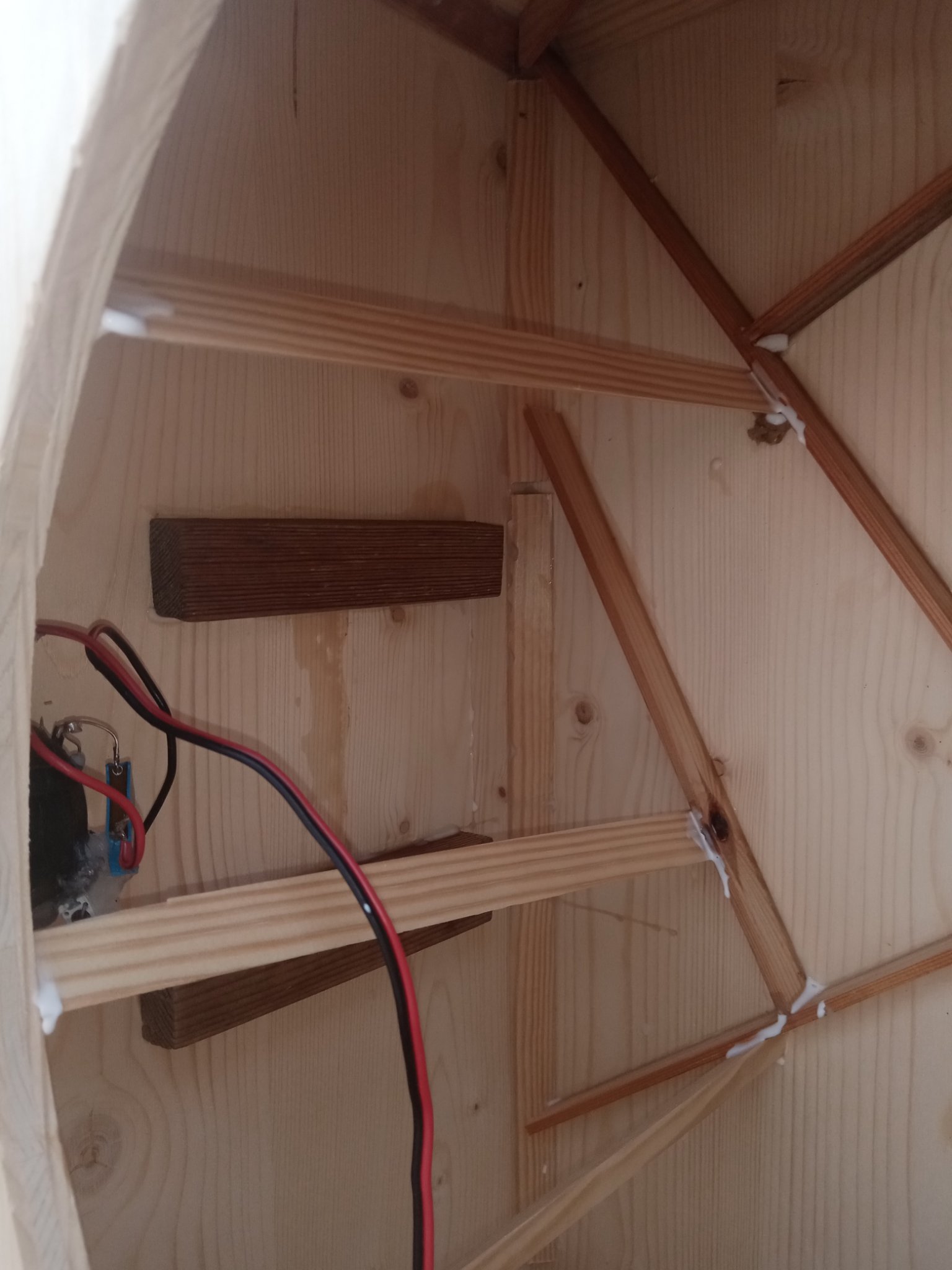

As far as bracing and damping go I've commented before that Dave's beautiful Jules Vern type speaker bracing actually acts as damping by eliminating any resonances in the box. Also, it's one ******* stiffly braced box.

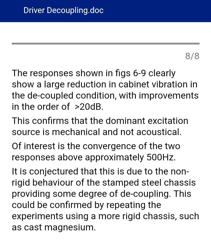

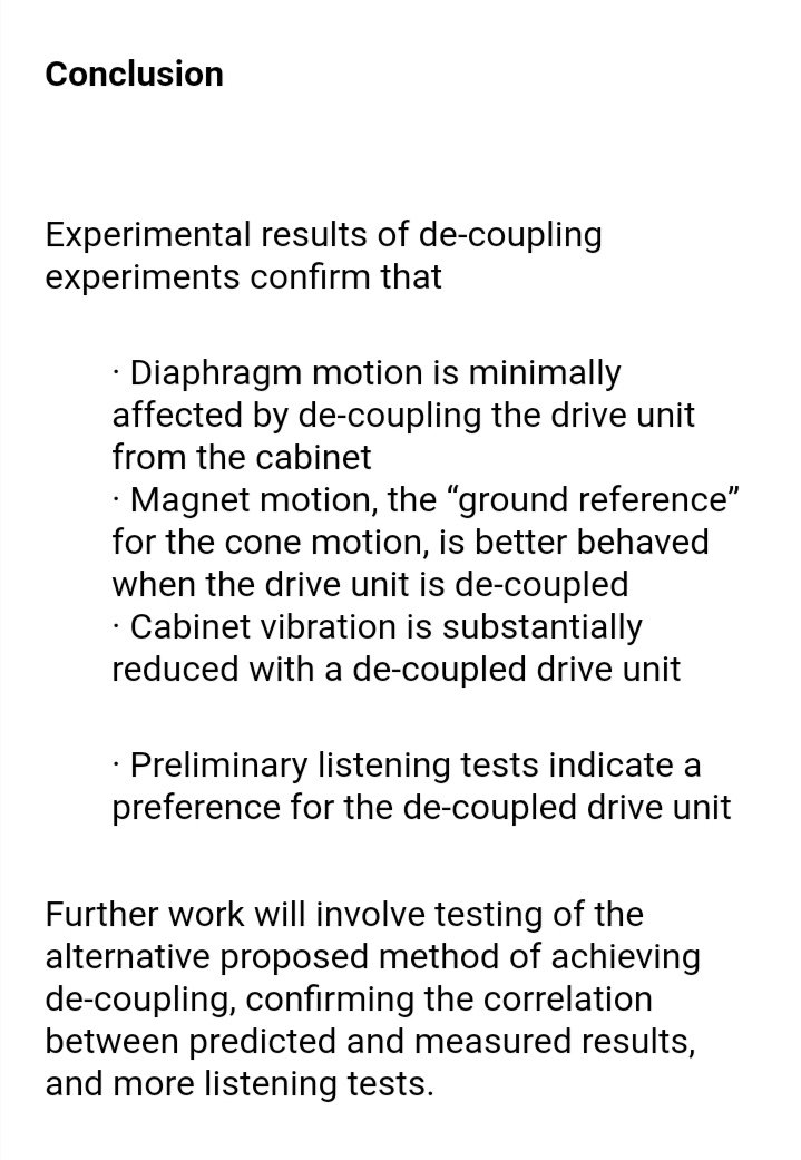

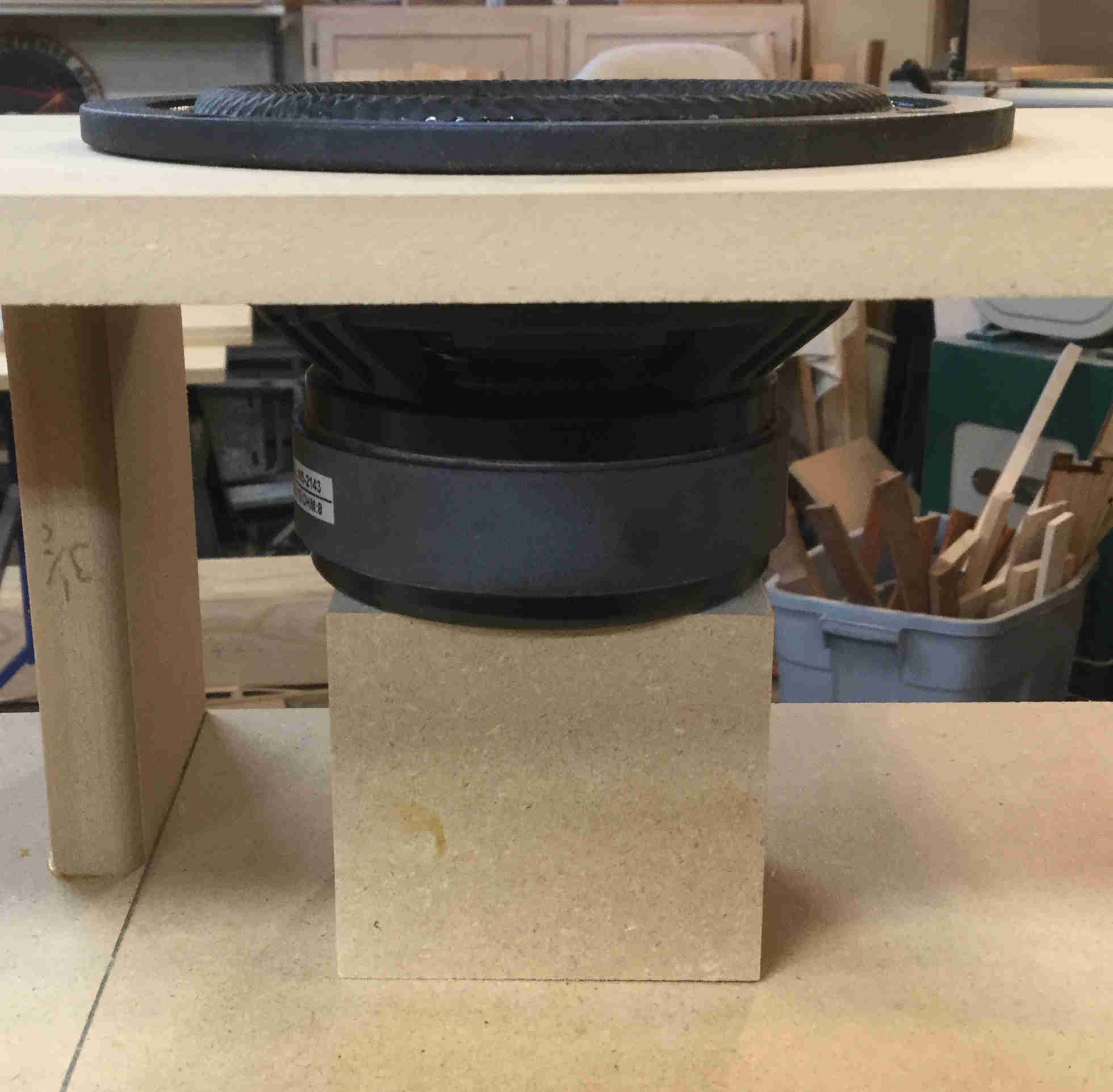

I've experimented with isolating the woofer frame from the front panel and found that supporting the woofer from the magnet with a stiff brace works best. The baffle stays isolated and a damping material gasket is between the woofer frame and the front panel. The woofer is supported by the brace that is mounted to the inside of the cabinet or to the floor. Another option is to mount two woofers back to back in a force canceling alignment. There isn't much if any improvement by placing a gasket between the woofer and front panel and then screwing or bolting them together. Also, the best results are of course with enclosures with large front baffles.
