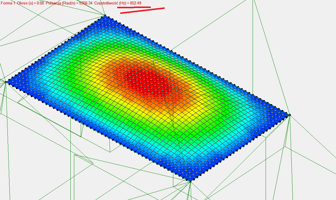

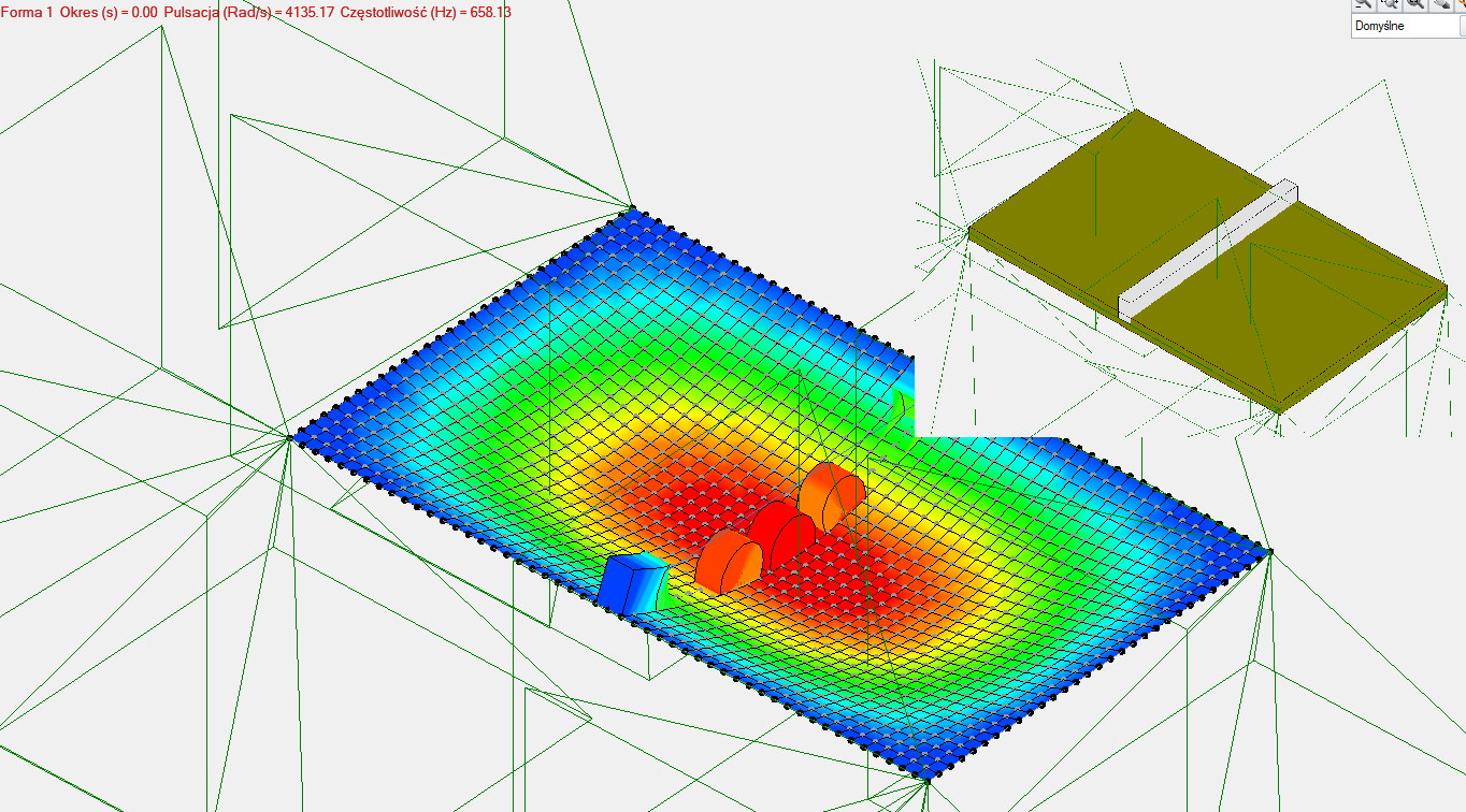

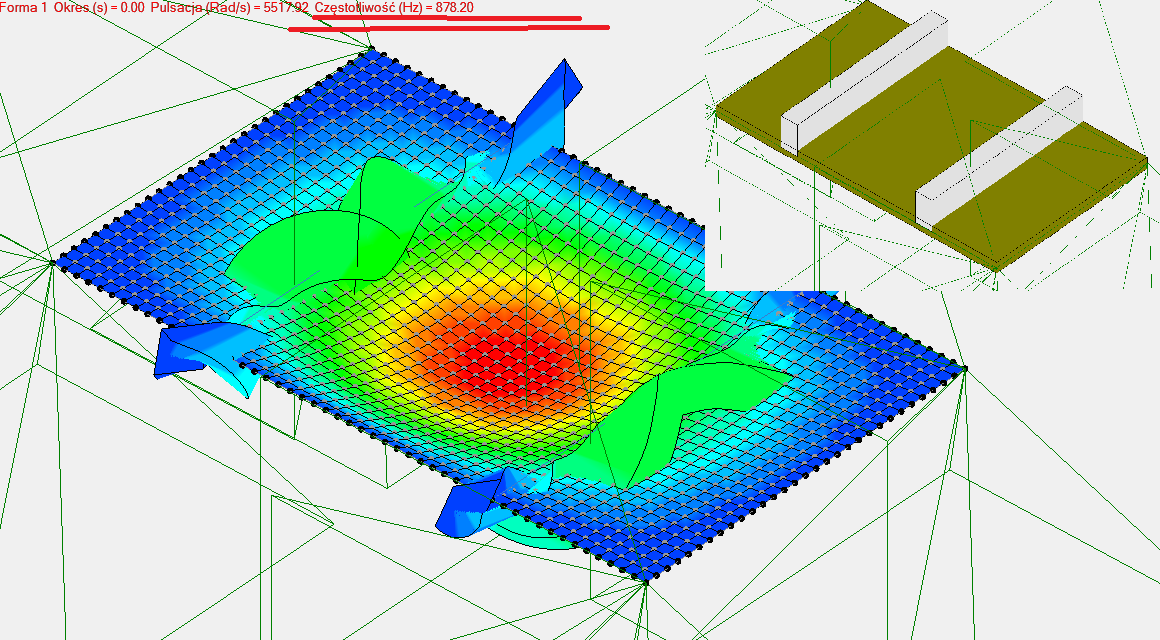

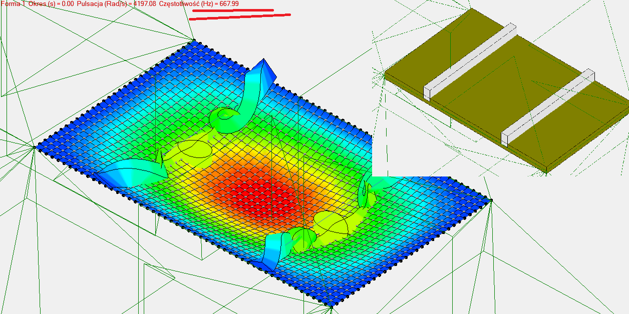

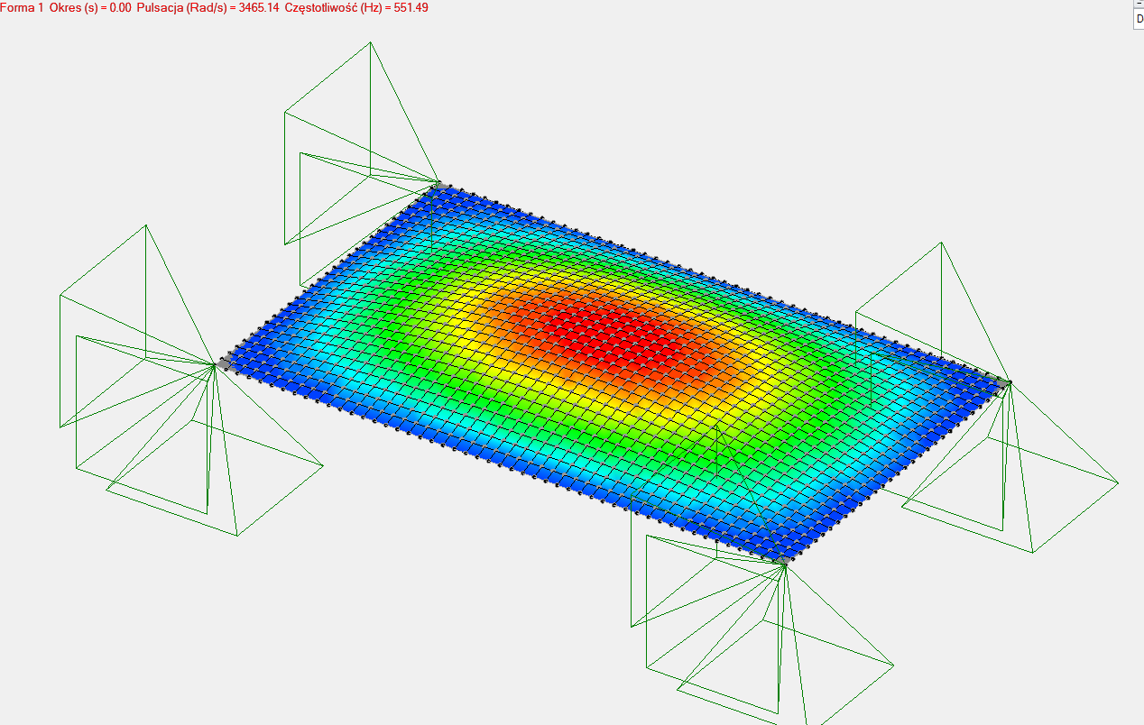

hi, i'm not sure if this will help with further discussion, but attached are simple simulation for 30x50cm wood panel.
simulation shows first resonant frequency (depends on geometric characteristic of panel). panel and braces are made bor wood (resonant freq. will look different for PLY or MDF). also it doesnt take boundary condditions into calculation (but what i did should be ok. for simple enclosure)
for 18mm wood -> 1st resonant freq. is ~550Hz
for 18mm wood with 1brace (20x30mm) > ~660Hz
for 18mm wood with 2braces (20x30mm) > ~680Hz (probably braces are too weak to stiffen panel or too far from the middle)
for 18mm wood with 2braces (30x50mm) -> 880Hz
for 30mm wood -> 850Hz
so bracing helps a lot. but it have to be done properly. Also it's very important if braces are made from one piece to stiffen all the perpendicular panels or from single element for each panel (worse).

Bracing isolated panels can be rather misleading not only because the boundary conditions used are not represenative of panels in speaker cabinets but also because when you glue up 6 panels to make a cabinet, cut holes in the baffle, bolt heavy drivers around those holes the problematic resonances (i.e. the ones radiating loudly at the listening position) tend to involve the drivers bouncing about on the baffle. There are resonances where the motion consists largely of panels moving but they tend to be higher in frequency, lower amplitude and not radiating directly at the listening position. After the one or two problematic modes have been addressed to reduce their magnitude, change their shape, shift their frequency,... what remains should be inaudible in use if the load carrying structure has reasonable damping, the baffle is of reasonable stiffness and nothing unreasonable is done to provoke cabinet motion. Different speaker configurations (e.g. small bookshelves, large monkey coffins,...) tend to require different degrees of effort to push the cabinet resonances down to inaudible levels.
Yes. It is a hard problem to analyze / simulate correctly. Not impossible, but hard. Someone who knows what they are doing with FEA needs to spend some time on a given design in order to arrive at a valid analysis.
A few years ago, there was a similar discussion. @ViniWerkel posted an interesting analysis that included the boundary effects. One of the conclusions is that once boundary effects are modelled, the strategy of increasing wall thickness becomes a very effective way to increase stiffness.
