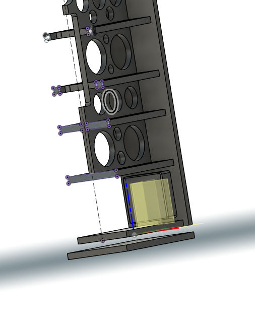

That is a bad position for a port. Also the enclosure modes will be worse than any panel resonance.It is bottom ported with a slot base on the bottom like a Wharfendale

However, the resonances should get trapped inside of the plate on the bottom. The plate will have felt on the top of it.
This actually splits the enclosure into more evenly sized portions than the other design. This is one of the reasons it is not my first choice.Avoid even spacing.

Can calculate the dimensions for a internal Helmholtz absorber, ala Pioneer/Tad etc.However, the resonances should get trapped inside of the plate on the bottom. The plate will have felt on the top of it.
Assuming an enclosure height of about 1 meter there will be a first mode with wavelength 2 m (170 Hz). To dampen this frequency your felt would need to be around 50 cm thick.However, the resonances should get trapped inside of the plate on the bottom.
A port should never be too near an enclosure boundary, worst is one end of a long box. All modes have a pressure maximum at the enclosure boundaries. So I would suggest to put the port at the back and keep the internal port end away from the bottom of the speaker ...
