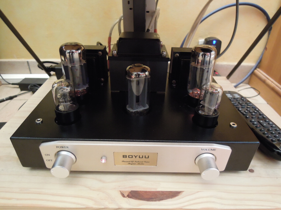

Hi!

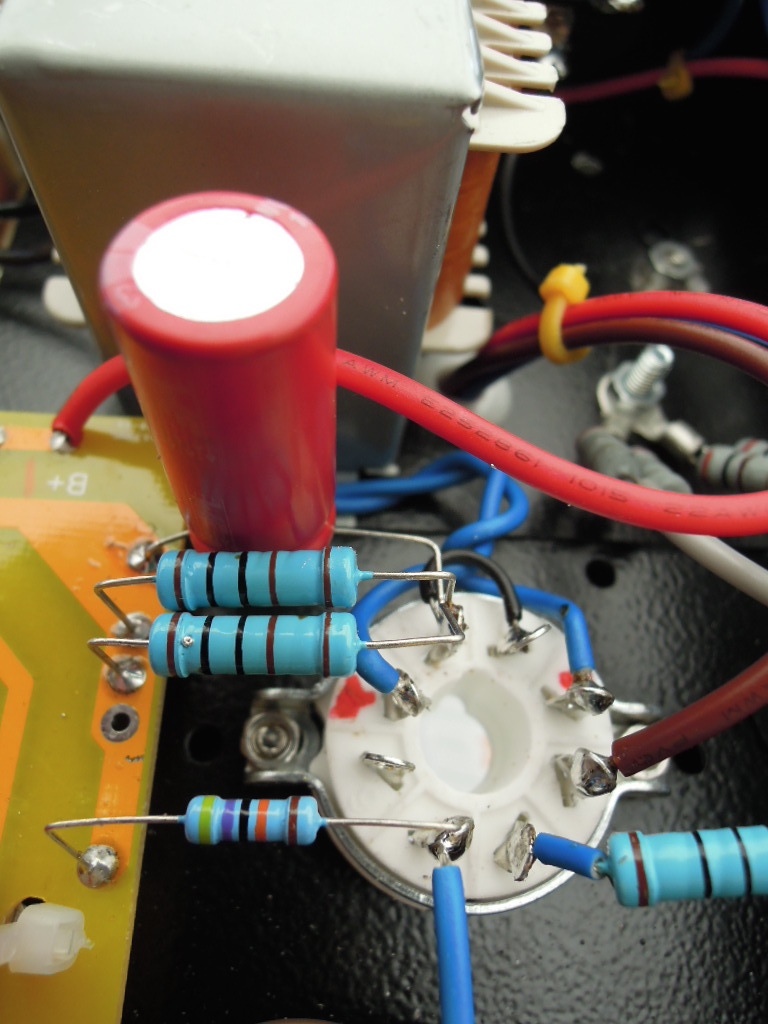

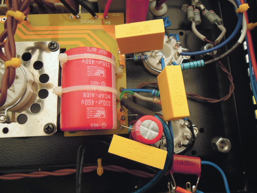

Here are my latest mods :

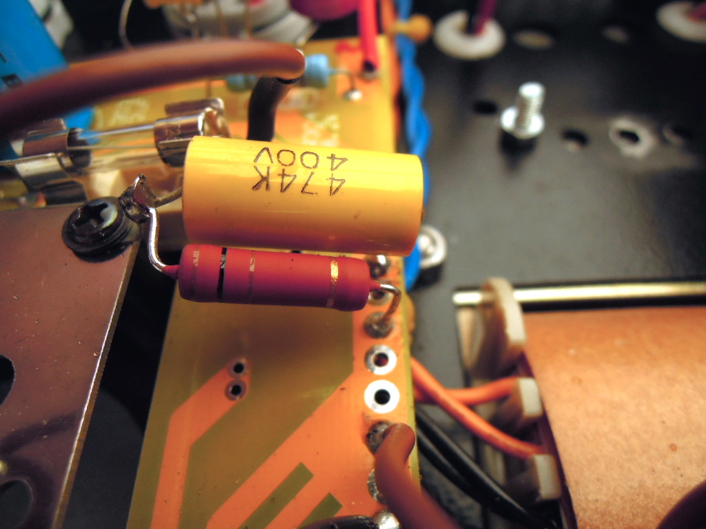

- I replaced the 0,22μF link capacitors by 0,47μF 400 volts MKP, and i also replaced the electrolytic capacitors that I added a few days ago, to decouple the 6N9PJ cathode resistors by high-quality 40Volts 470μF capacitor,
- I also replaced the EL34 cathode decoupling capacitors 220μF by 470μF,

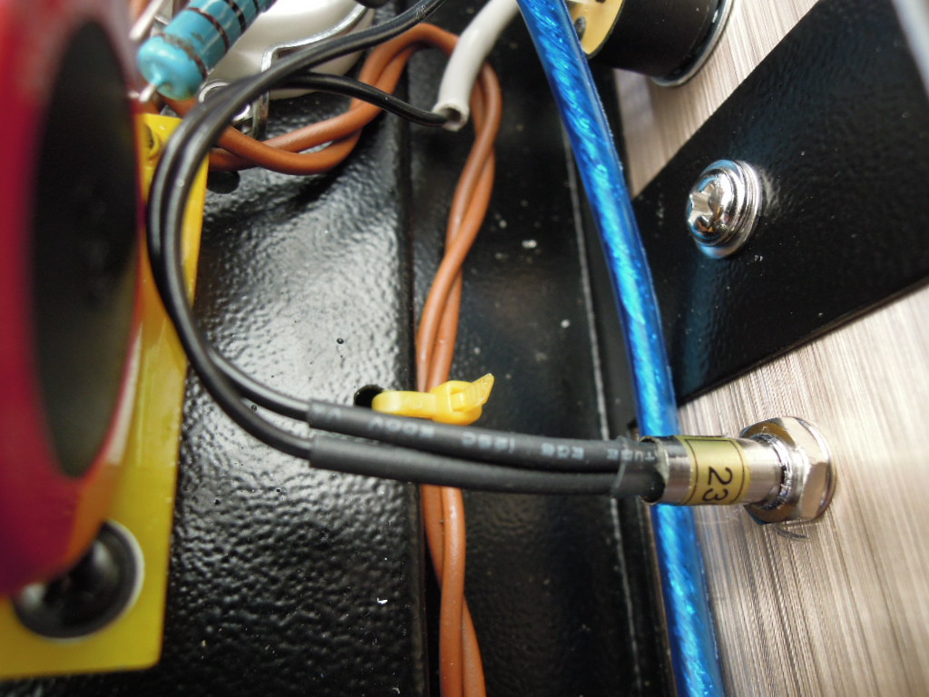

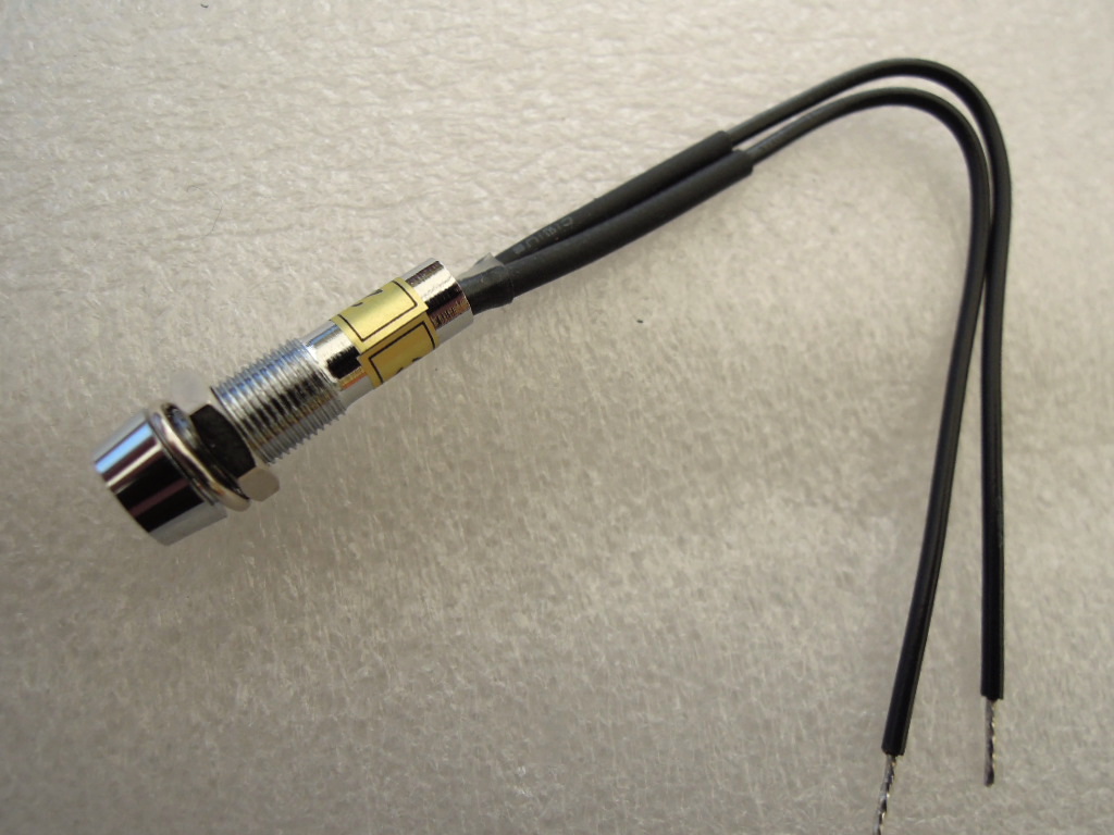

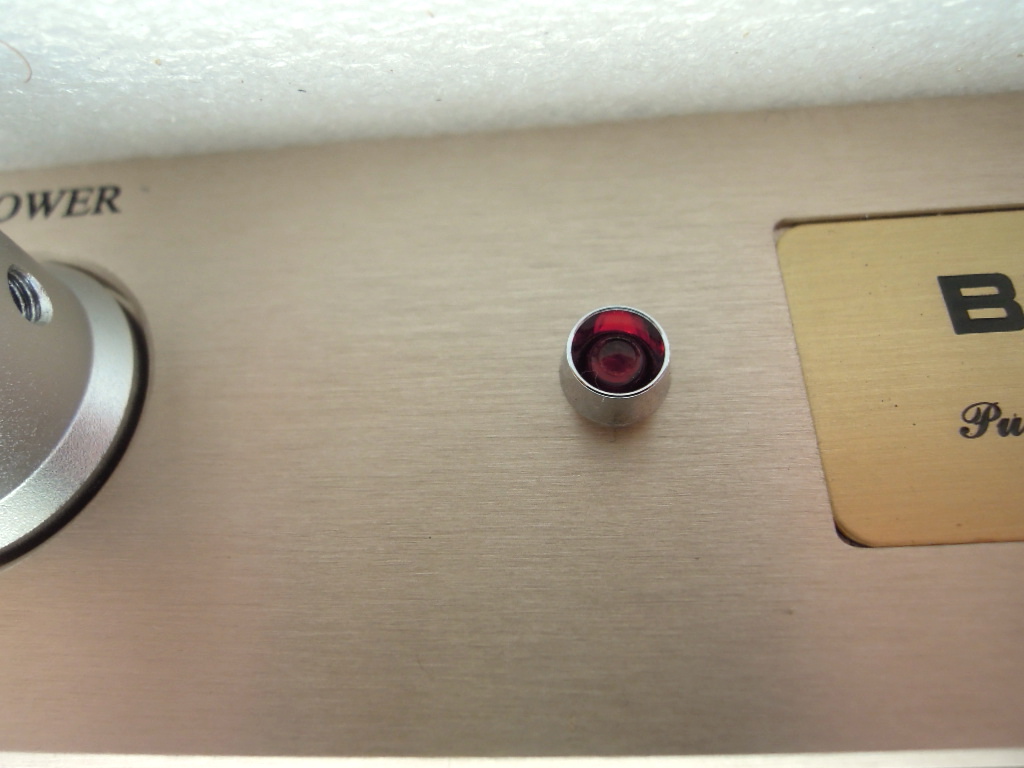

- And I installed a neon indicator light after the power switch.
So that's all for now!
Gidu

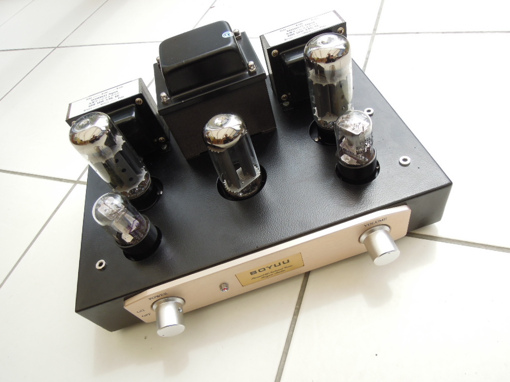

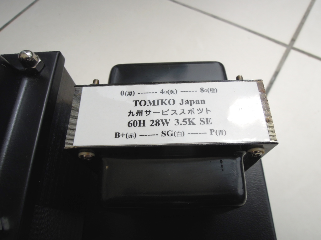

But, i shall replace the output transformers soon ! That's my next mod ...
Here is the model that i bought : it's a Tomiko
And i'm waiting for the delivery ...
Gidu
Gidu

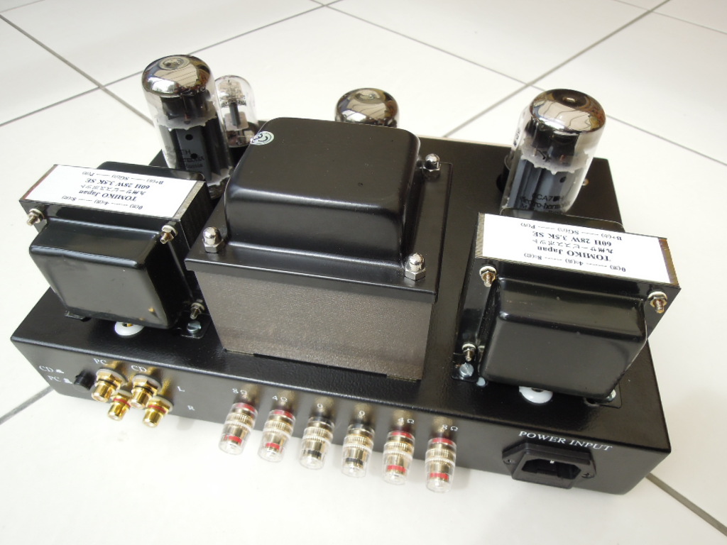

Hello !
Here it is, the Tomiko output transformers are installed, it's three hours of work, but it is not too difficult, the only difficulty was to identify the color of the wires corresponding to the primary and secondary windings ...
For now, I can not really appreciate the differences in tune with the original transformers because I have a cold and I'm half deaf !
But here are some pictures of the final result:

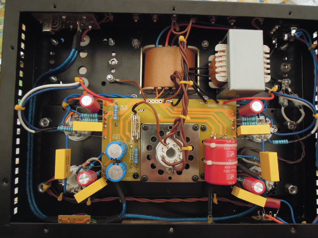

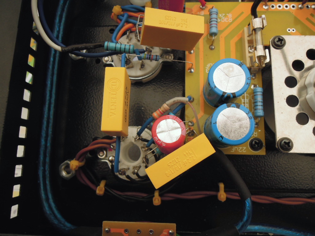

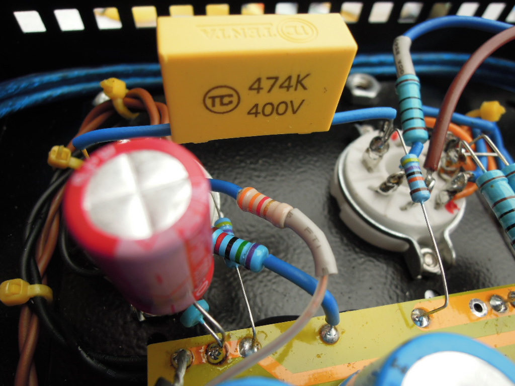

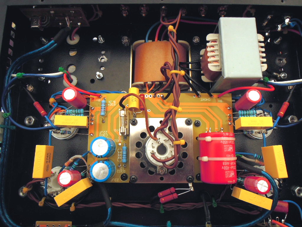

Hi !
My last mods :
- i connected in parallel of the cathode resistors of the 6N9PJ and the EL34 2 capacitors of 2,2μF and 10nF in parallel with the existing capacitors,

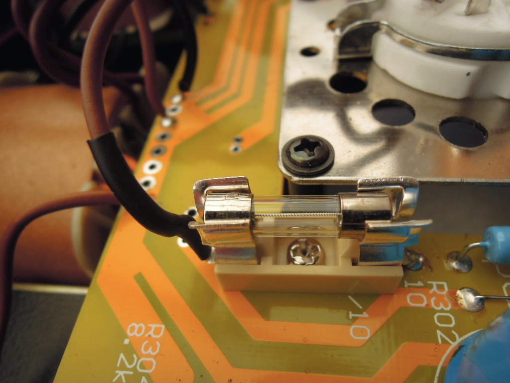

- in case of short-circuit of a capacitor, i installed a 250mA T fuse on the HT line in series with R301 to protect the power transformer and the 5Z3PJ valve.
So that's all for today !
Here are the pictures :
Gidu

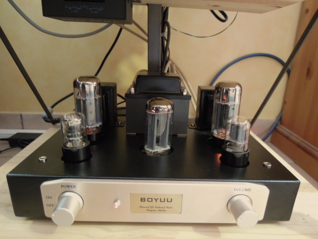

Hi !

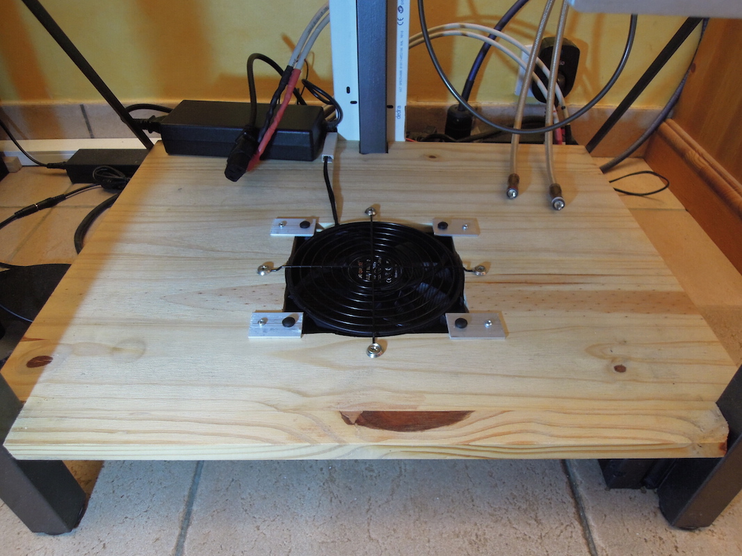

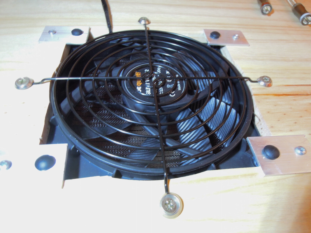

Last little DIY: the life of the components of a tube amplifier being directly related to the temperature of the components, i installed a very quiet PC fan normally operated at 12 Volts, but here under fed with 5 volts only under amplifier to cool it continuously.
After three hours of operation, the chassis and output transformers remain cold, only the power transformer is still a little warm, but far less than before !
That's all for today !
Here are some pictures :
Fresh Boyuu ...
Gidu

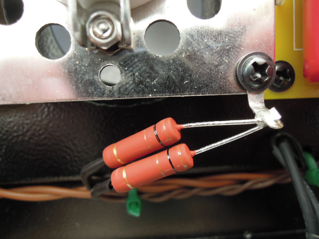

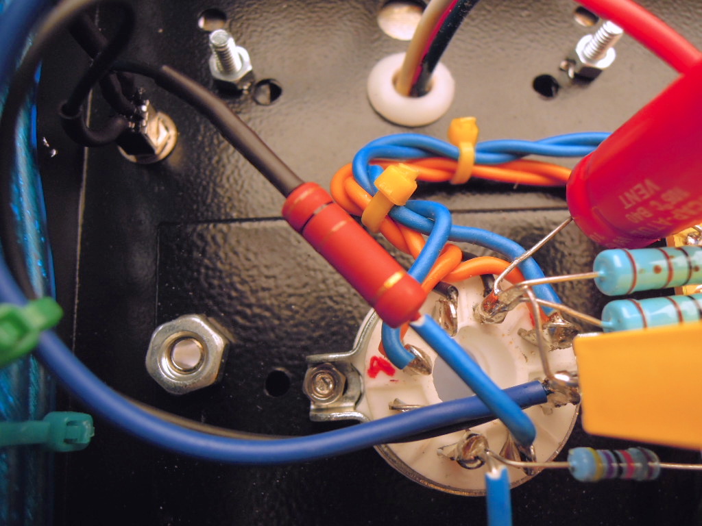

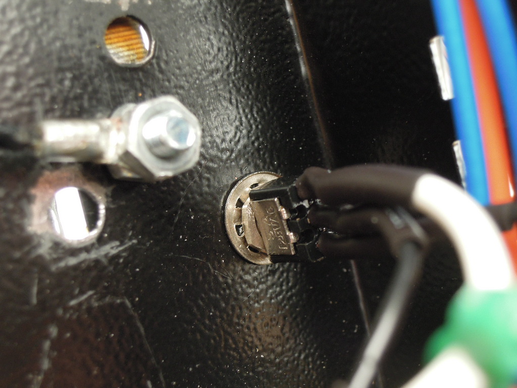

Hi !
These are my last mods on this amplifier:

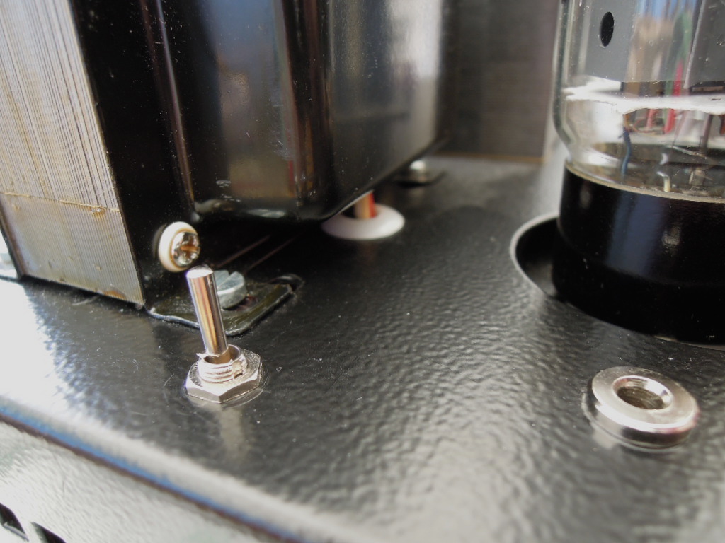

- Implementation of an Ultralinear / Pseudo triode switch,
- Grounding the chassis via a 100 Ohms resistor and a 470 nanofarads capacitor parallel, instead of a simple wire,
- Changing the 100 Ohms wiring resistances of the 6,3 Volts balancing point of the 6SL7 inlet tubes.
Listening in Pseudotriode mode seems more detailed while providing more support to the lowest octaves without losing significant power.
Be careful not to switch the ultralinear Mode / Pseudo triode when the receiver is turned on (big noise in loudspeakers and switches or even EL34 may blow, so, switching is done only when the amplifier is switched off)!
That's all !
Gidu

Please remove the brown capacitor across the Lorlin switch. It is a cheap part, and it is not of spec for AC 230 V .After some time it will fail to short . It is actually illegal to use in this position. You have to replace it with a X1 or X2 specification capacitor.
Ok, it's a good advice, i shall replace it soon ! Tank's.
