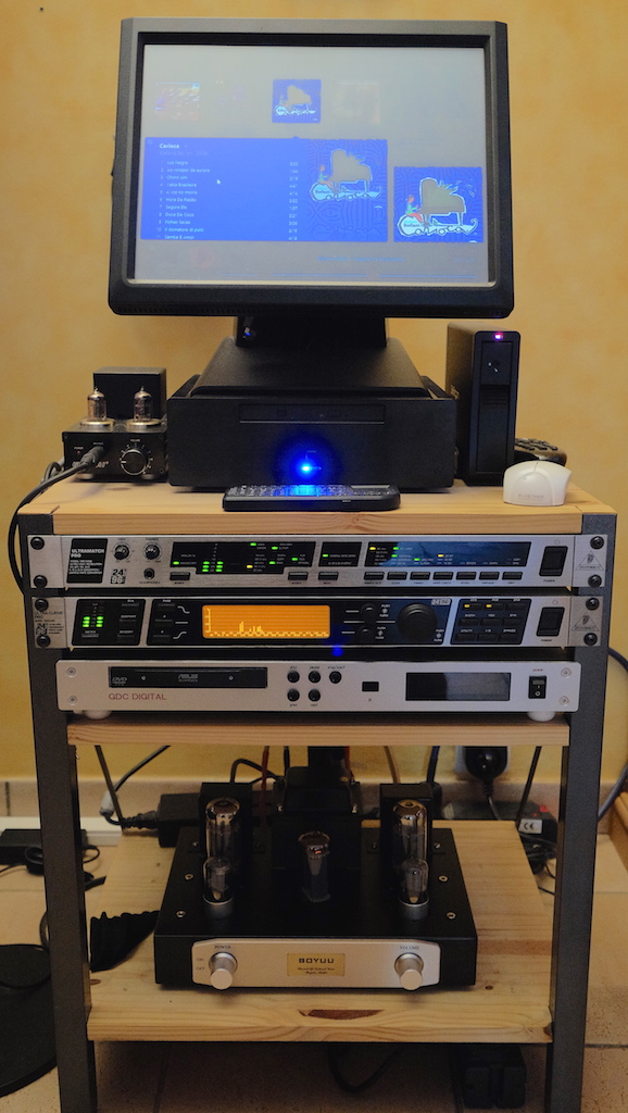

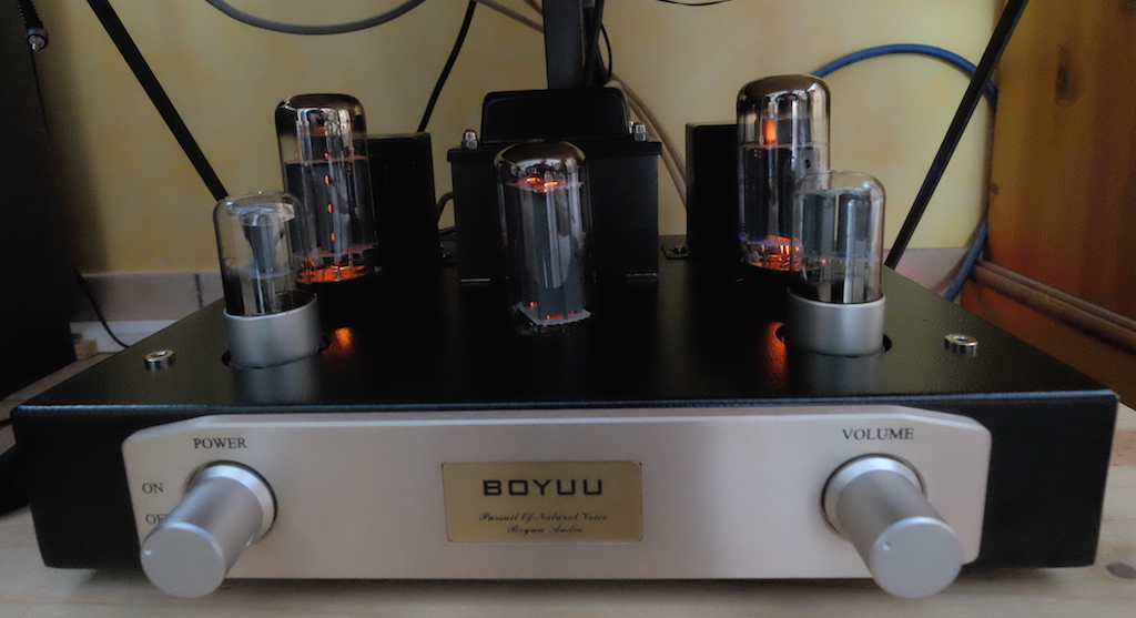

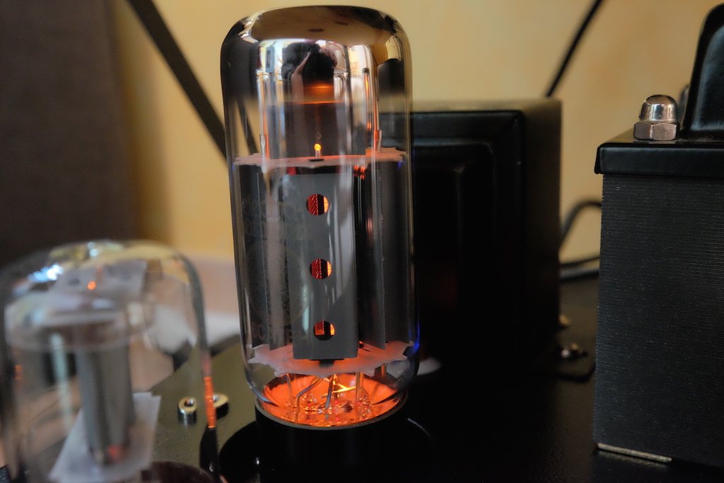

Hi!
Here are some pictures of my A9 BOYUU now fully operational:
The new tube 6CA7 EH instead of the Chinese EL34B :
And my actual hifi system (the CD player is fully diy, and the headphone too, but it is not visible on the picture ... see my signature !). The music player is based on MusicBee :
Gidu

A DYI CD Player????
How did you do this? Old PC drive and some electronics after that?
I built a DAC to bypass the CD internal one which is poor, but the whole player?
RESPECT! ( and more info required!) 🙂
A DYI CD Player????
Yes, exactly ! Look here : Lecteur CD audio DiY Sorry, it's in French ...
But, there is no DAC Embedded.
Gidu

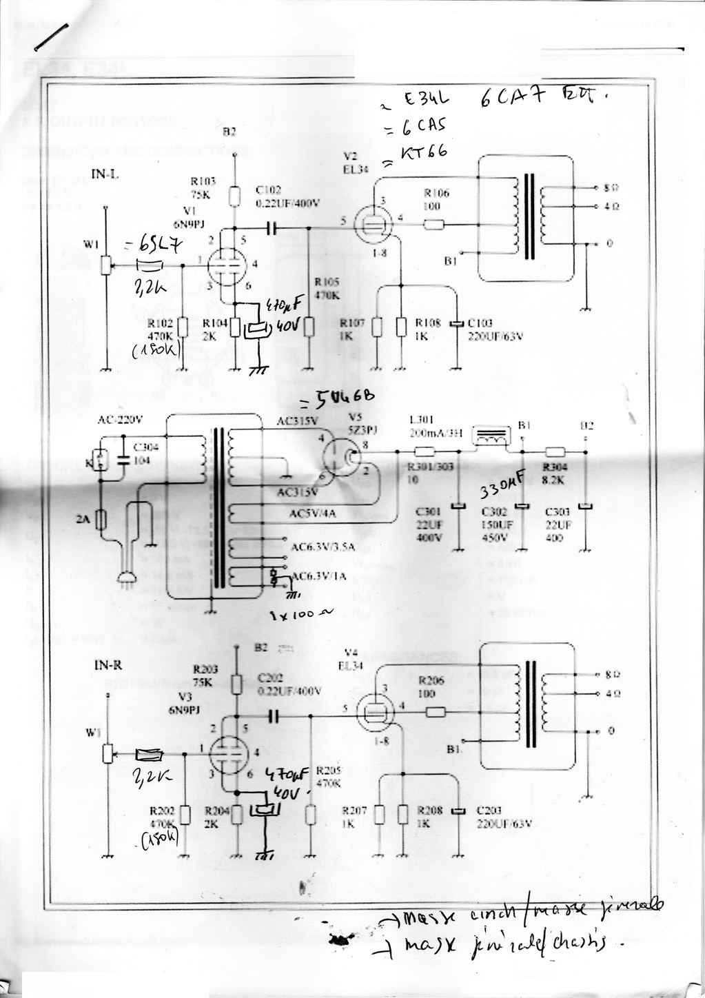

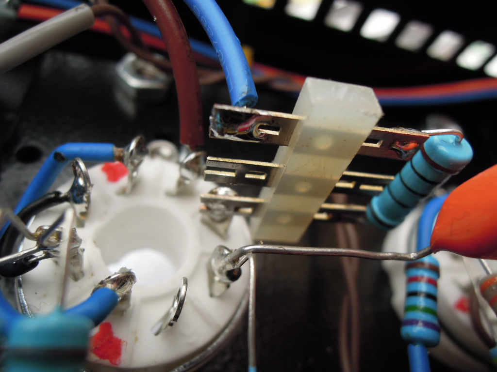

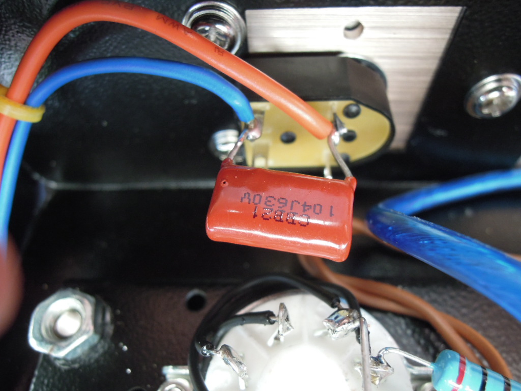

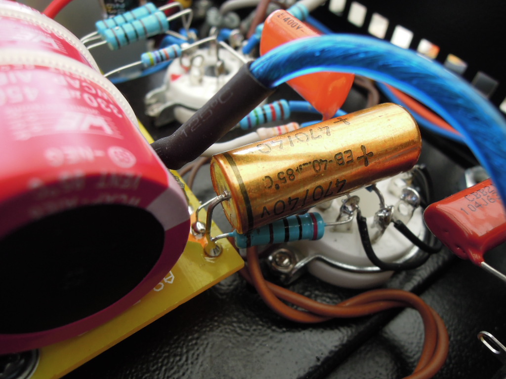

Hi!
Here is my last mod : I have set up a 470 microfarads / 40 Volts capacitor in parallel to the cathode resistor of each 6N9PJ tube.
It is strange that this capacitor is not present on the original schematic, because almost all of the schematics that I found on internet show that capacitor ...
The listening benefits are very sensitive : the input stage has a higher gain and the frequency response seems more linear to me, including bottom spectrum with substantially low frequencies.
Here are pictures of the mod :
And here are all mods that i done :
Gidu

Hi !
This calculator is very interesting, but what's the downside of having a higher value than that indicated by the calculator for decoupling capacitor resistance cathode of 6SL7, ie 470 microfarads instead of 80 microfarads ?
Gidu
More is better, do not worry!
Try at the cathode 1000uf +1000uf back to back ( + - - + ) and you will get 500uF not polarized-cap and much cleaner sound!
What would be the required voltage rating of the caps for this application? With two 1000uF in reverse series, this can become quite bulky in the enclosure!
Thanks!
Hi !
The required voltage rating of these caps is limited to 20 Volts max because the polarisation of the cathode is only a few Volts.
Gidu
Gidu

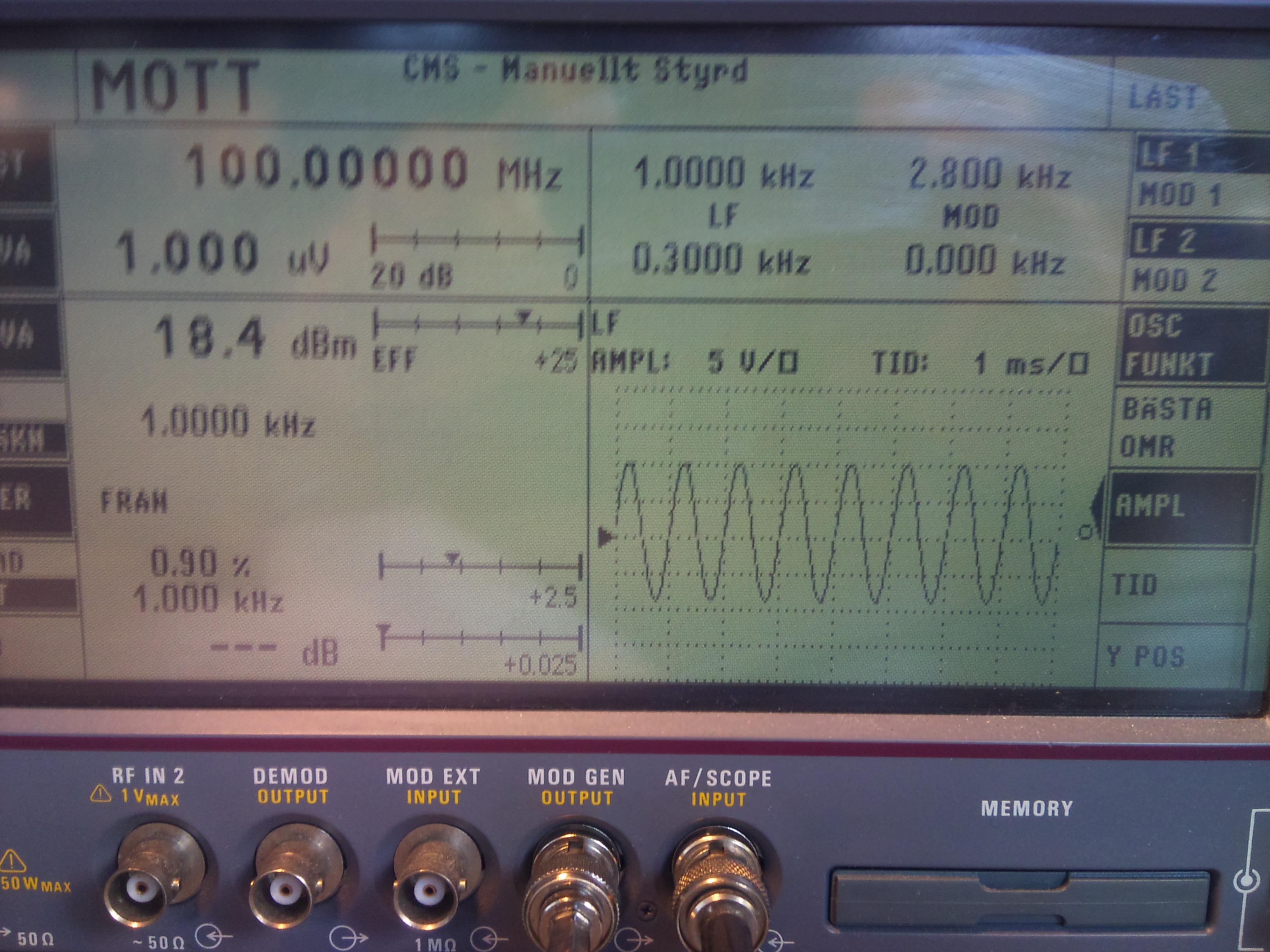

340v R301, B1 332v (47,3mA), B2 312V PIN 4 (EL34)325V, ANOD 321V, KATODE 24V, KATODE DRIVER 2,4V ANOD 220V , distortion vid 1kz 0,90, 1,4vp-p ing, gives 23v clean then start clipping , same att grid (el34) 23v gives to anod 429v , it makes about 17w channel,
