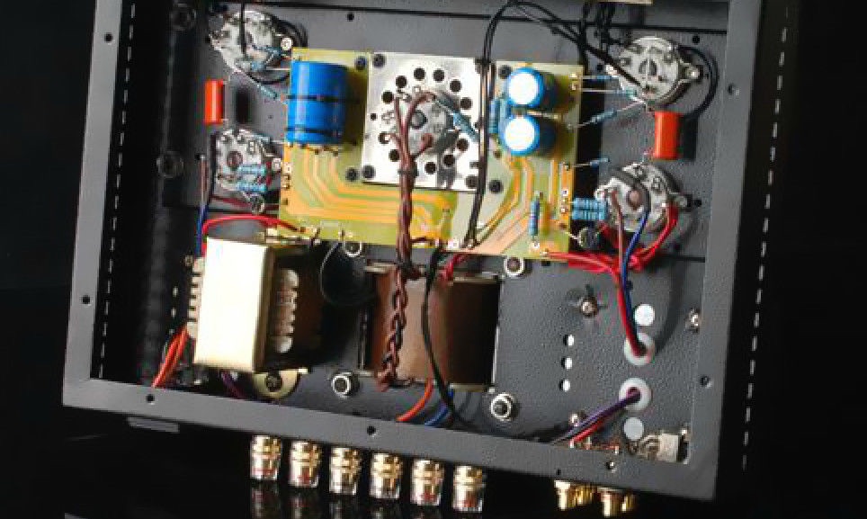

Hi Gidu,
I struggled with the schematics there. It shows only one 10R, but nominates R301 to 303 and the picture from Boyuu shows two on the PCB and one in series from the valve to the PCB.
Maybe someone else can shed some light on that, before you roast something on the amp. Mine runs with three resistors.

In fact, the choke inductor is mounted on the chassis as in the pictures above ! I have been using a hole for fixing the cover of the output transformer and the other leg of attachment of the choke is inserted under the plate which carries the supports of the electronic tubes.

Anybody out there who could emlighten us on the resistor value/number for the R301/303 just after the rectifier tube before the choke.
Since no expected voltages are provided for either B1 or B2, it could be anything.
I inserted 3 resitors with 10R each, i.e. 30R before the choke.

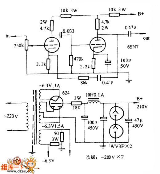

Have you removed the B3 connection to the 6n9p filaments?
You don't want to be using both heater elevation and artificial centre tap to ground.
Well, i don't have any connection between B3 and the 6N9P filaments (your schematic is different from mine) ... I only have now artificial center tap to ground !

Here is the simple schematic of this mod (this is just an example) :
The resistors can be replaced by a wound potentiometer 100 Ohms / 3 Watts , allowing fine-tune balancing of 6.3 Volts.
(The current through the resistors is: I = 6.3 / 100 = 0.063 mA , so the power dissipated is: P = 0,063 x 63 = 0.396 Watts or P = 6,3 x 6,3 / 100 = 0,396 Watts)
