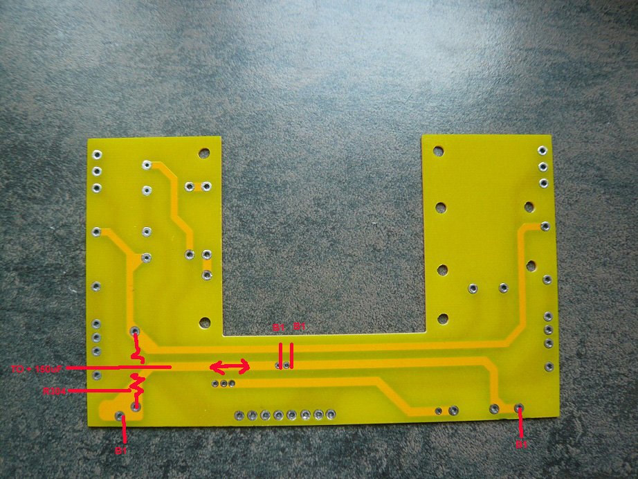

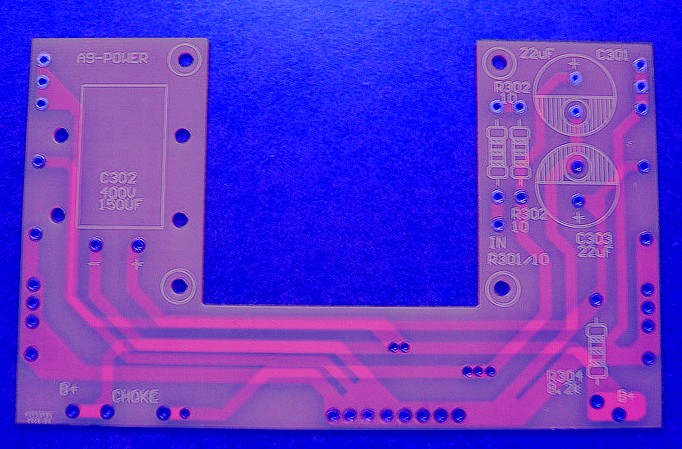

I have been reading this with interest as I have not started mine yet. Thought a couple of pics of the main power board might help with the fault finding.
Thanks! Just what I needed to answer my questions. Almost as good as having the PCB in my hands.
And, also thanks to Ygg-t for doing that combined photo.

From a very quick look at the schematic (and from a tube-noob's point of view) are the 2 connection points to C302 you have marked meant for connection of the o/p xfmr flying leads B1 ?
Yes, you have that worked out correctly.
There are two different pairs of solder points for the B1 connections-one pair close together at the end of that C302 trace on the top side of the board, the others are at the edge of the board; use either, IMO.
Checking the top and bottom of the board, you can figure out how the 4 connections to the + end of the 150uF cap are made:
Two connections to the primarys of the output transformers (B1 R and B1 L), one end of the choke, and one end of R304.
IMO, time spent working out this stuff before the board gets 'locked in place' with soldered connections is useful. Your pics of the board are an excellent resource.
For a simple circuit like this, terminal strips with good solder lugs can work well, but good ones are not that common these days, so the PCB can help.
