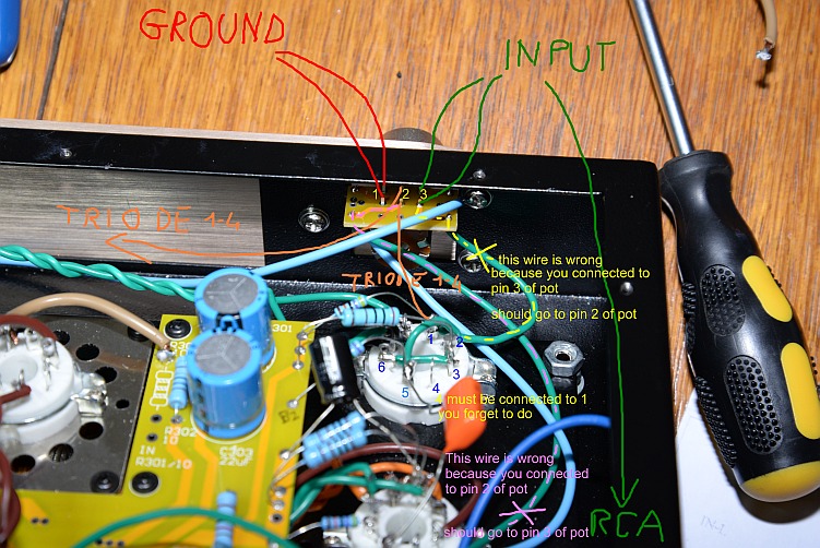

The first thing I see wrong is your potentiometer connections: the center tap must go to the grid, while you put the center tap to the input RCA. In this case you are shorting the source when at minimum knob level!
Please rewire the potentiometer connection.

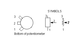

Grazie ygg-it. Can you explain that wiring to me then? The other two pins are common and I'd have thought that it's those (on the far left in the picture) that would be earthed. Currently the input is on the pins marked with the white "I" on the board and the outputs on the far right. I want to get this exactly right before I rewire them. Thanks for your time.
My advice would be to focus on the actual pot connections, not the PCB, if you are trying to match your wiring to the schematic. If necessary, take the knob off and unbolt the pot & PCB from the faceplate, and figure out what is connected, to what.
At that point, why not use your ohm-meter and figure out how the pots work? Which way of connecting will give you a 'straight through' (low resistance) connection between the input from the CD player (?) and the wiper which is connected to the tube grid, when the knob is turned fully CW?
I wouldn't assume that my idea of 'I'nput is the same as the person who made the PCB. (It could be 'wire to 'I'nput of first tube ??)

I've checked the pot with the ohmmeter and it appears the wiper is the centre pin, i.e. the current input connection, and the output is the currently connected output pin. The resistance varies correctly to practically nothing where the wiper shorts to the output pin. The unconnected pins, which on the board are connected and common, must be the earth connection which I need to complete. I'll give that a go.
Please refer to my pic.
Attached the correct potentiometer wiring. Pin 2 of the pot must be connected to pin 4 of the triode!
So when you rotate the volume knob, the triode's grid must go or to the ground (no sound) or to RCA-input (clockwise, max sound).
Pin 1 of the pot are the ground and must be connected together.
Also you forget to connect pin1 to pin4 of the triode in both channels!
The two grids are parallel connected!! These floating grids (pin 4) should be the cause of your noise!

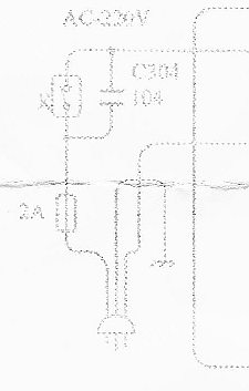

Why you miss the 2A fuse??
Please immediately insert 2A fuse (even less should be ok at initial stage) between one wire the power cord and (i.e.before) the power switch.
Do this before switch-on again your machine!
Don't exceed 2A fuse. 1.25A or 1.6A should be ok (220V*1.25A= 275W...) at this stage...

I don't see the ground wire connection of the pot. Please check that both pins 1 of the pot are wired to ground. Refer to my previous pic (my red connections)

Pin 1 must be connected to pin 4. Fortunately leaving them floating should not have caused damages to the triodes. They just acted as RF antenna and mixed the input audio signal due to the fact that the parallel connection of anode and cathode are wired correctly!!
Parallel triodes work fine because they lower the noise. Unfortunately Miller capacity double, but since this kit is missing of the grid resistor, this should not lower the frequency response too much.
I would put a 2,2k-4,7k resistor from pin 2 of the pot to pin 1+4 of the triode, instead of wiring them directly.
In any case our English friend must rewire correctly the pot before trying this.

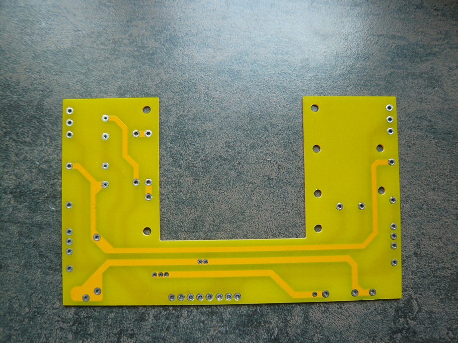

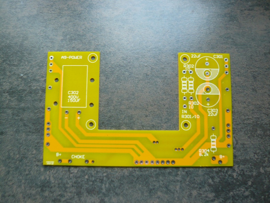

I'm still wondering about the power supply wiring connections - are there traces under the PCB? Some voltage tests would help.

By the way YGG - there is a 2A in-line fuse built into the power cord connector. I put that fuse holder in by mistake before I realised there was a built-in fuse.

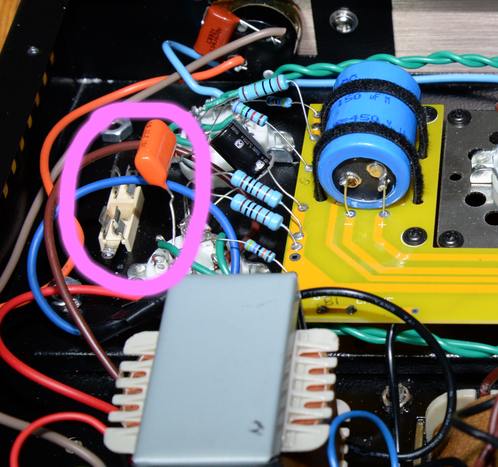

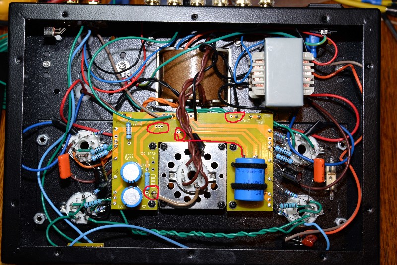

I'm still wondering about the connections to the power supply board.
There are traces underneath the board which don't show in the pictures.
I marked a few of the ?? spots on the attached pic.
If you can measure the DC voltages between ground and:
-Pin 2 or 5 of each input tube
-Pin 3 of the EL34s
-Pin 4 of the EL34s
-the + end of the large 150 uF capacitor
and post them, that would clear up some of the power supply questions in my mind.
Thanks.

Hiya VictoriaGuy
I have been reading this with interest as I have not started mine yet. Thought a couple of pics of the main power board might help with the fault finding.
From a very quick look at the schematic (and from a tube-noob's point of view) are the 2 connection points to C302 you have marked meant for connection of the o/p xfmr flying leads B1 ?
