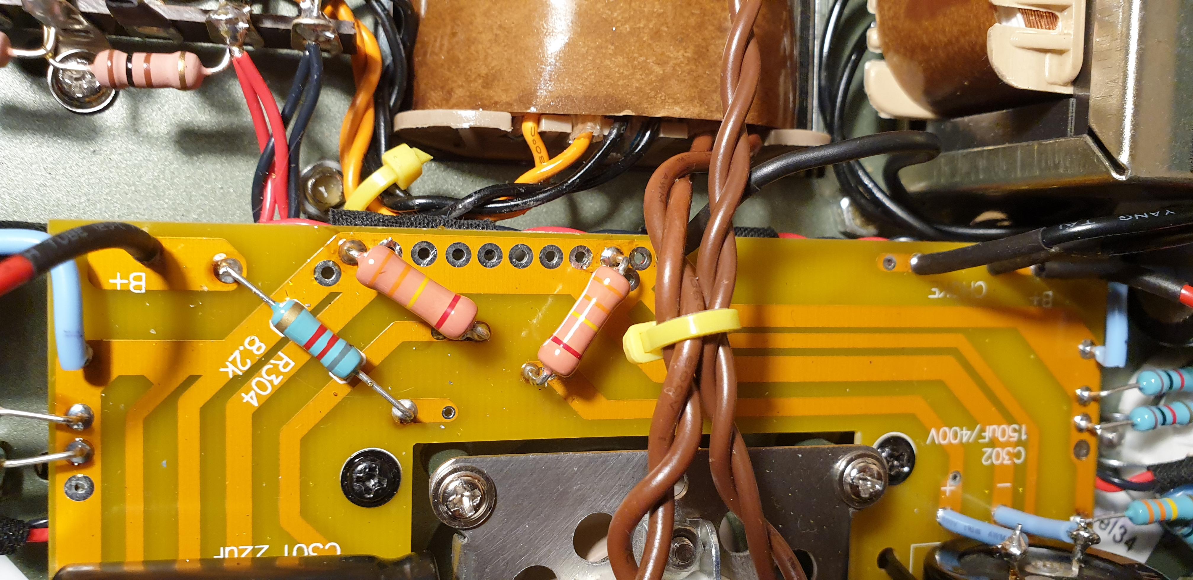

200k bleeders will run at about 0.6W, so yes, they should be hot, but it shouldn't cause any problem if they're real 2W ones

Well I'm not certain about being real ? Their not burning or discoloured but let's say their hot enough to leave a burn mark on your skin , that worried me , I have some Takman 5w equivalent but much bigger physically, ive been trying to work out exactly what is right for these , so many opinions but surely there must be 1 correct answer ? The caps they need to bleed are 330uf x1 and 33uf x2 is there something better ?? But I don't want one of those big cement types ive seen thrown in , ive spent a lot of time and effort inside the app, but I'm also still learning

I think you said earlier that the charge bled away quite quickly. Maybe double that time by increasing the resistors, reducing the current - and hence its heating effect.
True, you may increase the resistors value with discharge time increasing proportionally.
330k will run at about 0.37W, 470k at about 0.26W.

Thank you , as I said I'm still on a learning curve but I pay a lot of attention to this , I will see what other resistors I may have , I really question the quality of the ones I fitted , and so happens they were the ebay ones !! Everything else i get from hifi collective , should I increase to 3w ? Much thanks for the replys guys

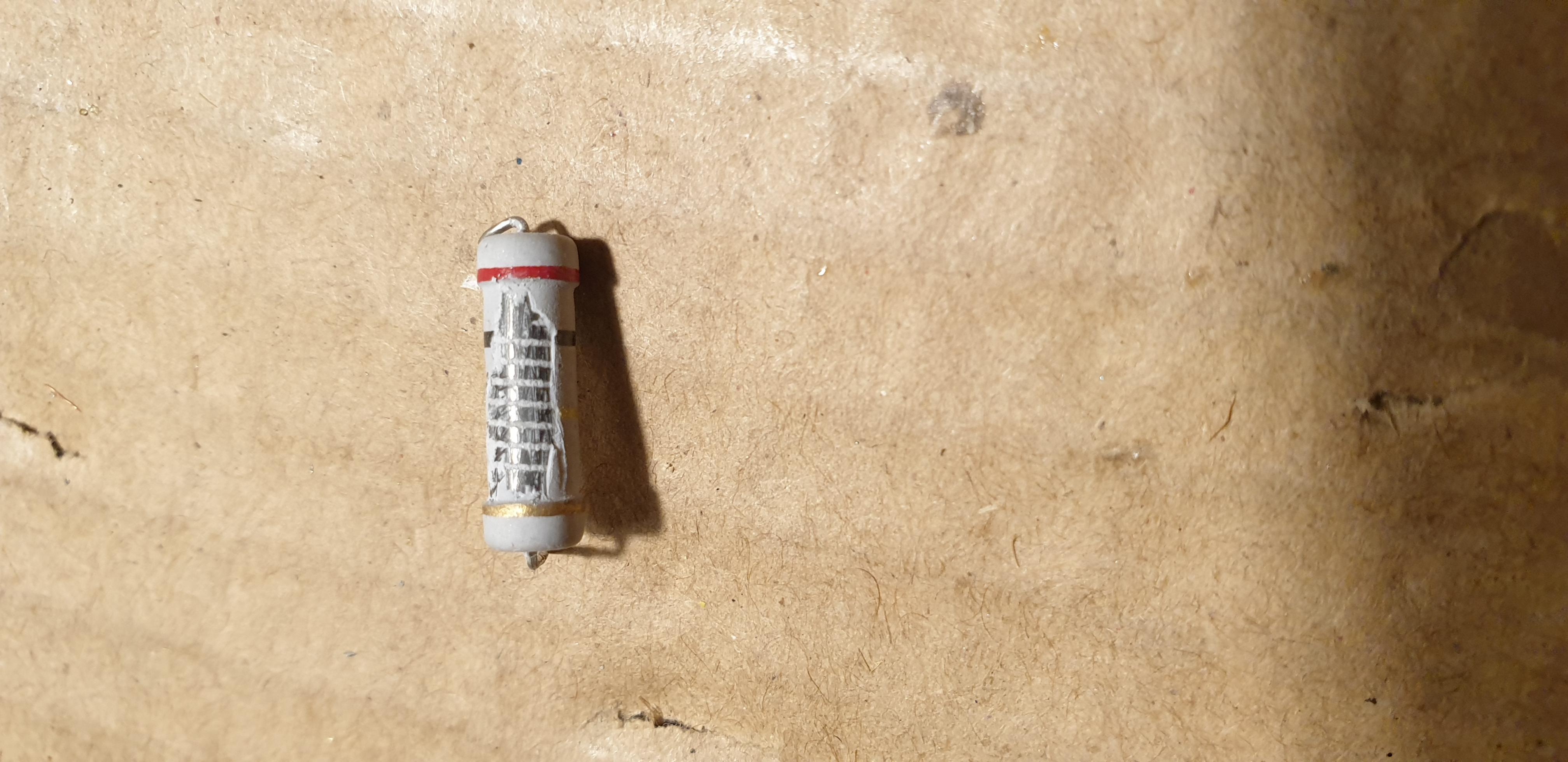

Ok so I have tonight changed the 2 bleedback resistors, luckily I had a pair of Takman 330k , the pink ones in the photo , all is cool 😎 now literally, to my disappointment the grey ones are fake without a doubt , is nothing sacred??
think were both confused now !! so the grey unbranded ones but i suspect fake in their values was supposed to be 200k 2w - the new pink Takmans are 330k 1w - and they are almost cool to touch , Takman rate their 1w resistors to run at something like 5-600w - physically they are big as 2-3w resistors - i know some people just dont worry about cheap stuff but i always buy good quality - as in the case of me risking buying the grey200k's from ebay - look where that ended up !! normally i use hifi collective because i trust their products - Takmans are about £1.00 each - ebay pack of 10 rubbish £1.50 -- NEVER AGAIN !!
