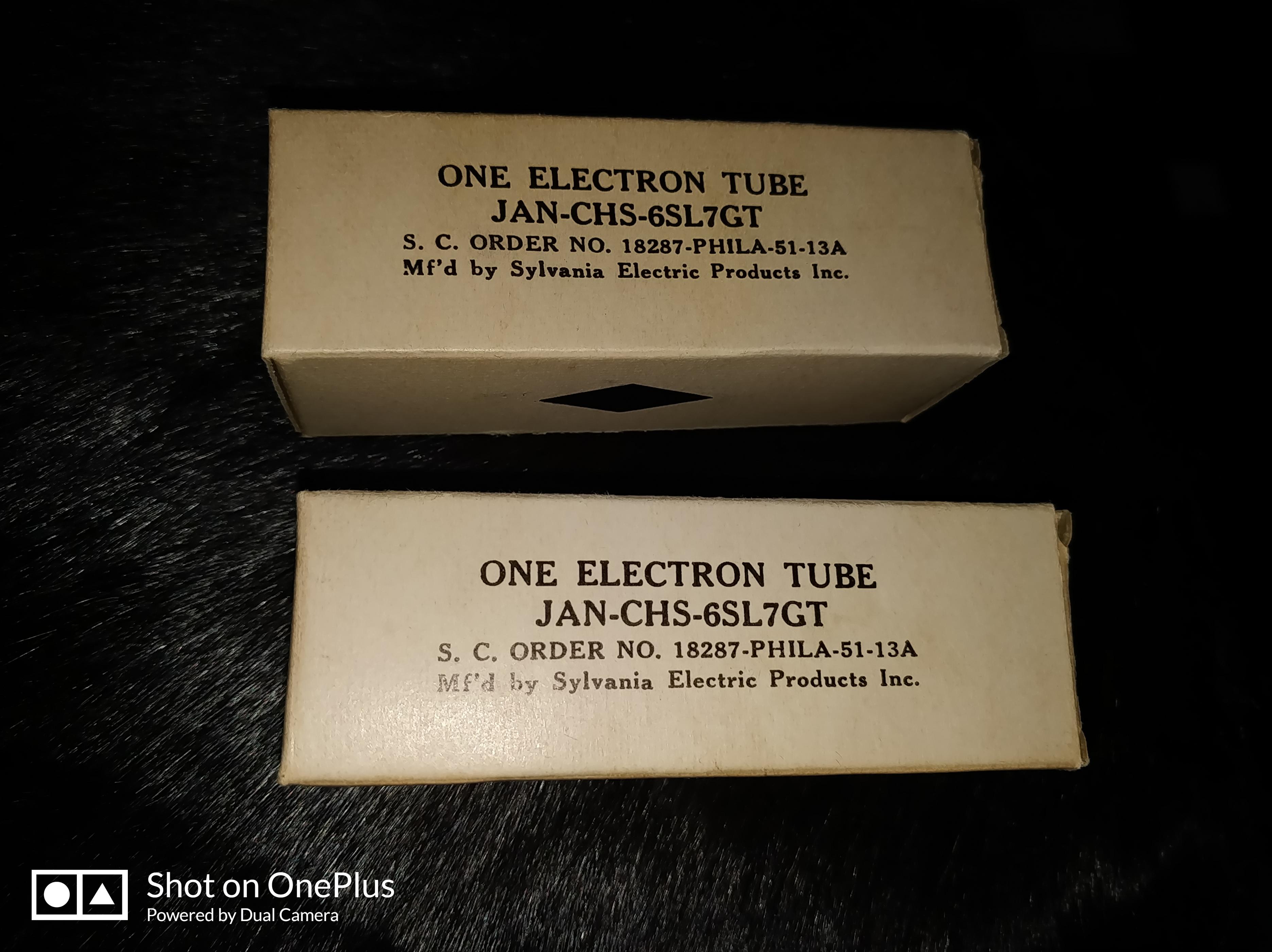

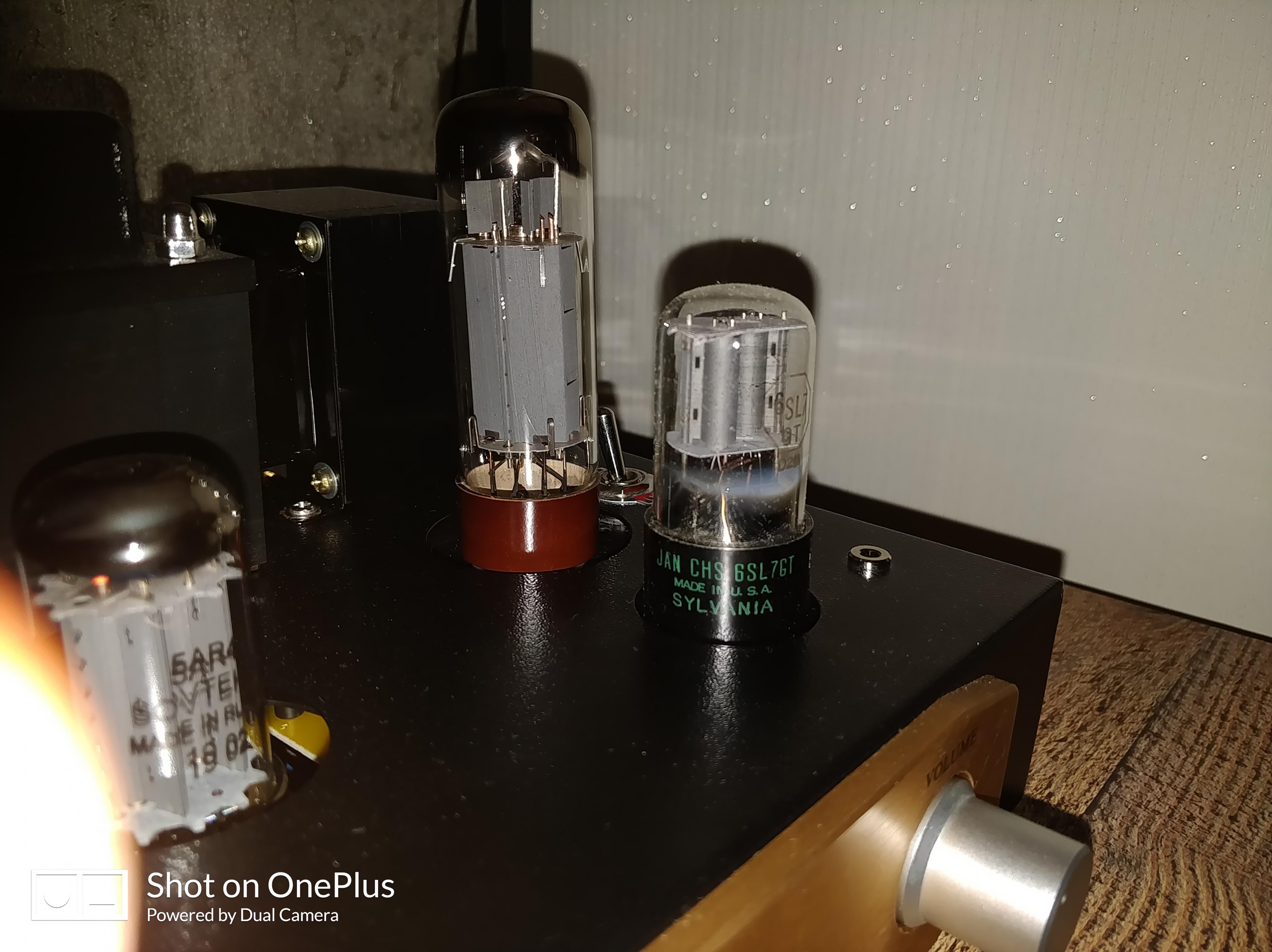

Just thought I'd share my latest upgrade.
I just swapped out my Tung-Sol SL7GT s for NOS Sylvania JAN-CHS-6SL7GT s and, oh my, what a difference they make!
The amp is noticeably brighter, with clearer treble and bass. The soundstage appears wider too.
Can't say if this will have the same effect on stock A9s - I added bypass caps and local negative feedback to my driver stage but I think it's worth a try - it certainly won't get any worst..
