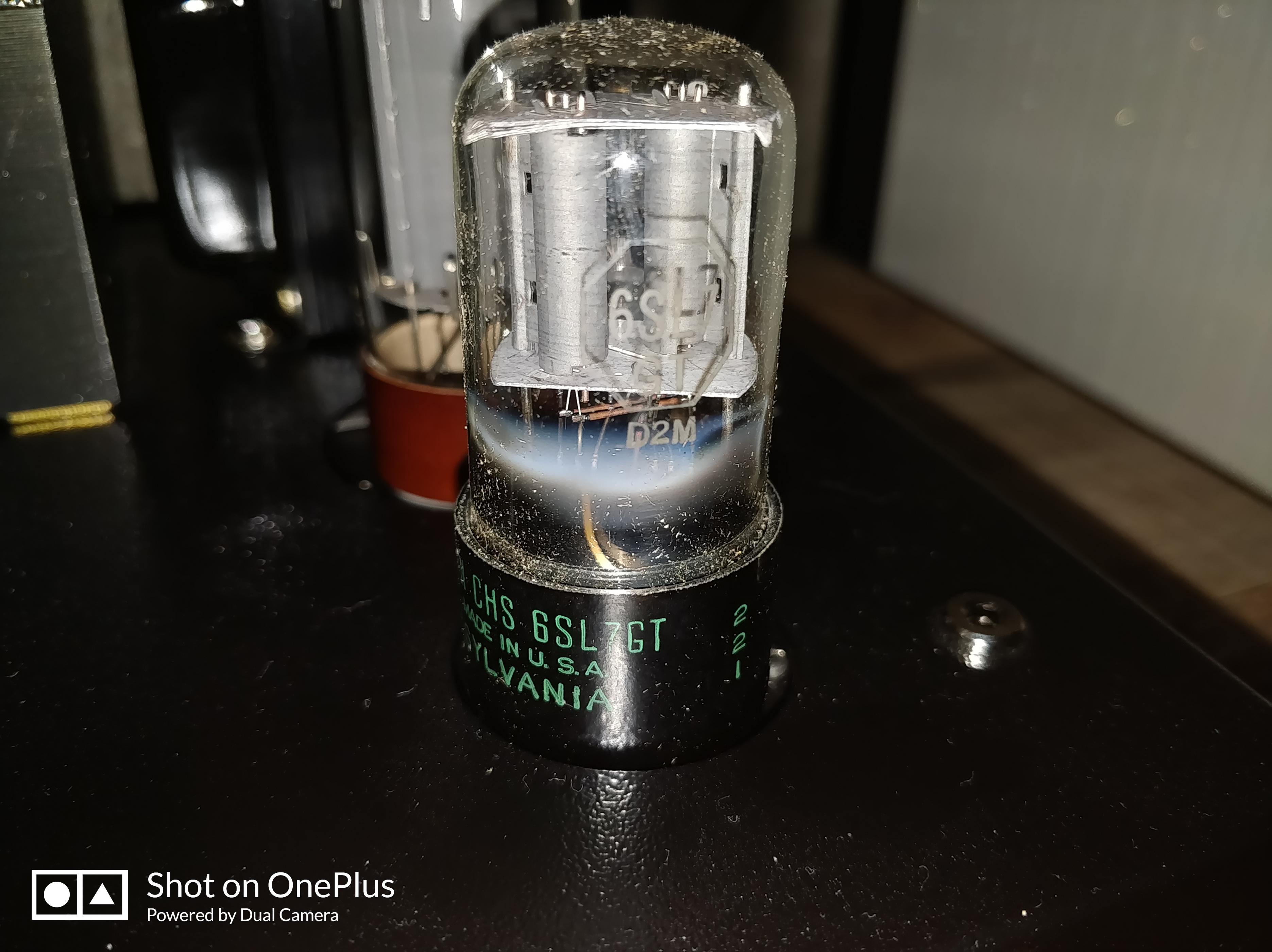

Is it just me or has that Sylvania gone to air. The white getter flash isn't generally a good sign.
Hmmm, haven't noticed that before..
It plays fine, though.

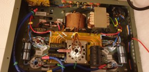

i have just finished my amp this week - albeit not much Chinese stuff gone into it - so far about 20 faultless hrs played - i have posted pics of it here - have you changed yours much from std ??
That's very tidy !! great work.
I ditched the PCB in mine but it's a rats nest next to yours.

if you look on the pcb of my amp just in front of the mains transformer you will see 2 resistors - the grey ones , these are 200k 2w and bleed everything off when powered down - my amp bleeds to 10v in about 15sec - then all is safe to go in there - they bleed off the 3 big caps

you can probably already work out ive changed everything from the original kit on the couplings i went for those big ERO 0.22 polyprop's - tubes im running gold lion kt77 - chatham Jan 5r4wga - and the pre amp tubes are otk russian 6h9c - i had some sylvania in there but so microphonic you couldnt get near them - speakers are klipsch r51 monitors 92db - i have also created the virtual centre tap groundings - all resistors are Amtrans 2w carbon - alps blue pot and better binding posts and input jacks - mine has zero humm , hiss etc - as its new and done about 20hrs now its going on the scope next week at vintagetech as i dont have one -

What's the little terminal strip for?
A bleeder?
I put together something similar in the same spot.
Mine is a bleeder, doubling as a 45v potential divider to elevate the artificial center tap of the tube heaters and an led indicator for high voltage warning.

The pair of 200k bleeders are the grey coloured ones in front of the mains transformer, they bleed off the 3 big caps , very quickly I might add , I might change the value of these ? They are 200k 2w but run bloody hot 🔥, the tag strip is where I made the artificial centre taps for both heater circuits , its the quietest tube amp ive heard in a long time regarding hum n hiss , its going on the scope Wednesday at a technician so I'll have the report on my 2nd built amp
