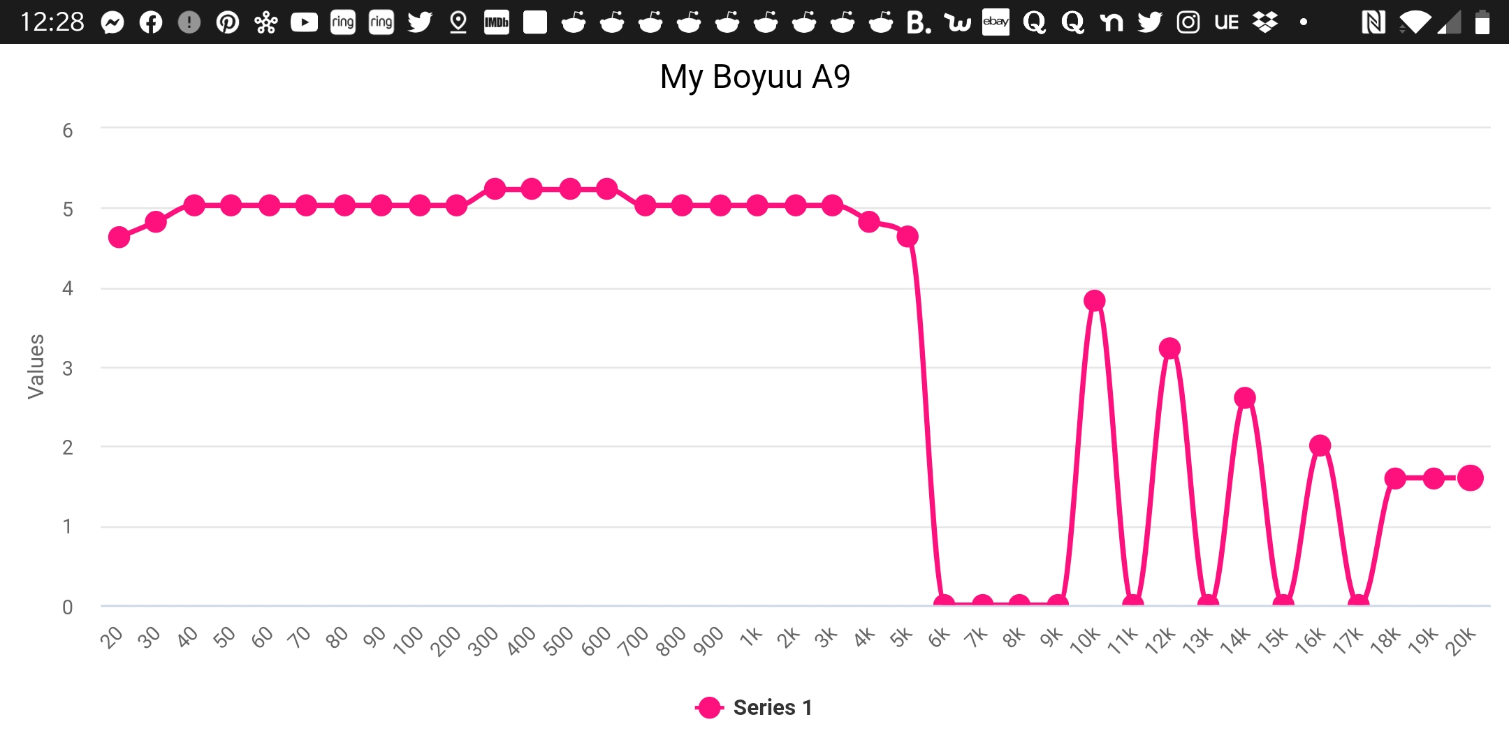

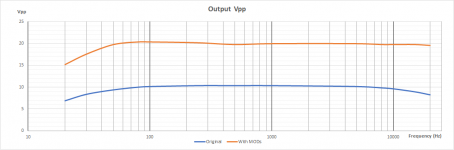

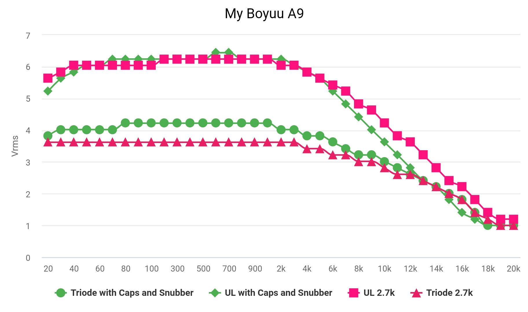

I finally got myself a descent signal generator and set about measuring my amp's frequency response.
It's quite flat up until about 3k, then rolls off towards the highs.
The gaps in the plot are due to I not having measured this frequencies but later decided to expand the scaling to flatten the roughly logarithmic curve.

Tubby23,
Is that graph in Voltage units?
Or, is it in dB?
I seems like the high frequencies are rolling off too much and too soon.
Can you refer me to a Post in this thread that has the exact schematic of your amplifier build please?
Did you use a scope, or a DMM.
Most DMMs roll off at high frequencies.
Terminate your generator with the proper load (50 Ohms, 600 Ohms, etc.).
Then measure just the generator again by itself with your scope or DMM.
What is the result?
Lets solve this apparent problem for you.
Or, is it in dB?
What is the result?

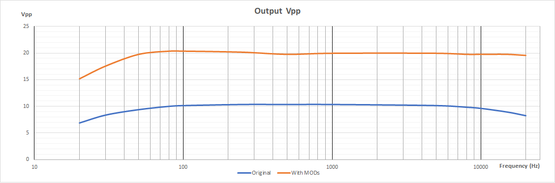

Hi, sorry for the late reply.
It's in volts RMS.
I measured the values manually with one of those cheap little oscilloscope. It has osd readouts like any digital unit, sparing me from counting grid lines. LOL
I've performed further mods since posting this.
The rolloff is due to my cheap OPTs, possibly meant for guitar amps.
I've since introduced global NFB and step networks which have flattened the response curve and also cleared up severe ringing on my square waves.

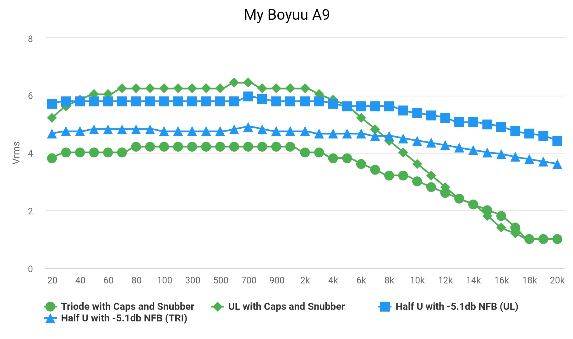

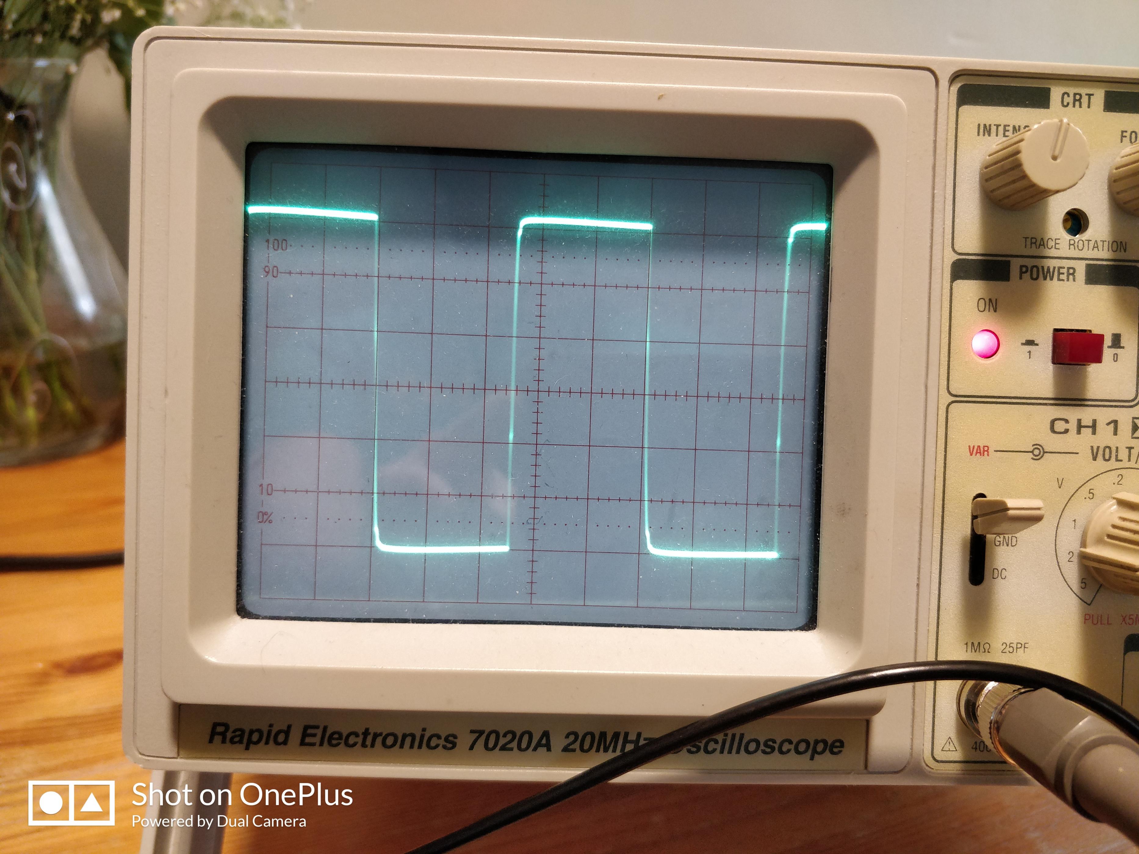

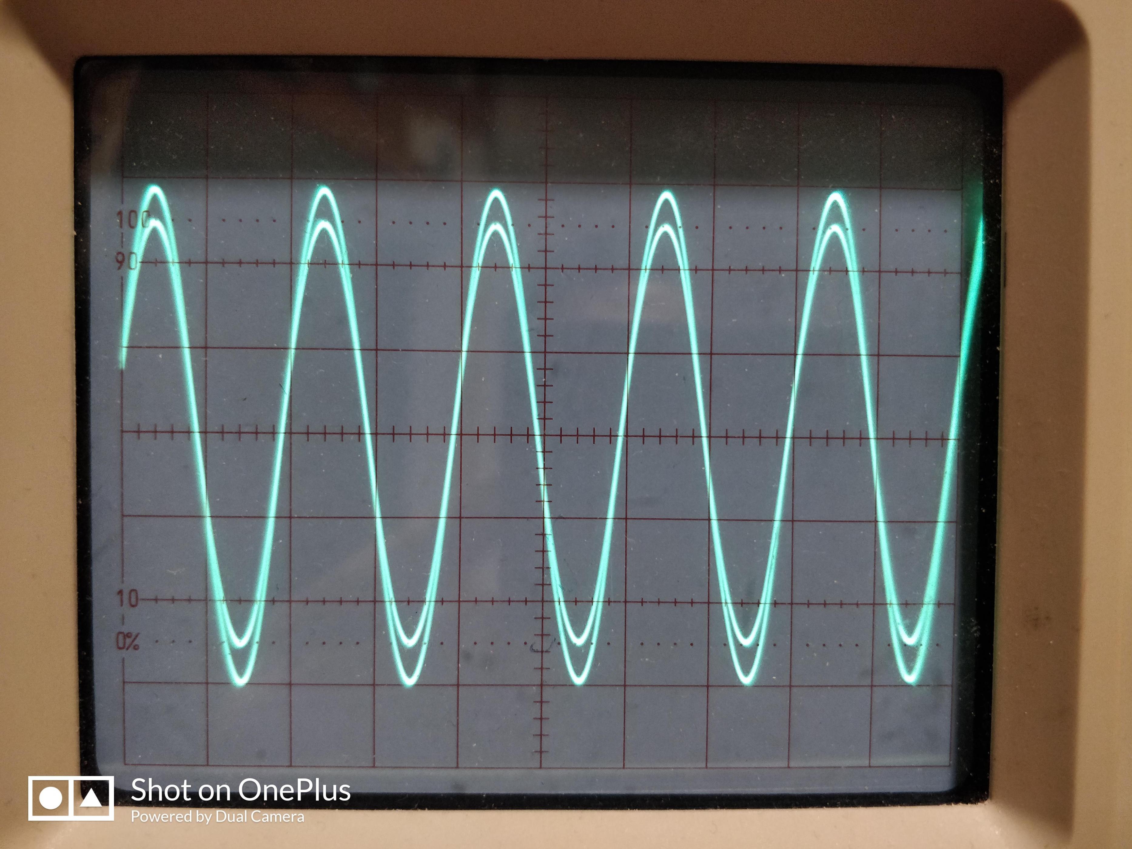

1st pic is the improved frequency response in both UL and Triode modes and heavier GNFB.

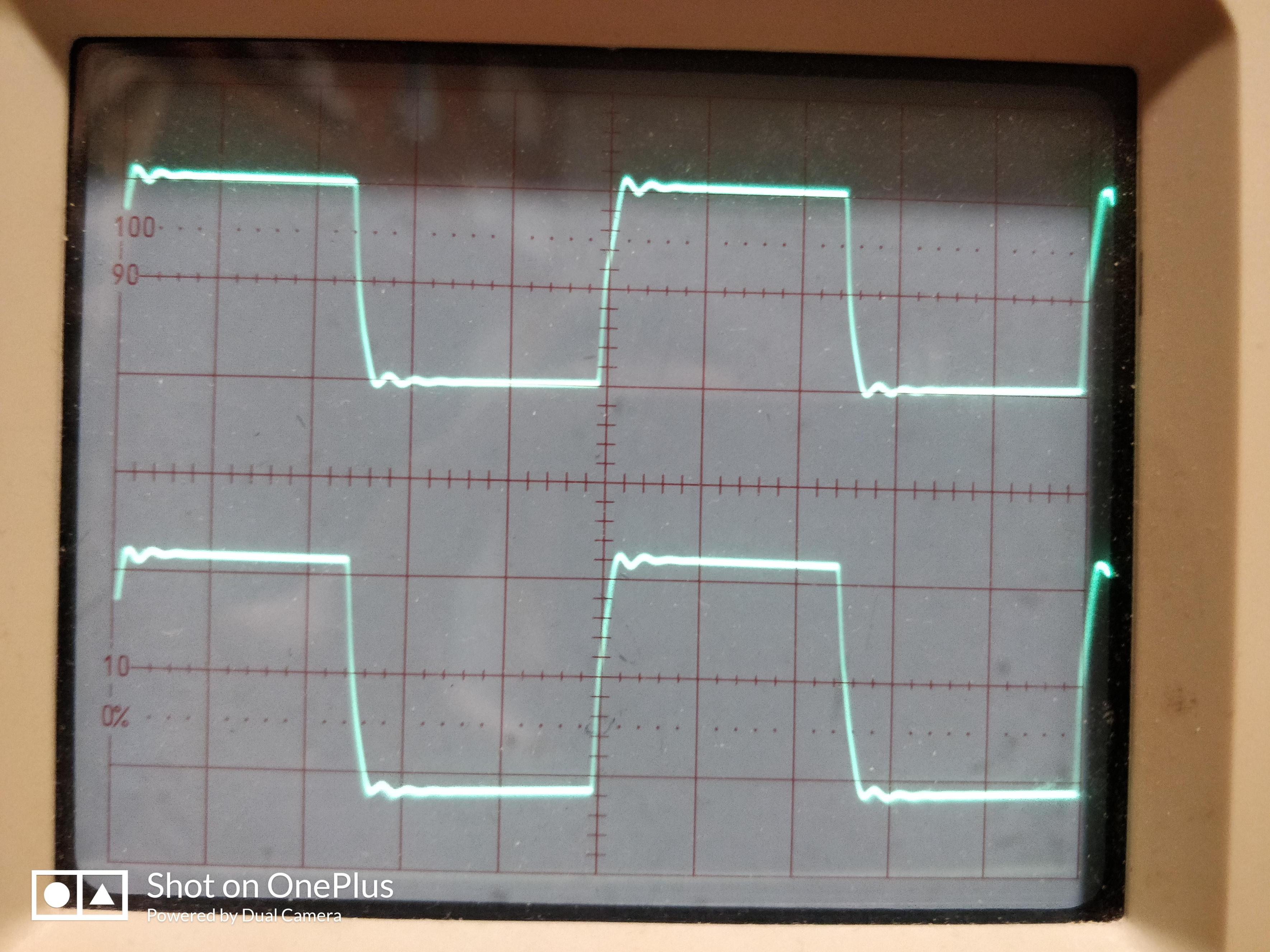

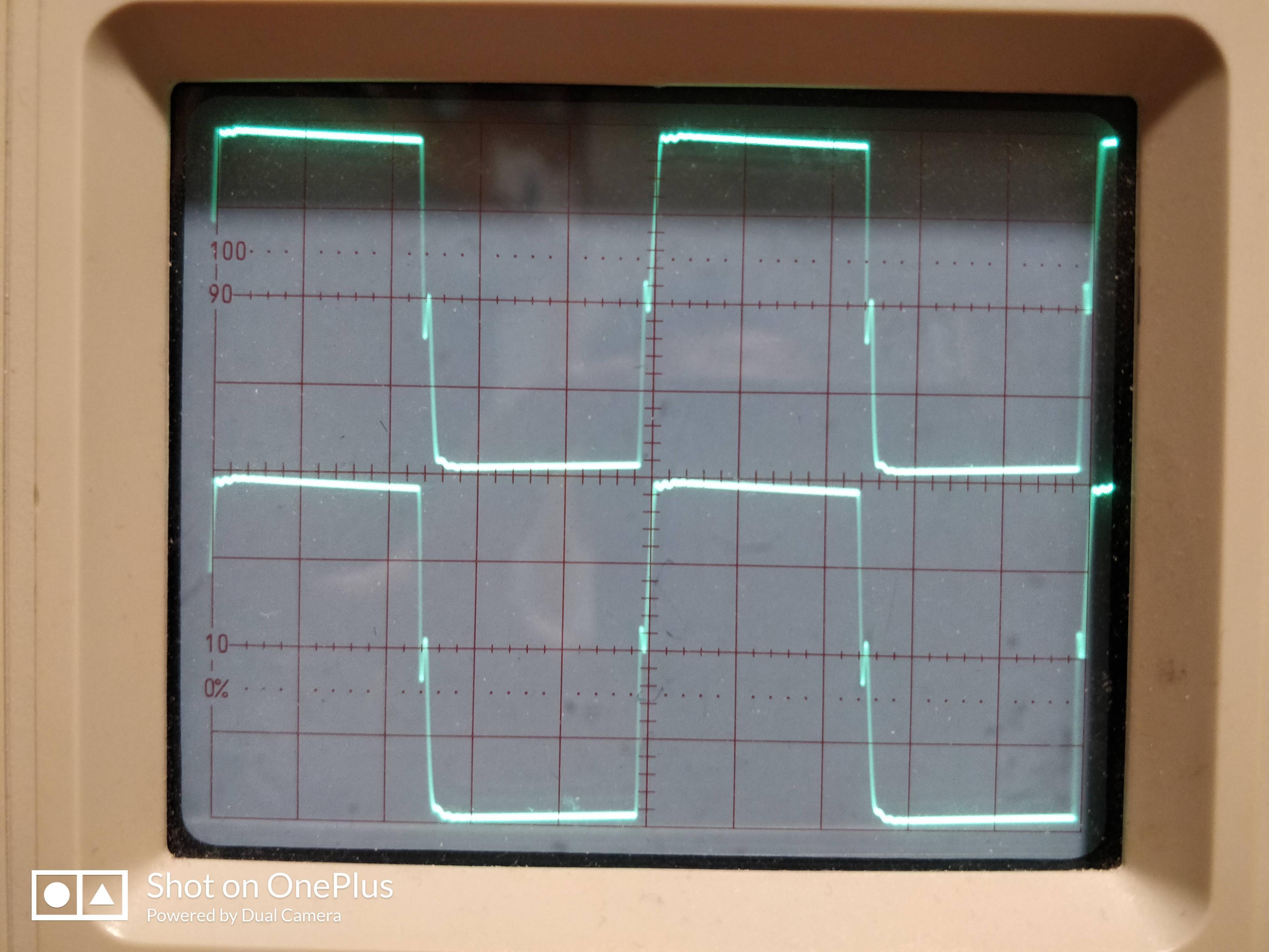

3rd pic is 1khz square wave taken at the 8 ohm tap in triode mode.
4th pic is an issue that developed in that one of the 6SL9's shunted cathodes came undone so the trace shows the difference in output between singular and parallel triodes.
5th pic is 1khz square wave in UL mode.
6th pic is the same before correction by step network and GNFB.

I'm intrigued by this suggestion.
I had no idea that it could be my generator rolling off itself for lack of a proper load.
Despite what my amp's response shows, it sounds fine to me with bright sounding highs - mind, my 50 year old ears are only good up to 13-14khz anyways..
Thanks for the suggestion - I'll try this later today.

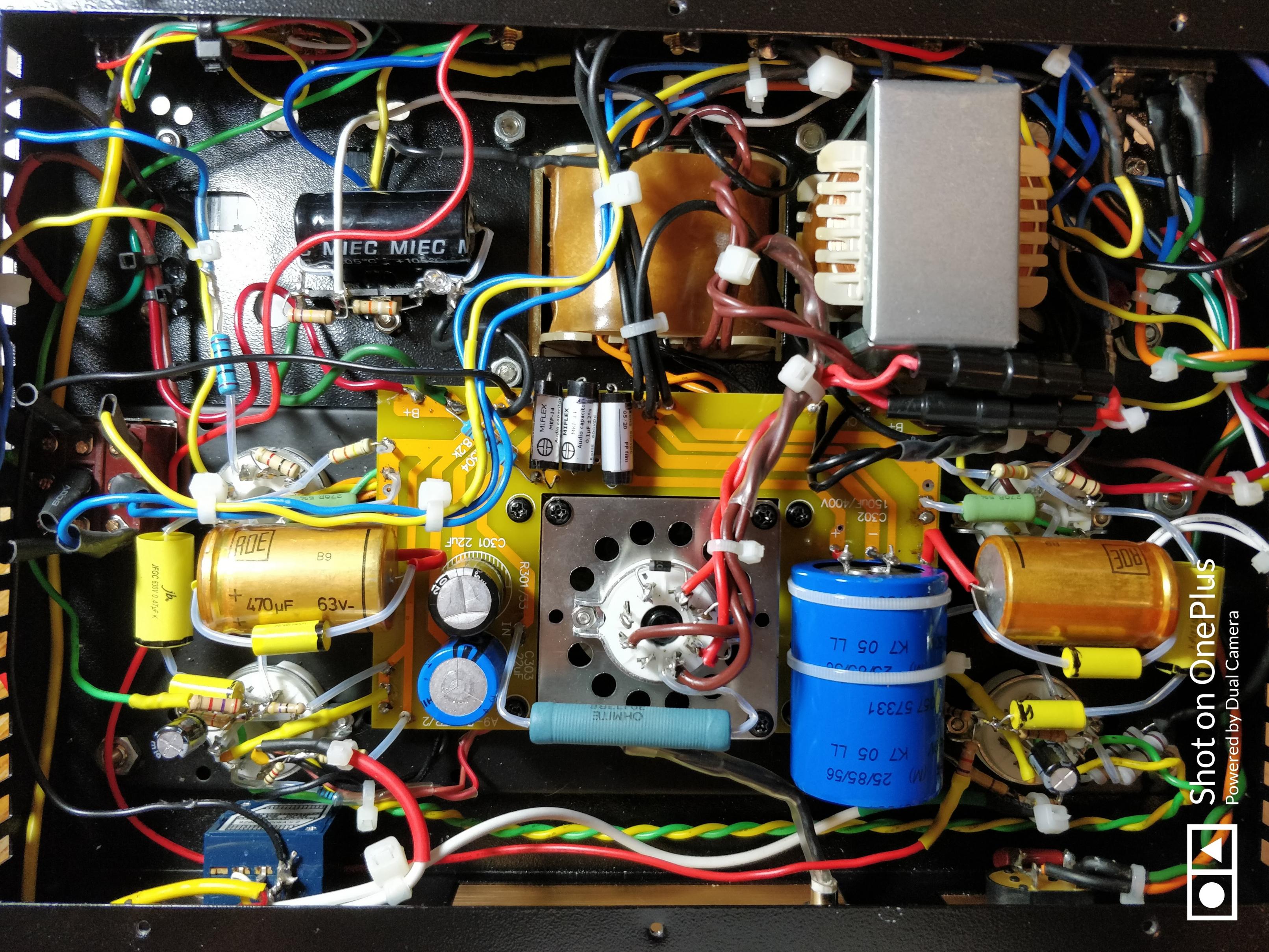

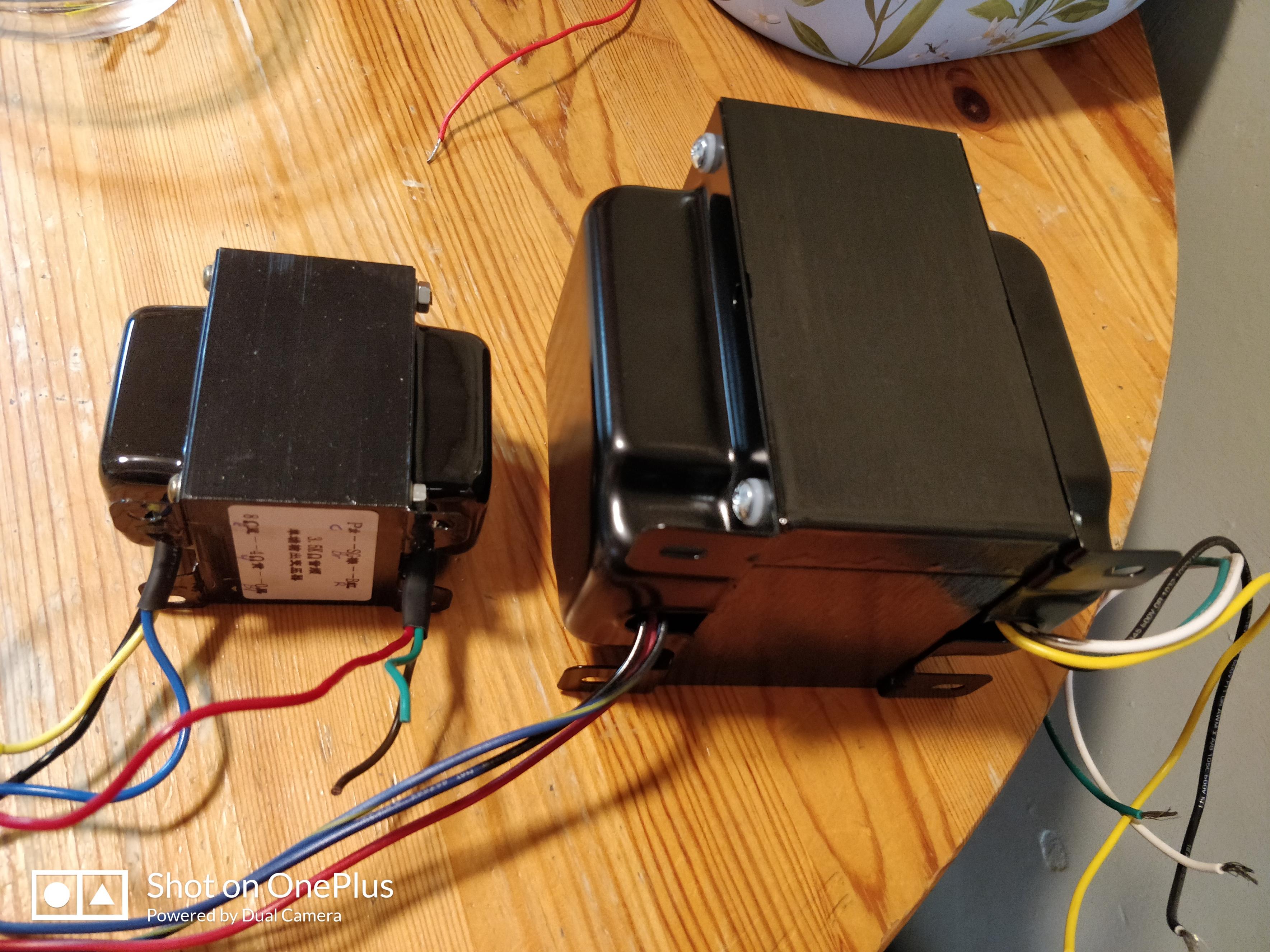

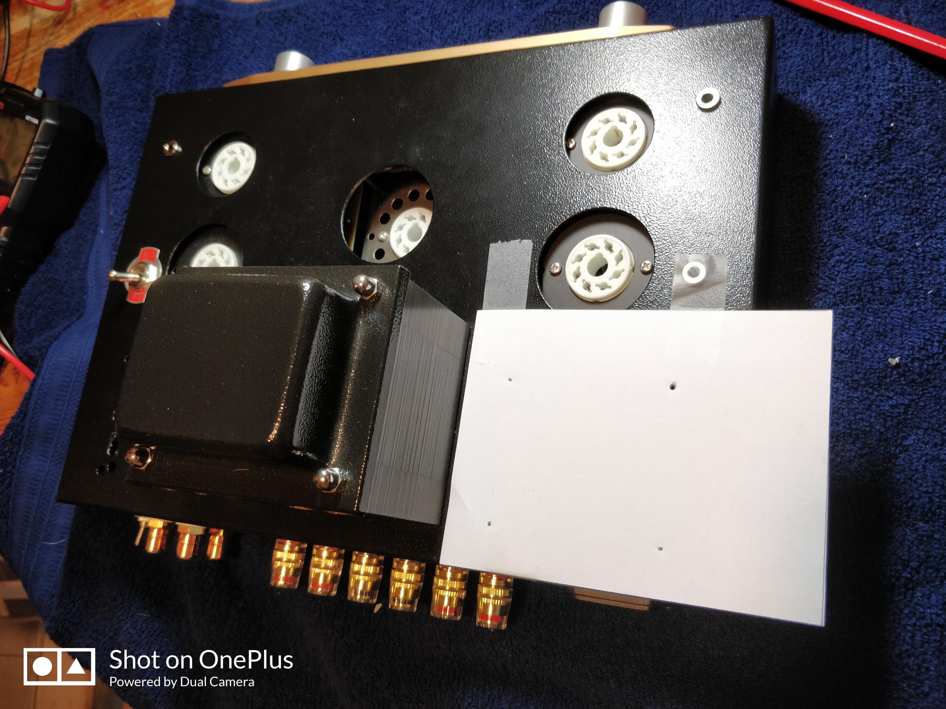

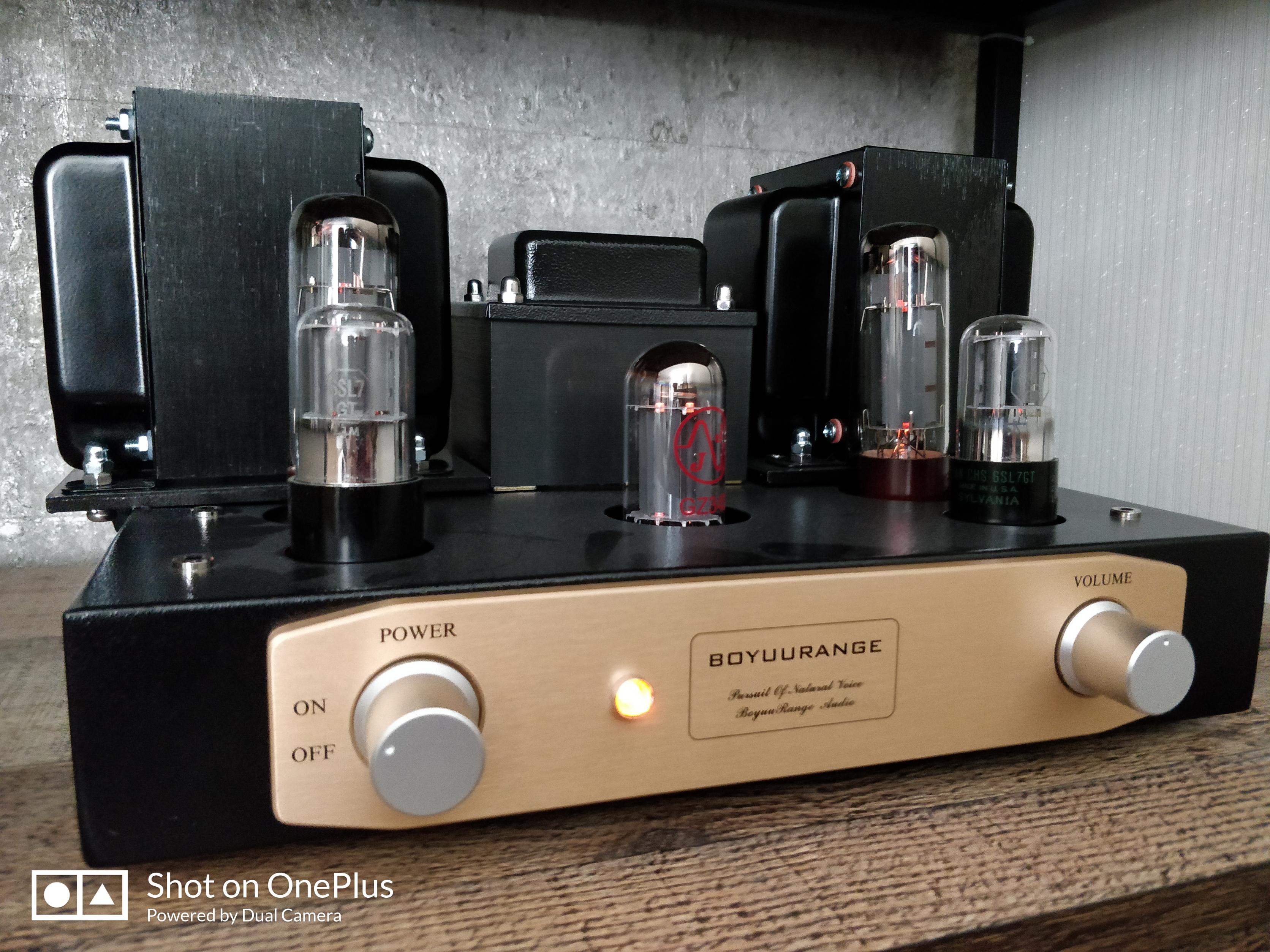

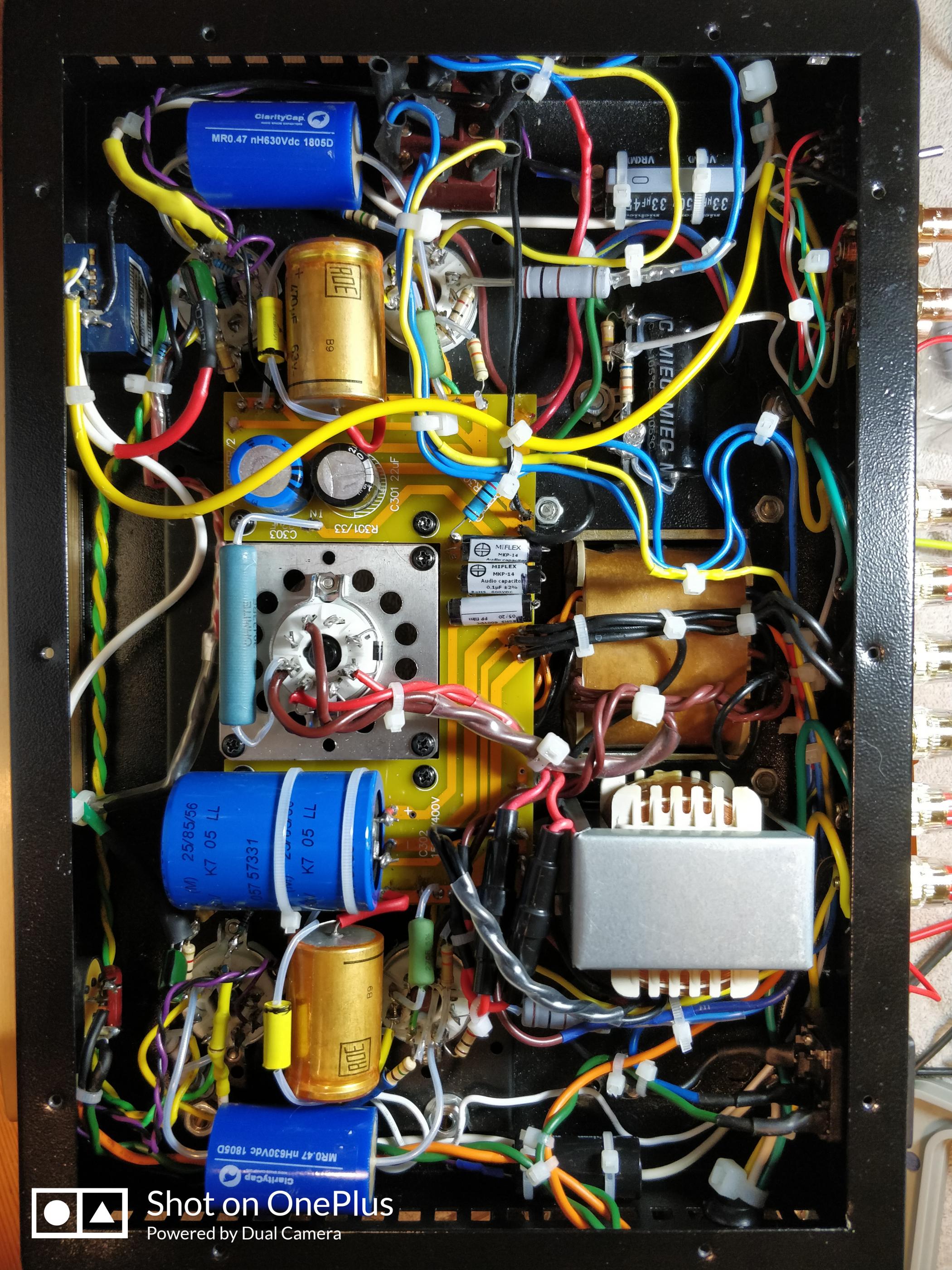

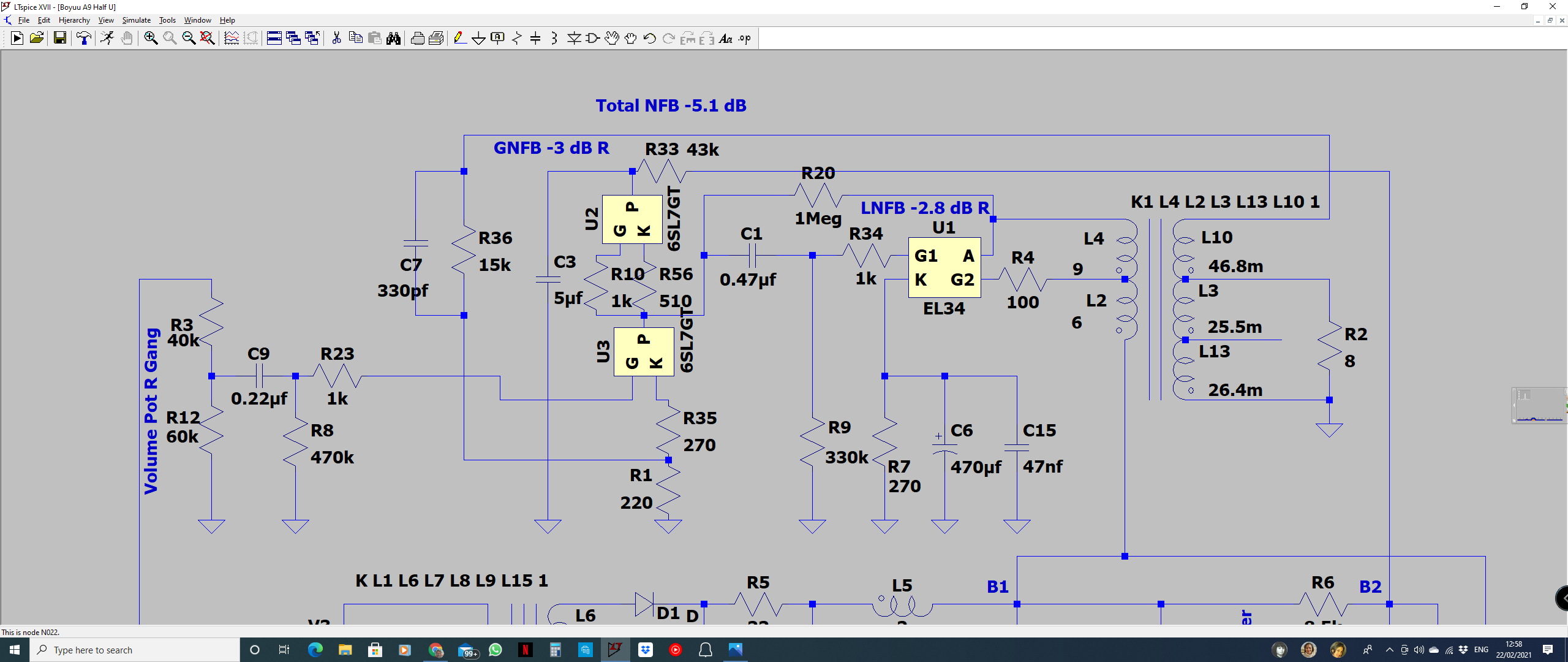

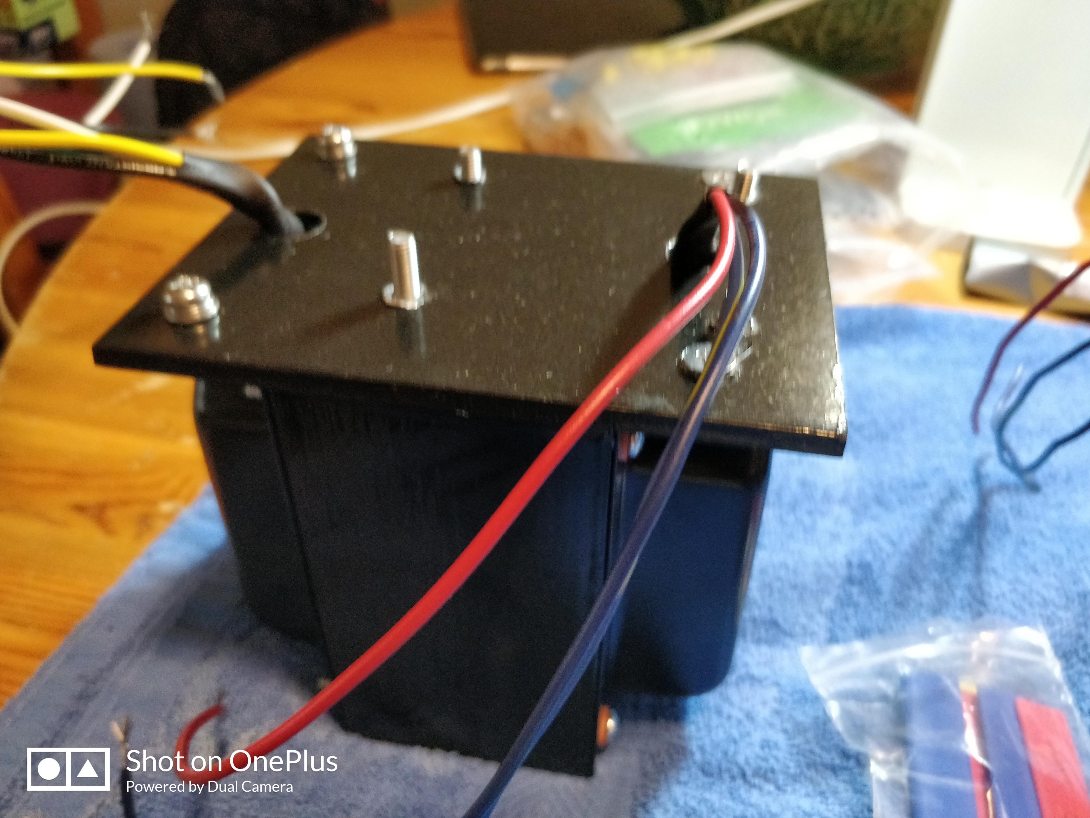

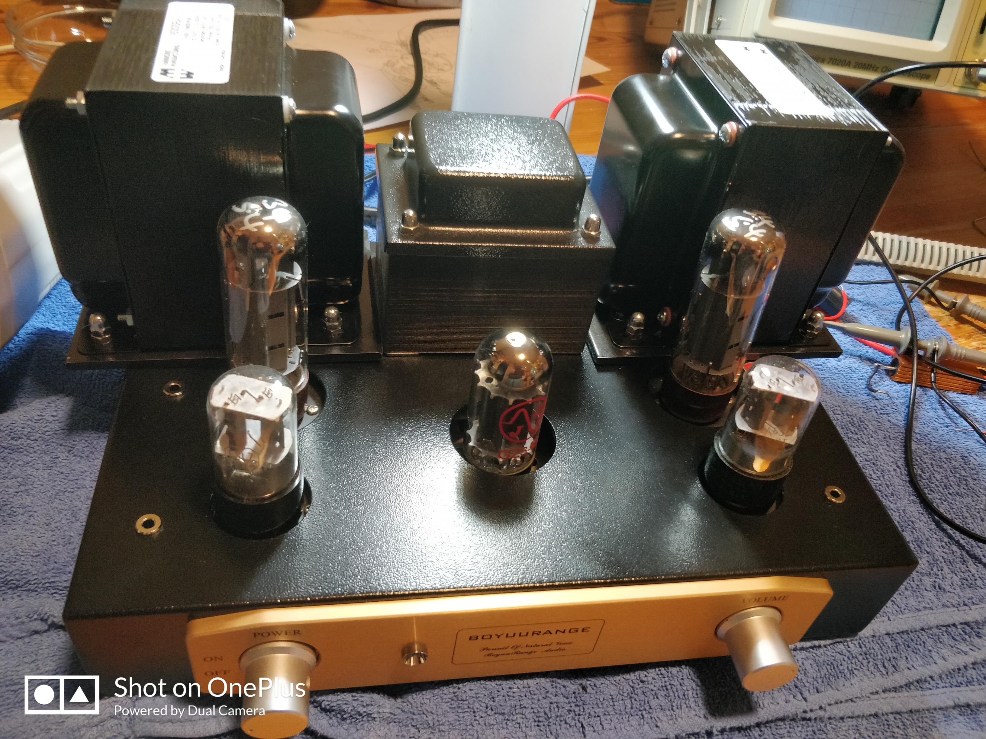

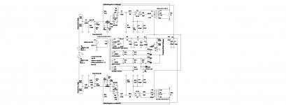

Here's my upgraded Boyuu A9, now with Hammond 1630sea output transformers and a reworked input stage, formerly parallel-tied, now Totempole/Half U as Merlin Blencowe calls it 6SL7s.
The old transformers I previously installed (not the OEM ones) had good bass but unacceptable high end rolloff and ringing. These are in another league.

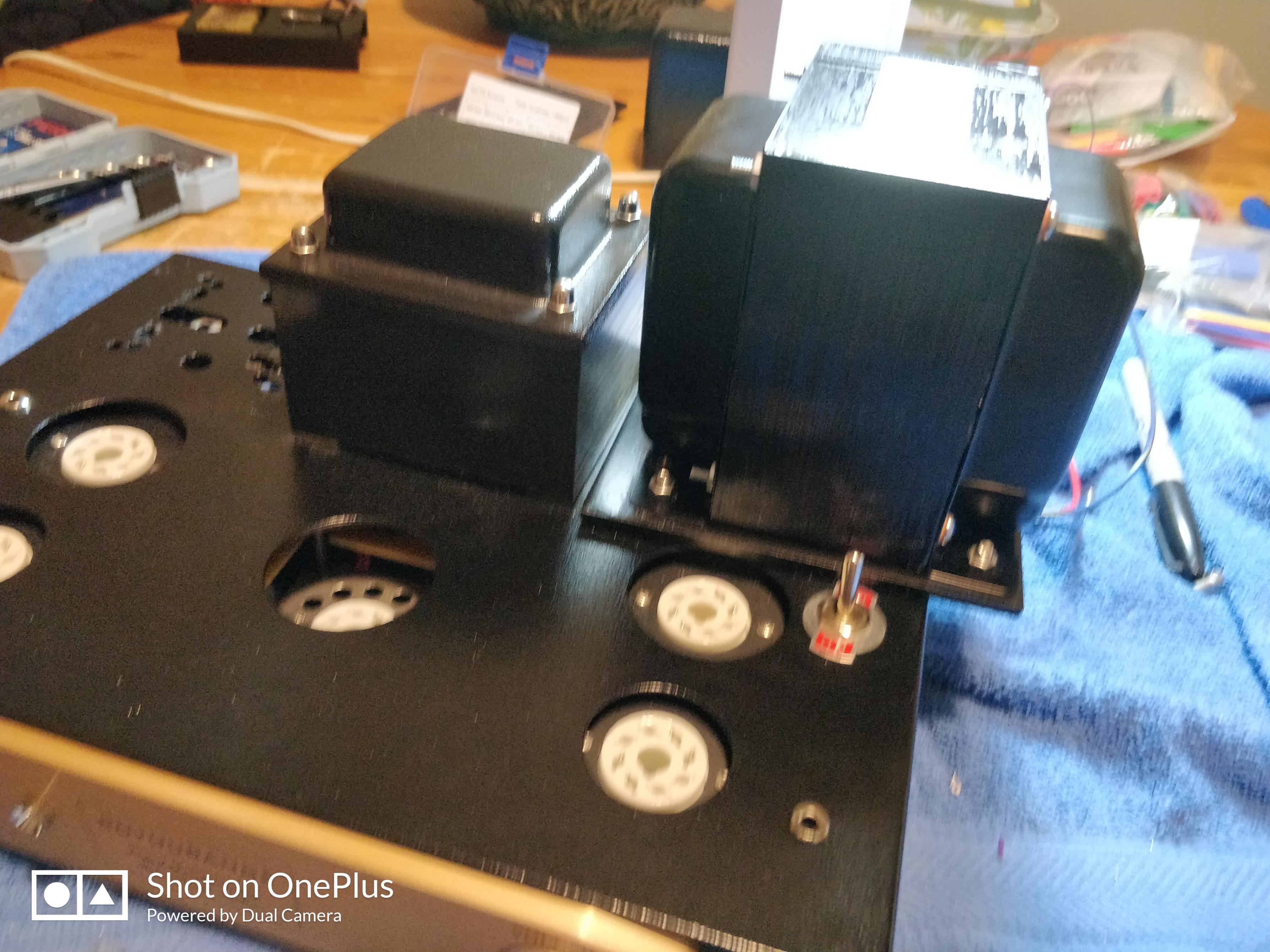

In order to fit these monsters onto this tiny chassis I came up with the idea of using custom-made 100mm x 130mm x 6mm aluminium alloy plates to serve as brackets/shelves.
A nice side effect is because of the lower DC resistance of these, my HT has bumped up a little and my output tubes are now biased at 82% of max dissipation without the need to swap out the cathode resistor.
It has both global NFB (-3Db), tapped off the otherwise unused 16ohm lead and local NFB (-2.8Db) between the input and output plates, totaling at -5.Db. The Totempole input stage is unbypassed.
I was previously using a potential divider feeding 45v into all the heaters' artificial center taps for hum suppression but I had to rejig it for the Totempole because the max heater to cathode voltage permitted on an 6SL7 is 90v and there's now about 125v difference between the two cathodes of each input tube so I set the elevated voltage to about 65v, right in the middle.
Square wave testing reveals perfectly formed squares at 1khz, 2khz,..... up to about 10khz without the need of any step compensation apart from the 330pf cap strapped across the GNFB resistor of 15k setting the high end corner frequency at about 32khz., which I put in the design anyway.
The little amp has been completely transformed.
The previous harsh, guitar amp sound has been replaced by something much more musical and balanced.
Asked
Update:
I changed the input stage from parallel triodes in a bottle to what Merlin Blencowe refers to as the Half U, more commonly known as The Totem Pole Stage because the former is really optimized for low impedance loads while the latter is much more universal due to V2 working as a cathode follower which allows the stage to bias properly with less THD.
Before settling on the Totempole I briefly experimented with an SRPP but it wasn't suited to the high impedance 330k Rload of the power stage.
Changing that to Totempole just involved unsoldering the output coupling caps from the top of V2's cathode and attaching them to it's bottom (V1's anode).

Very nice!! I am going to have to re-draw your schematic. I think you should slap on some walnut side panels on to hide the transformers hanging over. The look would drive me crazy.
Is there any need for the .22uf cap at the input?
Protects the amp against any potential DC coming from the source and also reciprocally protects the source from a shorting input tube.
It also sets the low-end corner frequency to 1.54hz in conjunction with the 470k grid leak resistor.
