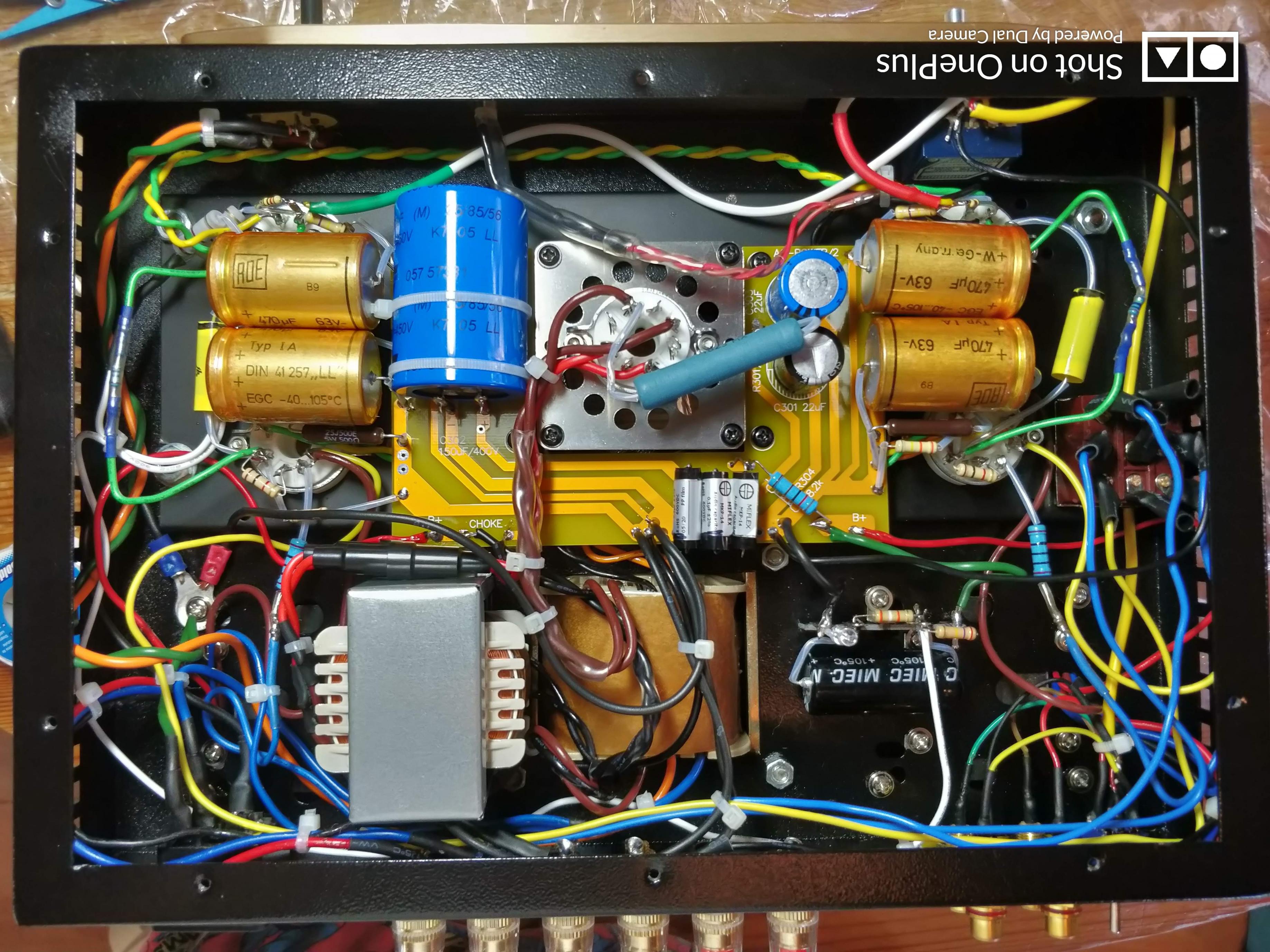

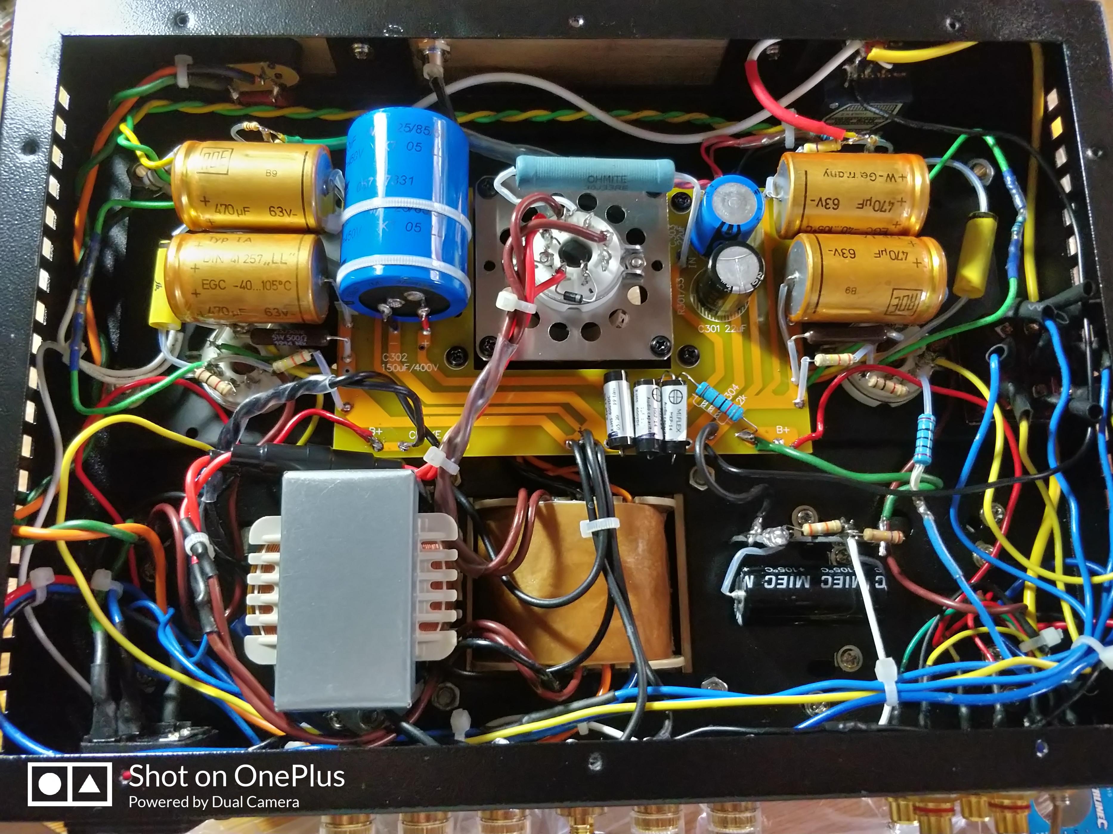

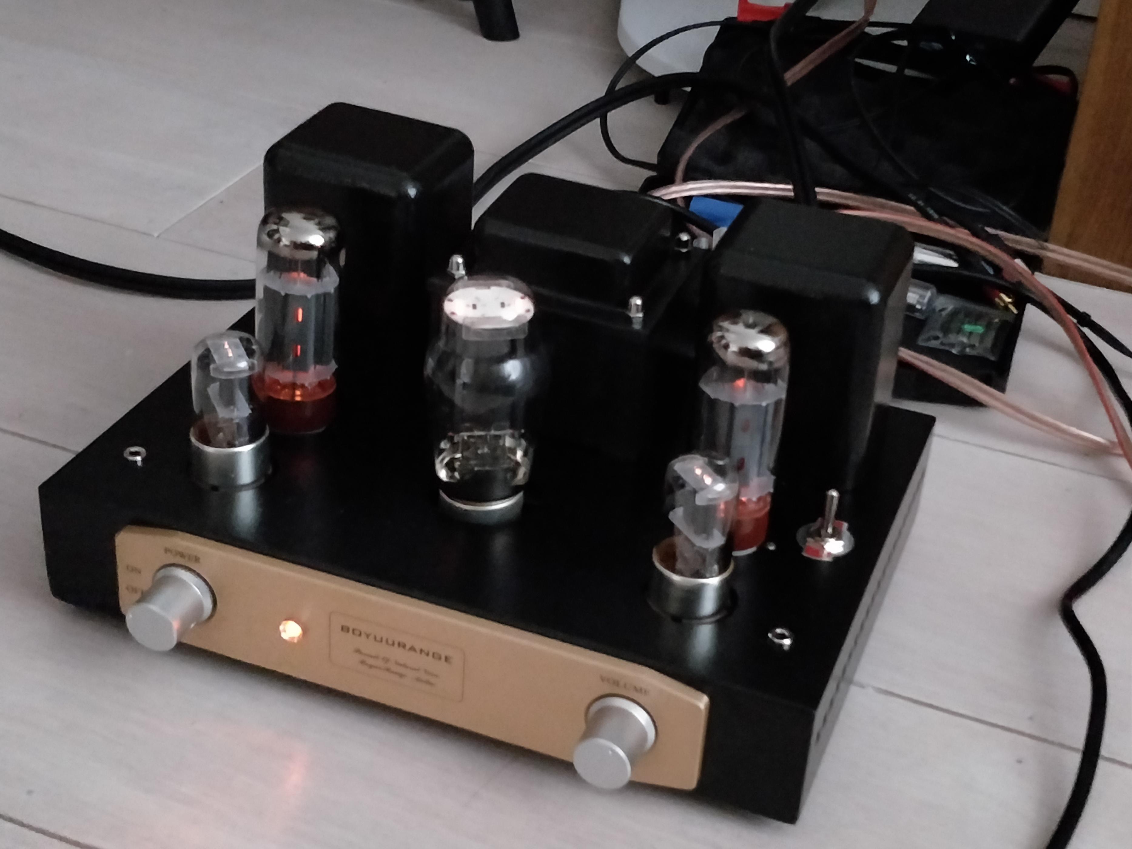

Here's A close-up of my build and how it's comparing to my previously posted design. This was before I noticed the shorting OPTs and began taking it apart again. Notice how i implemented the voltage/potential divider by using a 5 lug terminal tag strip board and securing it with one of the OPT cover fixing screws. The device also doubles as a bleeder with an LED pilot light.

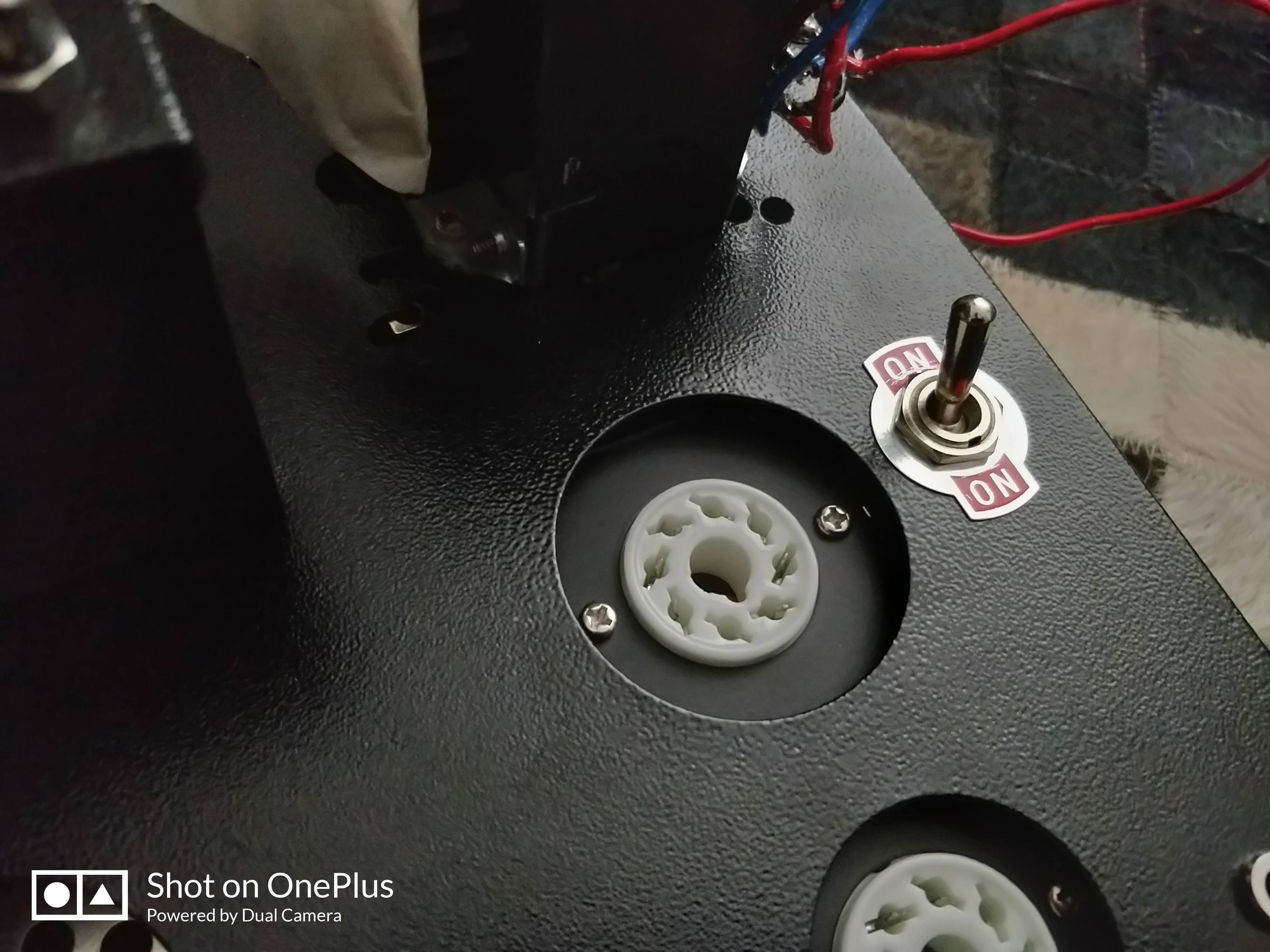

Over to the right, the Ultralinear/Triode switch is visible - its very simple, really.
The screentap from an OPT feeds into the top lug. Out of the middle lug comes the wire that feeds into the screen via a 100R resistor. Into the bottom feeds a direct shunt from the Anode. The switch has 3 gangs but i only used two for left and right. So throwing the switch one way connects the screentap to the screen via the 100R resistor and the other way connects the shunt from the anode to the screen via the same resistor. Simples. I had it connected properly the first time around and there's no reason for the OPTs to have been damaged by this mod.

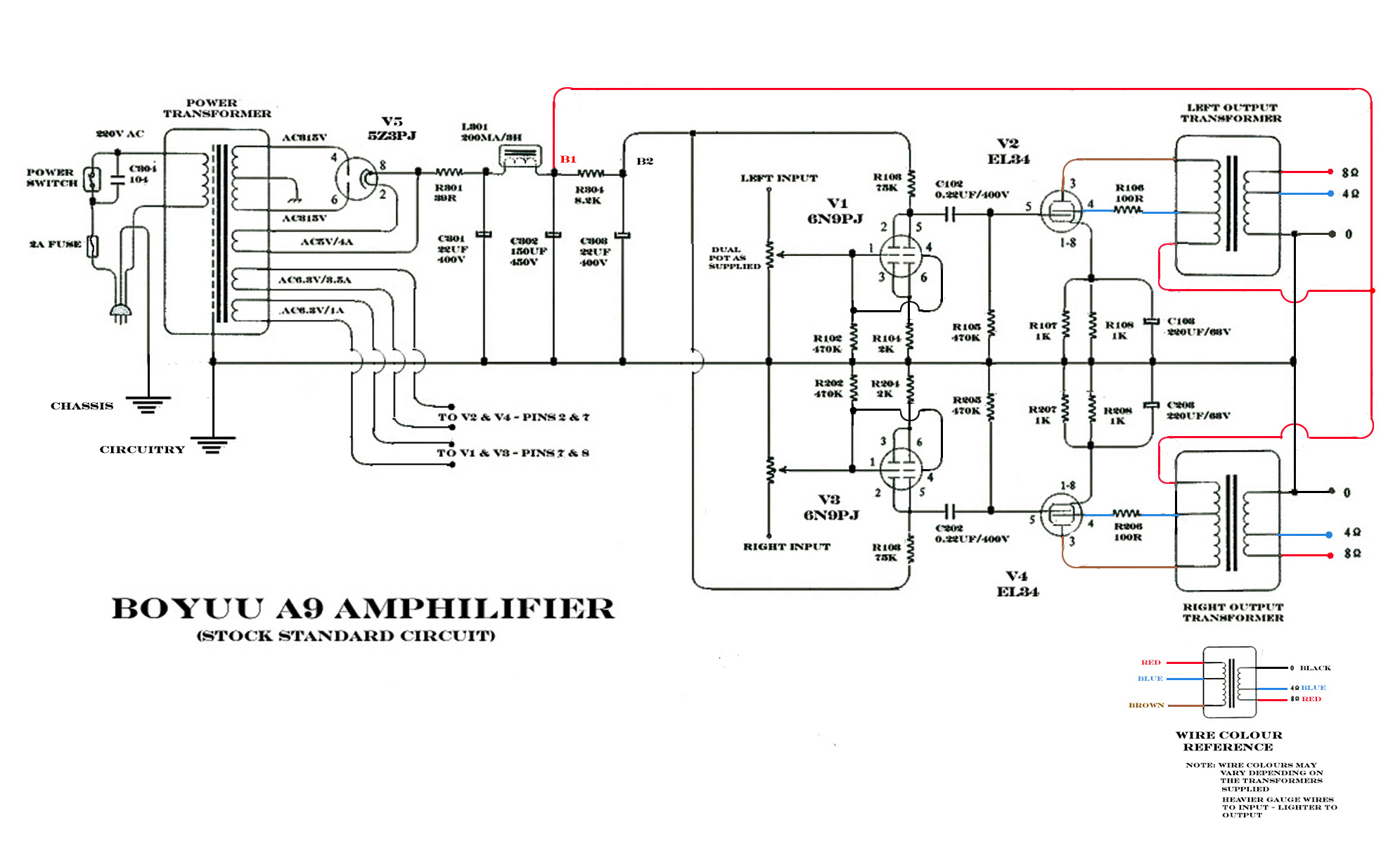

Hi Tubby23,
I would be a bit concerned about this high B+ voltage. I would assume the solid state rectifier (if you are using it ) will give you higher voltage, and normally about 325v (B+) using tube rectifier (325v is higher than others , because I am in Australia and we have 240volt AC)
I would doubt the missing of output transformer could ever cause this high voltage. the transformer and EL34 will consume 15 watt in the way how it biased now. It will not be able to drop that much voltage if you put them back online. This is just my thoughts.

Hi mate.
Both OPTs along with their tubes are offline.
Would that be less concerning?

Hi Tubby23 ,
I have some resistance information for the output transformer that I measured before I built the amp:
the primary: Red-Brown 205 Ohm, secondary: Red-Blue 0.3 ohm/2.72mh, Blue-Black 0.7 ohm /3.22mh
my power transformer output 337v without any load, 325v with everything powered.
For the high B+ of 390 volt, I would be a bit worried about the filter caps, some of these only marked as 400 volt. And you will need to increase the R103/203 for 6N9P to lower the plate voltage for that stage.
high B+ probably will not harm too much to EL34, in your case , you will almost have a plate voltage about 375 volt, and about 60mA plate current, your Amp will be biased at 90% max dissipation ,which is recommended for class A. You will have very warm sound, unfortunately my Amp only biased at 60%, too hard to achieve 90%

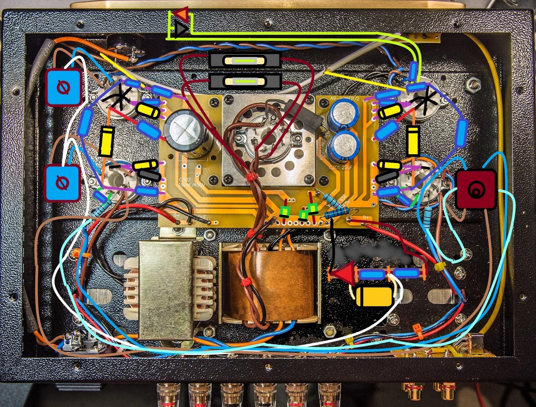

A9 Schematic - Corrected
Thanks for your observation. I have corrected that missed point and other points raised by others and attach my latest schematic.
The lower 6N9P should be rotated 180 degrees (to being upside-down).
Pins 2 and 5 are the plates; pins 3 and 6 are the cathodes.

Hi Daniellu.
I got it working!

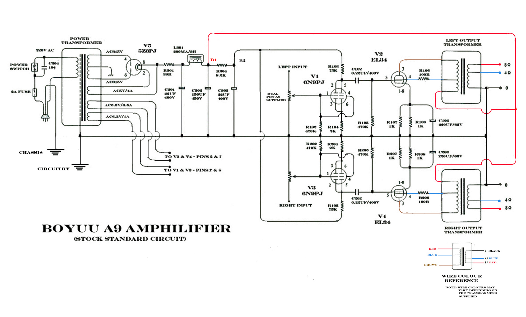

Turns out I had swapped the OPTs primary red and blue wires around! LOL. My bad for not measuring their resistance before.
But I assumed that the thicker wires were the outputs...
For the primaries I got 208R between red and brown. 111R between brown and blue. 97R between blue and red.
The secondaries were 0.8R red/black. 0.4 blue/black.
With everything connected, B+ is 336V and my potential divider for the elevated heater voltage is putting out 45V as I designed.
It's all working great now!
Got it working!
I assumed that the thicker opt wires were the outputs!
Corrected that and am getting 336v on B+ and it's working grand.

Great to hear that you found your problem and got it going. With this problem in mind I have included a note on my schematicGot it working!
