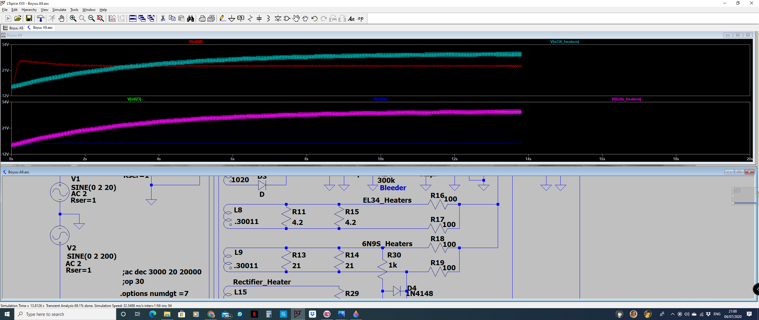

My Future Build - Revised

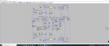

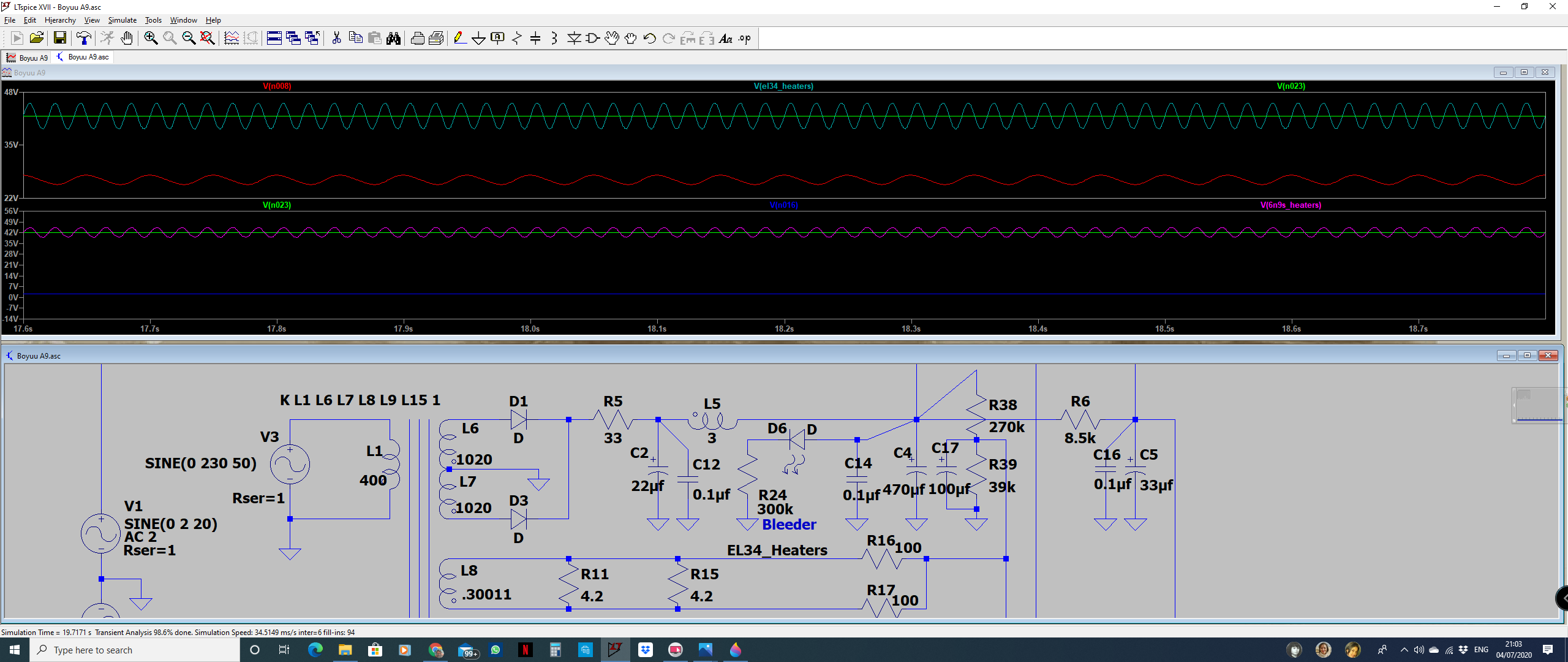

So after taking into consideration TG's comments and recommendations, here's my revised project modeled in LTspice almost in it's entirety. I still haven't received my A9 yet.
1) I'm keeping the Humpots! 😀
2) Discarded the plan of tapping into the tubes' cathodes in order to elevate the heater circuit - instead I've added a potential divider across B+ and ground, raising the heaters by about 42V. This feeds into the humpots' wiper and the ends are attached to the valves' heater pins. One pot for the preamp and one for the power tubes. In the pics attached I ran my model in spice and it shows the heaters on both the 6N9S and EL34 42V well clear of their cathode voltages while well away from the 100V Vhk maximum of the 6N9Ss.
Don't know the EL34's but I assume its probably more than that or the same at the very least. Anyways, the model's running fine.
I've included an ASC file of my model that you can run or modify in Spice to your heart's content - I did the work so you don't have to! LOL
You might have to install valve/tube models in your copy beforehand, though.
3) I've abandoned my plans on adding 10nf caps alongside the 470uf electrolytic bypass caps on cathodes.
4) Transformer HT leads will now be fused by 2A slow-blows.
5) I'll leave the 0.1uf caps on the power rail as they're easy to implement - I mean there's holes in the board especially for them and I see small caps alongside large ones on power supplies all over youtube - so it must be good! 😀
Right - that' it for now.

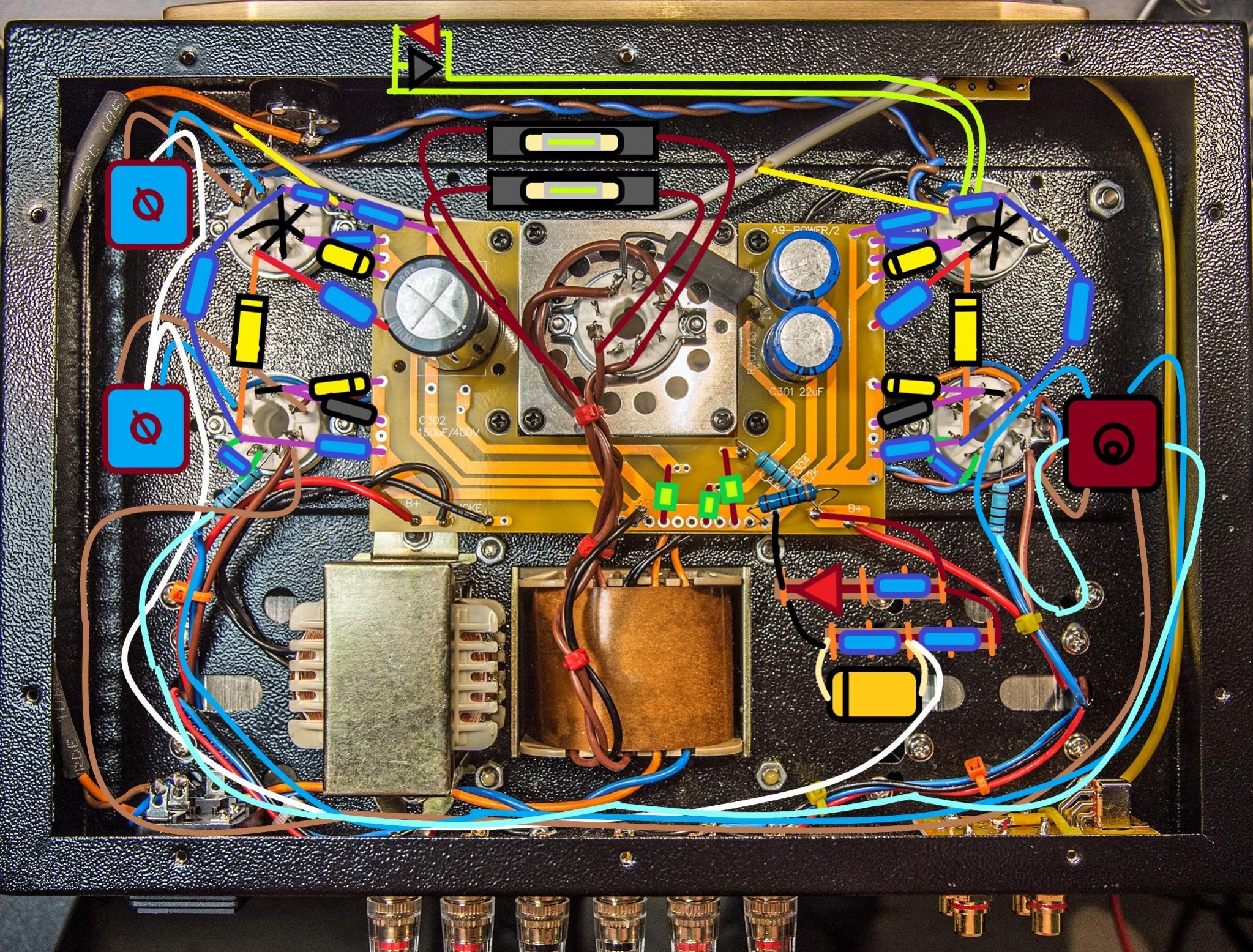

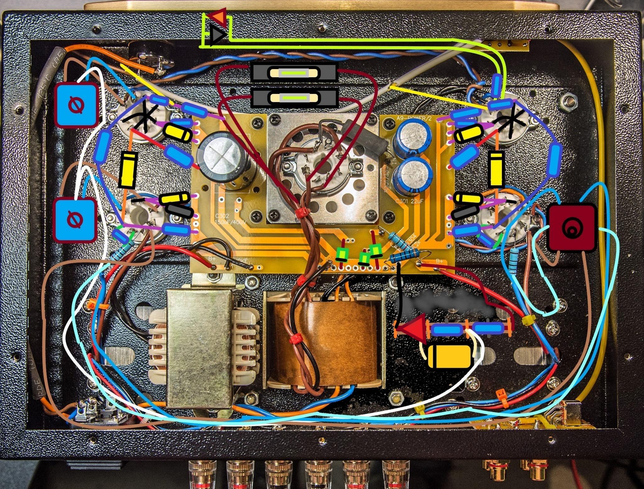

And here's what my mods are going to look like.
Notice, I intent to install the humpots and pseudo triode/ultra linear switch into the holes reserved for the optional tube cage.
Whoops! Just noticed I painted the coupling caps on backwards!
Whilst these aren't polarized there's benefit to determining which side the outer jacket is one and placing that side on the lower impedance side - such as towards ground and as in this case, towards the anode of the proceeding stage.
Here's the picture corrected:

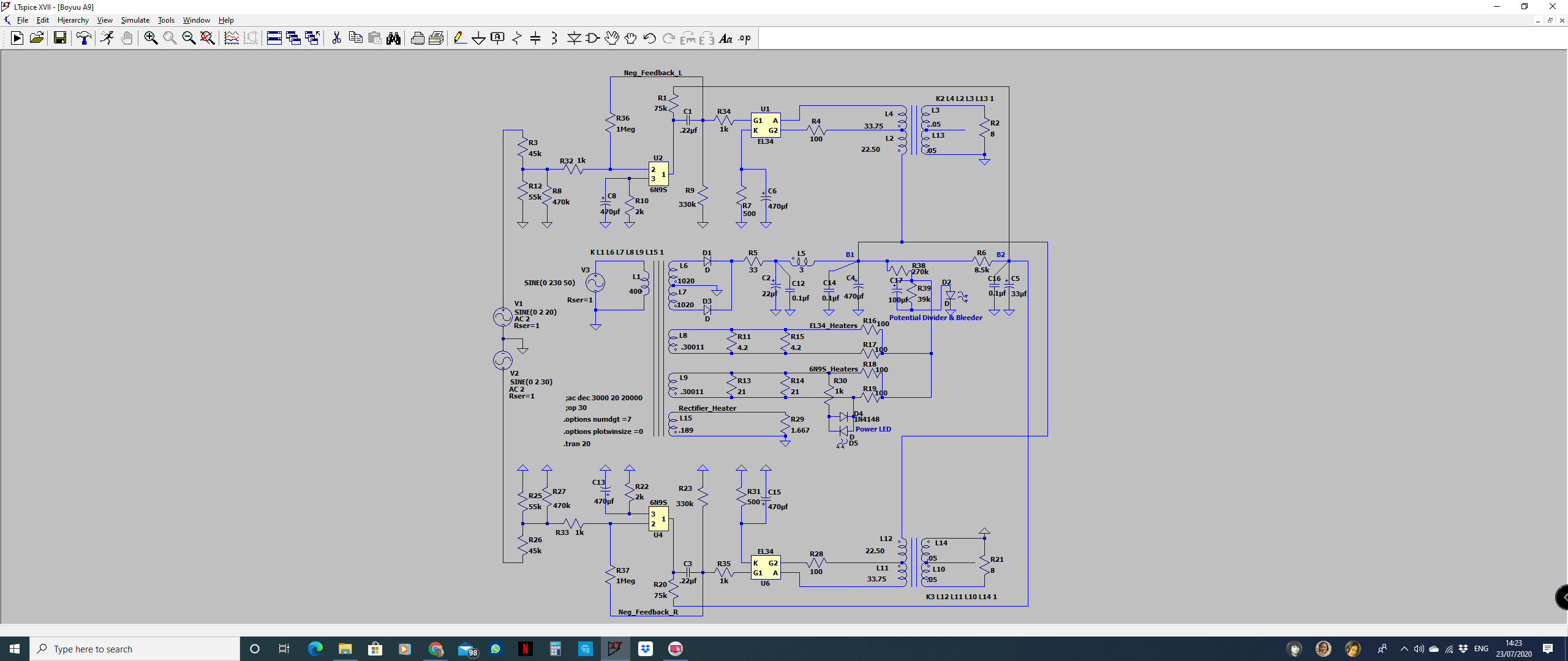

My Future Build - Latest Revision
My kit has finally arrived and I'll start on it this weekend!

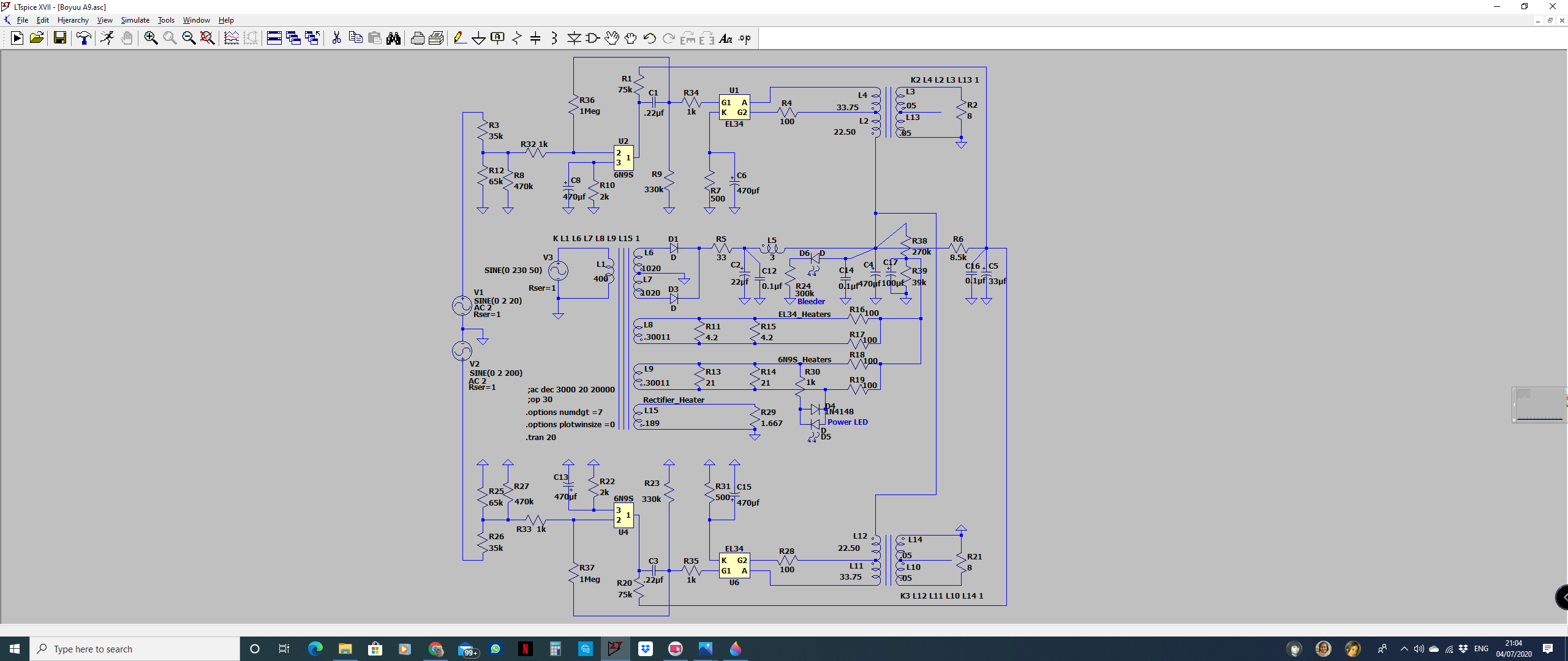

For my latest and, I think, final revision I combined the potential divider (for heater elevation) and bleeder with indicator LED into one unit since I was using a 300k bleeder resistor for the LED and, as luck would have it, the two resistors for the potential divider are 270k and 39k so I just stuck the LED at the bottom. Happy days!

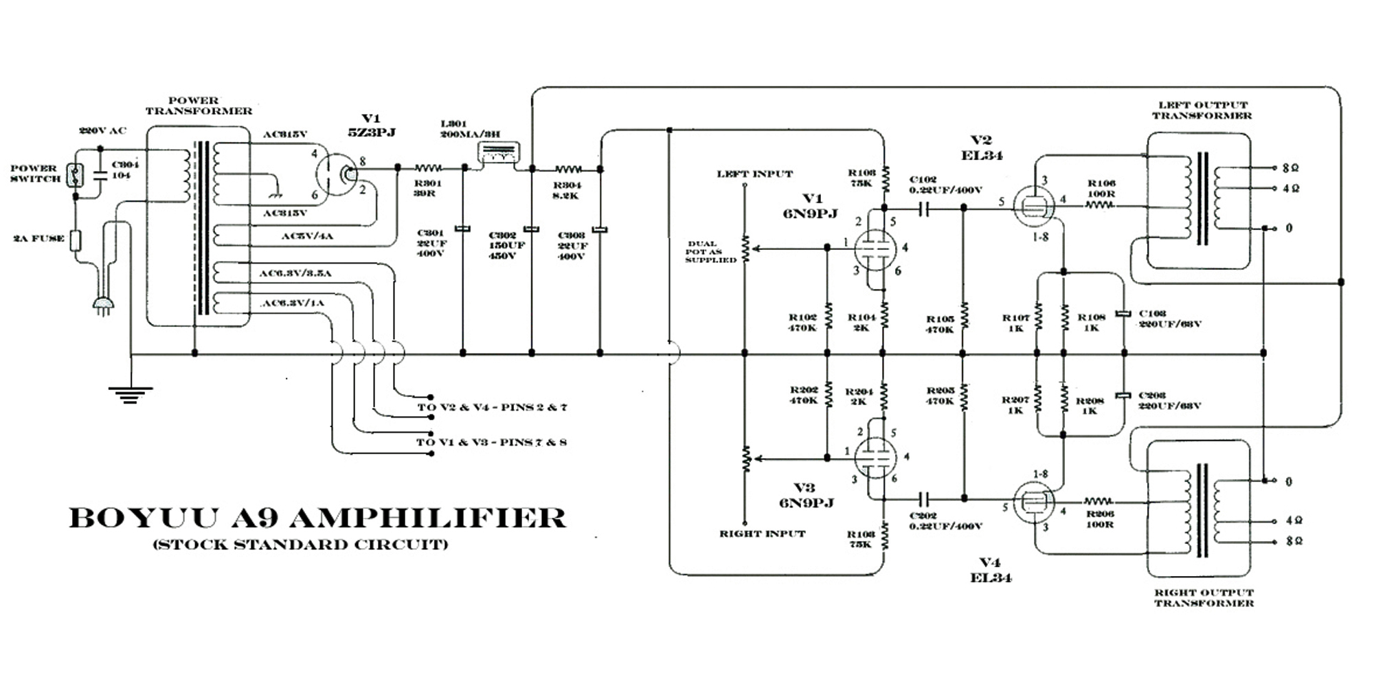

Schematic - May be helpful to newbies
Most likely at the wrong end of the forum but as the title says it maybe helpful. I tried many different free circuit drawing programs but ended up using just Photoshop Elements and juggling copies of the original sent with my kit. Hope it helps someone.
Hello DIYBobbie, i like well, it's well thinked but i don't see the link of pins 1 to 4 of V1 and V3. This link is it necessary into the schematic and into the build of amplifier.
Hi Learn.Hello DIYBobbie, i like well, it's well thinked but i don't see the link of pins 1 to 4 of V1 and V3. This link is it necessary into the schematic and into the build of amplifier.
Interesting that you mention that. I initially linked 1 & 4 on my build and I found that linking these pins actually caused problems. I can't recall just what the problems were now but my unit works well without linking 1 to 4
Maybe someone could enlighten me on why I had problems.

A couple of small details changed on the schematic posted previously. Please disregard that schematic and refer to this new one---Most likely at the wrong end of the forum but as the title says it maybe helpful. I tried many different free circuit drawing programs but ended up using just Photoshop Elements and juggling copies of the original sent with my kit. Hope it helps someone.

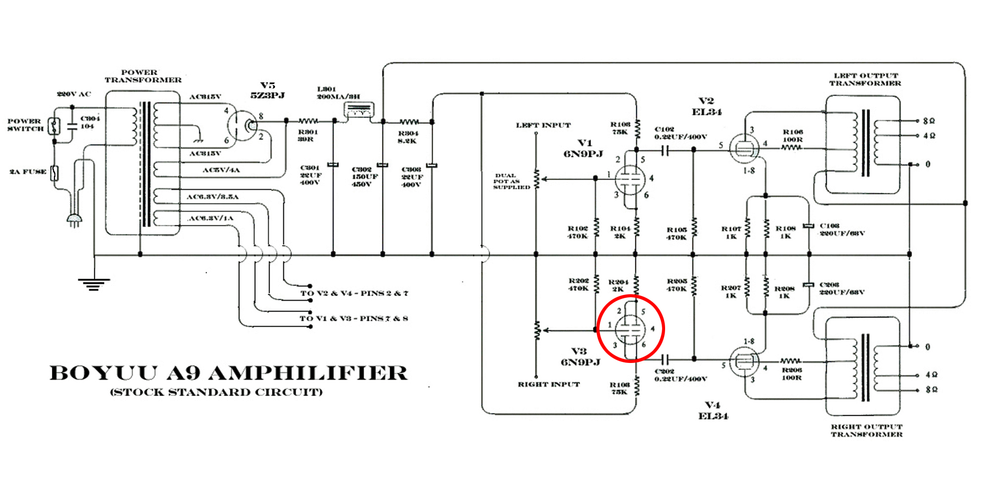

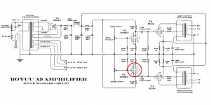

The lower 6N9P should be rotated 180 degrees (to being upside-down).
Pins 2 and 5 are the plates; pins 3 and 6 are the cathodes.
Correction needed
Yes you are right. A point overlooked. I will correct this in a revised post that I am working on shortly.
Thanks for your observation.

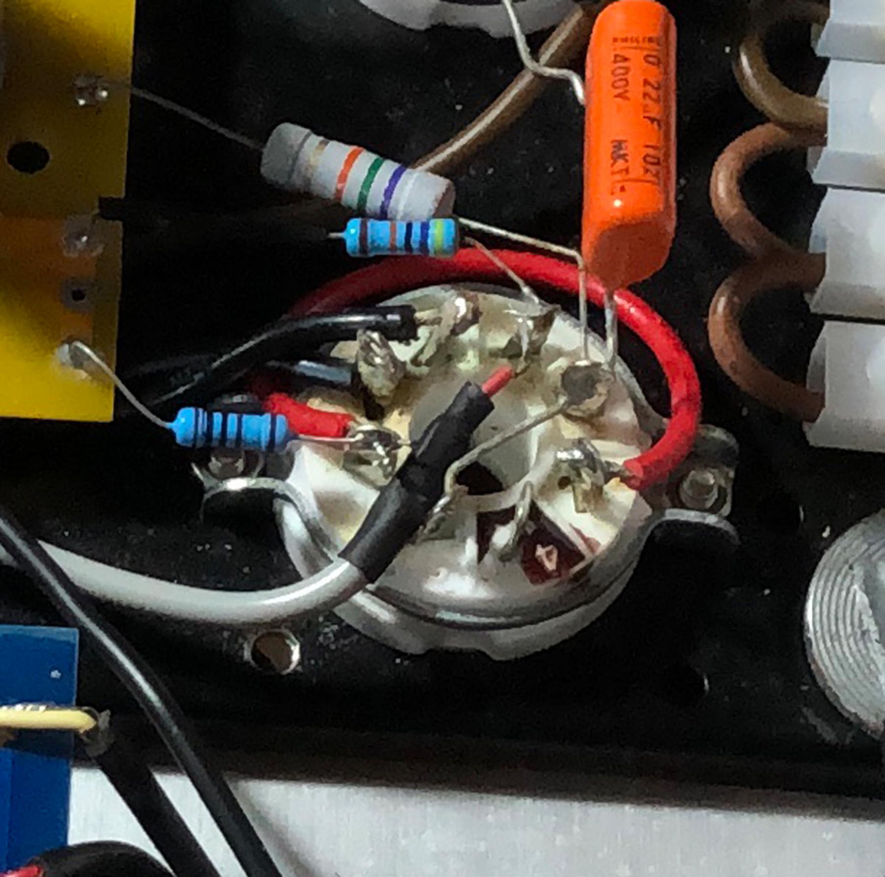

I finally built my A9, went to test it..
The heaters came on but there was no voltage across the rails. First tried with my 60w dim bulb tester which flared up then self down.
Pin 4 on the input tube appears to be disconnected.
How many schematics will repeat this error?
Most people do not read all the way through over 1000 posts.
Use separate grid stopper resistors on the input tube.
Of course, many of those amplifiers are on PCBs.
The question is, is pin 4 connected?
For those who build their own amp point to point from scratch, if they build according to the schematic, the triode with the floating grid will spoil the performance.

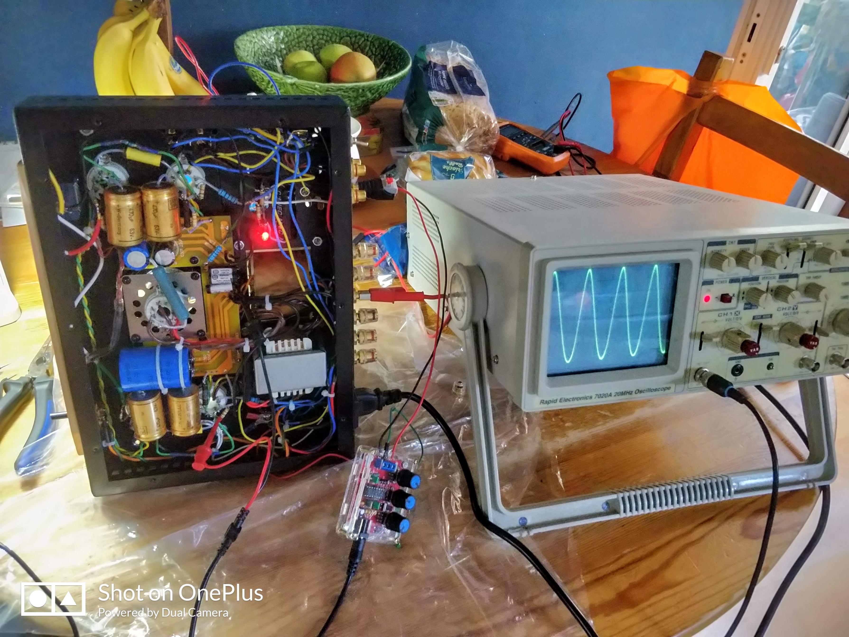

My Build Update
So, I disconnected the OPTs from B+.
Put the oscilloscope to the outputs of the coupling capacitors and, despite there being some distortion from the high voltage (395v @ B+), everything seems fine. The voltage was high because of the missing OPTs just as it was virtually non-existent two days ago because of the shorting OPTs.
Was getting 395V with the dimbulb tester and 409V without it but only for a few seconds.. I guess its times like these that a variac would come in handy..
Anyways, I'm now shopping around for two new OPTs - another opportunity for upgrading as I won't wait another 40 days for their replacements to arrive, once the email toing and froing comes to and end.
