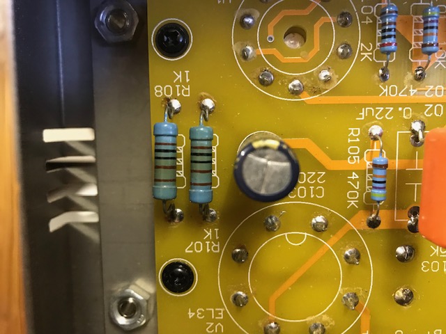

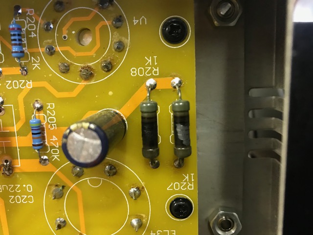

Hi everyone... A big thankyou to everyone for all of the information in here, what a thread !
I bought one of these (built) back in Jaunuary as my first tube amp and I've been slowly going through this thread and trying to learn as much as I can. The plan is to modify (butcher) this one as a learning platform, I have very little experience with electronics, before building my own.
So far, I've replaced the coupling capacitors with 0.47uf 400V and C302 with a 330uf 450V one as well as swapping out the volume pot (Alps 100k) and power switch (Lorlin). all going well and loving the sound using EH 6CA7 and Tung-Sol 6SL7GT with a JJ 5U4GB rectifier.
I'm going to add the artificial center taps to the 6.3v heater lines with 4 100R 3W resistors and rewire the heater filaments while I'm at it.
Also going to add a couple of 200K 2W bleeder resistors and a 3.3K 2W grid stopper to each 6SL7.
The last planned mod is a UL / Triode switch. As I only need 1 set of RCA input I've put a DPDT switch where the input button was and will wire this up to swap between modes.
Beyond this, I'm looking at the cathode bypass capacitors as covered in this thread and maybe swap out the resistors for some higher quality ones as done by Gidu.
This is where my problem is.... I've measured the resistors in my amp and checked the coloured bands so I know the values but I can't work out how to choose the right power rating and I'm hoping that someone on here maybe able to validate my choices before I buy anything. These are all Vishay metal film.
R102/202 - 470R 1W
R103/203 - 100K 2W
R104/204 - 2K 1W
R105/205 - 330K 1W
R106/206 - 100R 2W
R107,108/207,208 - either 4 x 1K 2W or 1 x 500R 6W
Thanks in advance for any help and I'll put some pictures up when I get the amp back together.

Hi Bosch,
I think R102 should be 470K, 0.5w would be enough, and 1w will never fail . R107/108 or 500R will have a maximum current about 50-60mA, P=1.8w, I used 5w worked for over a year never had trouble, 6W is even better!

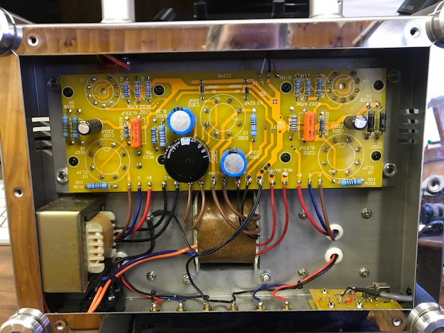

Hi Nick,
If you could load/show a photo of the engine room of your amp it would be helpful.
Images
nick-ryan@bigpond.com
just read out how to post the images so fingers crossed.
Cheers Nick
Hi Nick,
Cheers Nick
The photos came thru. You did well Nick. However, your amp is not a Boyuu A9.
Take a look at all the images posted on this particular forum and you will see what an A9 looks like.
Does your amp have a name? Maybe you could find a forum for that amp elsewhere on this site!!
Bobbbie

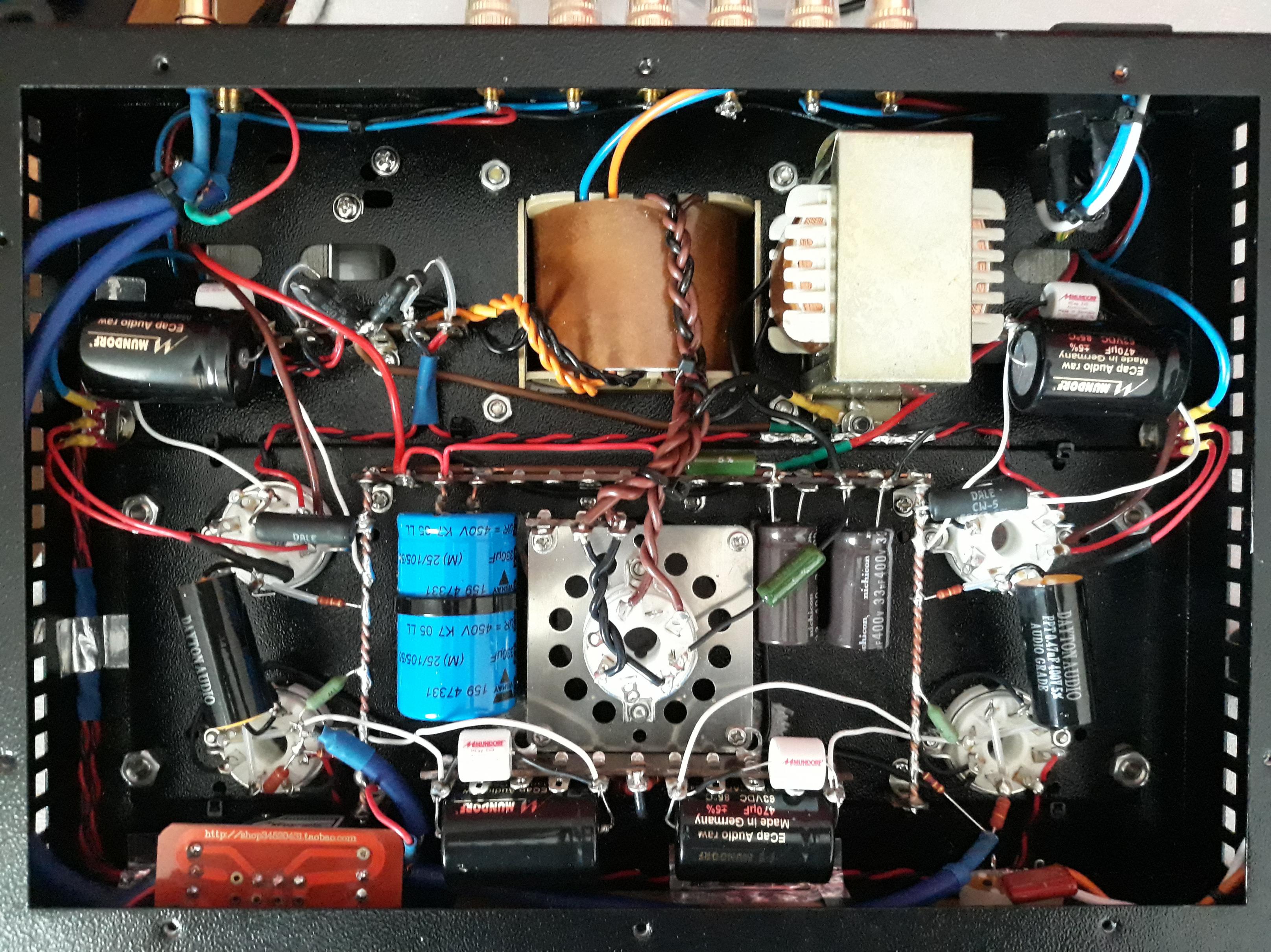

Rebuild
Finished.... 😀
Got the last bits connected up this morning. Spent a bit of time measuring voltages and checking nothing started to smoke.....
Happy with the results so popped in the tubes which came with the amp and it works like a beauty. Not switched to Triode mode yet, just loving the sound after having to use my laptop to stream music for the last few weeks.
I couldn't have done any of this without this thread so thanks to everyone....
Finished.... 😀
