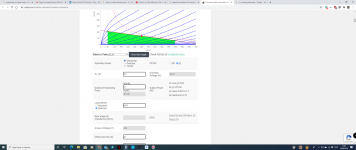

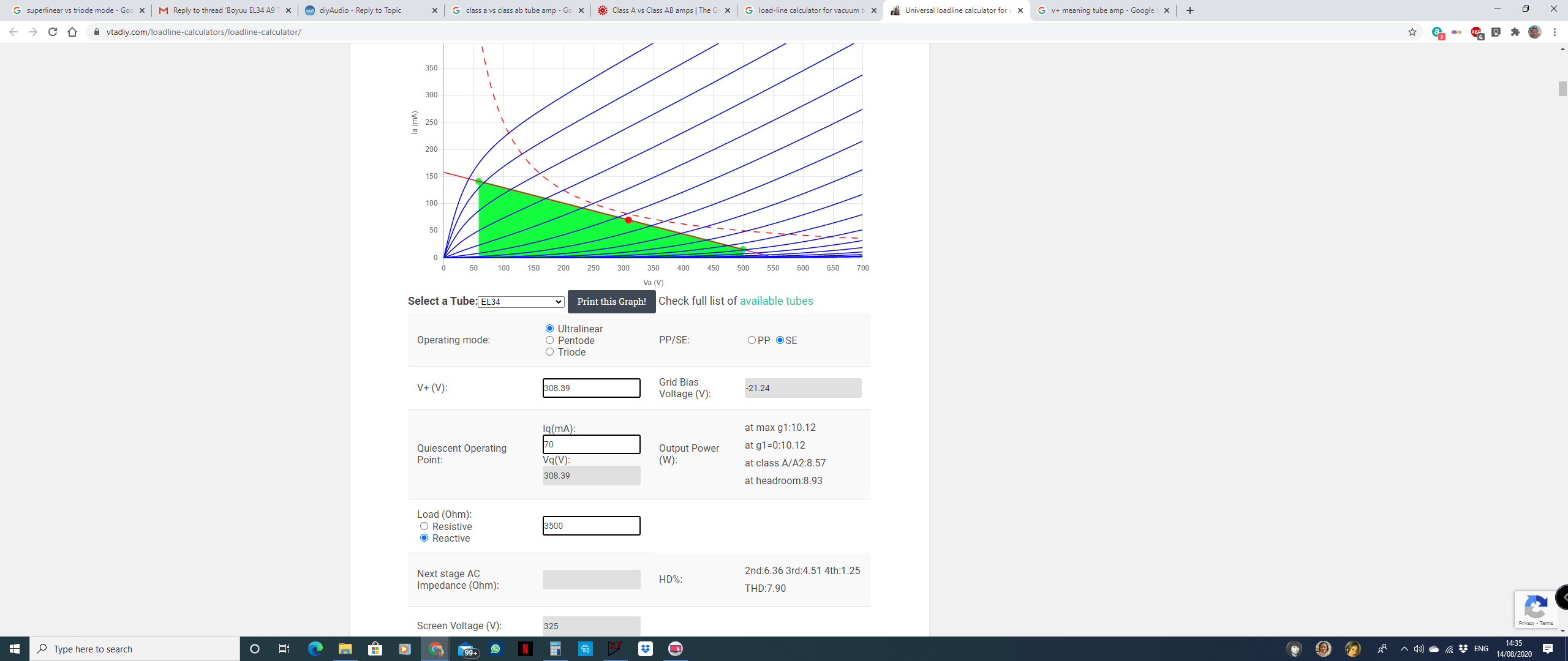

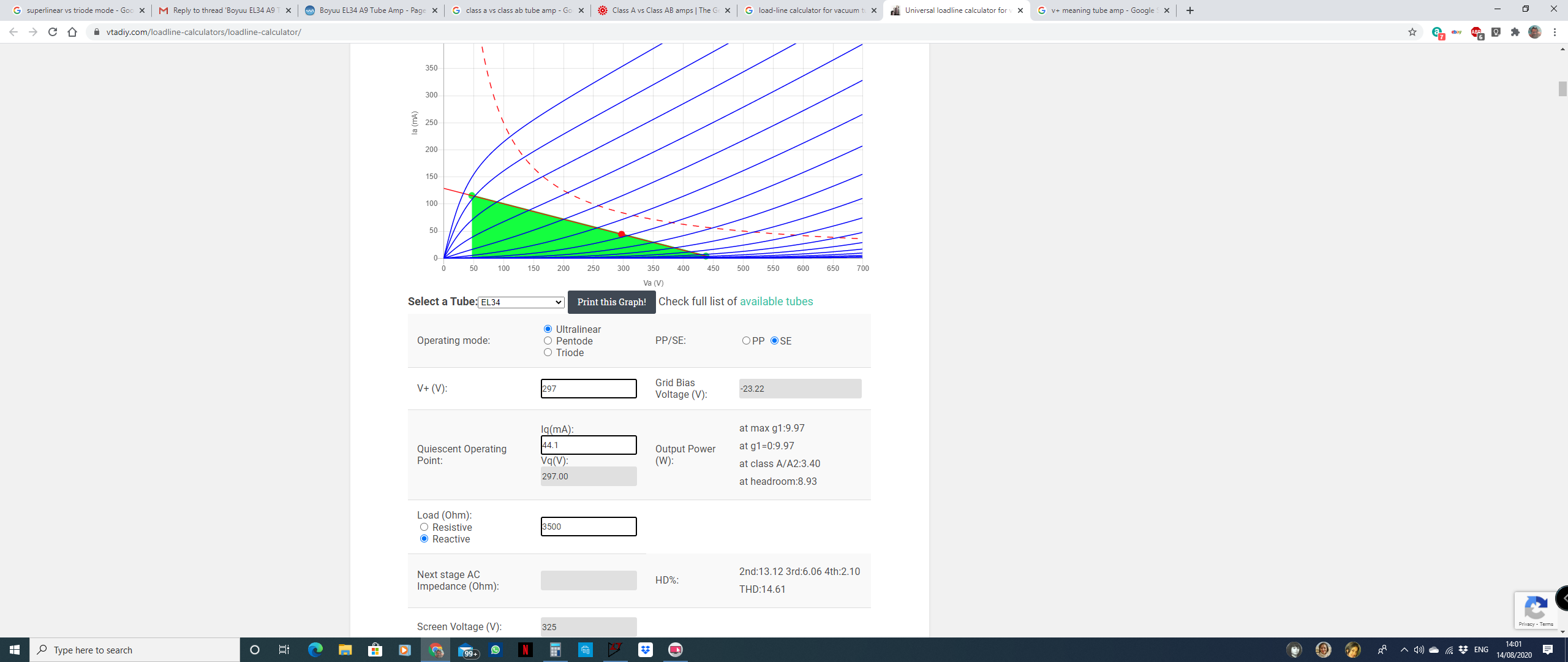

Tubby23,
56% at 45.90mA.
90% (90/56) x 45.90 = 73.77mA
There will be the following changes in your amplifier:
The B+ Voltage will drop because of the additional load current.
The Power transformer will get hotter.
The Self Bias Voltage will go down (because you have to use less resistance than the 479 Ohms you are using now,
in order to get more current).
The B+ draw now is over 90mA.
It will be going to more than 147.5 mA.
How warm, or how hot does your power transformer get at the 45.9 mA/tube now?
How about the rectifier tube. Check the tube specifications for the new current (probably OK), But be sure to check the rectifier's rating of the capacitance of the first filter cap that is in your amp, versus the higher current level the rectifier will be running at.

Hi.
My rectifier is the stock 5Z3P, in series with UF4007 diodes at the inputs.
My reservoir cap is a 22uf/450v, followed by a 330uf/450v after the choke and, lastly, one of the stock 33uf/400v "Phillips" after the 8.5k resistor.
I haven't any means of measuring the tranny's temperature but it, along with the whole amp, gets quite toasty.
Someone, I believe it was member "Learn", mentioned it's rated at 200w.

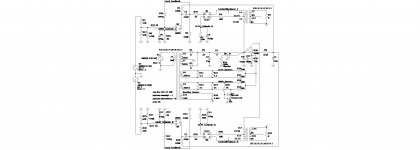

According to LtSpice B+ is currently drawing 91.92mA, measured at the choke.

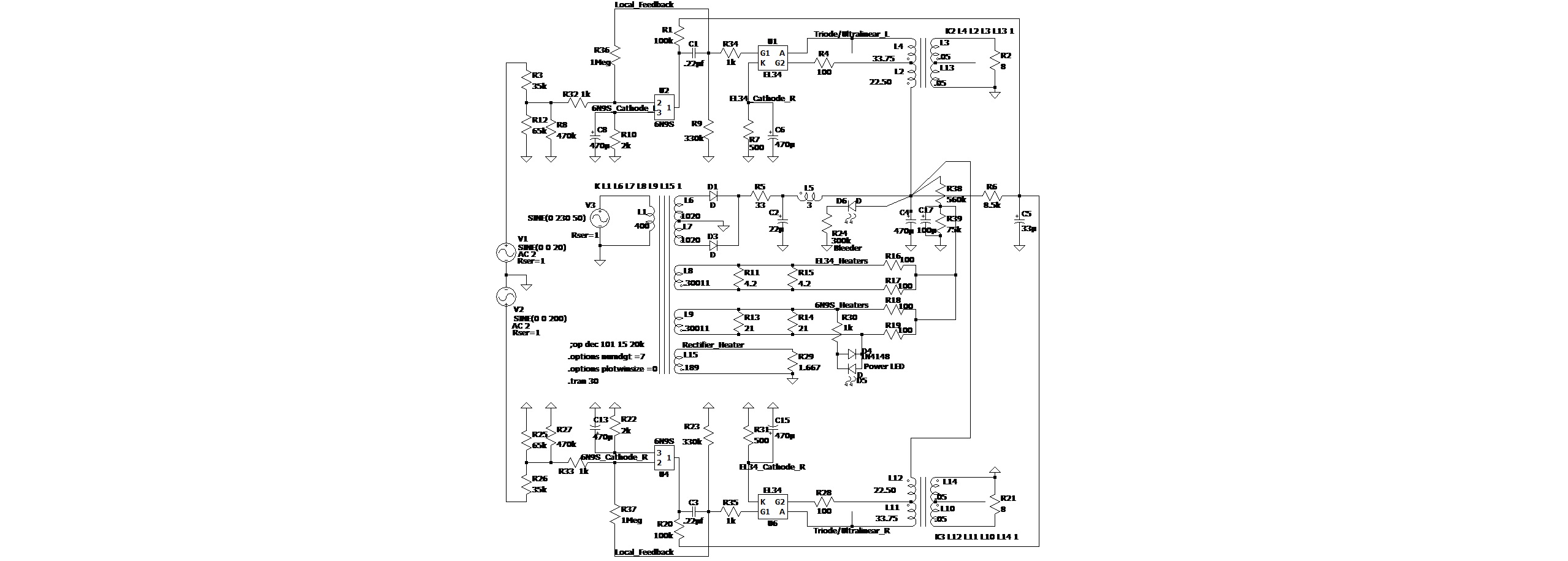

My OPTs primary DCRs are (L) 219R with 11v drop and (R) 222R also with 11v drop...hmmm..
My B+/HT is currently 332v and EL34 plates are both 321v
My 5Z3P stock rectifier is equivalent to 5U4G with the following specs:
(1550V PIV, 225mA max DC. 44V max drop at 225mA)
LTSpice won't model tube rectifiers but my virtual diode-based two-phase rectifier is outputting 445mA RMS at the moment...
But it shows that only 100mA are flowing through the choke..
I have no tranny spec data.
And that's all the info i can provide at the moment.
Tubby23,
I am not a software guy.
And I do not use Spice.
Try and model your 5Z3 as the following:
44V/225mA = 196 Ohms (I know, that tube resistance is dynamic not fixed, but for your spice model, use 196 Ohms in series with a HV diode).
Then, in spice, simulate the 5Z3 with the following model:
A high voltage rectifier diode in series with 196 Ohms.
You need two of those models to make it full wave, just like the 5Z3.
I think your mains are either 220 or 240V. The power transformer primaries are in series, right?
So, the DCR is 219 + 222 = 441 Ohms. You could never draw more than 1/2 Amp in 220V, even if the secondary was shorted.
I do not believe your DCR readings.
I think your DMM is reading the DCR improperly. You need to short the secondaries, then read the DCR again. DMMs get confused in the Ohmmeter mode, when measuring an inductor/transformer (but short the secondaries, and the primary inductance "goes away").

6A3sUMMER
Those DCR measurements were of my output transformers, not the power unit. I haven't ever taken any measurements of it.
I have it modelled in spice as an ideal transformer.
Yes, UK mains is officially 230v but mine fluctuates from 232-238v, depending on local loading, whatever factors.
Just two days ago I was taking the power stage's measurements and B+ would go up and down by 2v every so often, affecting the other voltages.
Currently, I have the rectifier modelled as an ideal full wave diode-based unit. I get similar rail voltages in the software as those of my amplifier simply by fudging the mains voltage up or down a few volts (which actually reflects my local mains, lol).
But I'll try your suggestion of additional resistors in series with the diodes. Question: the rectifier tube's 44v drop isn't purely resistive but what else is it? Reactive? Inductive? I ask because instead of resistors maybe I could put coils or caps instead, or a combination.
With regards to your valid concerns over the A9's power dissipation, once I increase the biasing, I only want to increase it enough for the bigger 15w/6.6Z OPTs I'm going to order. And bandwidth

So, with my current cathode resistor of 497R (500R) the readings are:
Plate-to-Cathode: 297v
Total plate current: 44.1mA
Plate dissipation: 13.1w / 52% of max
I plugged these figures into this website:
Universal loadline calculator for vacuum tubes - Vacuum Tube Amplifiers - DIY
And obtained the first graph:
But if I replaced the 497R cathode resistor with a 270R I'd get:
Plate-to-Cathode: 308.39v
Total plate current: 70mA
Plate dissipation: 21.6w / 86% of max
Hence the second graph
The third is with both a 270R Kr and OPT with 6.6K impedance.
Spice seems to show the voltage swing to be around +-250v.
The 270R resistor allows the swing to be taken into higher volumes (headroom).
Anyone care to check these figures, please?
They're potentially good for all of us!
