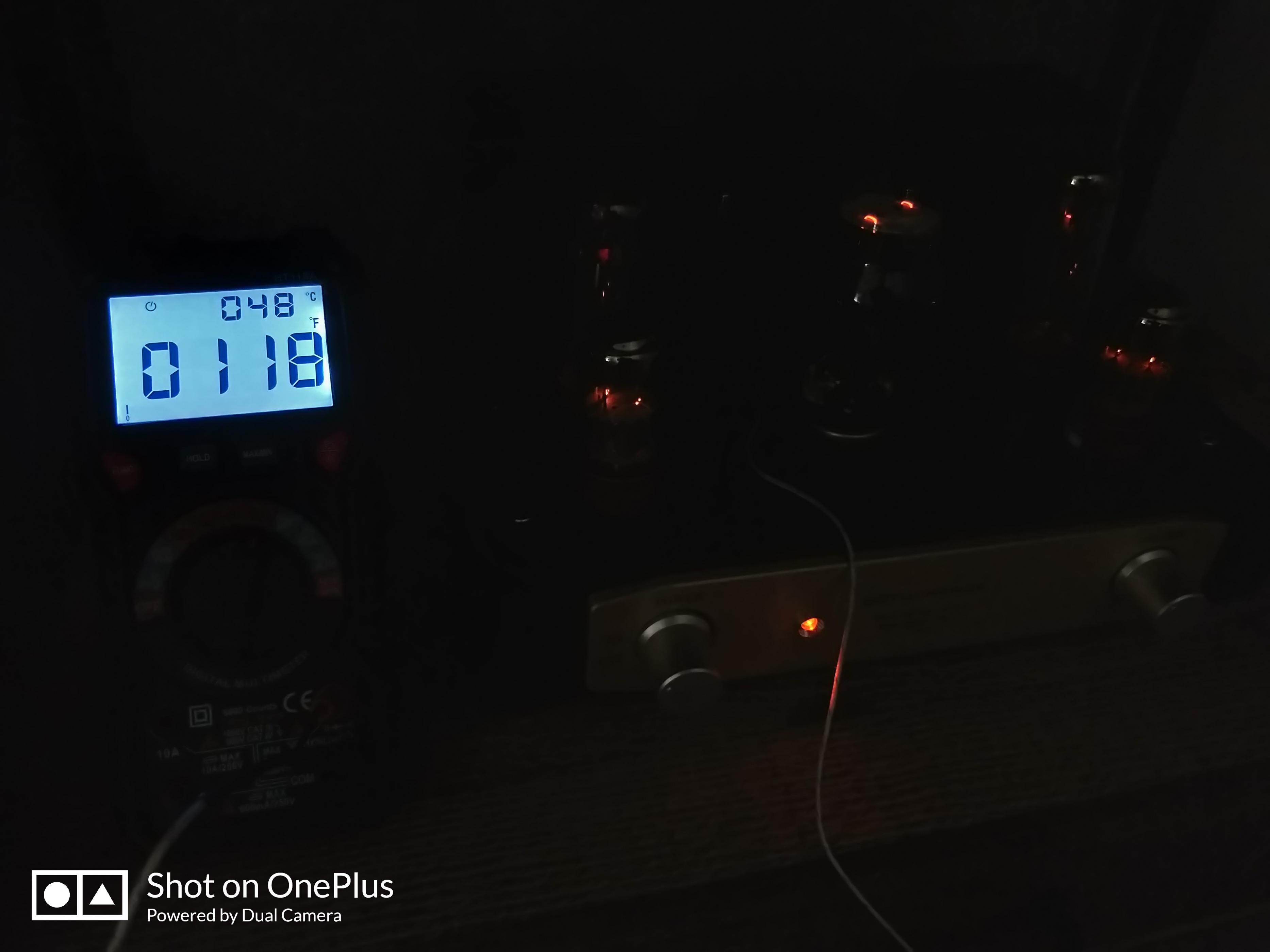

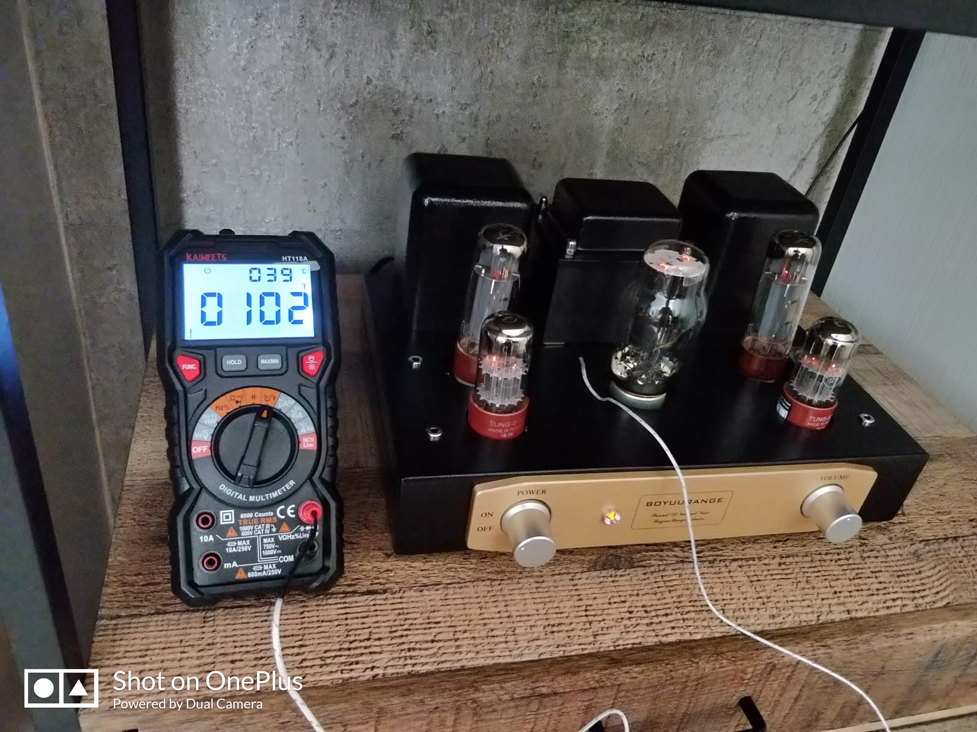

Well, I finally swapped out the 497 (500) ohm cathode resistors for the 270 ohm and I'm now getting 71% plate dissipation but the bass has all but gone.
Also...the transformer was getting too hot - I measured it 50C/122F before i switched it off.
Not happy.
I'll put the old resistors back in.
Not happy.
Back to the old resistors.

Have literally no idea then.No.
Its the same.
Given the output stage current became even marginally bigger (50mA vs 48.8mA) the voltage shouldn't have gone up.
Maybe it's the input stage that is responsible for the effect? Have you tried changing just the input or just the output tubes?
That was kinda expected to be honest...Well, I finally swapped out the 497 (500) ohm cathode resistors for the 270 ohm and I'm now getting 71% plate dissipation but the bass has all but gone.
Hmph...even at stock biasing my tranny runs at 52C/126F.
