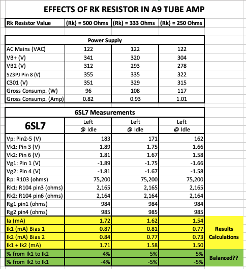

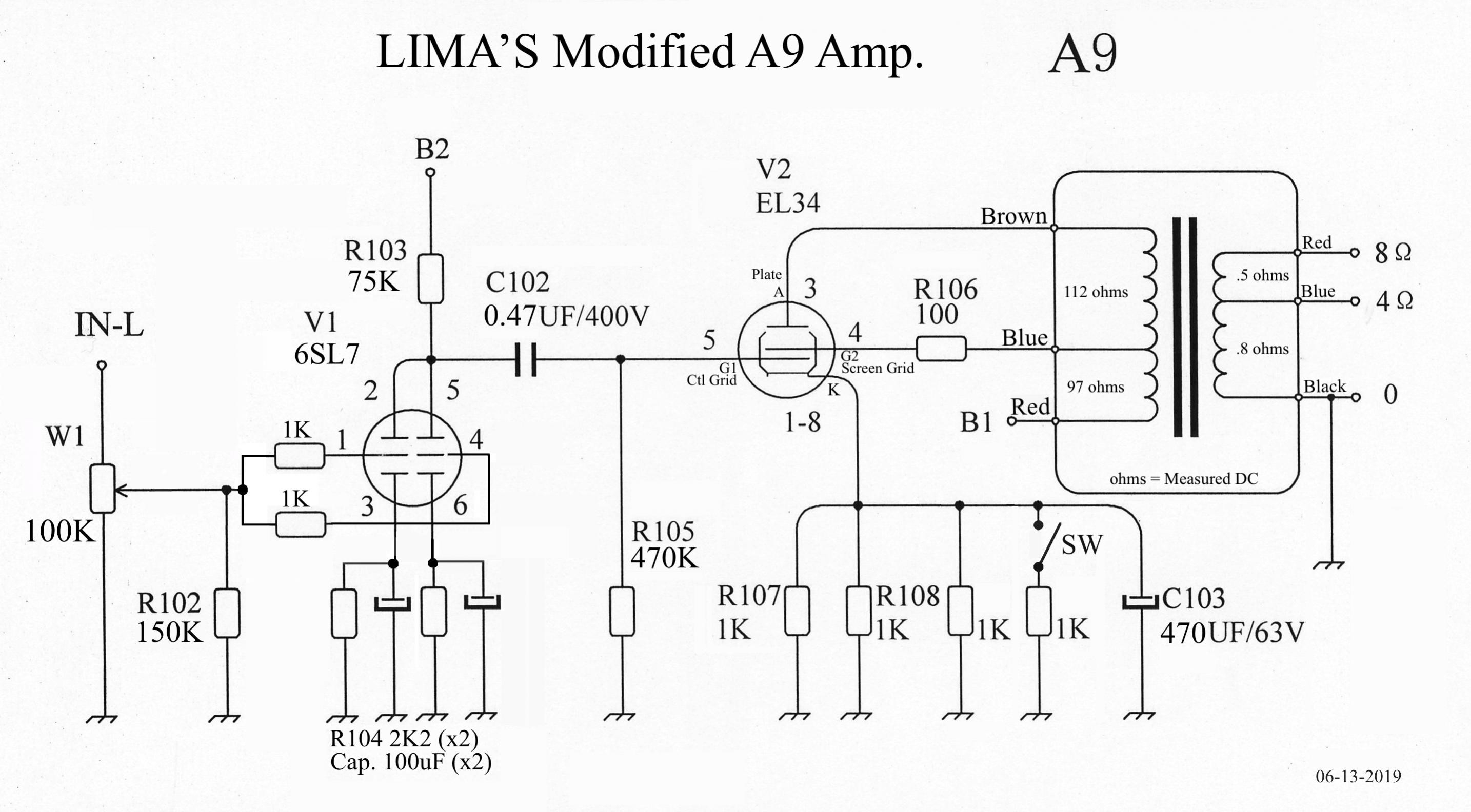

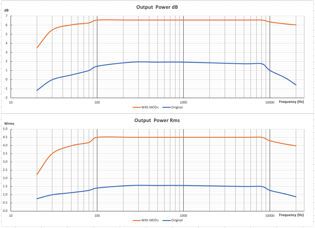

"Changing from a rectifier tube that has a significant DCV drop, to all solid state rectification will make the transformer to
run much hotter, especially if you use the same B+ filter capacitances, chokes, and resistors."
Surely you mean they run cooler with solid state rectification?
Am I to understand that simply increasing the rail voltage increases the overall power available?
Does this affect biasing, either fixed or cathode-based?
I suspect not but want to hear from the pros.
Those are good transformers, but that's overkill.
Each of them costs (and probably weights) more then the whole A9 amp.
And they're huge - will they even fit on the chassis?

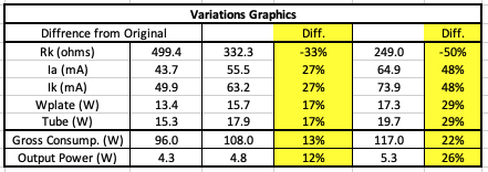

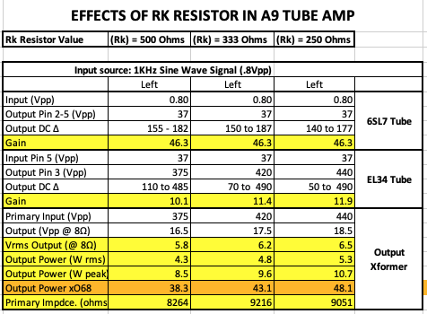

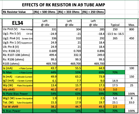

Well, it depends.Surely you mean they run cooler with solid state rectification?
The current through the PT is roughly the sum of the current consumed by the amp itself and the current pulses that are charging the reservoir caps. Since the SS rectifier has lower impedance, those current pulses will be bigger.
You'll probably get about 20-25% current increase just by changing 5Z3 to UF4007. You can drop it to 10-15% by replacing the 22uF first cap with the 10uF one, still gaining a good bit of B+ voltage.
On the other hand, you save 12-15W that were heating the 5Z3, and you don't heat the PT with the rectifier tube itself (not that it matters much, since it is heating mostly the core and not the copper, but still).
It does. You'll have to increase cathode resistors to get to the same quiescent current as before.Does this affect biasing, either fixed or cathode-based?

But, you are trying to increase the output power of you amplifier using the power transformer that you have.
You will not be able to use choke input filtering. Even with solid state rectifiers instead of a tube rectifier, you will get Less B+ voltage.

Hi Tube23,
Last time I modified my A9 amp was about a year ago and I experimented with 3 different values for the Rk resistor: 500 ohms (original value), 333 ohms and 250 ohms. I did not try 270 ohms.
I’m posting my measurements with the 3 values for Rk and you can see they are very close to your measurements. I’m thinking 270 ohms might be the ideal value for Rk because, in my case, with 333 ohms felt like it has room to improve and with 233 ohms seems like it’s pushing the tubes too hard. 270 ohms might be the sweet spot. I normally use my amp with Rk 333 ohms and eventually I flip the switch SW to use it with 250 ohms when I want a bit more power.
The frequency response has improved a lot with my mods, compared to the original design (See graphics). BTW, these frequency response tests were done using sinewave signals. I’m planning to repeat this test with a squarewave signal, but I haven’t had the time yet.
I hope this information will be useful to you and I would like to hear your (or everybody else’s) comments.
FLima
FLima
