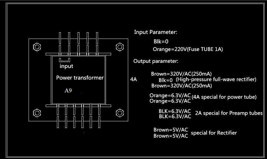

Voltage test: With the transformer unloaded, the two 6.3V secondaries will have the same voltage, or nearly the same voltage.
Ohmmeter test: The DCR of the high current secondary will be lower than the 1 Amp secondary. You need a low range Ohm Ohmmeter to test this (and very good connections of the test leads to the secondary). If the readings are not stable, the DCR is lower than the connection resistance.
Under load: The EL34 filaments on the 1A secondary, and you have a hot secondary, and less than 6.3V (or less voltage than the high current secondary).

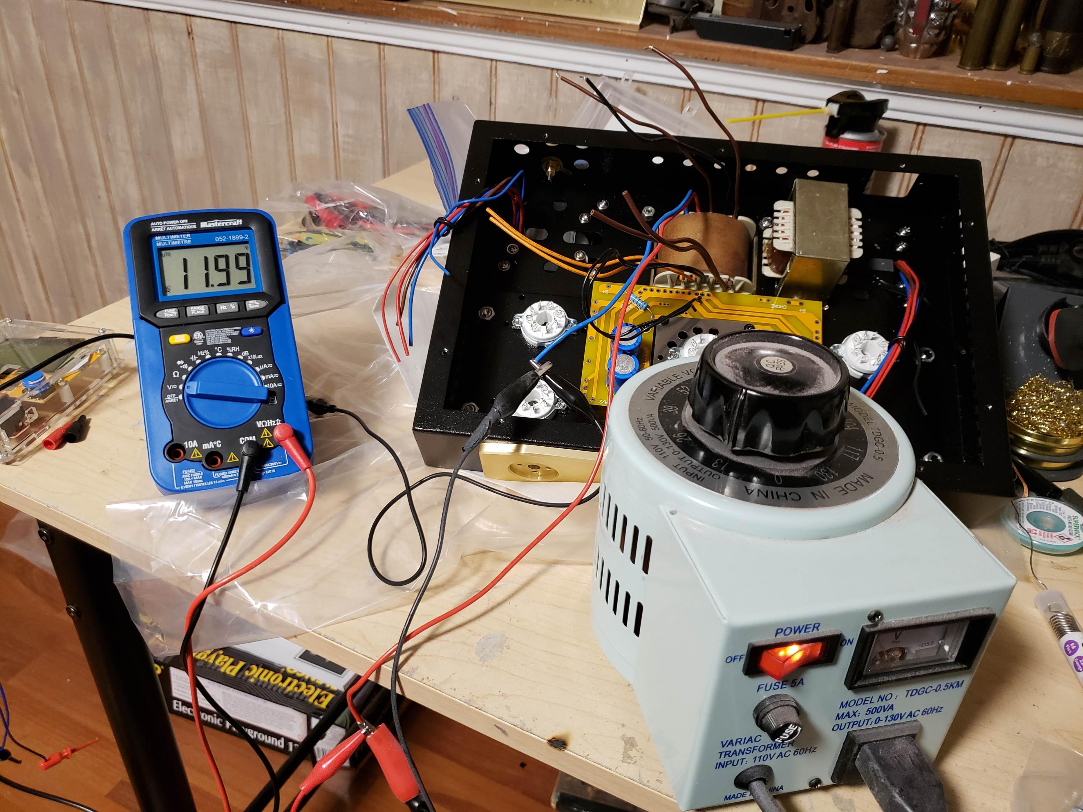

Yes - dial down the voltage to 15 volts AC or so, and connect that up to the primary. Then, even the HV secondary shouldn't have too 'exciting' a voltage on it. Still, be careful!I do have a Variac that I use for a DIY Acrylic Bending Machine I built. Thinking I could use that to keep the voltage levels way down???

For testing voltages, it's often possible to just jam the meter probe points into the end of the wire without stripping the sheath. Once the wires are stripped, I almost always use test leads with alligator clips.

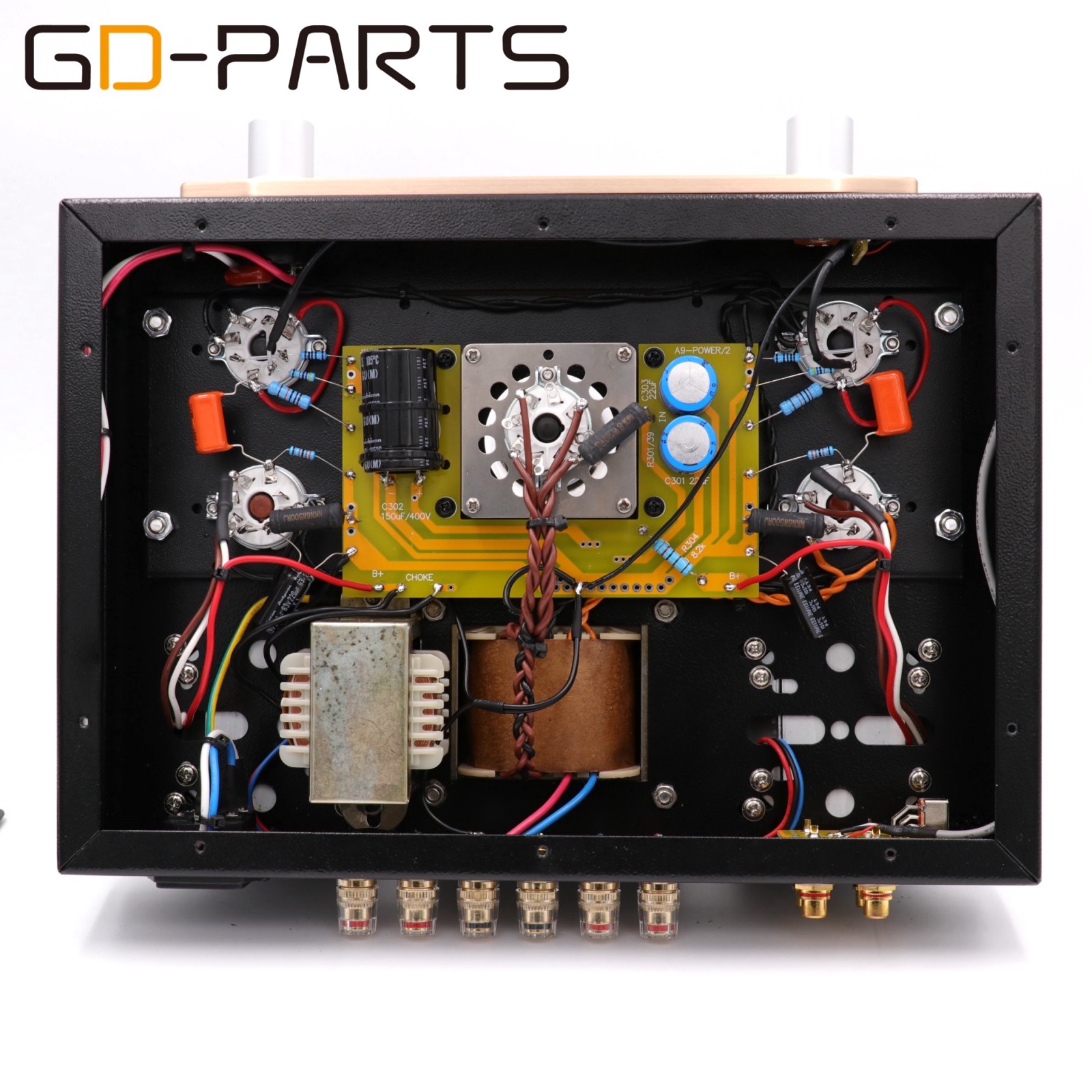

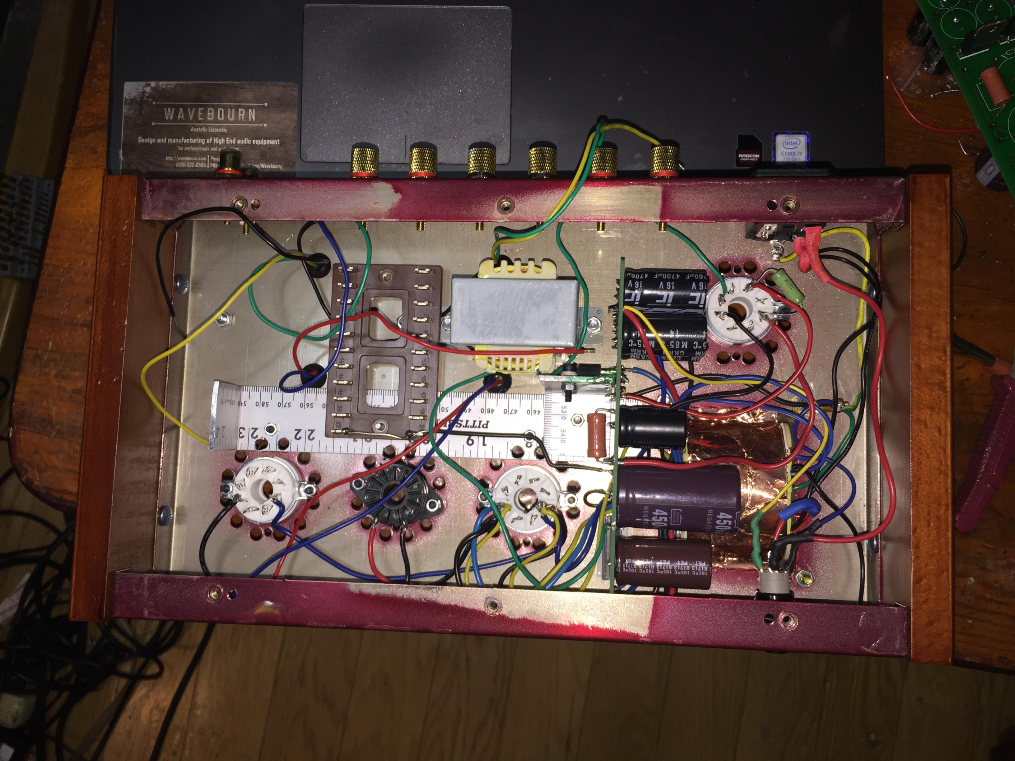

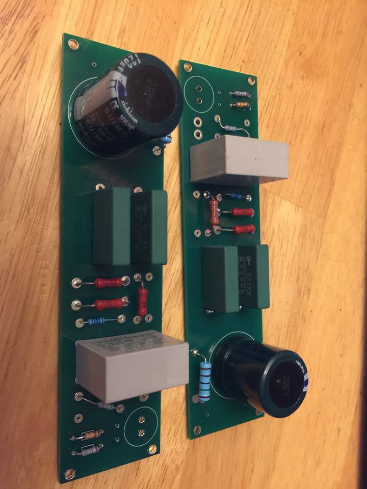

I have a question about the style of construction in this amp.
It's 'half-on and half-off' the PCB, and seems to have the components added and soldered 'from the top'.
I've built projects where the PCB is 'populated' with components and then connected with wires to the controls and tube sockets (many guitar amps use PCB or eyelet board like this). I've never built a project where there are components connecting the board to off-board tube sockets.
How do you solder the through-hole leads properly, working 'from the top'?
And how do you trim the leads after soldering?

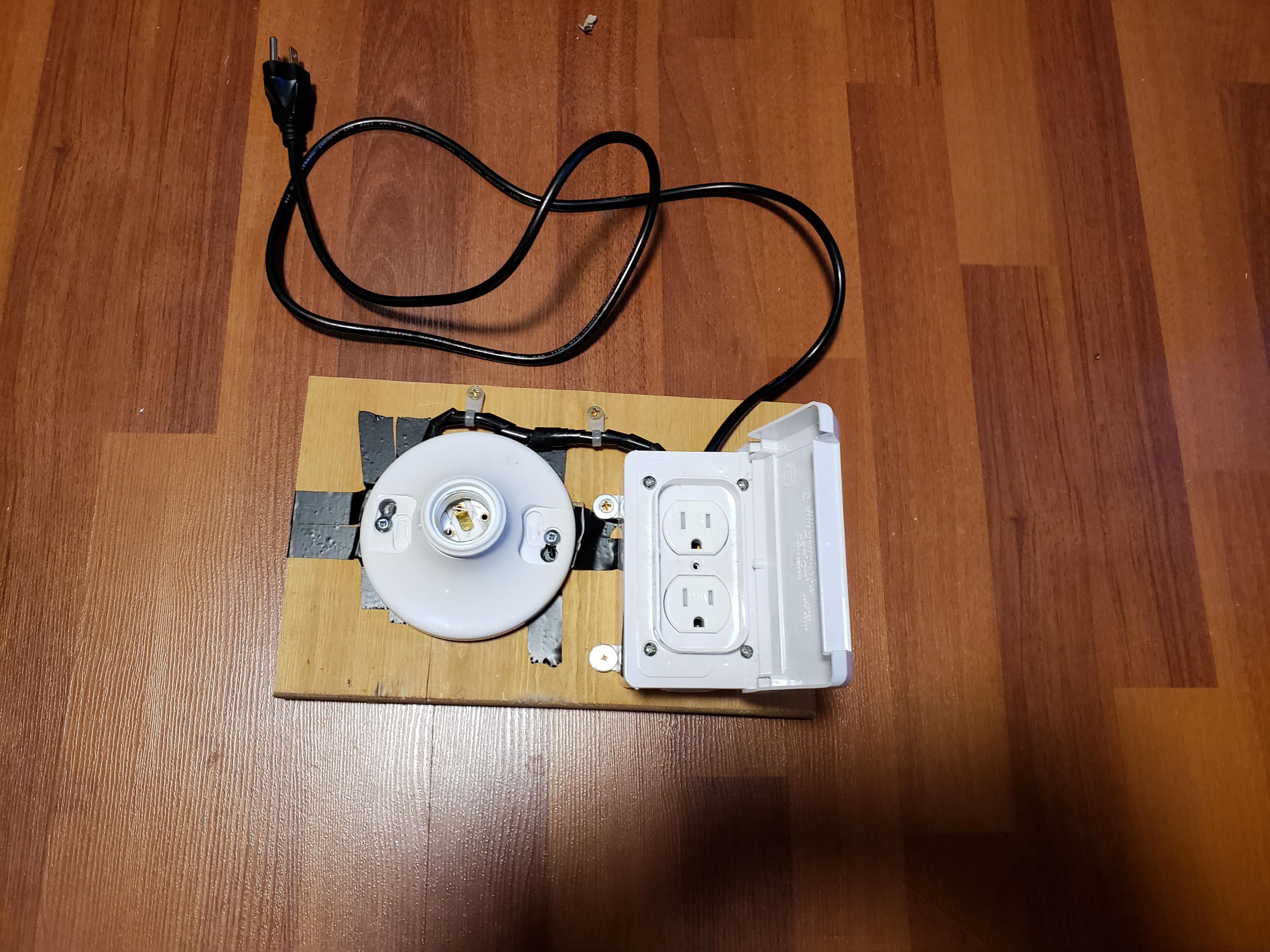

This is the meat of what I need to know so much appreciated. Will try hand bombing it - in fact I did just that building the dim bulb tester today and had no issues. The stripper will certainly come in handy on my boat which is what I really needed it for - especially in behind the helmet area and in the engine room. The lead legs seem to be quite long so will trim them down after testing with the variac and multimeter etc.

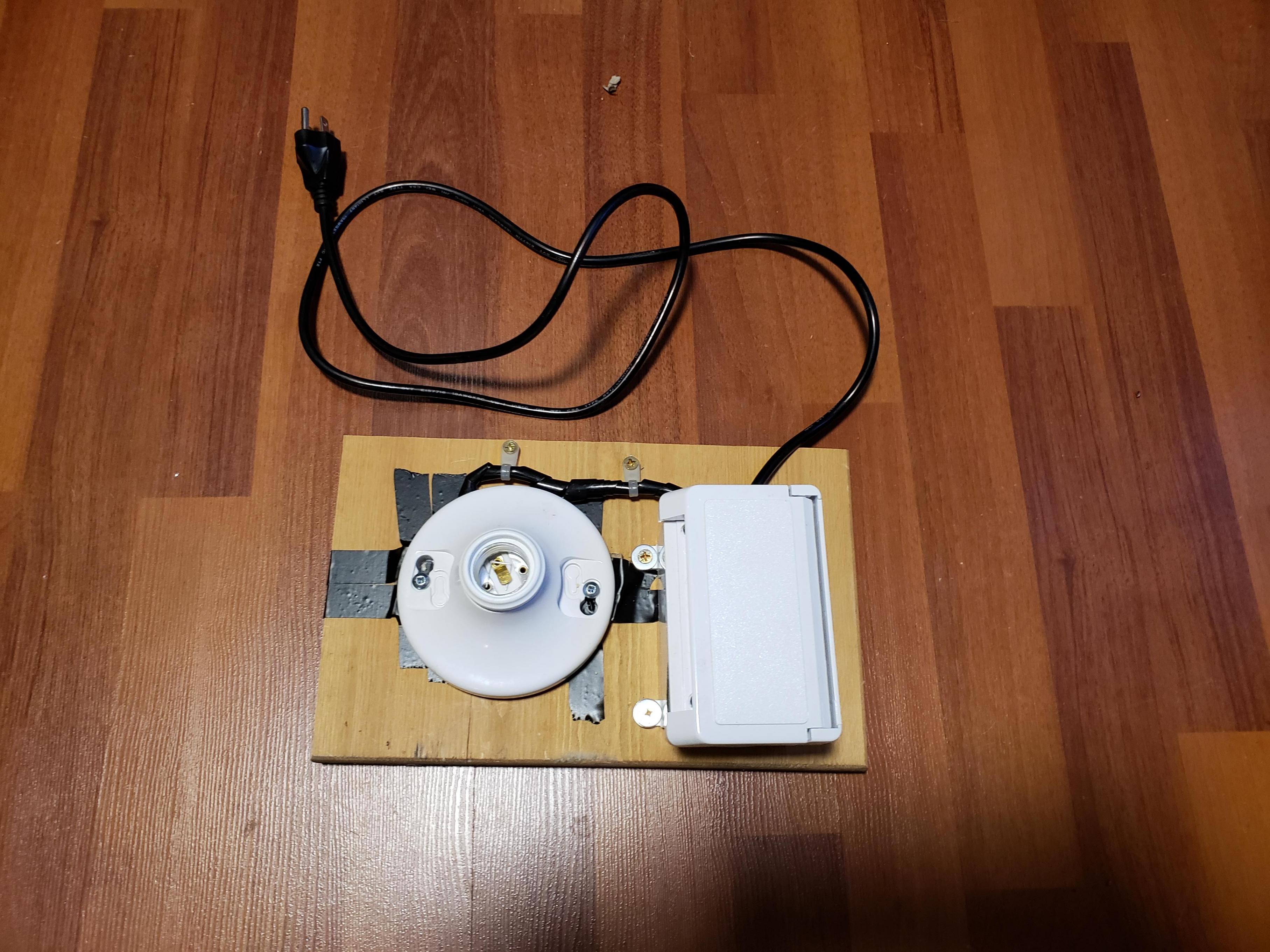

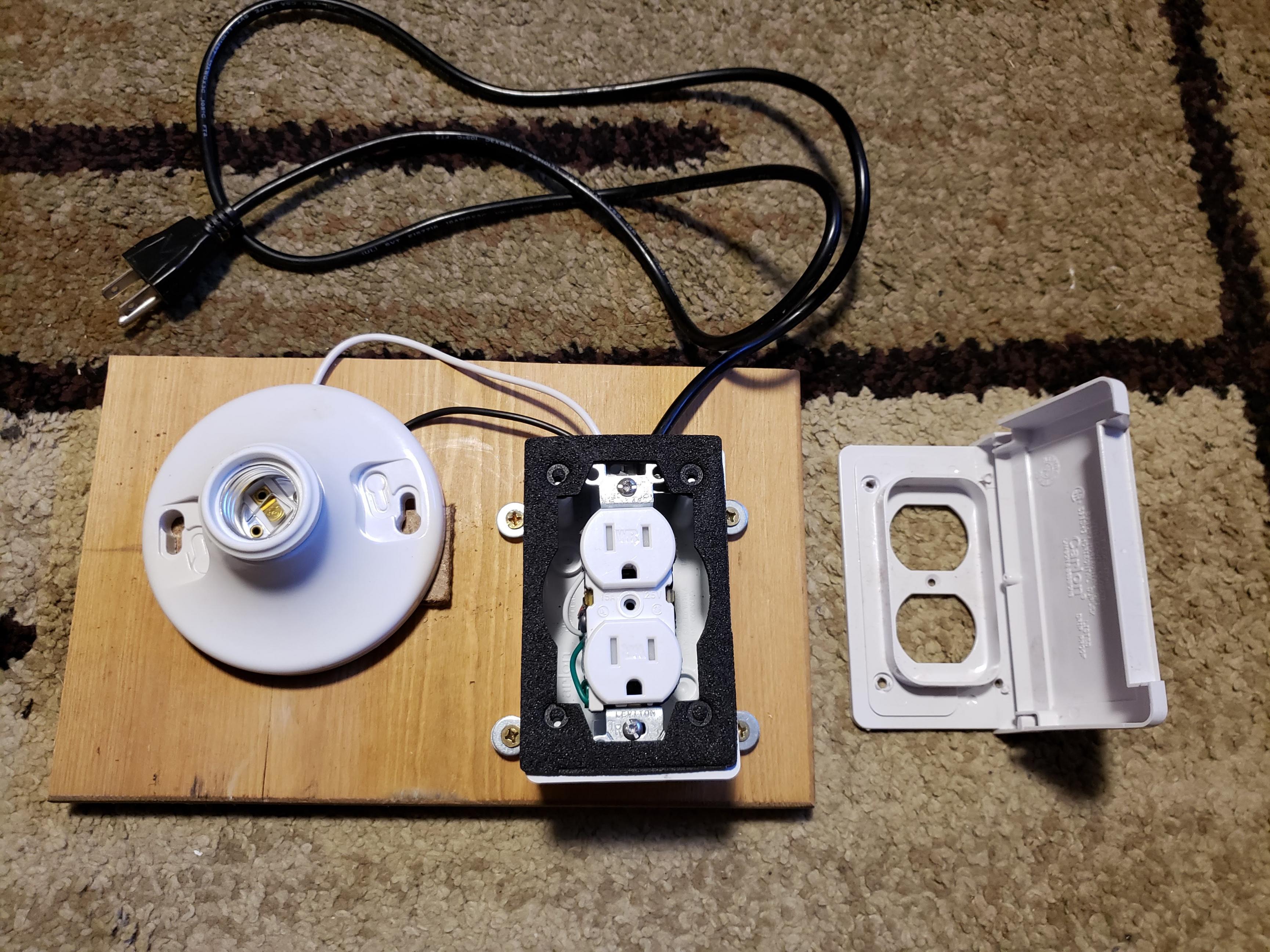

Pics of the dim bulb tester follow.
Great tips - many thanks.

I never mount tube sockets on PCBs. A first, they obstruct convection. And second, heat expands metals, so leads of sockets finally break solder joints. I guarantee my amps for 5 years, but hope that they will live forever. Modern components are better mounted on PCBs, so I may use PCBs standing vertically, for better convection path, connecting sockets by wires

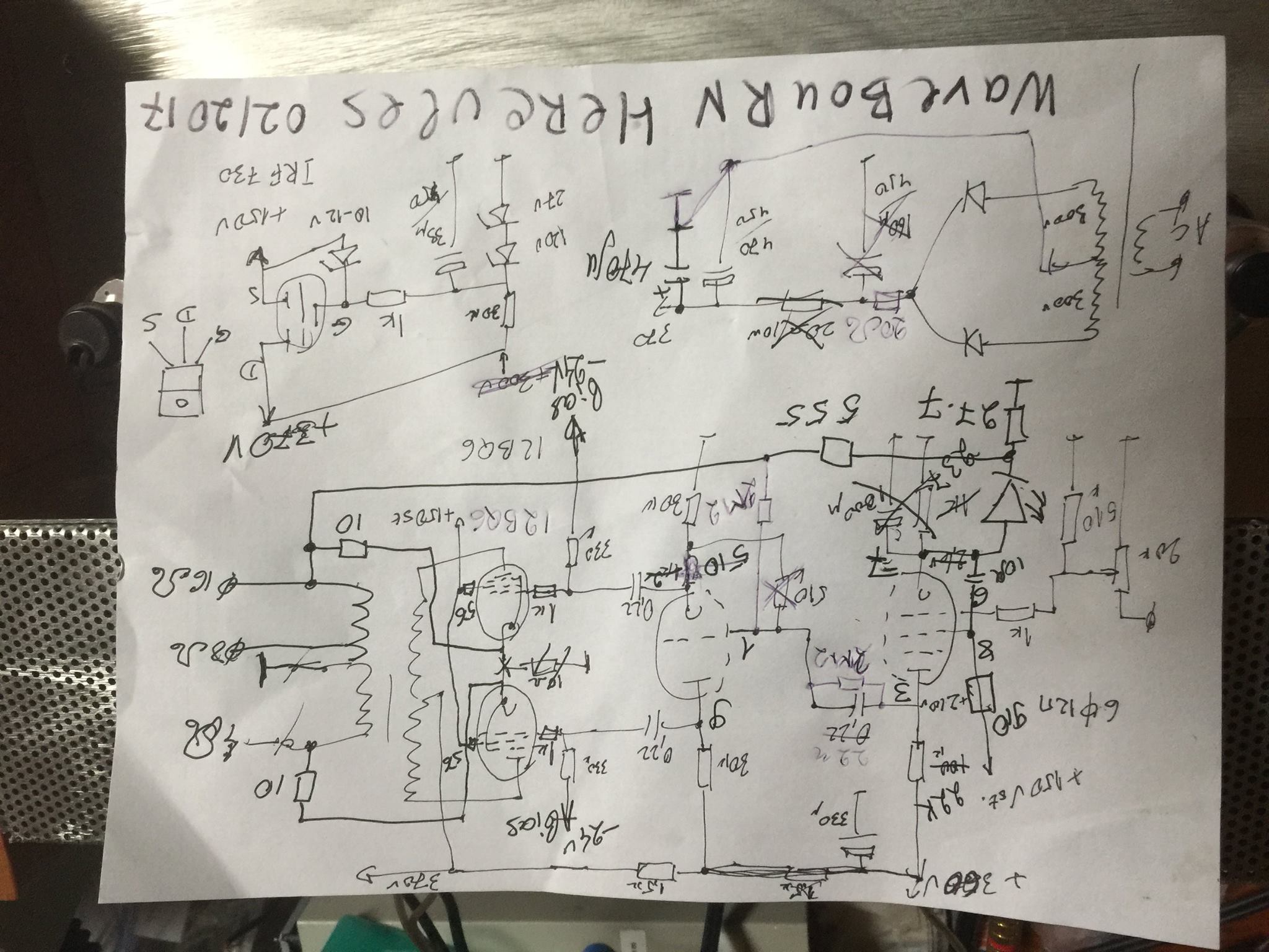

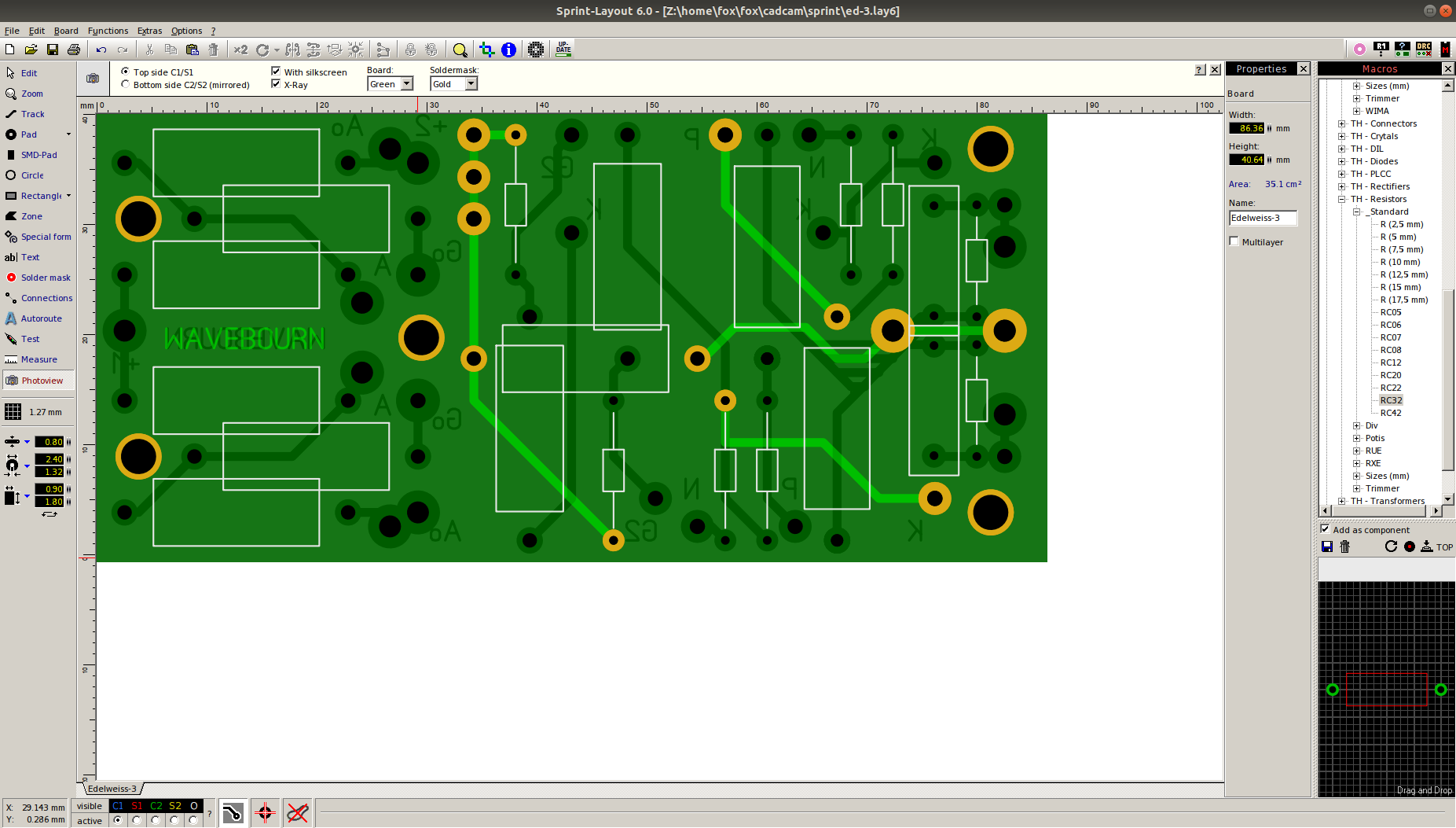

Many many thanks LongRoad - your provided schematics actually reflect the cap values I received - This is a very very good start. Have just begun proving the power transformer lines for continuity on the various windings (had to build my dim bulb tester first). This is a big help!
I also found this image on a Google search which reflects the exact PCB I have so will use it as somewhat of a rough guide to make sure what I do is making sense. I am first going to build as-is then will likely follow your guide for suggested mods once I have a firmer understanding of the build😉
Thank you agian John
Why are 'modern' components with leads not capable of being used in circuits the same way they have been for 80+ years? (i.e. connecting to tube sockets and solder lugs). Or do you mean surface mounted components (SMDs) are more 'modern' ? I agree that for 'rough handling' situations (vibration, lots of moving), laying the components with leads on a PCB is better, but home audio gear doesn't get very tough usage.

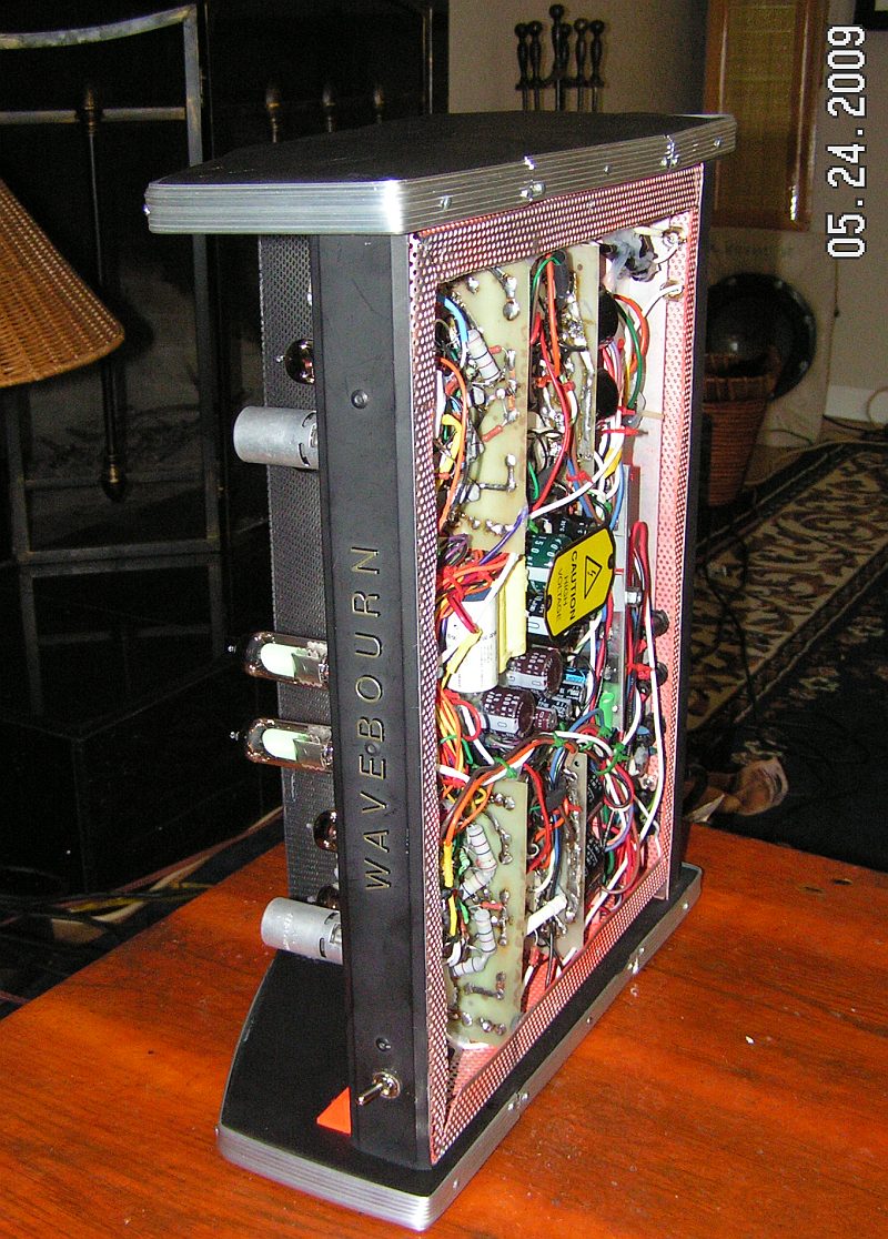

I recall taking apart some high-end (HP or Tek) equipment and it was full of PCBs with tube sockets. I also remember a tour of the SAGE (air defense) computer room - it was a tube computer designed in the early '50s - and that computer was built with plug in boards with tube sockets. They went through a lot of tubes. (By the 70s they were getting tubes from the USSR to keep it going!)
How do you manage grid stopper resistors? I don't think you would solder the resistor on the end of the wire....And, do you solder components across the tube sockets? That's a quite convenient thing when it works.so I may use PCBs standing vertically, for better convection path, connecting sockets by wires
I've learned a lot taking apart tube gear from the 50s and 60s.

Nothing wrong with good PCB boards- they make a lot of sense for 'kits', and multiple builds. PCBs, perforated boards, eyelet boards, turret boards - lots of variations that can all be used to make good gear.3. Yeah, I thought the same as all the reading and Vids I have been watching seem to extol the virtues of point to point wiring vs PCB configurations. I plead plane ignorance on this one when I ordered it. I suppose it would be easy for better people than me to bin the PCB and go back to first principles????
The Tubelab boards from George are really nice - I still haven't built the amp, but the board is on my shelf here.....
Were tubes in that computers mounted horizontally, so boards did not obstruct convection path?

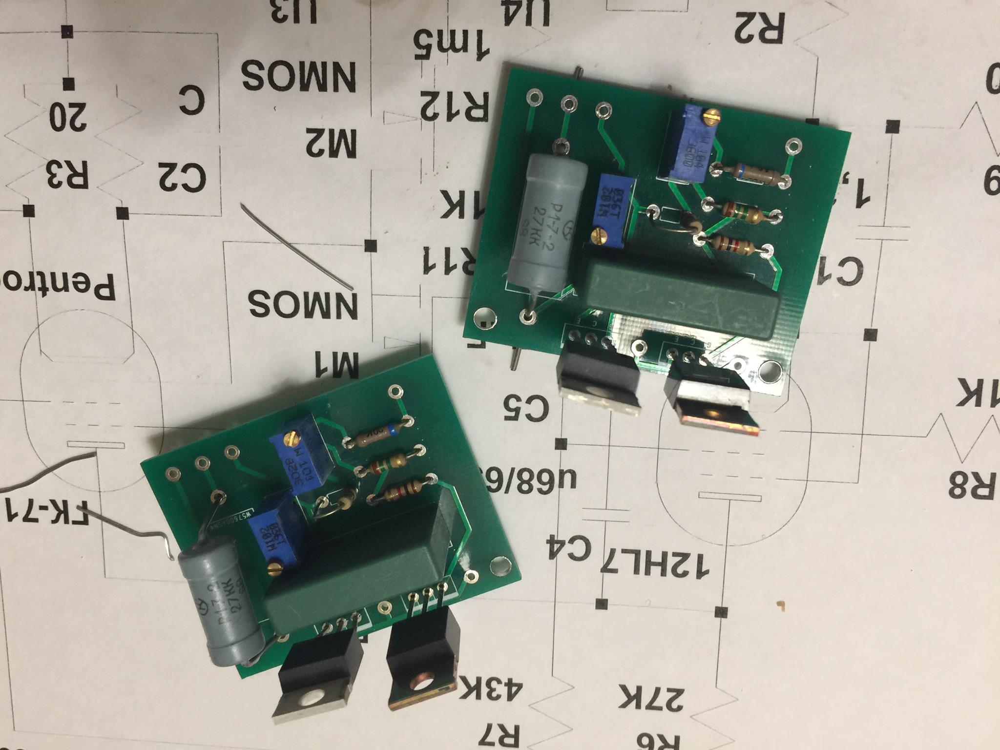

Why everything must be mounted on PCB? Not at all! Grid stoppers, interconnects, resistors between tube socket pins, and so on, can be mounted directly on the socket. But components designed to be mounted on PCB better be there. For example, electrolytic and film capacitors. And of course it is logical to mount some resistors, caps, etc.., between boards and sockets. I feel uneasy when I see heavy PCB mount caps glued to the chassis, or heavy resistors or boutique capacitors hanging on long thin wires... You say no vibrations and accelerations in home audio? What about shipment?
Here are examples attached, some of my prototypes. Not a visual art, but you can get the idea.
I have to agree with Anatoliy. I find that modern components have shorter leads these days and often will not reach the terminals the original parts were soldered to. That's all.
-Chris

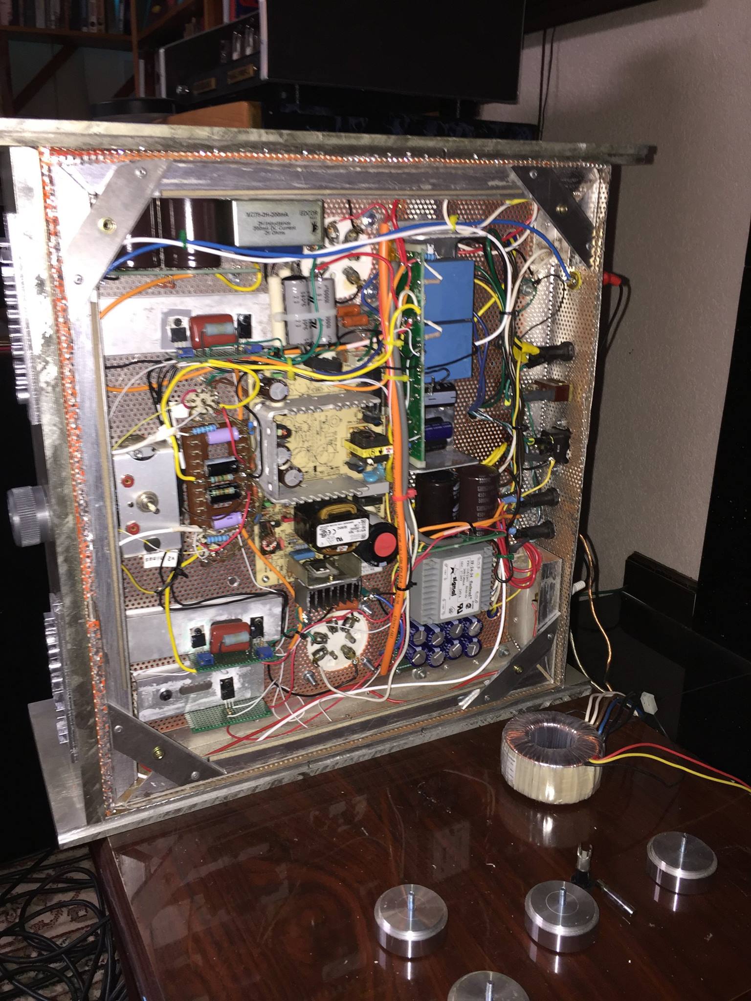

It was a long time ago, but my recollection is that the tubes were short (low profile) and the plug-in boards were mounted vertically.
The cabinets had LARGE forced air duct systems - ventilation and cooling were big problems. The entire 'building' was mounted on large springs and was underground in a hard rock 'mine', so ventilation air had to come from the surface above.
Very large diesel power plant was part of the system, and there were some interesting problems with the exhaust pipes (dozens of m. long, vertical)...a story for a different forum! 😉

Here is a board for a stereo single ended amp that I designed yesterday. Waiting for them to be manufactured and shipped... One of advantages is, it can be used with any set of driver and output tubes, i.e. the board is universal.
One more examples, push-pull amp board, a single channel. Input triode, pentode, or cascode, does not matter, with Concertina phase splitter. Any tubes can be used. It was designed for my Hercules amp. Either LED or resistor+cap bias of input tube, also LED/LDR optical compressor can be soldered on the board.
If needed, I can add class A2 driver boards to any of them, either SE or PP one. All of them have 41 mm height, to fit under 1U chassis.

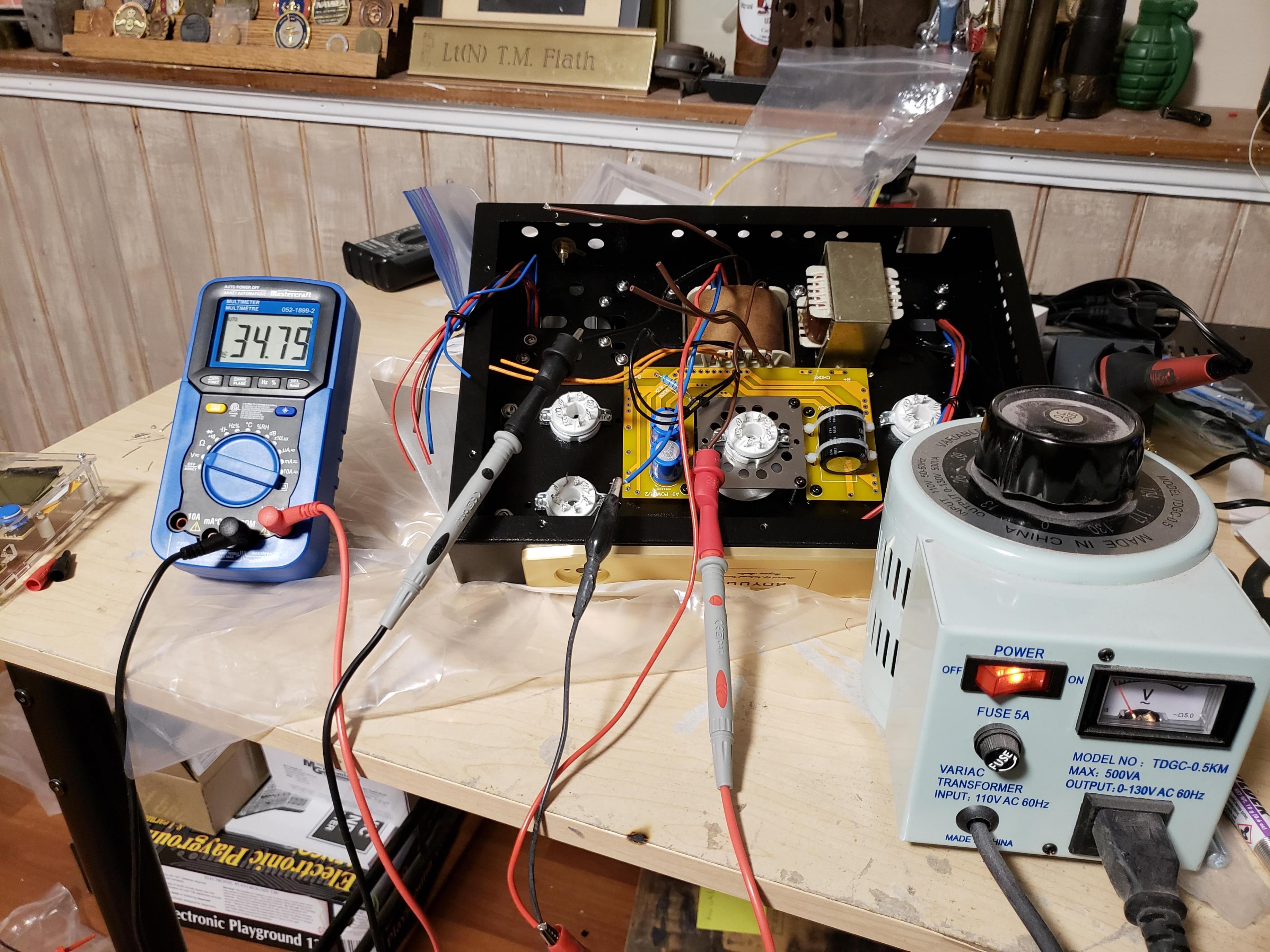

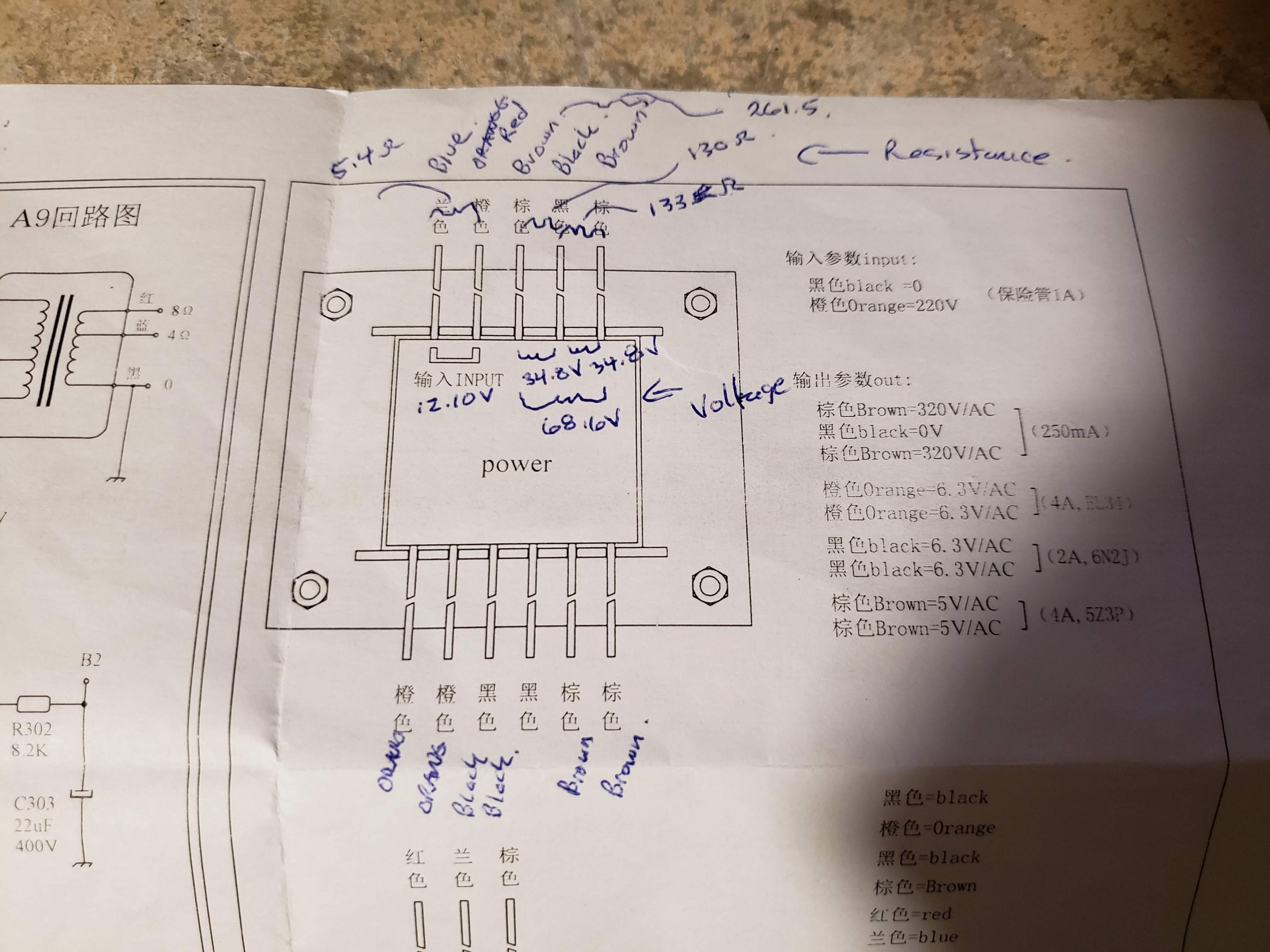

Went with 12V as recommended for the X 10 factor which again makes sense to me (then I don't have to do ratios) 😉
Here is what I get with an input voltage of 12.10 VAC (my cheap variac is quite touchy). From Brown to black (Center Tap - confirmed with resistance measurement first) it is 34.8 VAC on both sides (they agree perfectly). From brown to brown across the whole coil it is 69.5 VAC which is a little higher than the expected 640 VAC across both and 320 VAC for each center tap measurement (extrapolating to 10X). I would conclude from this that it is a 120V-ish transformer as it can't be 220 VAC with those numbers. 😕
Is this actually a reasonable amount of tolerance or should I be getting another transformer? See photos (the 11.99 VAC shot was taken earlier and was difficult to repeat - the meter read 12.1 VAC when I took the other shots (close enough though I think.
Now to do the other smaller voltage measurements for the two 6.3 VAC coils and the 5 VAC coil...
Tim
readings for the other coil pairings are 0.686 VAC for both 6.3 VAC coils and 0.543 VAC for the 5 VAC coil.
Tim
Tim
There are two 6.3 v windings - one rated for more current? Do the colour codes help with that?readings for the other coil pairings are 0.686 VAC for both 6.3 VAC coils and 0.543 VAC for the 5 VAC coil.
Tim
Those voltages look OK to me - once you get the amp built, if the B+ and filament/heater voltages are still a bit high, there are ways to correct the problem (bucking transformer, resistors, etc...) and you can deal with it then. I wouldn't worry about using that transformer, at all.
Sometimes using older transformers from the era of 110-115 AC supplies, I've run into the same thing.
What's your AC supply voltage at your place? 120 VAC? >120?
Thank you John. Yes on the 6.3 VAC - Markings are clear and match on my diagram. There is a size difference in wires as one pairing is for a max 2A load (Black wires) and the other is max 4A (orange wires). The two black thinner wires are for the 1A circuit feeding the heater on the 6N9P while the thicker orange wires are for the 3.5A circuit to feed the heaters on the EL34 tubes as best I can make out...
House was built in 1967 - 115.7 VAC at the socket - that may answer the delta😕
