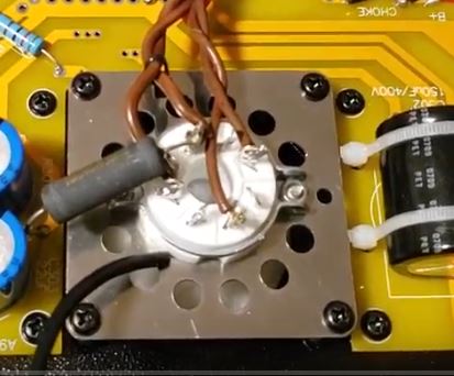

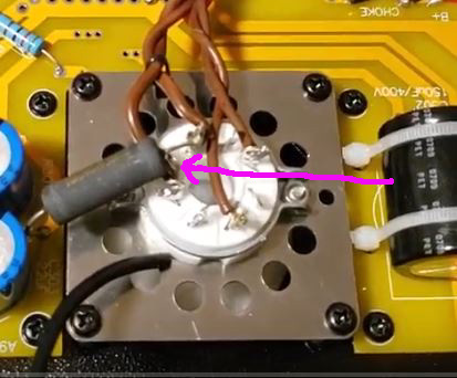

Also, check that power resistor - it's not clear which terminal(s) it's supposed to be contacting from the shot in the video. Bend the leads to position it where you want it. If there's any concern, putting 'spaghetti' tubing or heat shrink on the lead can insulate it from accidental contact. Insulation stripped from wire can be used as 'spaghetti'. BTW, the springy stranded wire that came with my Chinese kit was difficult to route to where I wanted it in the chassis, so I recall using some better quality solid core wire. Hoffman amps is a good source for wire. Push back wire (like in older amps) is really nice to work with....

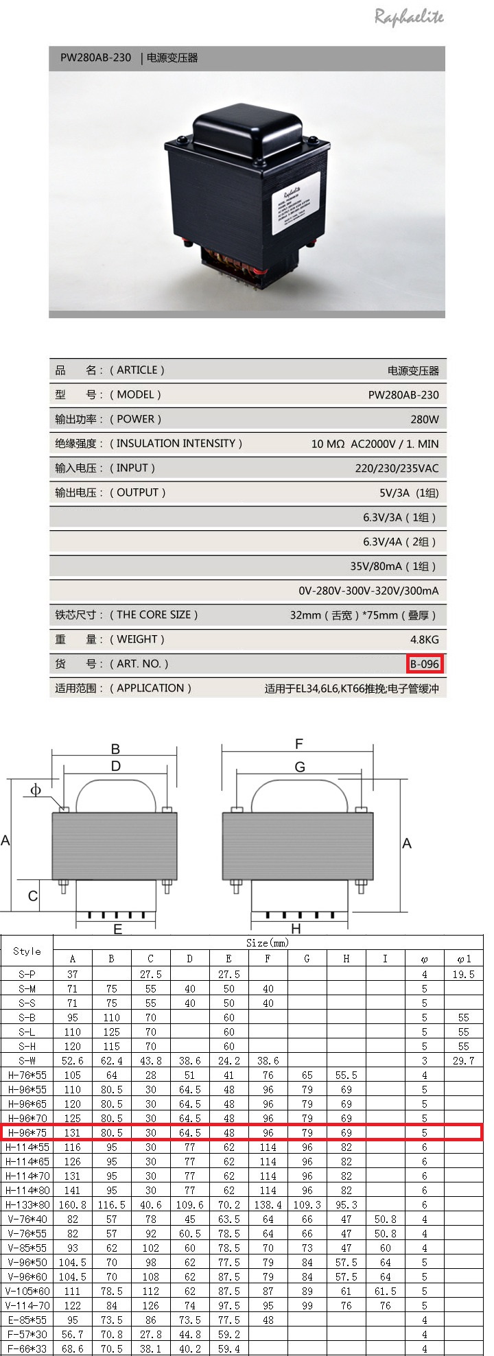

So far, my transformer is on its way to me.Yes, but you may get as the result 7.5V instead of 6.3 😀
I hope he will provide the claimed 6.3 volts. 😉
You have a very good temperature balance in the amplifier.
This was one of the responses from post #525 that evaporated after I tried to "submit reply": The power resistor actually goes to a dedicated marked slot (or hole) on the adjacent PCB - all the rest I have sussed out. Not sure what you mean by the term "spaghetti"? Thanks. Tim.
Yes; agreed.🙂

From the video, the resistor seemed to be quite close to one of the rectifier tube socket terminals. You've probably fixed that by now. I'd also make sure that the other resistor lead isn't too close to that capacitor body (even though the cap has plastic insulation), since the resistor is part of the B+ supply.
