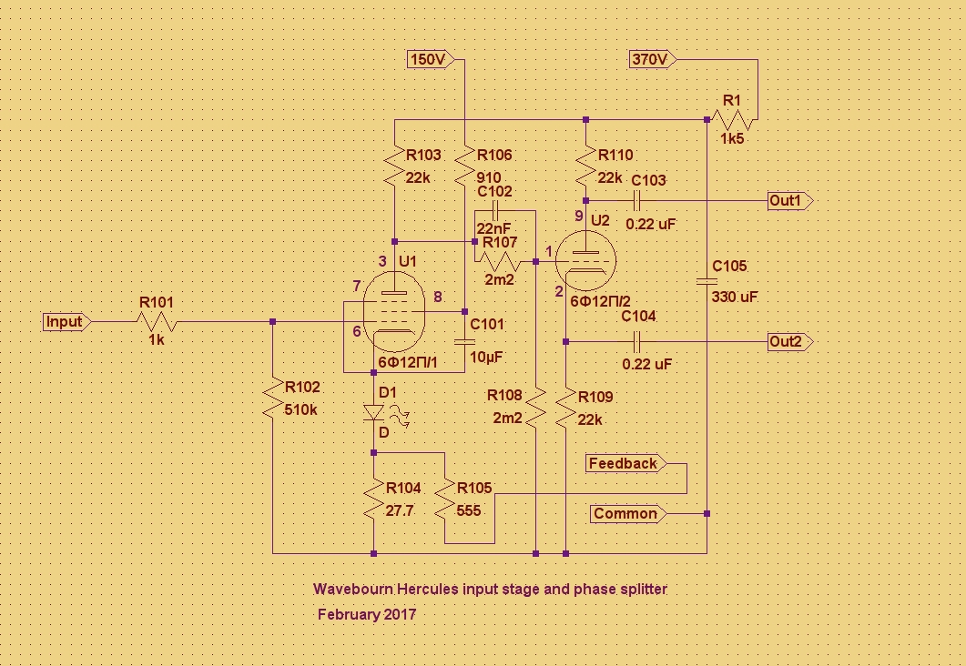

Explain why you need to supply 370 volts of power if the output lamp is optimal for 250,

What 250? Where did you get that?
It is a split-load phase splitter, drives control grids of output tubes, biased to -22V.
What swing on anode and cathode does it need to drive them? What idle voltage between anode and cathode it needs to do that?
Can you calculate that? It will be your answer.
I am even afraid to ask you about "heating the apartment" by 1-10 mA current...

I see the picture, thank you. But can you please answer my questions before we discuss your picture?

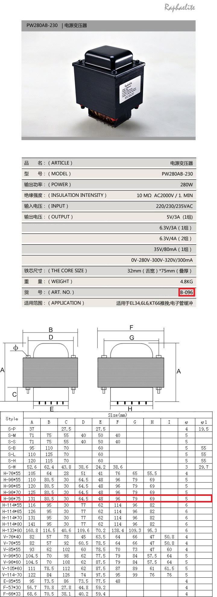

In my amplifier A10, which worked for one month, there was a short circuit between the turns of the winding (failure).
Why did the "boyuu" reduce the transformer power in the A10 amplifier model?

It is DIY Audio, you are free to tweak what you get, for optimal results. Overheating transformers? Well, you need to draw less power. How? Decrease idle current. How? Either increase the value of cathode bias resistor, or decrease voltage on the screen grid, adding one resistor and a capacitor. 1.5 times less power as the result that was promised? Well, it was a wrong promise. And 1.5 times difference in power is barely audible.
I actually chose the A10 because of the beautiful polished stainless steel from which the amplifier body was made. I realized that I would not get any increase in power from the A10. Now ordered a power transformer, which costs three quarters of the cost of the amplifier 🙂 This is called I saved myself from extra money. (Joke).Well, it was a wrong promise. And 1.5 times difference in power is barely audible.

You can check for yourself. 3.5K 10W would mean a RMS voltage as a square root from 35,000, i.e. 187V. An RMS current would be 187/3.5, i.e. about 54 ma, that means peak of 76 mA. If the voltage between anode and cathode is 350V, the tube should dissipate no less than 27W, if it is an ideal tube that can deliver 50% efficiency. Can such an amp produce promised 12W per channel? No way!
I do not chase for power, I am satisfied with 5~8 watts. I love listening to music at a low volume. When replacing the transformer will have to align the mode of operation. Now I can not turn on the amplifier, it sparkles in the transformer.
The optimum temperature of the transformer is 60-65 degrees. Normal is considered the temperature of 60-90 degrees. Most transformers are designed for this temperature range, and the maximum permissible overload temperature is 120 degrees.
If the transformer power is greater than the required, then it is always good. More powerful transformers have higher efficiency. For example, a transformer with a capacity of 3-5 watts may have an efficiency of only 50%, while for transformers with a capacity of 50–100 watt, the efficiency is usually about 90%.
