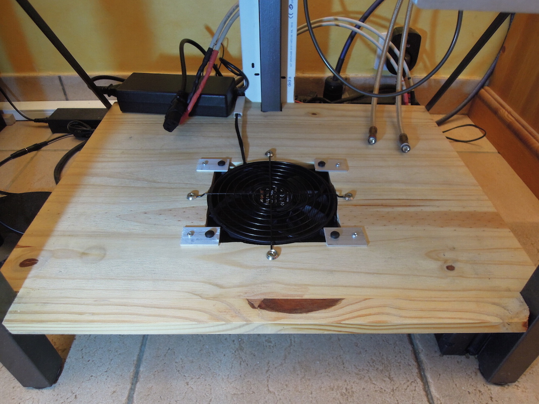

Without load (without lamps) the transformer does not heat up. I bought a transformer in exchange for this. GZbotolave Raphaelite 280W amplifier power transformer EL34,6L6,KT66 push pull tube buffer-in Amplifier from Consumer Electronics on Aliexpress.com | Alibaba Group
There are no other reasons for transformer overheating. I saw that you also cooled the amplifier by placing a fan under it. It is a bad idea to listen to the noise of the propeller.

The fan chosen is an extremely silent fan that normally operates at 12 volts and I voluntarily under-volted at 5 volts DC, which makes it completely inaudible, while refreshing the amp correctly. It increases the longevity of all components, especially capacitors ! And there is no vibration at all ...

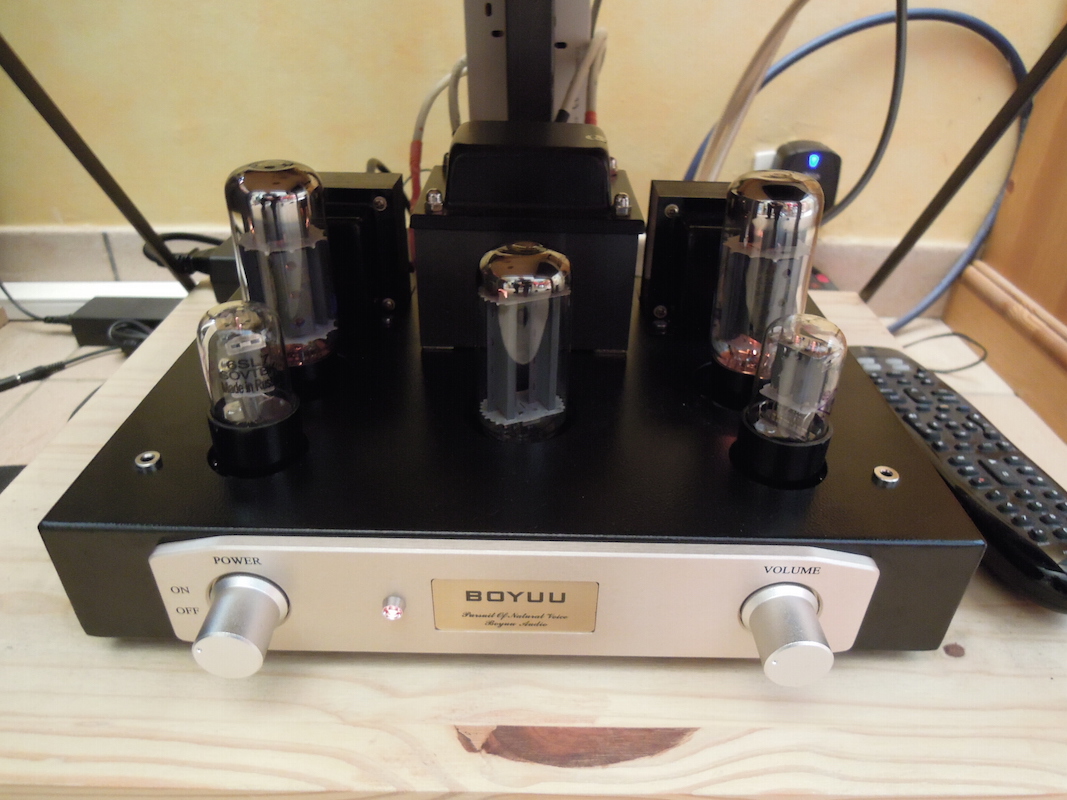

Is there no bottom plate (safety cover on bottom of amp) on the Boyuu? And, are there ventilation holes in the top plate of the amplifier? I don't understand how the cooling air passes through the amp. Well-designed low power tube amplifiers (with safety covers) have operated for many years in the past without fans for cooling......using natural convection cooling when necessary.
With all the major heat-dissipating parts -tubes, and in this case, transformers- above the chassis top plate, does the underside of the amp get very hot due to dropping resistors in the power supply , or ????

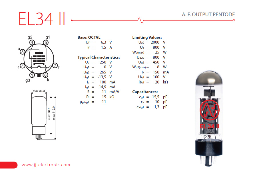

On the power amplifier can give 330v 200ma Maximum current consumption per EL34 lamp 150ma, two lamps need 300ma. The same indicators for the filament of lamps, so the transformer is not stable and is very hot.
Isn't the B+ about 300 volts? (320??) in the A9? Max dissipation of EL34 is about 25 Watts? So isn't the current about 60-70 mA through each tube? (All approximate numbers.....)

I believe if you ever have to put a fan underneath an amplifier to keep it safely cool, then you know one of two things:
1. The amp is being used in an environment that is hotter than the maximum rated temperature specification of the amp.
For example an amp that has a maximum temperature rating of 40 Degrees C, but you are using it in a room that is 50 Degrees C.
2. The amp was not designed very well, it is not safe.
I've seen amps that didn't need more cooling because they wren't safe. No bottom plate=Not safe=Better ventilation !
I fully agree with the second paragraph. Temperature conditions are set by the engineer, You can calculate and prevent overheating when creating a basic amplifier circuit. For the environment from -10 * to + 40 * With proper calculations fan is not required.2. The amp was not designed very well, it is not safe.

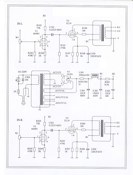

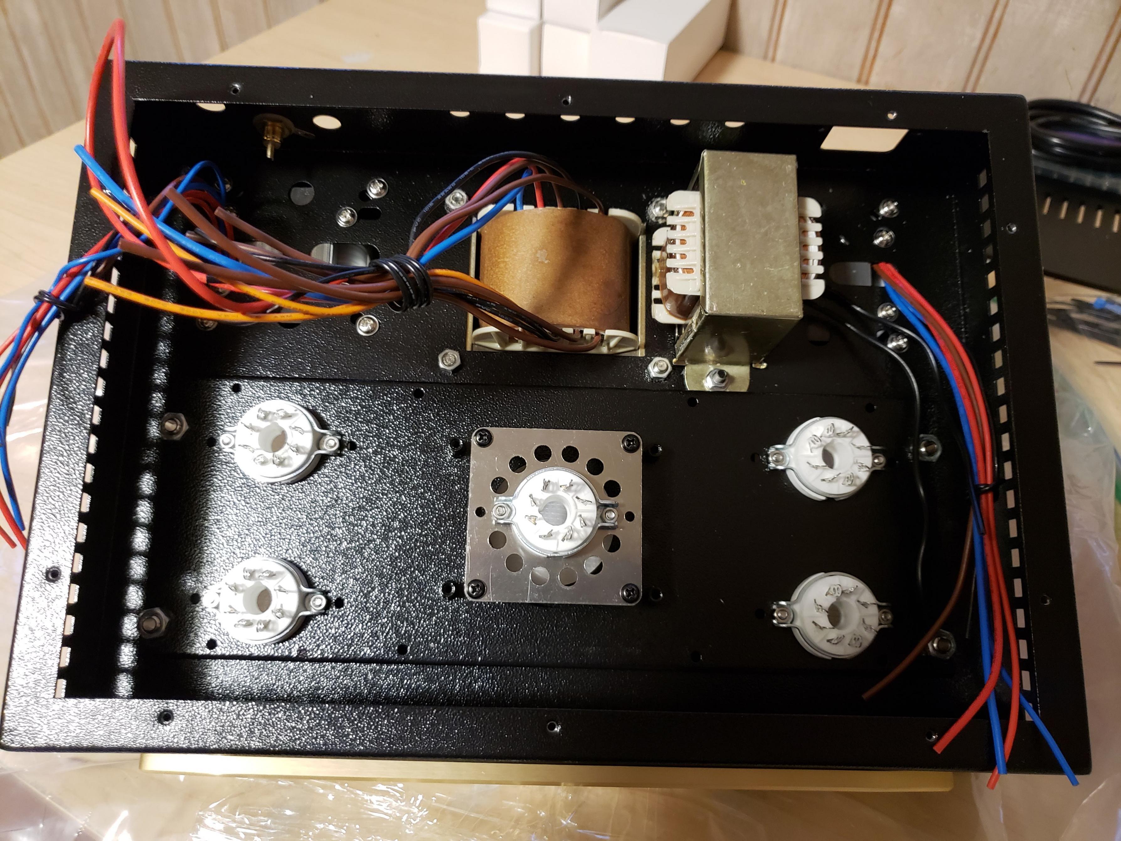

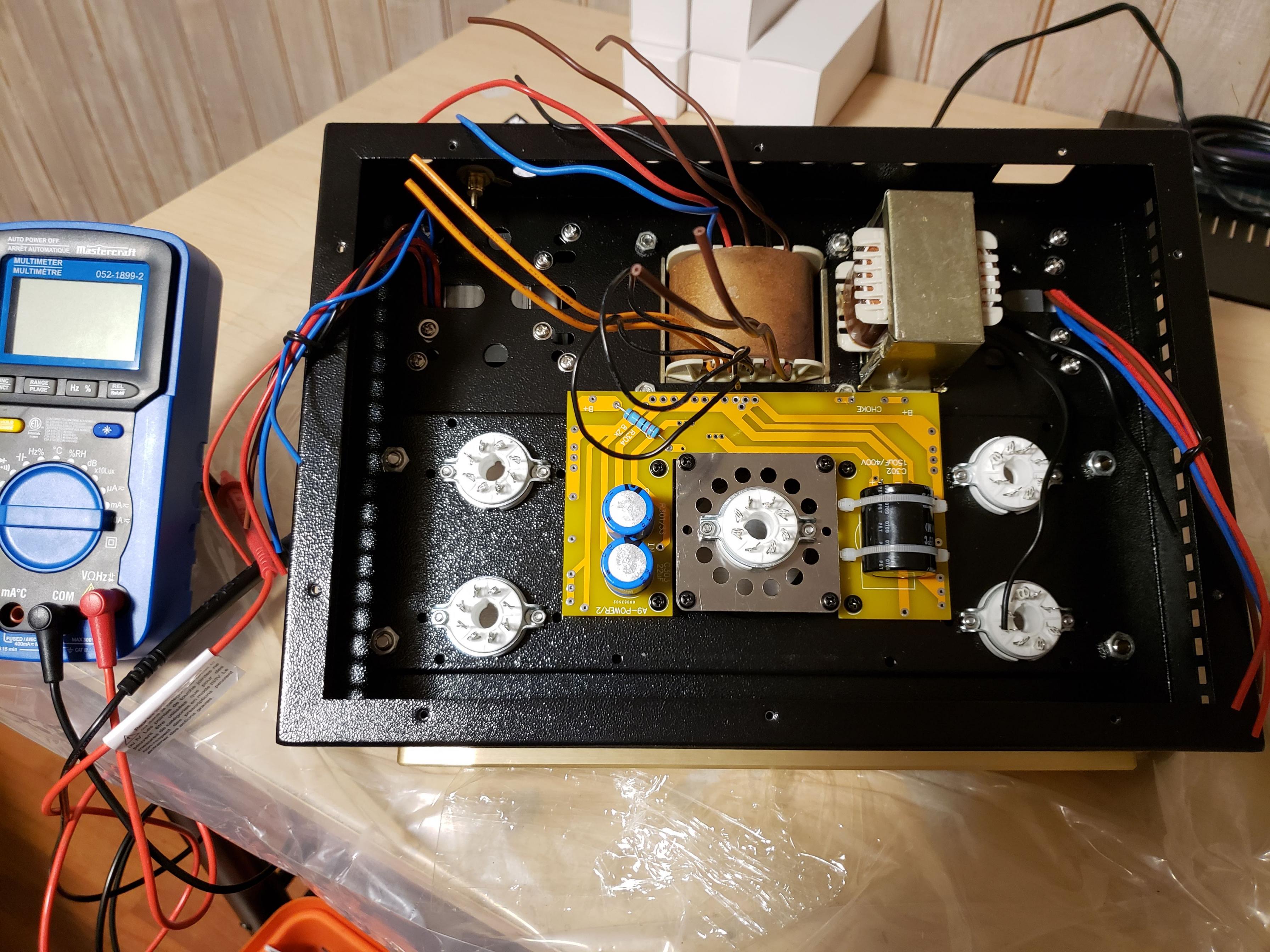

Well folks finally found some time and got the Octal Sockets in plus the circuit board as per the photos (next post). Anybody out there have a 120V schematic as there are significant changes in my unit from the schematics I received (posted on page 44 of this thread)? Colour coding is a bit different for power transformer from the 220V schematic - I believe my input colours are blue and red vs orange and blue. Also I populated the main circuit board which looks completely different from Gidu's pic I re-posted on the same page as above. Both smoothing caps C301 and C303 say they should be 22uF but the ones that came with my kit are 33 uF as per pics (confirmed with seller they did send me a 120V kit and said they would send a 120v schematic by email several days ago - nothing received. Communications is not their strong suit). Here is what I have so far. Anyone have a 120v schematic for the A9?
The amplifier circuit is the same 120 volts and 220 voltsHere is what I have so far. Anyone have a 120v schematic for the A9?
The differences in the transformer.
connect the transformer to the idle and measure the voltage.
I wouldn't believe too much - it's only a matter of a few minutes to check the wires to figure out which winding they are connected to.
And as suggested, once you are sure you have the primary wires, connect them to power and see what AC voltages you are getting on the other wires, to make sure your assumptions about colour coding are right. This is before you connect the secondary leads into the circuit.
I use an old AC 'wall wart' adapter which puts out about 20 volts AC instead of the 120v line - useful for testing and lowers the anxiety level.
Have you built a 'dim bulb' tester yet? It will come in handy later.

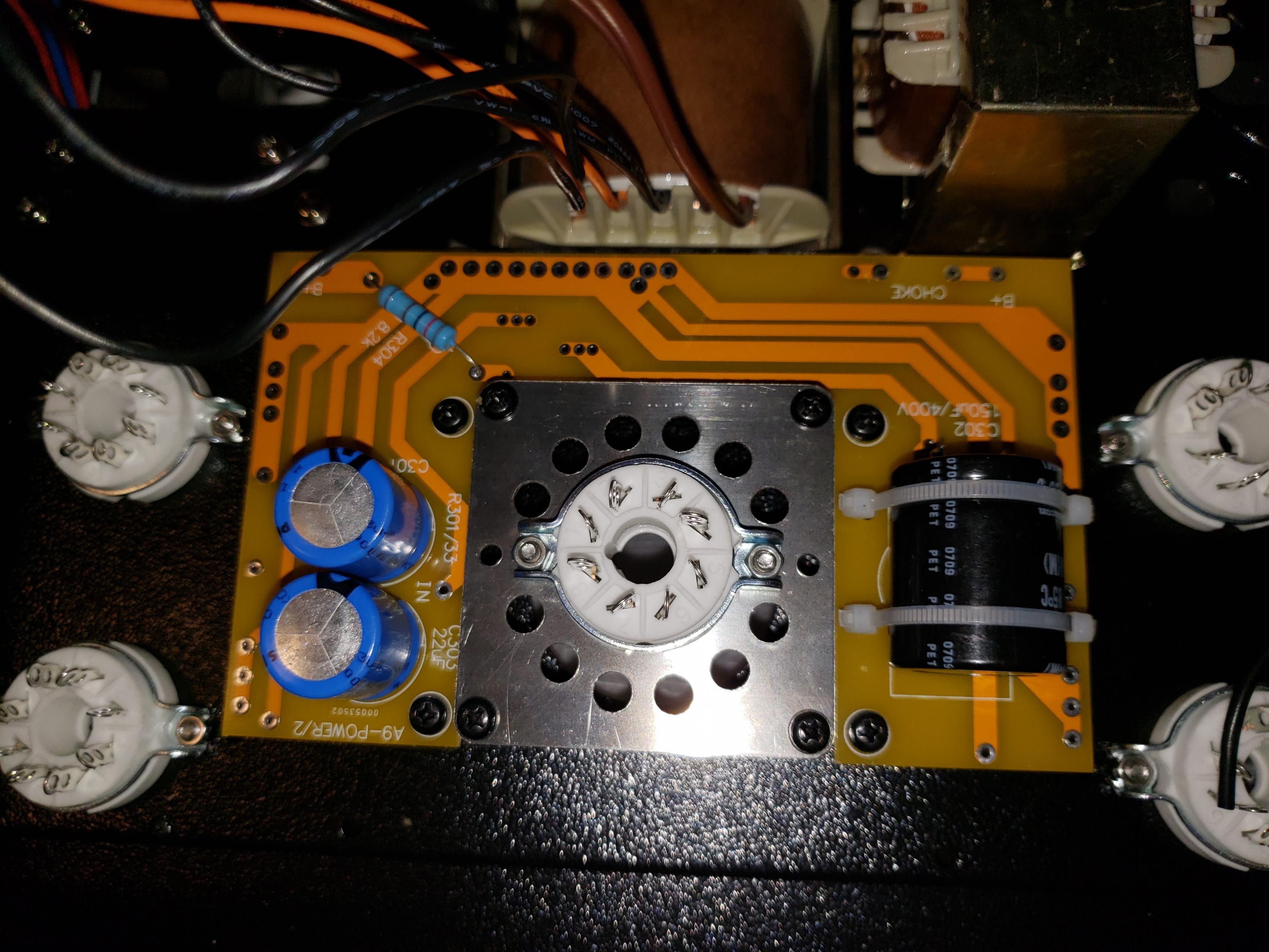

I'd be careful about wiring up the circuit just from pictures.
Also, it looks like a pretty thick coat of paint on that chassis. Make sure the spur washers are cutting through to bare metal when you are bolting components.
Or, sand off the paint at the connection points. A flap wheel in a Dremel is good for this.
As LongRoad said, the amplifier circuit is the same no matter what the primary voltage on the power transformer, assuming they shipped you the 120volt power transformer. You will know that as soon as you check the power transformer voltages. If the heater/filament windings aren't producing the right voltages (3 v instead of 6v, for example) you don't have a 120 v transformer.
Thank you VG - will build a Dim Bulb tester tomorrow as per: YouTube
Makes perfect sense. I do have a Variac that I use for a DIY Acrylic Bending Machine I built. Thinking I could use that to keep the voltage levels way down??? Yeah, the bending unit is far from the safest electrically - thankfully I am not in full production of these and am super super cautious (famous last words): YouTube
I haven't exposed the leads on the transformers yet as I am waiting for a skookum wire stripper that I just ordered so I don't stress the wires trying to hand bomb it with hand strippers as per: Wire Stripper, EONLION Self-Adjusting Wire Stripping Tool/Cutting Pliers Tool with Wire Stripper/Crimper/Cutter, 8'': Amazon.ca: Tools & Home Improvement
Once I strip the wires I will identify the transformer windings as per Uncle Doug's advice (stumbled onto his excellent channel of tube amp discussions/explanations so am learning loads from his videos): YouTube
Thank you for your patience and guidance
Tim
That is what I had thought but what has got me confused is the fact that the three large caps included with the kit are of completely different values from what is called for on the large PCB I have installed or the 220V schematics thinking I was missing something critical- I was thinking that maybe a 120V schematic would show values that were maybe more appropriate for 60Hz North American operation vs 50Hz Europe etc.
I was actually thinking about that (Paint is quite thick) - of course since there is no build diagram that comes with the unit I have no clue where the critical grounding points are to the chassis to do this are. Are you talking about the banana plug adapters for the 0, 4 and 8 ohm sockets (I don't really see any spur washers in the kit other than on the plugs)? Not sure also where on the chassis I would ground items as shown in the schematics - where I ground these items is not readily obvious to me????
This is why I was hoping to see more pictures to get a feel for the construct - I already know that my PCB board is different than other photos I have seen in this thread which of course means I have to be careful in the build - thinking that dim bulb tester is going to come in super handy😱
