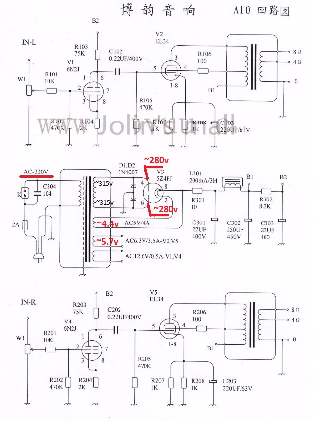

mmm, I see, maybe some of the kit builders can say if there are ,or not, 6.3V filament UNDER LOAD,See Chart, red indicates actual voltage.
I think you do not understand electrical circuits. Operating voltage should be 315 V. The operating voltage of the incandescent lamp is 6.3 V, pentod 5 V The transformer is wound with a thin wire that does not allow to hold the operating voltage. The voltage drops and the transformer heats up. Thicker wire, they can not use because of the size of the transformer. The Chinese simply fooled with an amplifier "Boyuu A10" put a transformer in it weaker than "Boyuu A9" Make sure it has a transformer 96x60 it's a lie!
I think You do not catch my comment, we are two people using a foreing language , it can happen.. I mean, if the Xformer is inadequate and sag under load, You caculate 5.7V instead of 6.3V in one of the secondaries, people that already have the thingy running, can tell if it is so.
You calculate 5.7V instead of 6.3V in one of the secondaries, people that already have the thingy running, can tell if it is so.
Is it a calculation (from theory) or an actual measurement with an AC voltmeter on an operating amp? And A9, or A10?
I apologize for my englishI think You do not catch my comment, we are two people using a foreing language , it can happen.. I mean, if the Xformer is inadequate and sag under load, You caculate 5.7V instead of 6.3V in one of the secondaries, people that already have the thingy running, can tell if it is so.

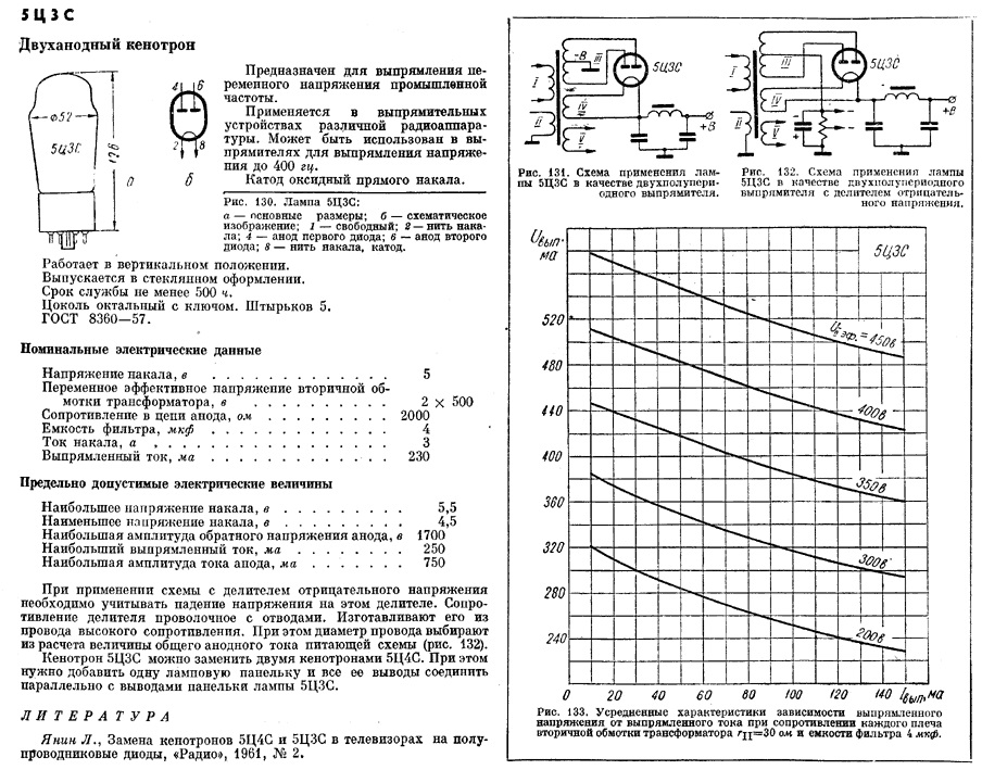

it is very difficult to find information for you in English, the lowest allowable voltage of the kenotron 5z3 = 4.5 volt
The voltage of the filament and the working voltage can sag a little from the stated, but not so much, there is an obvious constructor oversight.

The Boyuu A09 amp and the A10 do not use the same input tubes: they are 6N9PJ (Octal) on the A09 and 6N2J (Noval) on the A10 !
And the intensity of the heating circuit is not the same on these two tubes: 300 mA under 6.3 Volts on the 6N9PJ and 150 mA under 12 Volts on the 6N2PJ which makes a difference of 300 mA for both 6N2J tubes compared to 6N9PJ, which may explain the respective size difference of the two magnetic circuits that equip the A09 and A10 !
The voltages that you have noted, both the non-rectified HT and the voltages of the two heating coils are obviously abnormal, which, combined with the exothermic heating of the supply transformer, seems to indicate a downstream leakage current that it is necessary to investigate.
I think that first you have to remove all the tubes to check again the no-load voltages: if the voltages return to their normal level (or if they are slightly higher) and that the transformer remains warm (the hand can remain above !) is that the problem does not come from the transformer !
Then, at first, put back in the 5Z4PJ rectifier valve and re-check the voltages: either they go down again and the valve is probably at fault or else the filter capacitors behind (C301, C302, C303 to check !).
Check also the two IN4007 diodes with an ohmmeter !
Either the tensions remain correct and the transformer remains warm and then you put back both EL34 one by one and each time you check the tensions: if they lower by putting one of the two tubes, it is either this tube is bad or the polarization of the latter which is faulty (check R105-205, R107-207, and R108-208), and check also C102-202.
There, we should have progressed well !
And unfortunately, if your power transformer has heated to the point of smoking, it may be necessary to change it anyway, after finding the reason for this overheating, of course!
Do not forget to take all precautions required for your safety, the high voltage on tube amps can be lethal !
Good luck and keep us updated !

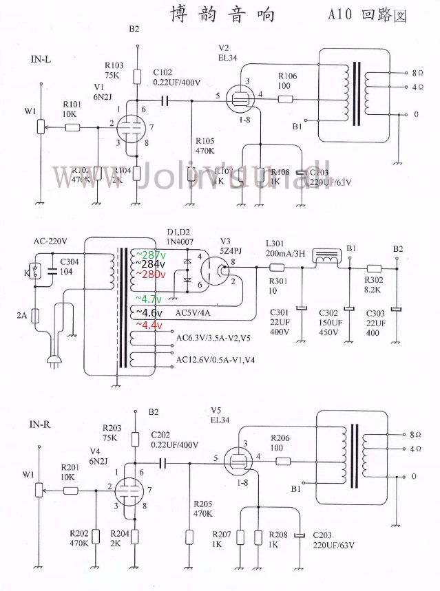

Thanks for the help me
Power supply without all lamps = 287v
Power supply without 5z4p = 284v
Voltage under load with all lamps = 280v
5z4p Lamp voltage under load = 4.4v
Without lamp 5z4p = 4.6v
without all lamps = 4.7v
Even so, I think the matter is the insufficient power of the transformer and the inaccurate calculation of the operating voltage on it.
If I'm wrong, correct me please. Thank.

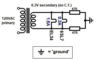

Have a look at the attached schematic. It shows the simplest type of heater wiring for two tubes (an EL34 and a 6SL7) using a 6.3V AC secondary with a center-tap. (The schematic is stolen from Merlin's Valve Wizard site and then doctored for this purpose. I hope he doesn't mind.) Notice that the transformer secondary winding is center-tapped, and that center tap is grounded. That means there is 3.15V AC on either side of the center tap, which together makes 6.3V AC across the entire secondary winding.

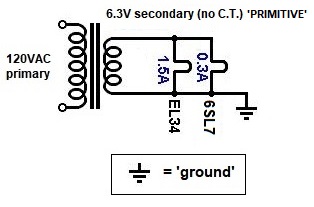

Attached to this message is a schematic of the same heater supply as in the previous post, but now using a heater secondary winding that has no center tap.
Note to where the ground symbol has been moved.
It is critical that the heater supply is grounded in one place only.

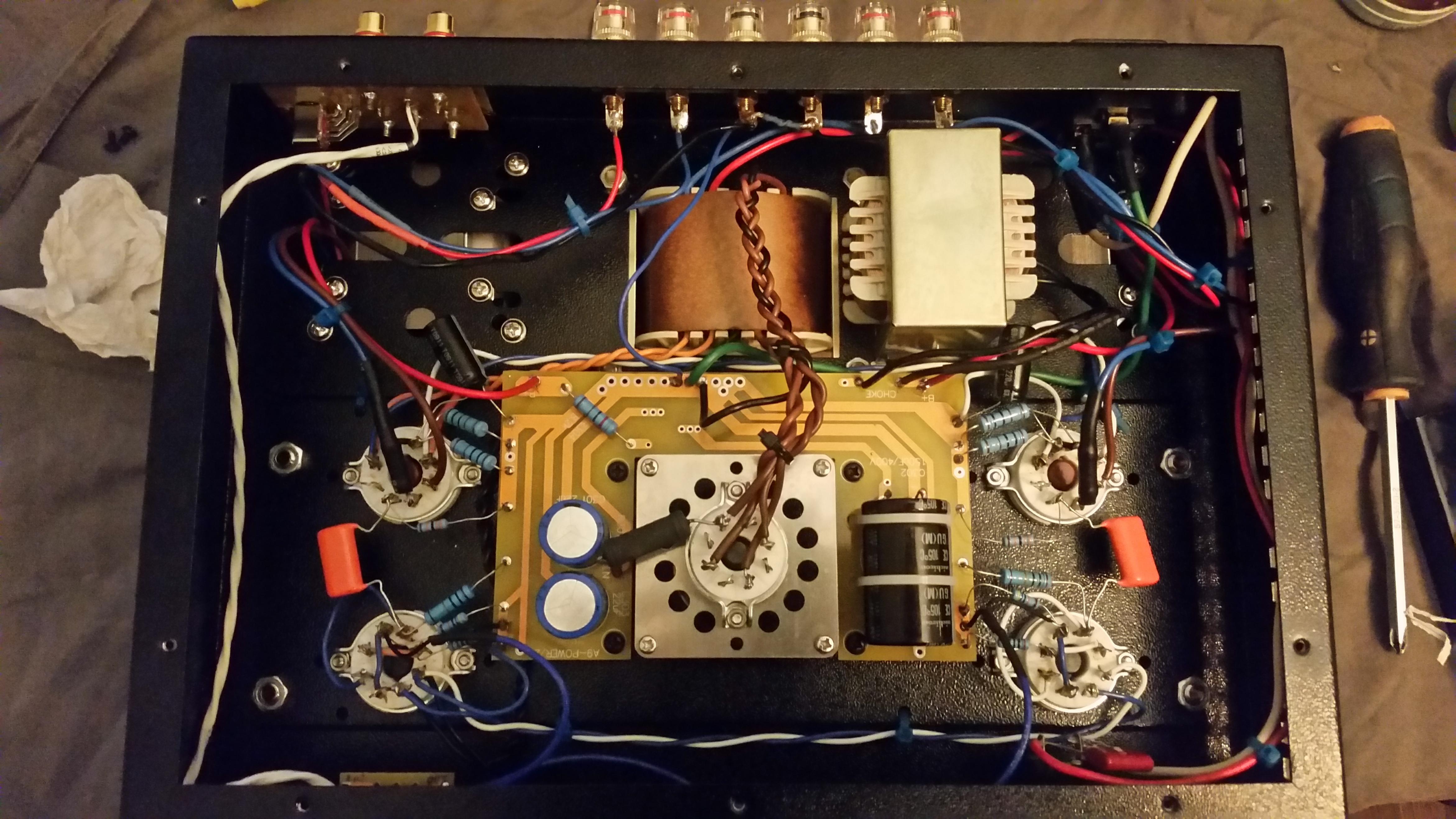

I've uploaded a picture of my a9 showing the wiring. On the 6n9pj tube the heater wires go terminal 7 and 8. I have a blue wire going from pin 7 to ground on the board. On the El34 they go on pin 2 and 7. i have a white wire going from pin 7 to ground on the board. The amp plays this way.
Thanks. I understand. What you're doing is this (in the attached schematic labelled 'PRIMITIVE').
Yes, that will work.
It is not the best way to wire an AC heater supply.
Adding resistors to that type of circuit will do little to nothing to reduce noise from the heaters.
The better way is with two resistors connecting from either end of the secondary winding to ground, creating a resistive center tap for the primary winding. Merlin B calls this an "Artificial Centre Tap":
I got that from Merlin's excellent page on Heater Supplies. The page is written for people who want to design tube (valve) guitar amps, but the concepts for a hi-fi power amp are exactly the same.
The Valve Wizard
Read that, and you should come away with a much better idea of what's going on in your Boyuu amp.
