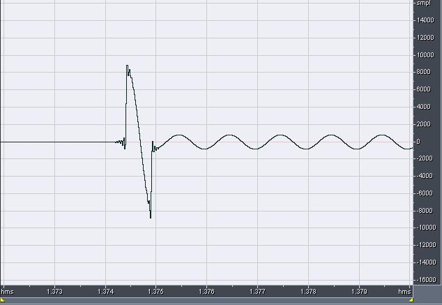

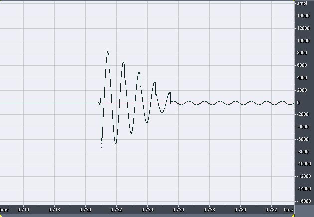

Comb filtering from a single reflection or diffraction event will cause ringing in the time domain ? How ? 😕A standing wave is a poor counter example as it, like the OB example, is the response of two sources: the sound generator at one end and its far end reflection. In any case, we will see ringing in the time domain whether the cause is comb filter cancelation or mechanical system resonance.
Smearing in the time domain yes, since some of the impulse energy arrives delayed in time, ongoing ringing at a spot frequency like a high Q resonance due to standing waves I can't see how though.
True, a single reflection doesn't "ring" but does have a messy time response. We also know that cancellations due to reflections will be perceived as having a distinct pitch.
I tried some convolution in Cool Edit Pro with a single reflection nearly cancelling a 1k interupted tone and also a 5 reflection combo cancelling the same tone. In the second case the primary convolution impulse was 50% and then 10% impulses at 0.5, 1.5, 2.5, 3.5, and 4.5 mSec. (The half delays assured cancellation.)
Multiple reflections looked more like the tone ringing you would expect. Certainly back when magazines published tone burst measurements we saw a lot of long term ringing.
I'll have to think about the reason for that.
