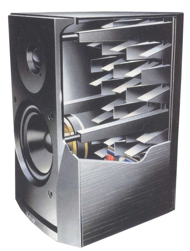

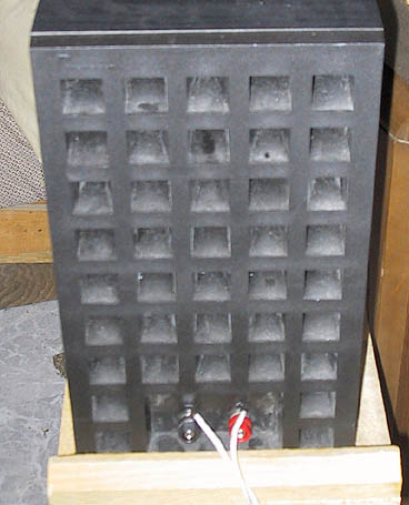

I have another idea for box construction. I was thinking about what could be done inside the box to reduce the impact of mids reflecting of cabinet walls and I'm wondering if a scaled down diffusor wouldn't provide some benefit when combined with absorption.

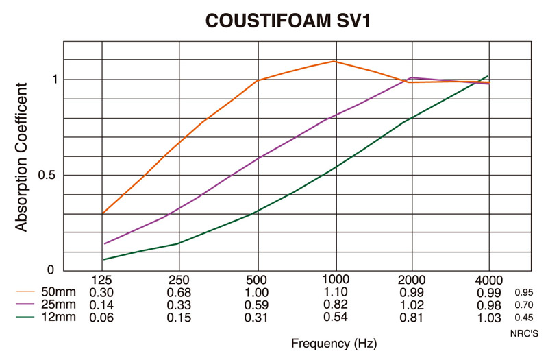

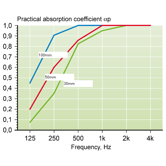

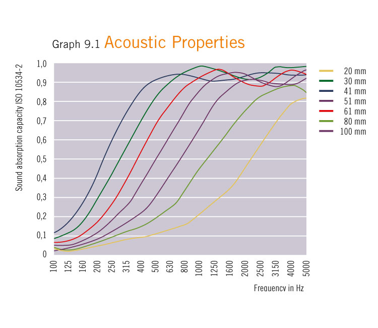

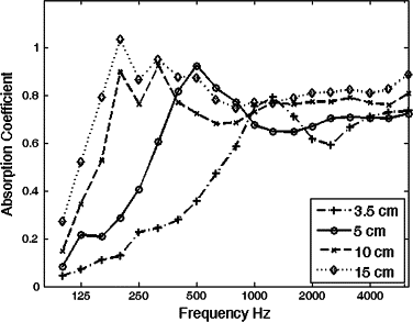

Facts on acoustic absorption
Since most of this discussion seems to be centered on the absorption of internal cabinet reflections or standing waves, let me give you guys some ideas to think about. I've attached a couple of graphs showing absorption quality vs. material thickness. These are for some high quality foam absorbers and the usual rock wool and fiberglass.
As you can seen material thickness is key for a low absorber cuttoff. Every time you double absorber thickness you achieve an extra Octave better performance. We might just put a 2" material lining around the inside of our cabinet and see that anything above the 500 to 800 Hz range is over 90% absorbed. Is that good enough?
It turns out that we need to absorb down to the 1/2 wavelength of the longest dimension. A closed box will have 1/2 (and 3/2 and 5/2) wave resonances for every dimension (LWD) so the most difficult one to absorb is the 1/2 wave of the longest dimension. If we are thinking about a 40 inch tall tower cabinet it would resonate at about 170Hz. Looking at these graphs I can see that about 200mm or 8 inches of these materials would be required.
That turns out to be about 1/5th of the cabinet height. In fact, for any cabinet length or height that we can think of, as the cabinet gets longer the depth of treatment will also grow exactly in proportion, so we can simply state that an end of cabinet depth of treatment of 1/4 to 1/5 the wavelength of the particular dimension will always be needed but will also always be sufficient.
It also turns out that less material will suffice if it is spaced off the boundary. Architectural acousticians know this and save money by spacing absorbers off of the wall and ceiling. Many architectural materials will give data for "E400" mounting. This is the absorption quality of a material spaced 400 mm above a hard surface, which is the average spacing for a drop ceiling below a true ceiling. Such measurements are usually pretty close to having the qualities of the full 400 mm of material but at a considerable cost savings. So our 50 or 100mm material might work pretty well if we space it 1/4 wavelength off of the bottom or back wall (always 1/2 way down the cabinet).
I'm talking about real absorptive materials such as Rock Wool and Fiberglass, not BAF or Dacron pillow stuffing that have near zero absorption.
In the end it isn't hard to absorb the internal acoustical waves in a speaker cabinet if we use the right materials and take care. Airborne and structural born cabinet vibrations are another matter and perhaps we should be concentrating on them more as they are more likely to cause cabinet colouration.
