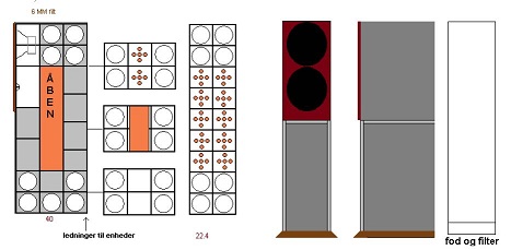

Aerolam Reinforced Aluminium panels are probably a bit exotic for most of us. Here's a Steen Duelund "Matrix" type closed box design made of MDF I suppose.
One of Steen's hobbyhorses is the glue holding the matrix must be a slightly soft type to give a path for energy to dissipate. But for sure, the matrix holds the wadding in a way that encourages energy absorbtion. I don't think I'd go quite this far, but the idea is useful. Notice the empty cavity in the middle. Discontinuities like that encourage scatttering.

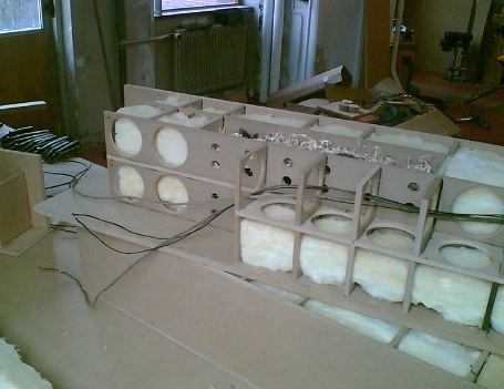

When it's all finished.
so when you said that's how you build 'everything and have for ages' you mean you haven't ever finished anything or you mean the special pipe out the back for the mids is a new adventure for you and haven't got anything to share yet - I'm confused
No, I've built lots of boxes this way (matrix bracing), including the last lot of PA speakers and a couple with the mid tube. My mains are Unitys and don't need the mid tube and I won't bother with it for the surrounds now. The design I have for the bedroom speakers will use if for the MB and MF, but that is last project and receiving less effort now as I collect the parts slowly as budget allows. However, my design will probably not translate to other designs, so you'd be far better off to visualise how to apply the principle to what you want to do. My bed is very tall, so the speakers will be too, so they bend through 90* and head towards the floor so can be longer than most people could use this way.so when you said that's how you build 'everything and have for ages' you mean you haven't ever finished anything or you mean the special pipe out the back for the mids is a new adventure for you and haven't got anything to share yet - I'm confused
I am not much of a photographer and didn't even own a camera until recently and didn't feel the need to document stuff for other people, so I never took pics. Because I'm still not much of a photographer and have decided on what I'm doing with the current designs, I will post it all when I'm done rather than discuss it as I go as I find that distracting.
