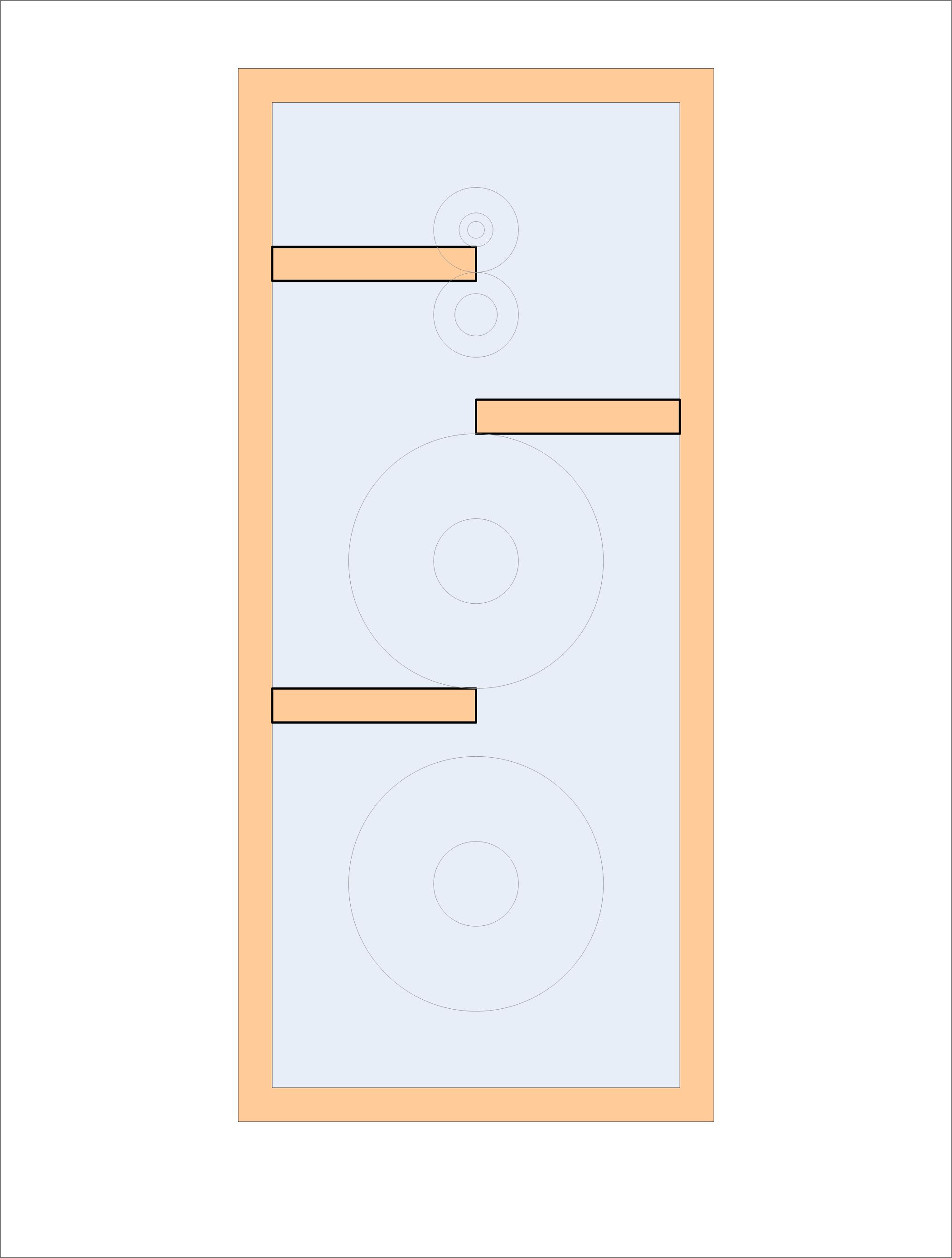

What about building in some internal baffles to effectively break up the resonant spaces into smaller spaces?
Assuming you will put the woofer in the top of your cabinet as drawn, I think you are still in the same boat. The divided spaces you create will be resonant in the frequency range wher your damping is already very effective. The issue is effectively treating the lowest modes and you will still have a mode due to the longest path from top to bottom. It may be a little longer/lower with the zig zag path of your labyrinth, but that only makes the treatment situation slightly worse.
David

Um, I actually don't have the woofer at the top - does it look upside down to you?
My understanding is that resonances require two unimpeded parallel surfaces. With the intermediate baffles, yes each will form a smaller resonant space, but the longest path would be without these requirements.
Reflections would still mostly be diminished with the top and bottom absorption material you would have already used, with only the middle space now needing it.
You're definitely right, it would have problems - I'm just wondering if they would be less or more problems than without.
It would be an interesting thing to try, IMO.
