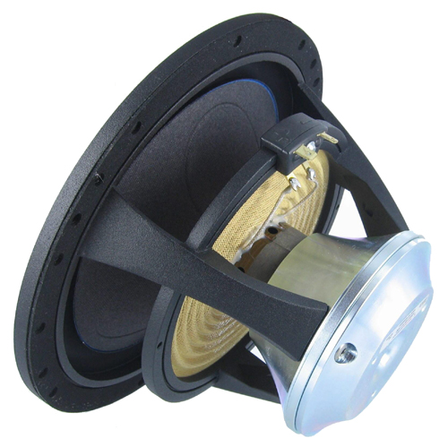

I wonder why more drivers aren't made like this:

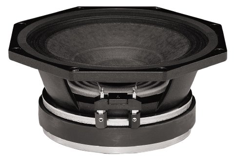

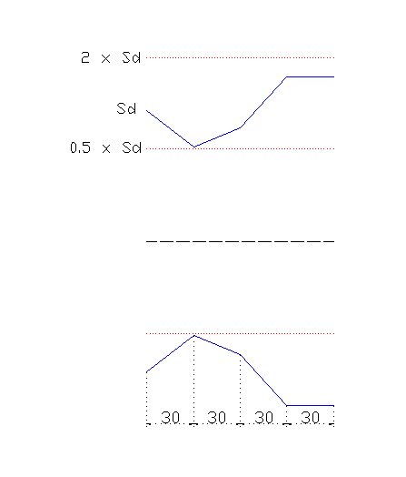

I was wondering about a restrictive magnet producing a horn throat and I created an example using the B&C 8PE21 8" mid.
The blue lines show the cross sectional area from the cone and around the magnet. Starting from the left with the cone area of 220cm^2, the next step is the basket cutouts converted to an equivalent circular cross section. The third step is the box area minus the magnet area, where the box is the smallest square box the driver cutout could fit, converted to circular cross section. From there is the box itself.

I'm going to be trying a BD BD15 as a dipole mid in place of my current setup with dual 6.5"s (Ceramic/Neo hybrid... with motors a lot like the B&C above), for the very reason above- the cone is minimally obstructed on the back relative to the front. Additionally the 15" has equivalent efficiency but an octave lower Fs and somewhere near 10dB more clean output and a smoother top end breakup (not that it matters with a 1k filter)
This is for 250-1kHz.
BD-Design' BD15
Magnet size or diameter is no primary factor in frequency response differences between front and rear of a dipole driver. As Siegfried Linkwitz has stated for years at Models for a dipole loudspeaker design, it is the "acoustic filter formed by the basket openings and trapped air between cone and basket". Together with the spider they build up a cavity, which acts as a Helmholtz resonator.
An open basket is better than wide braces, a small spider is better than a wide one, and a deep cone is better than a flat cone.
Rudolf
so bigger is better afterall when it comes to drivers - as it generally provides a more open space behind the cone.

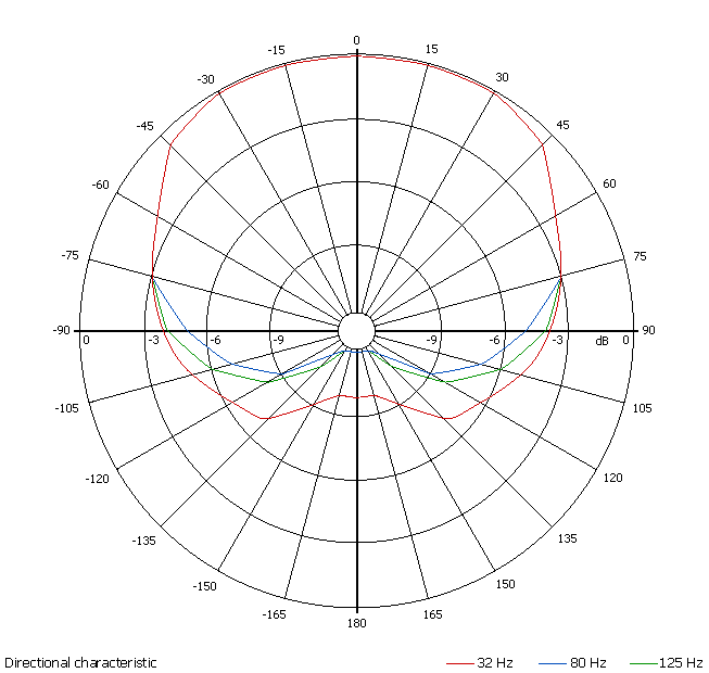

Here is a speaker with 2 large holes in the back:
RL 901K
It produces a nice cardioid response at 32Hz somehow but that is all I know about it.
Interesting - yes this is what I'm talking about in terms of another technique that may influence box/room colourations.
In the case of the RL 901k it appears they went for back-wave in the bass to optimize room behaviour.
