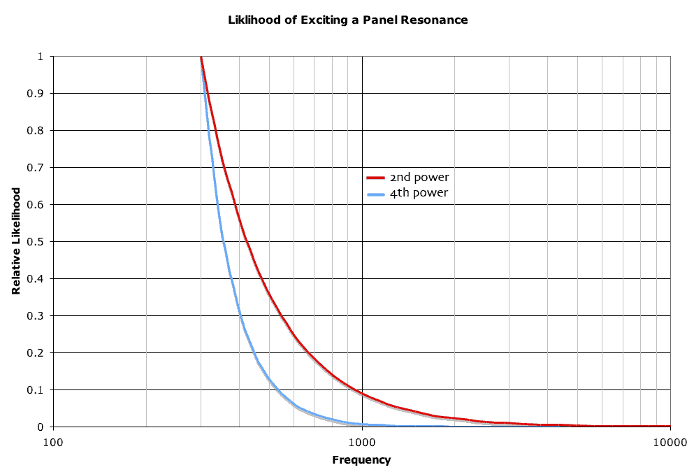

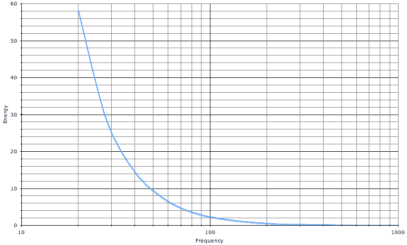

Studies have shown that resonances are more audible at higher frequencies and typical cabinet construction can't possibly push the resonances out of the audible band.
But a high frequency box resonance is less likely to ever get excited. Energy available to excite the resonance is inversly proportional to the square of the frequency. An argument can be made that it is actually more like inverse to the 4th power of f. And if the resonance that high is high Q it is even less likely to get excited, because a lot of continuous energy needs to be pumped into to get it going, and this is very atypical of music.
This is a chart i made of a curve starting at 300Hz = 1 (the hinge point for the 4th power argument), showing the decrease in energy for the 2nd & 4th power reductions (for comparitive purposes only), below that one from Linkwitz that will likely have a greater relation to real numbers. They show that one only needs to get the panel resonace up, not out of band (given that most of my stuff is FR not possibly with practical tech)
If a resonance is never excited then it is if it does not exist.
dave

I believe that viscoelastic energy dissipation is a frequency dependent hysterysis - so moving resonances to higher frequencies makes any damping we apply even more effective. Not sure how this combines with your 4th order chart Dave, but it could make it even better.

Not buying any of that. I've seen plenty of box resonance measurements and the Q's tend to be the same for resonances in any frequency range. Sowter and Harwood also took measurements of cabinets of essentially the same design but varied panel thickness. As you would expect doubling panel thickness doubles resonances (mass doubles and stiffnes is times 8 so primary resonances double). Most of the discernable resonances just shifted up in frequency, non disappeared.
The cabinet vibration curves I've seen are all done with constant voltage and tend to show pretty constant energy (peak level of resonances) well up through the midrange, so a sine sweep has no problem exciting higher resonances. The spectrum of music is fairly flat, especially if maximum energy is considered so an upper range resonance is as likely to be excited by music as a lower range resonance.
If bandwidth or Q don't change then the resonance width is not a function of frequency. (percentage width or width expressed as a fraction of an Octave, higher resonances are actually wider in total Hz). An upper range resonance is as likely to be excited as a lower range resonance.
I hope you are not talking about missing resonances by placing them off of the notes of a 12 tone scale. For those that are intrigued by that consider:
All transients will be broad band or noise like in nature. Most instruments, and especially percussion instruments, contain a lot of energy "off the notes". Plus people and instruments frequently use vibrato so they will wobble about a key (or, before autotune, just be off key). Plus instruments drift in pitch with environmental effects.
Plus you might pitch a single fundamental cabinet resonance between 12 tone scale frequenciess but harmonics of the resonance are not integral multiples of the fundamental, so they can't all fall between the notes (the same even applies to piano strings).
Finally, Harwood conducted his own listening tests and found that resonances at higher frequencies were more audible rather than less.
