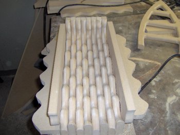

I do like the diffusor ideas still - I found another person who has implemented it.... first time I saw smoothed wooden surfaces instead of sharp angles
http://www.htforum.nl/yabbse/index.php?PHPSESSID=ahumoi0fmhm1gu74f2sq0apc81&topic=41295.0

Can assure you the real Cremonas don't look anything like that inside (I have looked in mine) but the idea is quite interesting all the same.
I'm not seeing how that is a diffuser, it's far too regular. Is there any empirical evidence that these sorts of structures inside an enclosure make the slightest difference beyond reducing enclosure volume?
Again, if you use absorption material that works then you will loose 99% (literally) of the energy trying to go through and bounce off the surface beyond.
If the material is inadequate then it will be so at the lower frequencies and the 1/2 wavelength resonance will be the least fixed by the damping material. The diffusor shown hasn't got enough depth to deal with any longer wavelengths. It would only provide scattering at frequencies where any absorber would do a great job.
These are cures advocated by those that neither understand the theory nor have done the measurements.

hmmm, so maybe diffusors are a crock, unless the box is big enough that it is more like applying a room treatment !
