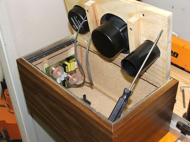

Also below is a regular sort of reflex box that is quite well thought out IMO. The bracing reinforces the solid timber front baffle where the grain is weak. The rest is chipboard I think. I still like the AR-LST shape. Seems a good compromise.

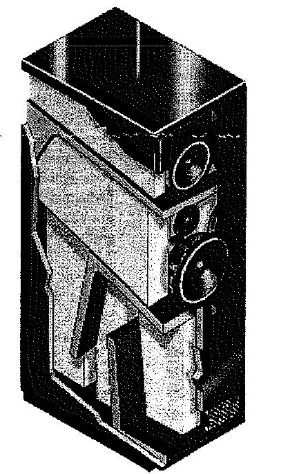

Just for interest, here's an established design using a tapered transmission line for the midrange. A sort of heavily damped cheesewedge open at the back. The Fried Studio V. FWIW, it uses a series crossover too, but we won't go into that. LOL
