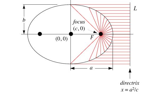

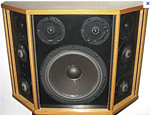

My feeling is you can get rid of all the diffraction problems by mounting the box in a flat wall. Lets suppose the wall is a piece of granite, just because it's about the toughest most inert material I can think of. We might compromise with brick. 😀
Golden ratio (approx 5:8:13 cabinet dimensions) is right for sure, because that spreads coincidence up to the 5th harmonic if you do the math. No cabinet or diffraction problems to worry about.
I'd guess all you then need is some evenly distributed stuffing to kill off the resonances. I might question whether the box or cavity behind the driver would better be some sort of flattened egg shape. Elliptical at heart. It could even be a horn or transmission line facing the outside world behind the speaker. You the listener would of course be ignorant of what is in the wall or behind it. You'd just see the driver mounted in a flat wall in your room.
Did anyone mention that low inductance and small drivers makes life much easier with crossovers. Time alignment good too. 3 way even easier. And don't forget to apply similar damping to your room as you do the speaker cabinet. 😎
Enclose some random images to keep us thinking.
