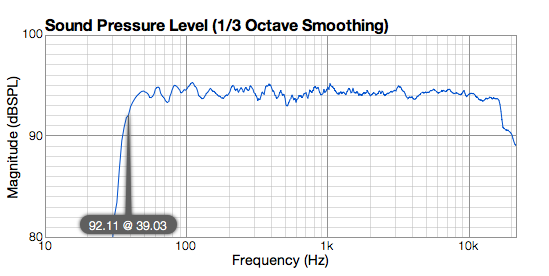

Hi Markus, I too am of of the opinion that 1/3 doesn't describe everything there is to know about sound. Our hearing is a LOT more discriminating both in time and frequency than most studies reflect, especially our subliminal hearing... which almost no one has studied because it requires a lot of brain-wave measurements.
However, I'm also not in agreement that 1/3 oct. data is worthless and that the use of 1/3 oct makes a measurement invalid. Especially when said 1/3 octave data doesn't look all that different from the 1/12th data excepting it's prettier to look at.
Below Schröder frequency 1/3 is too coarse. Ask any of the "veterans".
As for missing any data that would prove my claim, I clearly disagree with your stance.
Although the data I have chosen to show here is limited, it is a subset which IS representative of other datathat I have on hand.
You didn't show any data for a boxed speaker, so there's nothing that could be compared.
I could present reams of data, but this is not the place for that! I'll be happy to present more information, but please allow me to do that in the Vendor's section rather than doing it here. (I wish to respect the forum rules).
Please let me know when you post that data. Or, even better, upload the FuzzMeasure file(s).
As for averaged response across many points, and deviance from the average, that's one of the criteria I study the most. It's hugely important. Again, I'll be happy to post the data for this in a more appropriate place. But I will say the OB I've referenced here does pretty well in that regard.
I'm not interested in averaged data. I'm interested how similar the response is across a certain area and if the response is equalizable (minimum phase behavior). Averaged data is - like 1/3 smoothing - just sugar-coating.
So, to bring this back on-topic, my contention is that while cabinet resonances and panel resonances are indeed audible, and desrving of solid construction, damping and bracing, that the room resonances are even more important, and that OB reduces the room issues significantly.
Hope you will back up your claim one day. Until then it's simple conjecture.

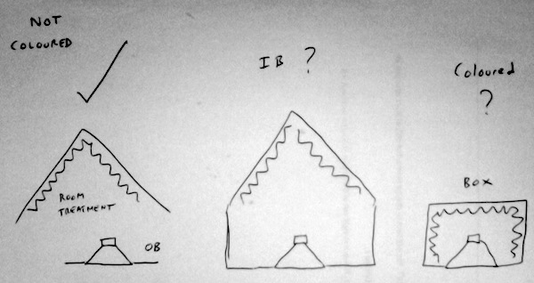

I'm trying to keep up with this all but there's lots of stuff here that I can't relate to box colourations.
What I'm seeing is opinions that an OB, with lack of a box moves the 'issues' to the room. So there's no free lunch. And when you are listening from further away from the OB, where direct radiation from the drivers no longer dominates, you are going to experience a lot of reflected sound which won't have the same spectral content. There are benefits but the whole situation becomes more complex to optimize. StigErik 'solved' this problem with significant room treatments, absorbing as much of the reflected back wave as possible. This makes it an IB rather than an OB ?
So, what does a box need to look like so that it behaves more like an IB than a box. Simplest is to make it huge - the room comes with the speaker drivers. Is it enough to make it large, or does it have to be aperiodic - ruling out bass reflex ?
Joined 2009
Like this....
There is a lot of testosterone in the air.I'm trying to keep up with this all but there's lots of stuff here that I can't relate to box colourations.
My first question is, do "box colourations" equate with "sounding boxy", or is this a syllogistic fallacy?

Alternately, as your own FuzzMeasure graphs show, your OB speakers simply have no bass to speak of. As one would expect by looking at them; a cheap short-throw 15 is not going to do much when left exposed in a room. They just don't have the volume displacement. Down low...I think it's an open question whether your OB speaker or a tiny bookshelf like the NHT Absolute Zero would win a bass-off. 😉
No bass?
Along with that I have a personal request: do you think you could drop the dismissive tone?
Dissing people as merely being wire marketers only shows uninformed prejudice, and takes away from what could be a valid technical discussion. Can we keep it respectful, please? Thank you for that.
Now, on to the technical stuff.
I get your point about distributed subs down low, and I agree it's a great way. I've worked with many variants, including the Geddes method. And, as I mentioned in one of my previous posts, my preferred cost-no-object approach is to use 4 distributed subs, two in front, two in back and adjust the arrival times of the front to match the two main channels, then to further delay the rear ones in such a way as to be exactly synchronous (at the back wall) with the pressure wave generated by the front woofers - but run them in reverse phase so as to absorb said pressure wave. Kreskovsky has discussed this technique using 2 subs, one fron and one rear, I prefer the results with 4. And yes, it is useful to run them up fairly high if the subs lend themselves to it, maybe as much as 120Hz or even 150Hz.
Now, your affirmation that my speaker doesn't go down low? It does a pretty good job actually, again look at the anechoic response, flat to 39Hz. And yes, I know the limited excursion of the 15" I've chosen is "only" 5mm. I'll tell you honestly, prior to building it, I too expected the system to sound dynamically limited in the bass.....and yet.... this is most definitely not the case, even with very large scale symphonic music. I guess there's just not that much deep bass in the majority of music! These things can play really LOUD and still stay very clean and impactful, no sign of dynamic compression at all.
If cost were no object would I recommend a subwoofer array with it? YES! but only for that small subset of the musical repertoire that really requires the low low bass underpinnings to make it work.
Otherwise it works brilliantly, and I am the first to admit surprise that it can carry itself as well as it does in the bass, and I mean at very loud levels, playing back full-on drumkits at amazing SPL in a moderate size room.
As for your challenge, I'd love to see your expression if only you could compare with the NHT - or practically anything else for that matter.
