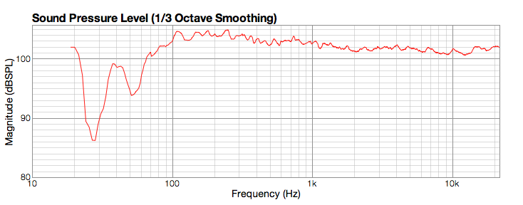

1/3 smoothing is way to coarse at low frequencies. Let's see that Jack Caldwell graph unsmoothed or 1/20 max. and from different locations around the main listening position.

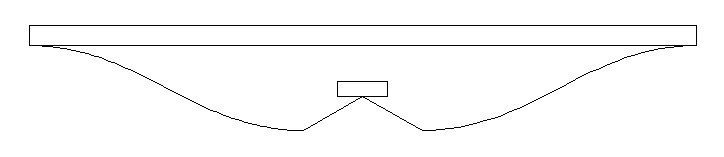

Looking again at Cal's special box design (see post 7 of this thread) - with an open area specifically behind the mid driver. This is a box speaker for sure - there's lots of 'box' everywhere. But Cal doesn't say he finds it 'boxy' and it sounds better with the back section behind the mid to be open. So it's about allowing the mids to 'breath' like a dipole.

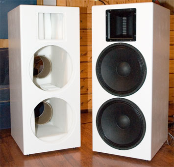

So how about this one - the well-regarded InConcert Miles speaker. Look at the attached image. The bass reflex ports are huge, positioned right behind the drivers. These drivers are XO'd high enough to say that there must be a prodigious amount of 'mid' leakage through the ports out of the back of the speaker. The thread is here: AVforum.no - Bygging av, Tangen AVdesign inConcert Miles.
Doesn't this remind you of Cal's open back-mid speaker. Perhaps this is the secret-sauce ?
Here's a quote from somebody who built a version of it:
"Because the ports are so large, the cabinet also seems to breathe easily, which (in my mind at least) accounts for the clean and open sound. Normally a bass reflex cabinet has a certain character to it, which I find interestingly lacking with these - which is a good thing BTW!"

Well, there really isn't any other place to put those giant ports than the rear side of the cabinet, so they ended up right behind the drivers. Have no idea of there is significant midrange leakage through the ports.
I had to use a lot of damping material in this speaker to attenuate the "boxy" sound of internal standing waves, but not enough to kill it entirely....

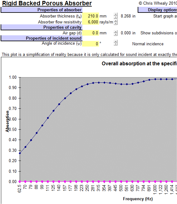

The caveat here is just how freakin' DIFFICULT it can be to get those internal box resonances to just go away.
In theory it shouldn't be but in practice damping material isn't always used right.. what, where and how much for instance.

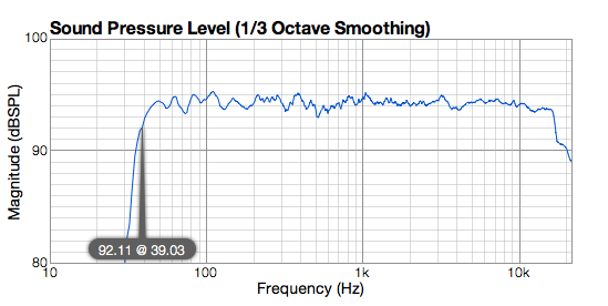

Perhaps I should throw in a response curve from an unequalized conventional box speaker in the same position... the peaks and valleys go to about +/- 15dB, and there are many more of them. But it's too ugly. I can't bear to look at it!
Markus your graphs look really great. That's a nicely tuned system. How would those same speakers look if non-optimally placed in a different room that has really bad resonant modes?
The point here is not to say look how good I can get these speakers when I optimize them in the room, it's to illustrate that a good OB design can give pretty good results even when used in a very BAD room. Without special treatments or room eq.
Well, if this is what you wanted to show then the data for the closed box speaker is missing. And, as I said before, 1/3 smoothing is way too coarse to show anything meaningful at low frequencies.
Same data, different smoothing:
P.S. If the 20Hz peak in your graph is the noise floor then you're not measuring loud enough and your graph is probably not really valid.

Oh, it's valid enough!P.S. If the 20Hz peak in your graph is the noise floor then you're not measuring loud enough and your graph is probably not really valid.
It's the noise from the Air Conditioning system. I had another measurement without it, and managed to erase it by accident, but the main response was identical above 40Hz. LF noise doesn't change the data at higher frequencies if it's not overloading the mic.
As for the contention that the 1/3 octave resolution not being sufficient, well... Your graphs do illustrate the point you're making, and the amplitude swings ARE dramatically different. But do we actually HEAR it that way? Less than it might seem. 1/3 octave is accepted by most in the pro-audio sector as being fairly close to how our hearing integrates sound.
That being said, I agree, smoother with a high resolution is better. But your contention that 1/3 octave invalidates the measurements is not something that most industry veterans would automatically agree with. I certainly don't.
Also, your examples are mostly concerned with the modes in the sub 100Hz range. IMO, it is more important to get the 100 to 400 Hz range working as well as possible, and this is where the OB works best. Again, I think OB's greatest contribution is in the reduction of lateral and vertical excitation, and due to "average" room dimensions, usually in the 80Hz to 400 Hz range

...there is very broad agreement that 1/3 resolution below the Schröder frequency was a very bad mistake. 1/3 wasn't chosen because of its perceptual validity but because of technical limitations.
you're missing to show any data that would prove your claim.
You're also just showing a single point in space. How does the frequency response look like at the left and the right ear??
Hi Markus, I too am of of the opinion that 1/3 doesn't describe everything there is to know about sound. Our hearing is a LOT more discriminating both in time and frequency than most studies reflect, especially our subliminal hearing... which almost no one has studied because it requires a lot of brain-wave measurements.
However, I'm also not in agreement that 1/3 oct. data is worthless and that the use of 1/3 oct makes a measurement invalid. Especially when said 1/3 octave data doesn't look all that different from the 1/12th data excepting it's prettier to look at.
As for missing any data that would prove my claim, I clearly disagree with your stance.
Although the data I have chosen to show here is limited, it is a subset which IS representative of other data that I have on hand. I could present reams of data, but this is not the place for that! I'll be happy to present more information, but please allow me to do that in the Vendor's section rather than doing it here. (I wish to respect the forum rules).
As for averaged response across many points, and deviance from the average, that's one of the criteria I study the most. It's hugely important. Again, I'll be happy to post the data for this in a more appropriate place. But I will say the OB I've referenced here does pretty well in that regard.
So, to bring this back on-topic, my contention is that while cabinet resonances and panel resonances are indeed audible, and desrving of solid construction, damping and bracing, that the room resonances are even more important, and that OB reduces the room issues significantly.
Perhaps the "absolute method" would be to measure at 1/24th octave with good conventional enclosures and my new OB design and compare extensively in 10 different rooms, and then publish the results in an 80 page white paper. But when it comes to giving helpful hints to the OP, please forgive me for not publishing "complete" data according to the criteria you state is necessary. What I've given actually IS a pretty good indicator, if only you have eyes to see.
