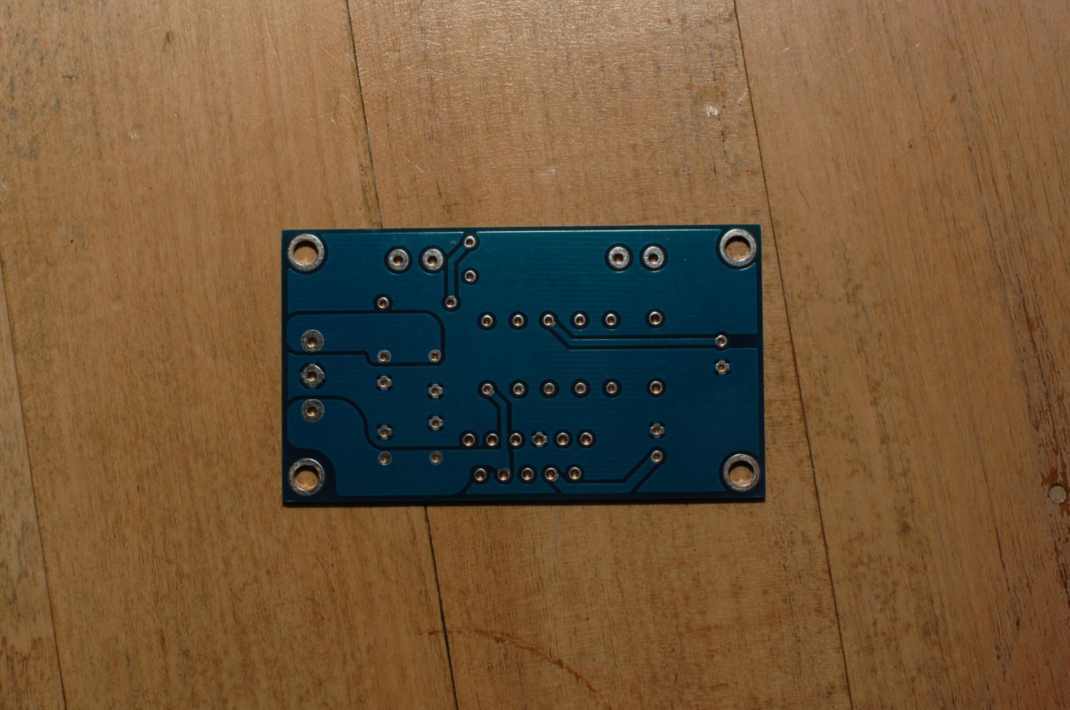

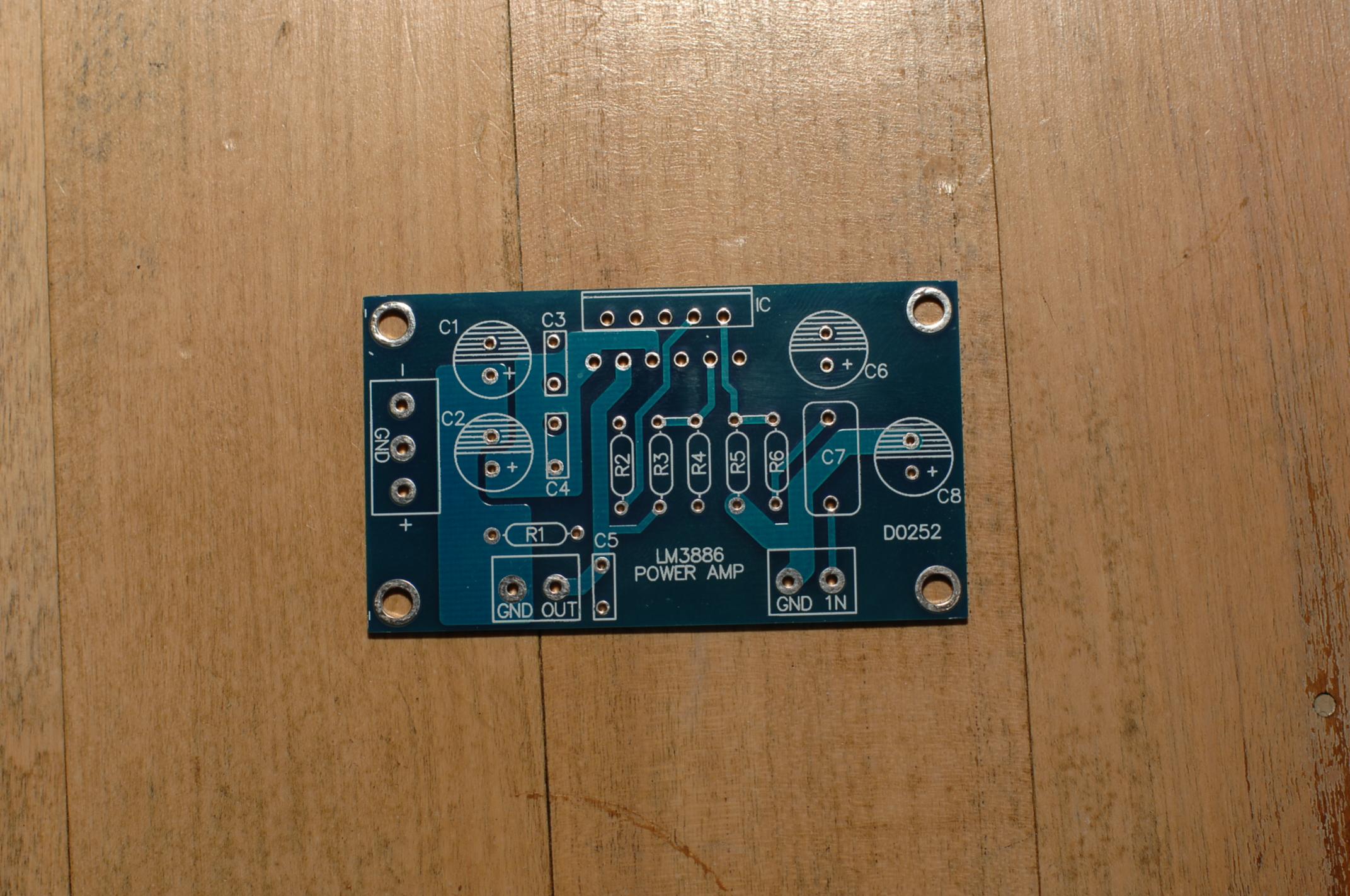

PICTURES: The new "Pemo" LM3886 PCB's.
Hi:
Here, the pictures of the "Pemo found" PCB boards for the LM3886.
After checking them out, I see that the Input Signal GND is connected to the Power GND as it is the case in the XY LM3886 PCB's. The bridges to cut are in the negative pad for C8, please correct me if I'm wrong.
I also would like to know if there is a need to add the RF filter capacitor in parallel to the resistor located in the + input signal to GND, as we did in the past with the XY PCB's.

Andrew, please confirm the location of the parallel RF cap. I think it goes connected to R5 in these new boards, that's the resistor that goes from Pin 10 to input GND, is that right?.

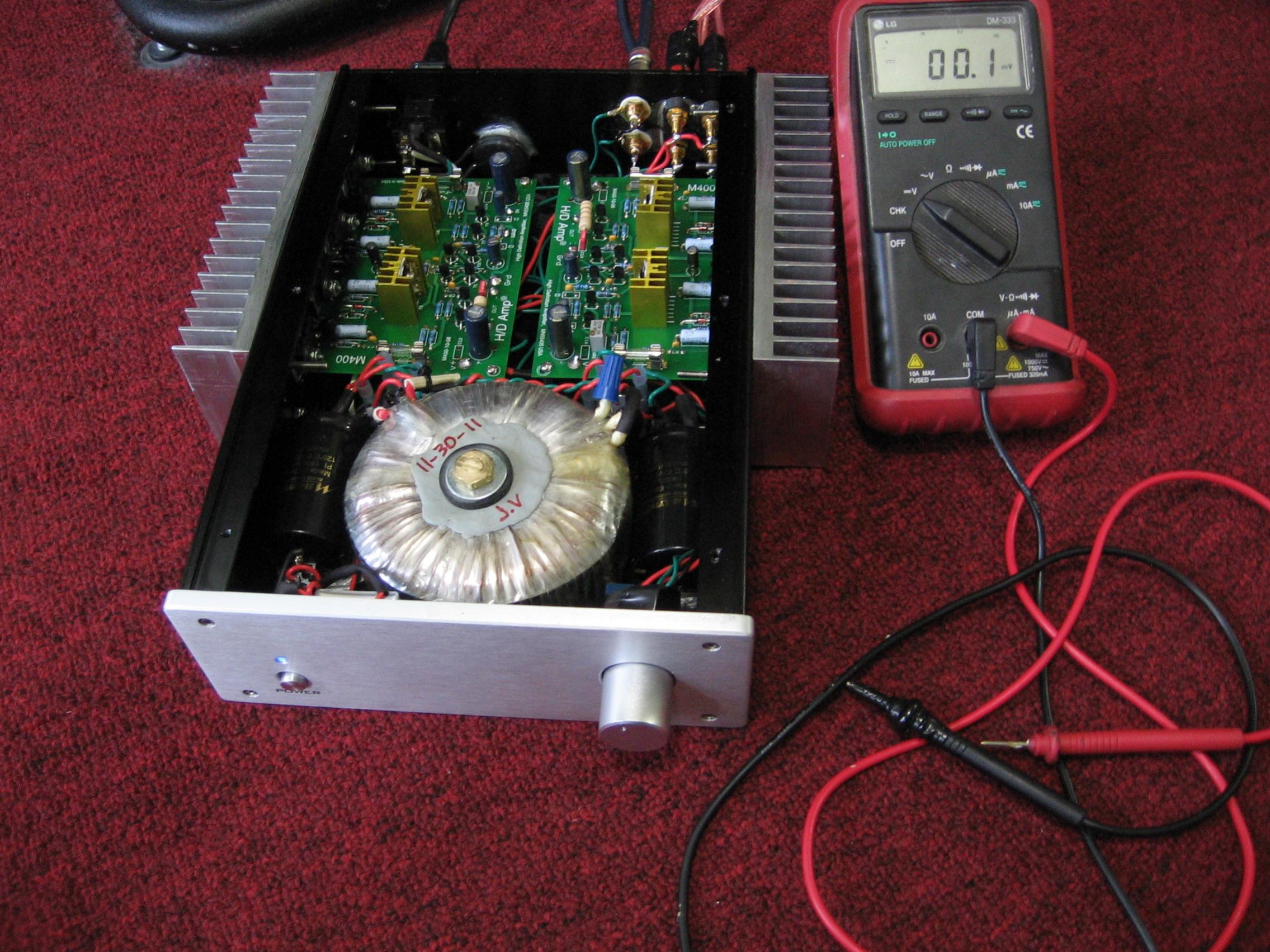

Lanchile, can you post pictures of your amp?. Specially the inside...?

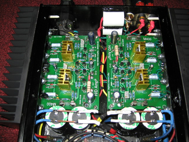

This is the inside.
Lanchile, thank you!
It looks great!
They show 2 amplifier kits, yours, the M400 which they say produces 130W at 8 Ohm, and the T300, which produces 150W at 8 Ohm. Why did you decide to get the M400 instead of the T300 that produces 20W more?. Is the M400 better sonically than the T300?.

I build the T300 for my friend too. Both sound really good, but I like the M400 better. I have ordered 10 M400 kits so far. Beside the M400 has fewer parts as you can see. and I do not need the extra 20 watts. right now my power supply is 42vdc per rail so I am not even using all his power, since to get the 130 watts you will need a power supply of 60vdc per rail.
That amp looks like a discrete design to me and not a LM3886 based one.
it is a discrete amp! I posted it here because Aguilabrava asked me to post picture.
You are right, I asked him to post those pictures and more details about his amp, I am interested in getting one of those in the near future. I figured that maybe some other people here might be interested in learning more about them too.

Here is the schematic of the PCB clone that you posted: I have made 2 XY ones and 7 "nemo" as you call them ones two of which are with upgraded components, nichicon muse, panasonic and wima MKPs. Will compare the latter to my ultimate BOM MyRef Rev E lated. Waiting fot the enclosure.
http://chipamp.com/docs/lm3886-manual.pdf
Hope this helps.
