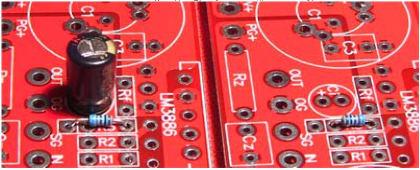

Yesterday, I decided to remove the Ci "feedback capacitor" or C4 in the XY PCB's of the new amplifiers I built recently. The reason behind it was that even though I used better quality components in these, I didn't like the sound they produced, it was too bright, the treble was too intense and the bass was kind of flat. In these new amps, I changed the value of Ri or R4 in the XY PCB's from 1K Ohm to 680 Ohm. I used initially the same type and value capacitor in Ci (C4) as I used in the first amplifiers, Elna Silmic II 47uF 50V.
This has been discussed in previous posts here in this thread, anyhow, I removed the 47uF and replaced it with a Nichicon Fine Gold 100uF 50V, so all the caps are the same in the new amps, C1, C2, C3 and C4.
This change has made a HUGE difference in the quality of sound, now the new amps sound great, the bass is more deep and robust, the highs remained the same but since the bass is deeper, more pronounced now, they don't feel as bright as before. It is incredible the difference this has made. Thank you, AndrewT once again...
After trying the three combinations, 1K + 47uF, 680 Ohm + 47uF and the last, 680 Ohm + 100uF for Ri Ci, I think that all of you guys using the 1K + 22uF combination that comes with the kit ARE NOT getting the best possible sound from your amplifiers, you all should replace at least the C4 cap.
For the "Pemo boards", I'll be using 680 Ohm for Ri plus 220uF 50V for Ci, as recommended by AndrewT. I couldn't use the 220uF now because I just ordered them, they should be here in few days, all I had now was Nichicon Fine Gold 100uF, but they did it, these things sound now better than ever. Compared to the first ones I built, these sounded always louder, I guess because of the 680 Ohm, but now the sound is more detailed, basically better bass and better treble. I highly recommend upgrading at least the C4, but the ideal would be to replace both, R4 and C4, using 680 Ohm for resistance, and at least 100uF for capacitance.

These cap value are not absolute.
They in conjunction with the resistor value determine the RC time constant.
That RC must be related to the input filter RC to ensure near zero AC voltage across the NFB capacitor.
Go back and re-read the formula. Post54. The RCs are linked to each other.

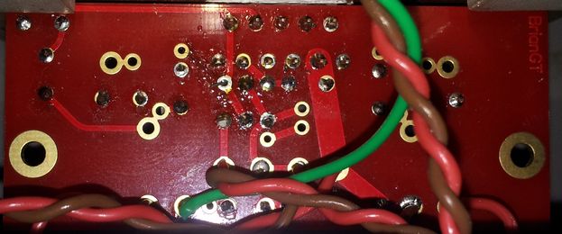

Hi again, this is PEMO.
Continuing my research on LM3886 boards, I also found this highly respected kit from BrianGT.
Here you can see part of one of his boards, where you can see that power ground and signal ground are.....tada.... connected.
NOTE: (Brian has the PDF document where I took this picture, protected. So if I am doing something wrong please let me know ASAP, to delete this message.)
3 out of 3. Why?
Best regards,
PEMO
Your pic does show the connection.
Is the connection on the bottom side?
Hi Andrew, this is the only picture I found, I think this is the upper side of the board.
Why these three designers have grounds connected?
Why they sound so good?
Is this grounding issue just for safety or also to improve sound?

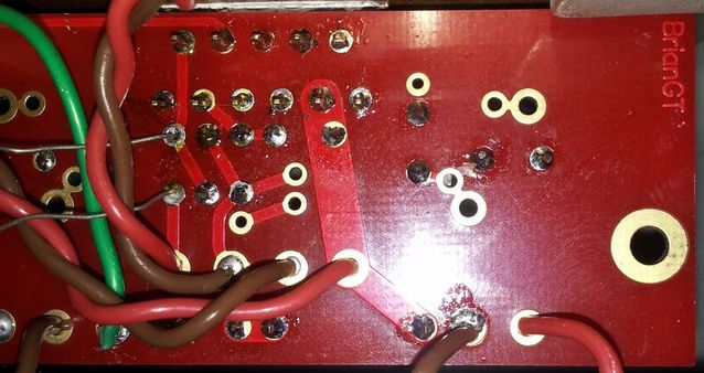

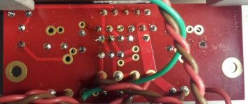

Here are some pictures of the bottom of the BryanGT amps. Hope they help
Edit: Long leads in pic #1 are just the excess from Uriah's Resistor Re-placer.
