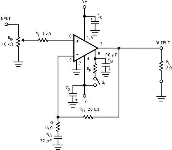

I'm trying your formula, with C4, C5, R5, R6 and R4 as locations in the XY PCB, I'm using 2.2uF as reference value for C5:
C4 >= C5 * Sqrt(2) * [R5+R6] / R4
C4>= 2.2uF x 1.48323969 x [23000]/680=110.37
Now, when using a reference value of 4.7uF for C5:
C4>= 4.7 x 2.16794833 x [23000]/680=344.64
And using 1uF:
C4>=1.0 x 1.0 x [23000]/680= 33.82
According to this, if one is using 22K Ohm for R5, 1K Ohm for R6, 680 Ohm for R4, then C4 should be 100uF if using a 2.2uF in C5, 330uF if using a 4.7uF in C5 and 33uF if using 1uF in C5. Is this correct?. If that is the case, then I should use the 100uF in C4 instead of the 220uF you recommended.

are your fingers faulty or is it the calculator/slide rule that is faulty?
sqrt(2) ~ 1.414
=105uF use, 120uF or 150uF
4.7*1.414*23000/680=220uF, use 220uF or 330uF
1uF*1.414*23000/680 = 48uF, use 47uF or 100uF.
But all these DC blocking caps result in different bass response.
First has 23k & 2.2uF, second has 23k & 4.7uF, third has 23k & 1uF.
I couldn't compare these different options because each have a different filtering frequency.
BTW,
it's not my formula. I pinched from others before me, I just keep repeating the advice because I found it worked. It removed the sound effect from the NFB cap. Whereas using a too small NFB cap and increasing the input cap to restore the frequency response to where you want it, does make the sound output more susceptible to what type of capacitor is used in the NFB. Make it big enough and you can't hear any distortion due to that capacitor.

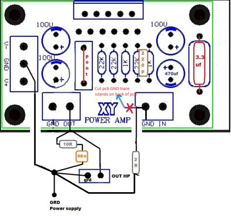

Why these three designers have grounds connected?
They have to be connected somewhere and those designers chose to do it on the board. You will have to ask them personally why they chose that location. The most likely reason is that it was the easiest solution.
Why they sound so good?
How good do they sound?
Is this grounding issue just for safety or also to improve sound?
The connection to PE is for safety.
The connection from line level ground to output and power ground can have an impact on the sound quality. If the ground layout is bad, you get hum from an unregulated supply or cheeping noises if you use an SMPS.
Hey, Pacificblue:
I'm happy you are finally back...!
What Pemo is referring to is that the guys here, including himself, that have not separated the input signal ground from the power ground cutting the bridges in the back of the PCB don't have any hum at all, their amps are totally silent.
From your answer, I understand that this is just a safety related issue, so leaving those grounds together would reduce the possibility of getting hum, but would make the amp "not as safe"???
Me, too. One of my colleagues became ill and I had to take over his duties, so I am quite busy now and don't have much time left to spend with the Forum. The poor guy will probably be down for several months to go and there is no replacement in sight.
It depends on the overall layout whether you need to cut or not. If you have a central star-ground in a multi-channel amp, you may get hum, and then you will be obliged to cut those traces. You may as well be lucky, have a central star-ground and get no hum. Since there are infinite possibilities to lay your amp out, you just have to test it to find out. Some people skip the test and cut the traces just to be on the safe side.
Andrew answered this already.
Let me add that you are obliged to connect the audio ground to PE as soon as the voltage at the speaker terminals can become greater than or equal to 25 VAC or 60 VDC. The only way around this is to create a double-insulated connection from the amp to the speaker, e.g. by means of Speakon connectors on both sides of the speaker cable.
Below those voltages you are not obliged to connect PE to ground, but it is good to do it nevertheless. That way you get used to it and are less likely to forget it when the connection is necessary.

Hi Johnny52
Your choice of implementation works (as in mine it does) but to be clear the best option is probably to cut the GND to really isolate the input/Feedback GND from the rest of the GND trace as pointed out earlier in the thread. Thus, this is the preferred option- if required:
Good luck

Same thing as post #38. I'll cut the traces.
I thought that 2R was on power supply ground instead of input signal ground. Sorry Fab.
