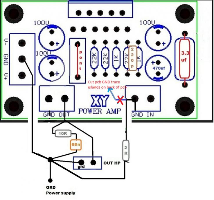

Hoping to get some help from this thread on my XY LM3886 amp. I am trying to solve for what I believe to be a ground loop with a ton of RF, hum and buzz. Moving the speaker cables around changes the noise so it seems like my speaker cables are acting like antennas.
I followed the XY mods in the image below with the exception the 2 ohm resistor from signal return ground. I read someone say this resistor was only if the ground plane was not separated from the signal input.
I also added a Thiele network to the outputs plus 1nf capacitors from the rca GND to chassis.
I created a star ground and have everything attached back to it:
  • Signal gnd, signal return ground
  • PSU ground, main board grounds
  • output ground

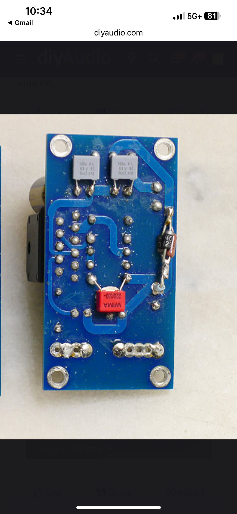

I could just add a 100n across each filter cap on the amp boards? Just like the picture below?

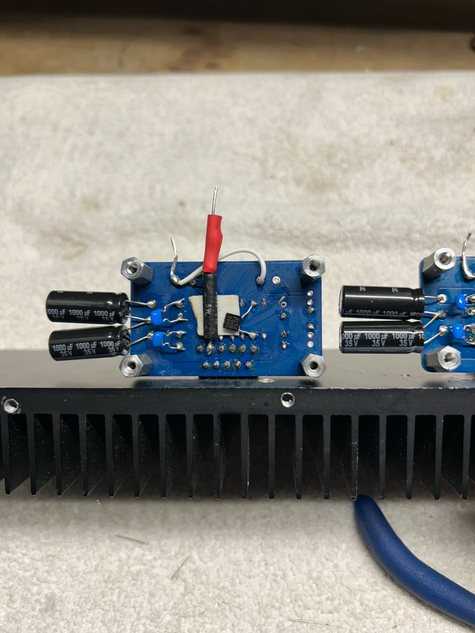

100 uF isn't enough to begin with. National Semiconductor (now TI) recommends 470 uF || 10 uF || 100 nF in the Application section of the LM3886 data sheet. I took that a bit further in my recommendations as newer and better parts have emerged since the folks at National wrote that data sheet. You can see my recommendations here: https://neurochrome.com/pages/supply-decoupling
I have seen the LM3886 oscillate with 4 Ω load and high-ish output voltage if the decoupling is up to the task.
Tom
Tom, I read your article about decoupling and I understand I need 470uf-1000V C1 and C2 caps, 10uf tantalum, and 4.7uf x7R. I’ll have to get creative mounting these to the bottom.
As for grounding, can you recommend how I should reconnect signal and power ground after cutting the trace to separate them?
I tried running everything to a star ground and I had a ground loop.

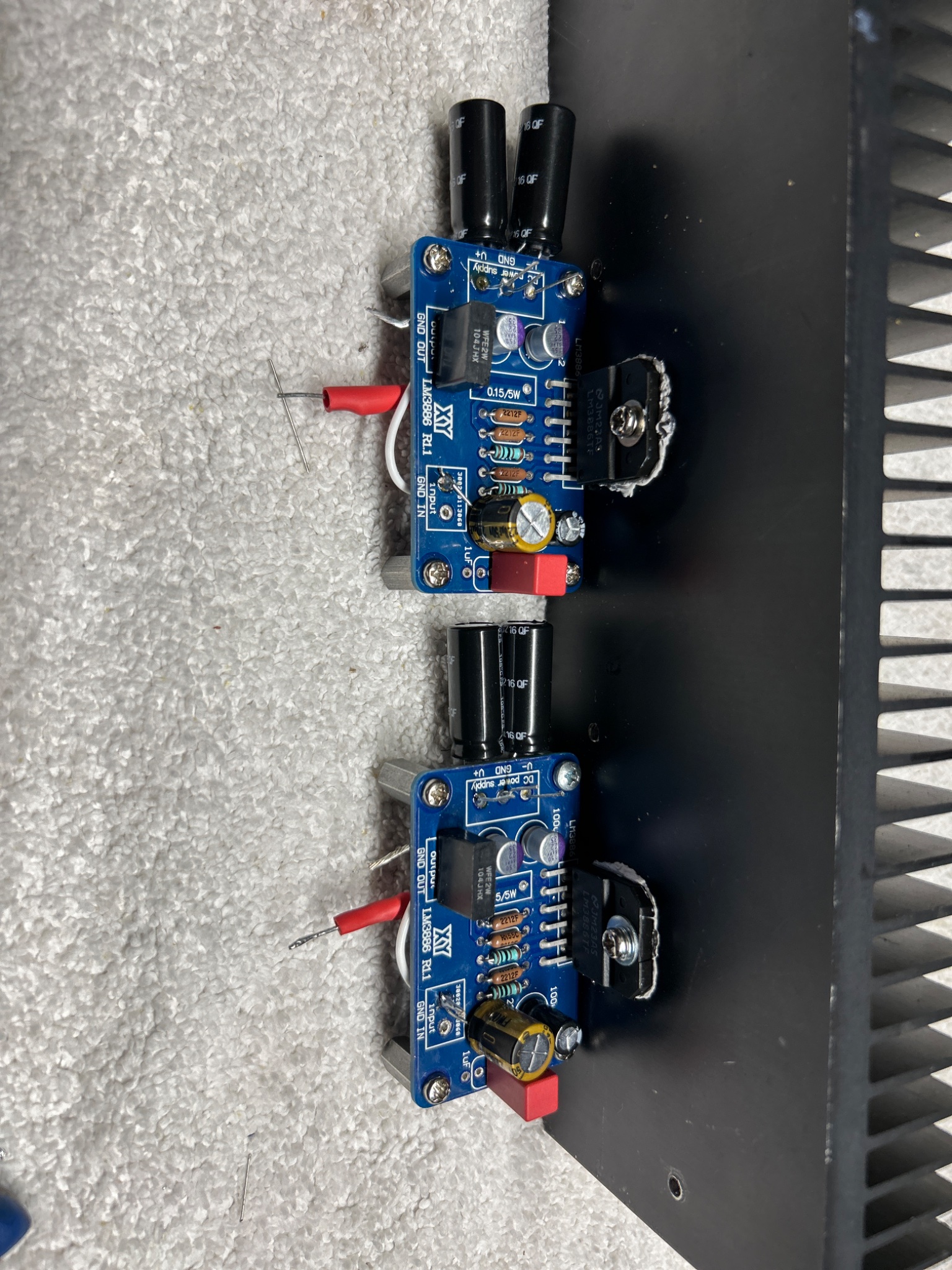

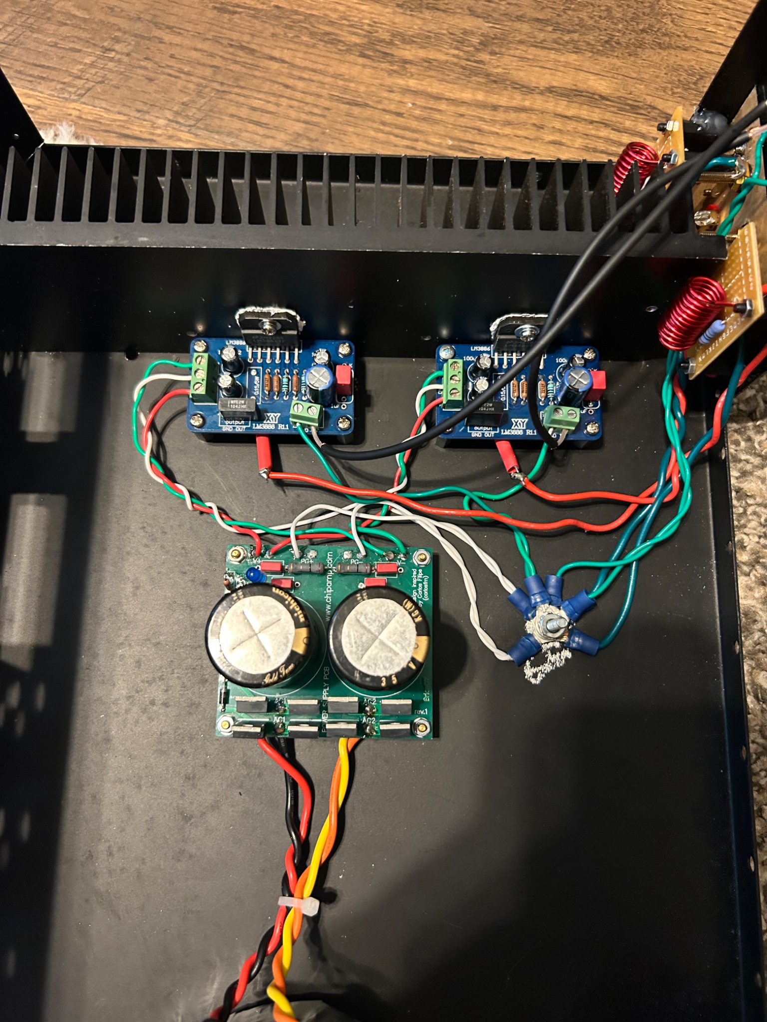

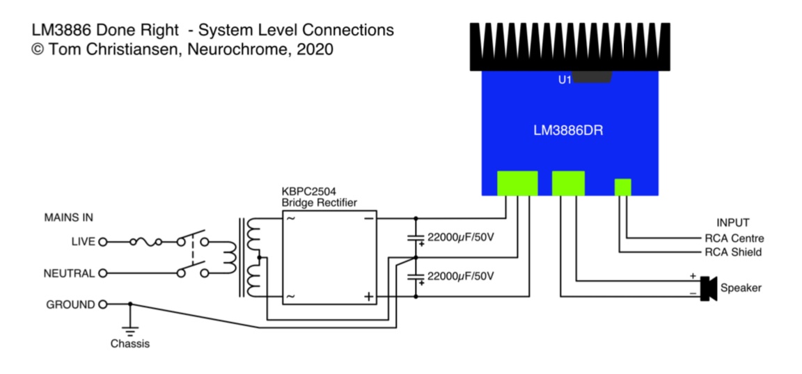

Tom, thank you for the help. Here is the update on the amp:
I went with 1000uf, 22uf, and 4.7 x7r for the decoupling. I removed the two input connectors, soldered the 1000uf caps there, and put the 22uf caps IPO the 100uf caps. The 4.7uf x7r caps are soldered in parallel on the bottom.
I also removed the star ground and wired everything to the boards while incorporating a ground loop breaker (following Tom's guide).
Finally this is the quietest the unit has been since experimenting with it. I still notice the speaker cables will pick up a bit of noise if the cables are near AC wires or next to my power conditioner, but that is an easy fix.
Sounds good but I need to increase my gain or remove the volume pot. I added a 100k pot I had on hand but it seemed to lower the input vs running my source directly into it.
Also, I have 10000uf caps in the psu and I might increase these to 22000uf...

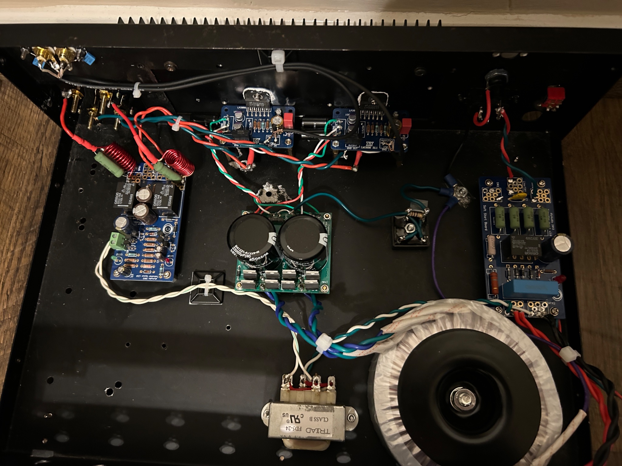

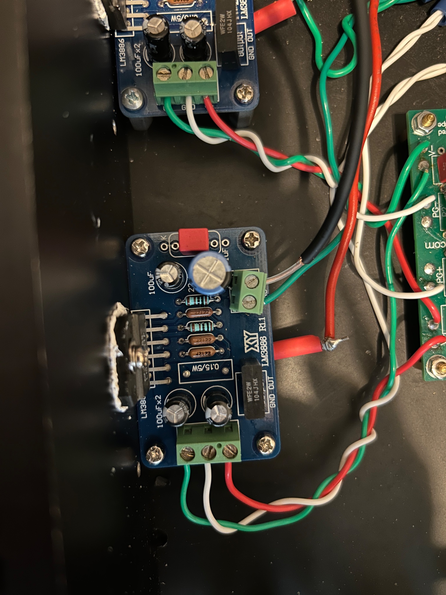

Just completely rearranged my LM3886 and made some changes.
  • increased my psu caps to 22000uf
  • changed my transformer from 18 VAC secondaries to 22 VAC (Antek as-2222)
  • mounted the heatsink to the back of the chassis to create more room inside
  • added a soft start and speaker protect relay
I ended up removing the volume pot to run it as a power amp. I might end up adding a better 10k pot in the future with another input and switch.
Really happy with the results and the modifications. Thanks for the help.
