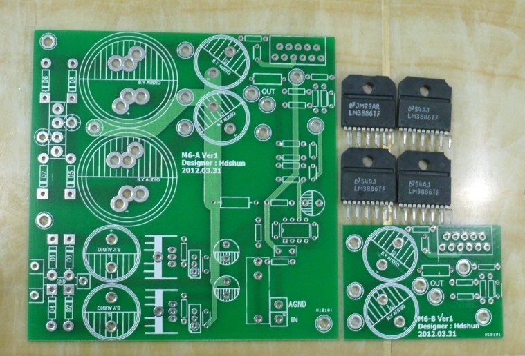

Today I received the new boards, let's call them the Pemo boards since he's the one that "discovered" them... You were absolutely right, ALL grounds on the board are connected, the input ground has to be isolated same as with the XY boards. These boards are bigger, I'd say about 10mm wider and 7mm longer than the XY's.
I will post pictures of these soon, both sides. I believe I know where the bridges need to be cut, I will tell you when I post the pictures so you can correct me if I'm wrong.
They look better than the XY's, the only problem I see is the location of the input AC coupling capacitor (C capacitor in National's datasheet), the space is too small to use same type of capacitor as in the XY boards...

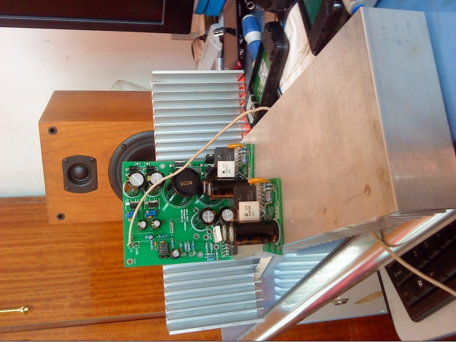

Andrew:
I measured the AC mV's in the output terminals. I've got the following readings:
Left Channel=1.7mV Right Channel=2.6mV
I understand that according to your last post, then the Right Channel amp is bad, but this is the same amp you've seen in the first set of pictures I posted here, and when I used them both before replacing them with the new ones, even with the wiring being a total mess with no "twisted pairs" and no separation of signal path from power path, there was no audible noise of any kind in those amps.
This is driving me crazy...!
