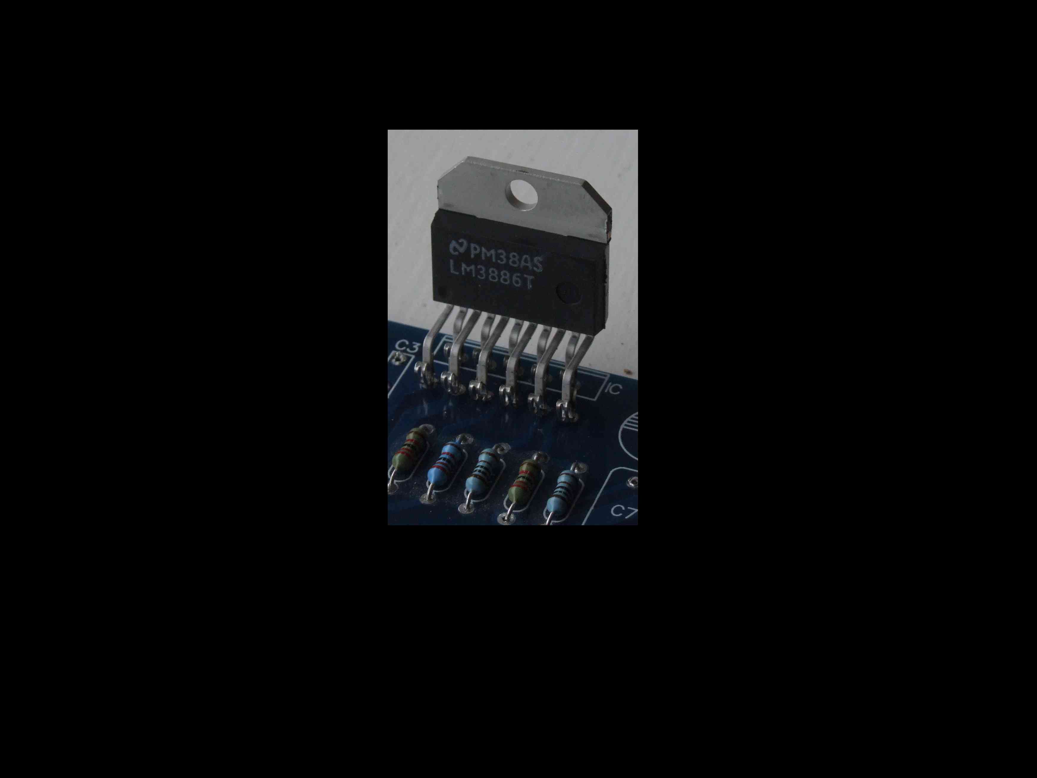

I was able to desolder the LM3886 last night, I used that "Chip Quik" product which is basically a solder made of alloy and a very clean flux. For those of you that don't know this product, it is simply great, I highly recommend it, you just apply a little bit of flux to each pin, then melt a little bit of the alloy solder on each pin, and this thing stays hot for few seconds, it melts the original solder allowing to remove the chip easily, no sweat at all. It would've been impossible to do it without it, I just have to order some more because I used all I had removing one LM3886.
Anyhow, I couldn't check anything on the PCB itself, and it actually got ruined because after I removed the LM3886 I tried to remove the caps using the conventional method with a vacuum pump and I lifted a couple of pads in the process.
I have the LM3886 intact, that's basically the only thing besides the input decoupling cap I could save. It is a shame that the rest of the components became garbage so soon... Well, I guess this is part of the game, sometimes one wins, sometimes one looses...
Since the shipping charges on these components were kind of steep, I ordered few items of each, so I just assembled another board with another LM3886, not the one I removed from the bad amp, proceeded to test it, and it worked perfect.

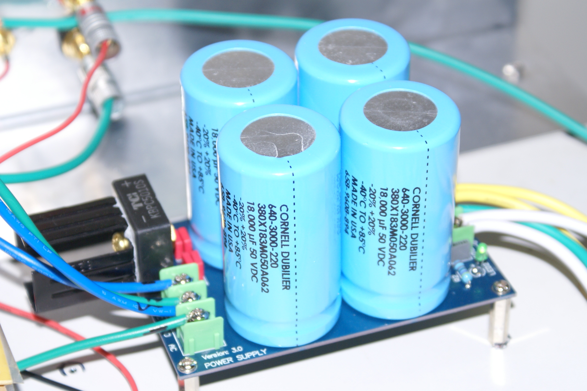

By the way, I forgot to mention that the PSU has also been replaced. I am using one based on the same XY PSU board, but with four Cornell Dubilier 18000UF 50V, Wima and Faratronics high frequency filter caps, a 1000V 50A rectifier bridge and two 4.7K Ohm 1/2 Watt metal film resistors.
Now, going back to the issue with the LM3886, is there any testing that can be done on these chips to determine functionality before soldering them to a board?.
Do they make sockets for these LM3886?. I'd like to be able to assemble a PCB just to test LM3886, being able to do so without soldering the chip to the board, is it possible?.

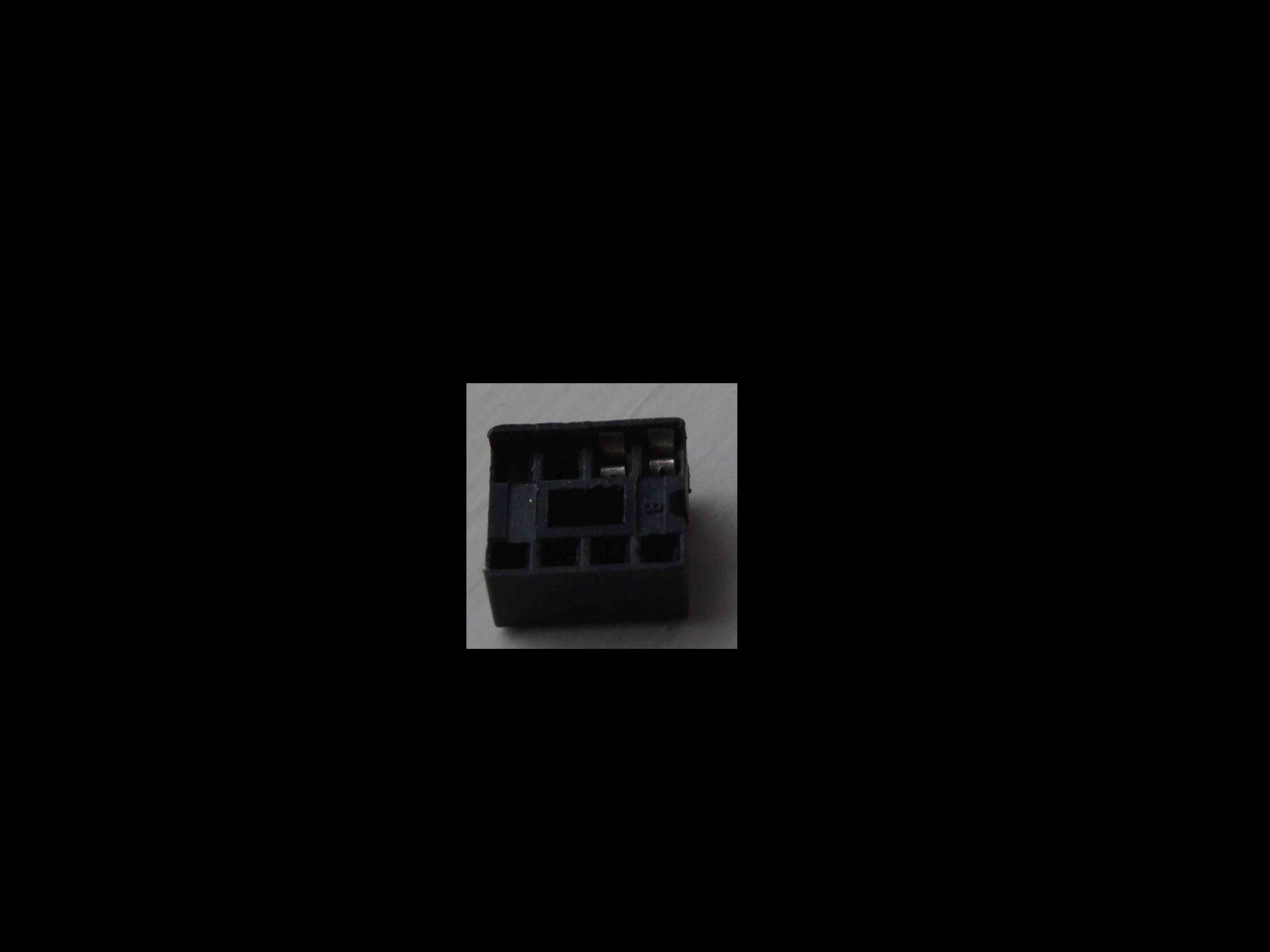

not turned pin. They are intended for round PINs.
I have some 8pin DIP socket that accept blade type PINs.
Last night I pulled some of these connectors from a couple of DIP sockets. They look to be perfect for a test jig.

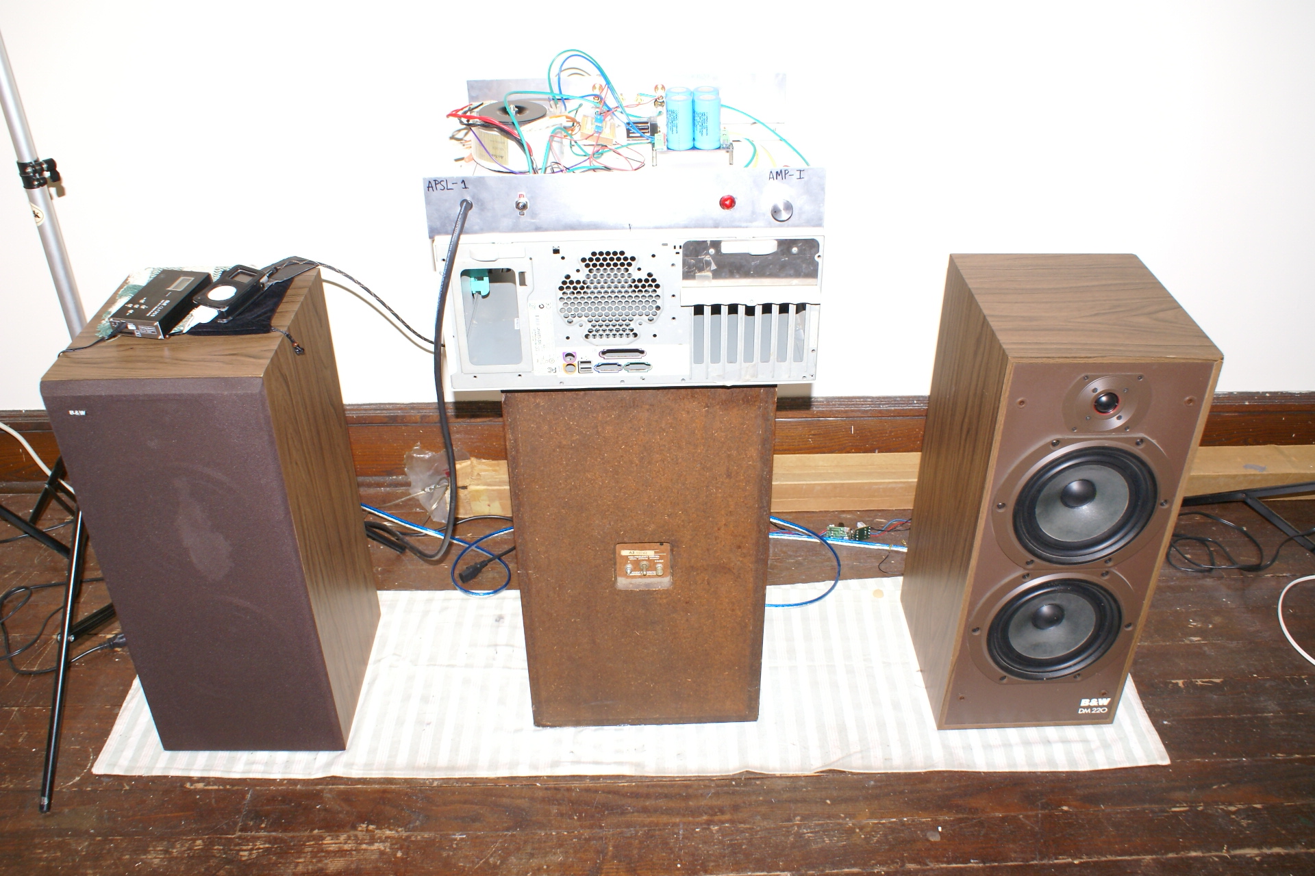

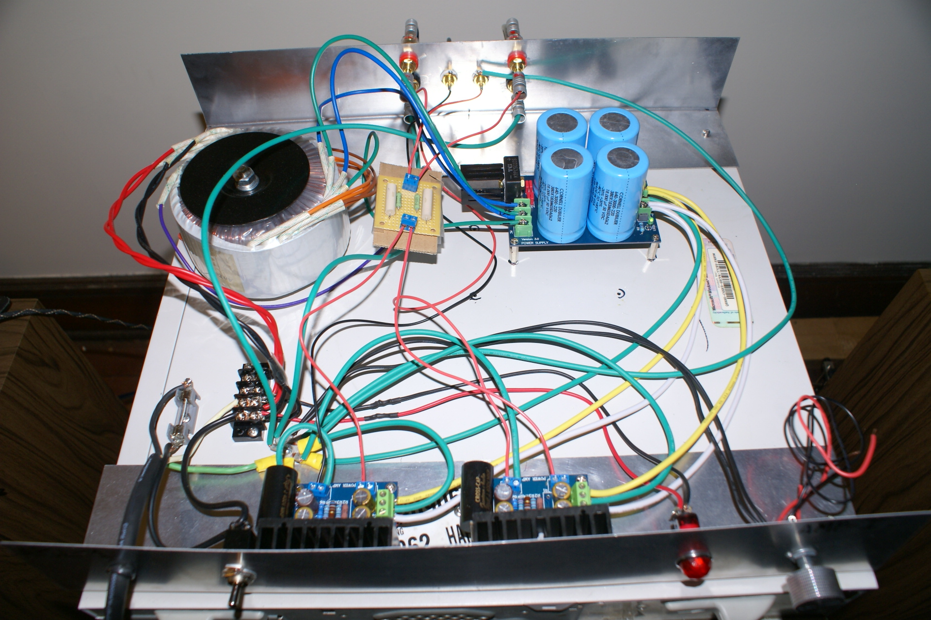

Here, some pictures including the new PSU with the four Cornell Dubilier 18000uF 50V caps, the new amps, the speakers and the two sources I'm using, iPod Mini and QLS QA350 WAV player. Also, the new Thiele R//L network with bigger inductors and resistors on a PCB board, as Corpius did it.
I know, I have to fix the wire mess, it looks terrible, but this is just for testing purposes. Now I have a very little hum if I get my ear really close to the tweeters, but with the first amps I had NO hum at all, that's why I haven't bothered fixing the mess. But I will eventually do. And yes, the left speaker has a stain on the front, but that's how I got them, I bought them used, but they sound great.

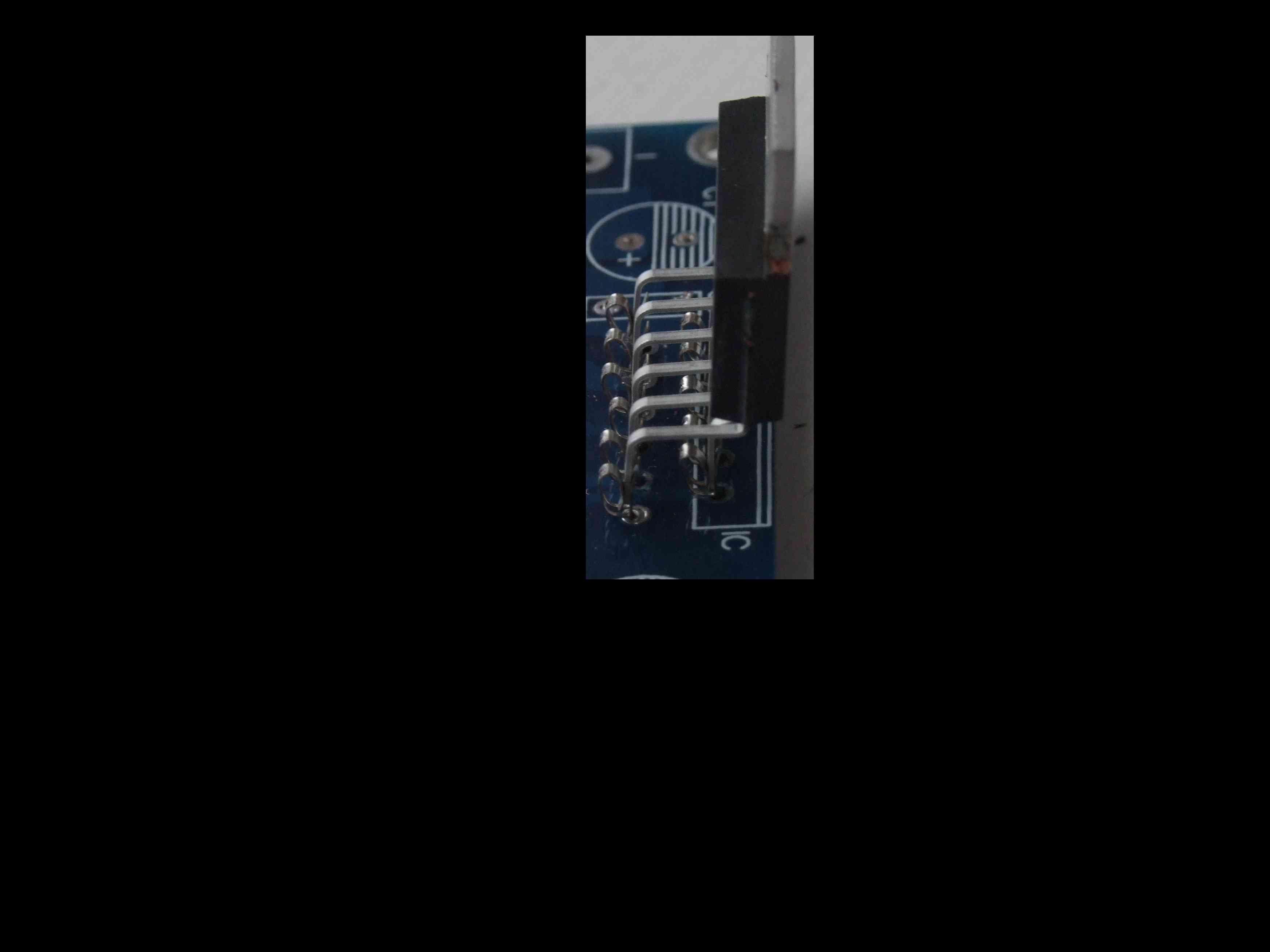

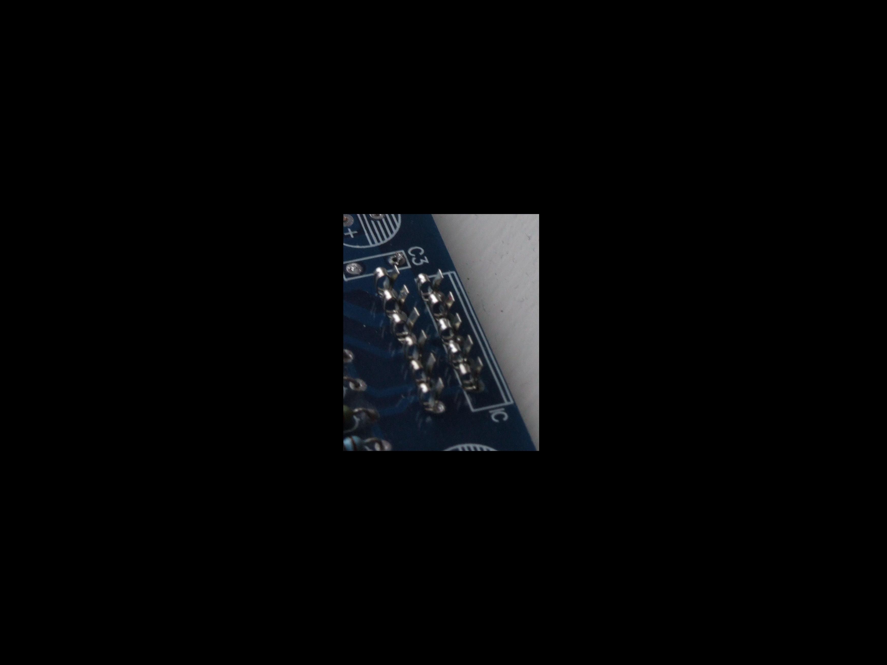

Here are pics of the test jig, using the sockets from a DIP8.
When the sockets are out of the plastic holder they are quite delicate and will not survive rough handling.
I have inserted and removed the 3886 from the jig a few times and it appears to work well.

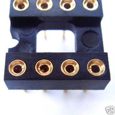

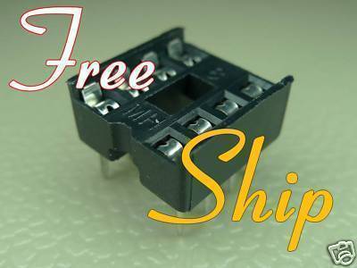

Thank you. That is the perfect solution. How do I get those "sockets".
If I simply order a DIP8 socket, no more details, just that, will I get these things?.
Where did you get the PCB?. It looks like the one Pemo was talking about... I think I'll be getting the ones I ordered by tomorrow. I'll post pictures as soon as I get them.
Regarding removing the black border, I don't know, when I crop pictures I never get any border...
Did you check post 291?.
Thank you again for sharing your extensive knowledge and being so helpful.
Look at the pic from your supplier.
You can usually see the difference between a blade type socket and a turned pin type socket. Turned pin are usually called up as such.

DIP-8 Socket
Andrew:
I found these two at the auction site.
They are different, one looks like yours, the other one looks sturdier, but I guess those pins are not coming out easily. Please check them out. Sometimes is a lot easier to find stuff at eBay because of the pictures...
