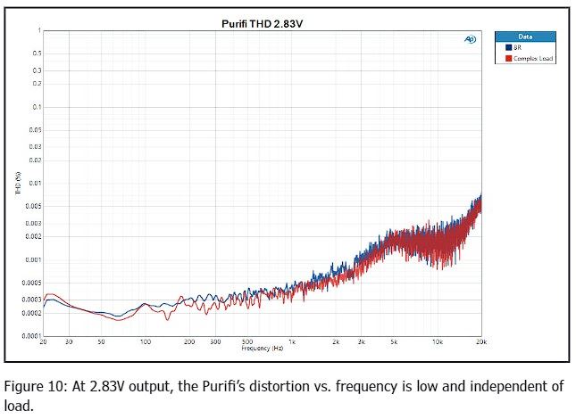

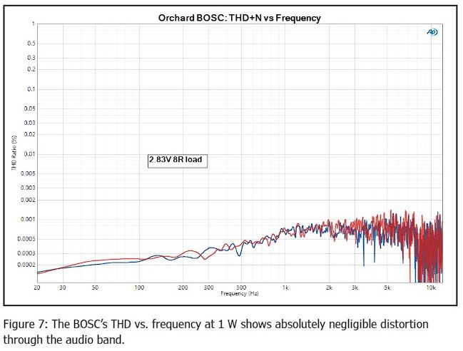

Yes, the Purifi has better measurements, but it is also a significantly more complex topology (three nested feedback loops, and one feed forward loop crossing a feedback point).
If you compare THD at 1W BOSC clearly is the winner especially at high frequencies. Compare figure 7 to figure 10.

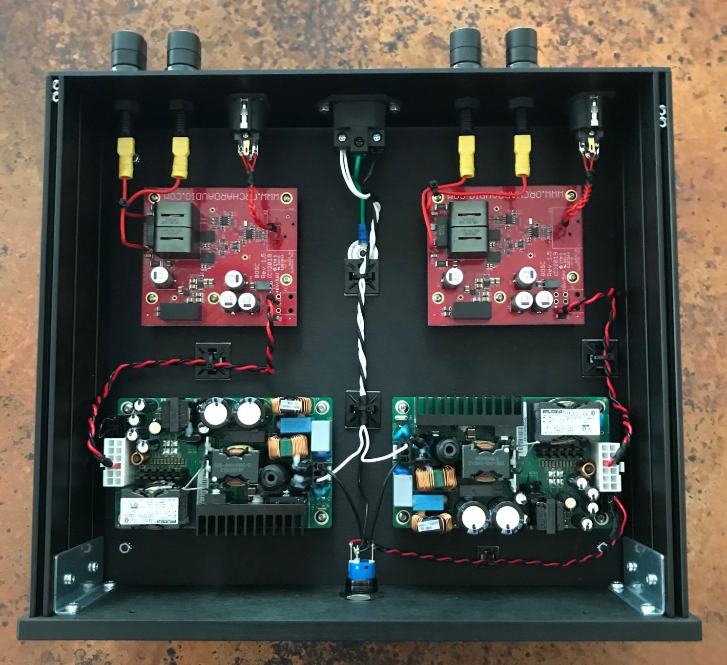

Nice project, looks like the integrated TI GaN half bridges?
Are you're using the TI half bridges? I had posted about using the TI LMG5200 over 5 years ago (still don't have the time or resources to attempt what you did) but no one else seemed excited about it - TI LMG5200 half bridge power stage
Glad to see someone finally integrated one of those power stages into a hifi amplifier! The design looks nice and compact and thoughtfully partitioned (from what the photos show). Well done!
You had mentioned you chose a more expensive, non-standard stack up to reduce inductance. Why didn't you just use a more standard 8 layer stackup to reduce cost while still reducing inductance? And did the use of a "higher quality" laminate really provide any audible difference? Sorry for all the questions, I missed all this fun while on hiatus.
Yes, they are TI half-bridges.
The stack-up and dielectic work together to minimize any parasitic inductances and capacitances especially when it comes to the switch node, because the slew rate of GaN devices is incredibly fast.
