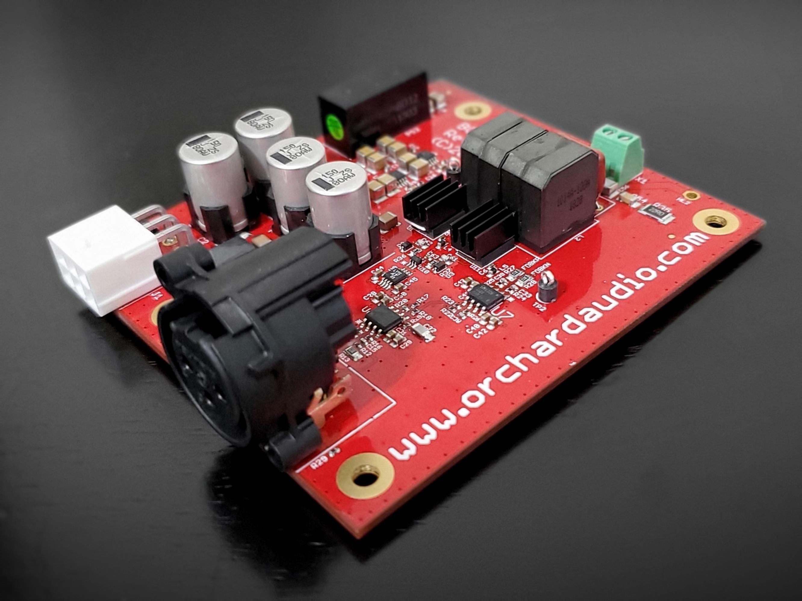

My company will shortly be launching a GaN Class-D amp - BOSC.
If there is enough interest from this community I can offer just the circuit board.
The modulator is a completely custom proprietary dual feedback design with switching frequency up to 900kHz.
Preliminary Specifications:
- Gain: 16.8dB or 6.92 (For 8 and 6ohm speakers)
- Gain: 13.8dB or 4.89 (For 4 and 3ohm speakers)
- Signal to Noise Ratio (SNR): 121dB (A-weighted)
- Total Harmonic Distortion (THD): <0.0003% (-110dB) @ 9W
- Frequency Response: DC - 60kHz+
- Sensitivity: 2.5Vin for 37.5W
- Input Impedance: 5kohm fully balanced for 8ohm amp
- Input Impedance: 7.1kohm fully balanced for 4ohm amp
- Output Power: 150W into 4ohm
- Output Power: 150W into 8ohm
- Board Size: 3.64'' x 3.3''

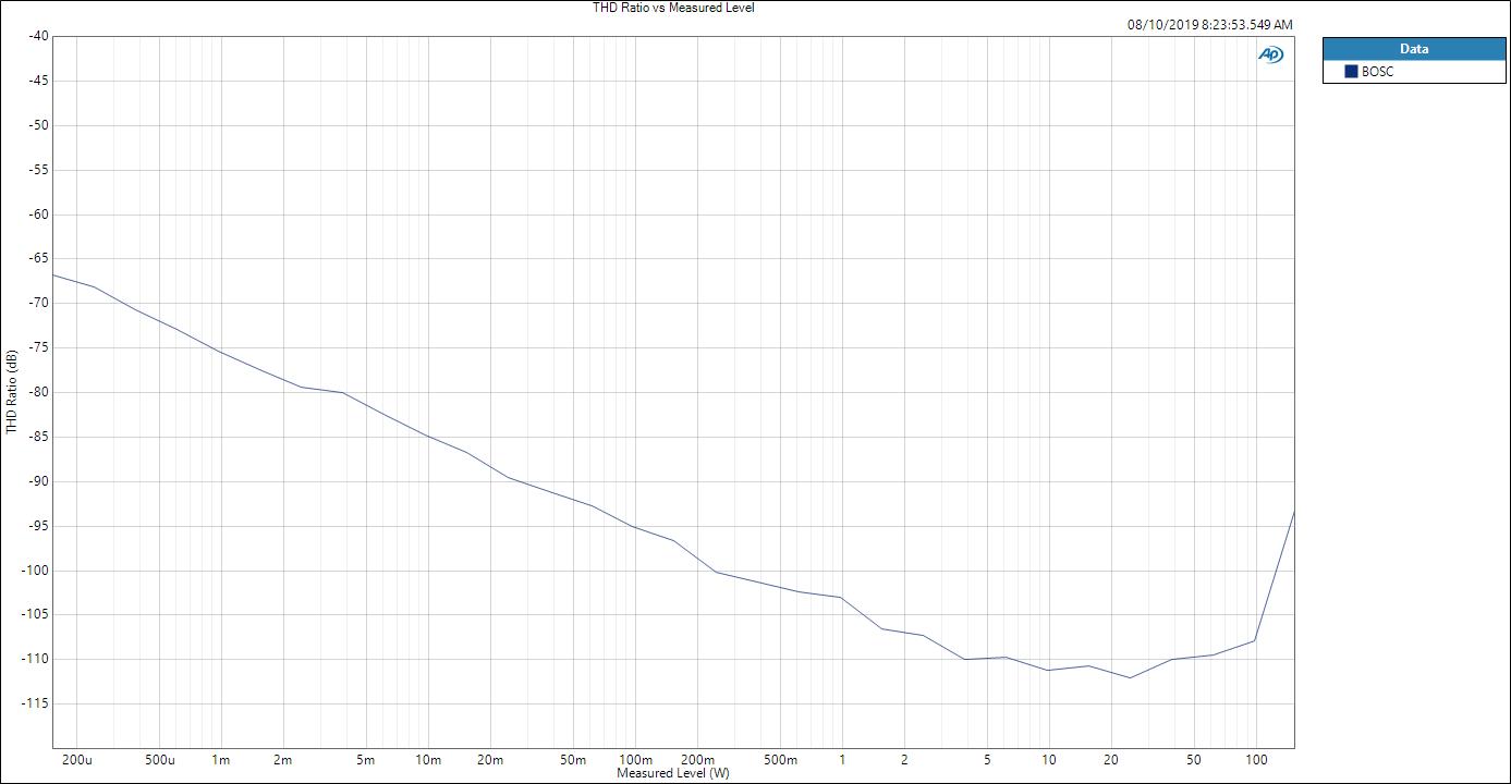

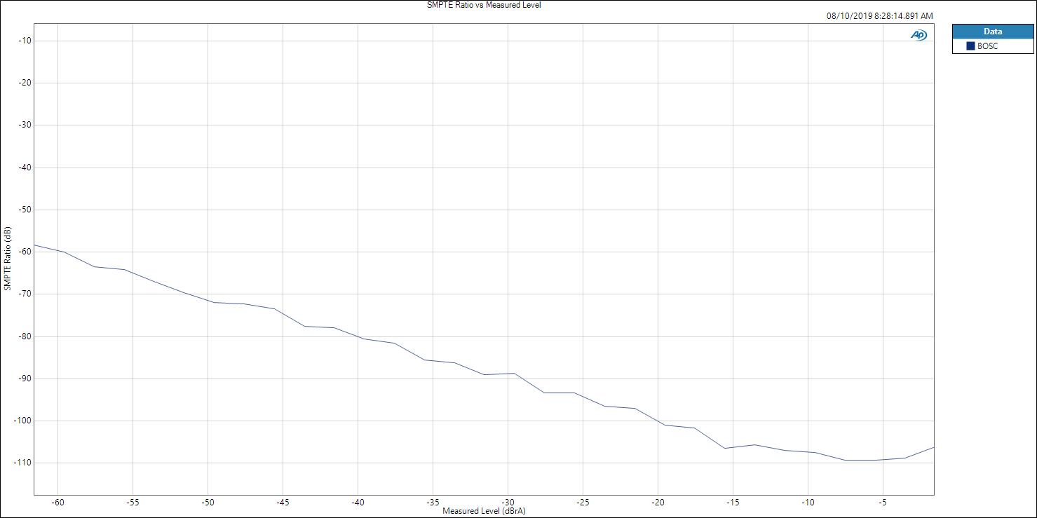

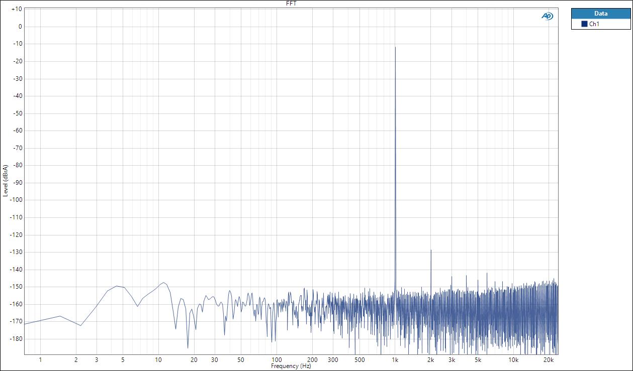

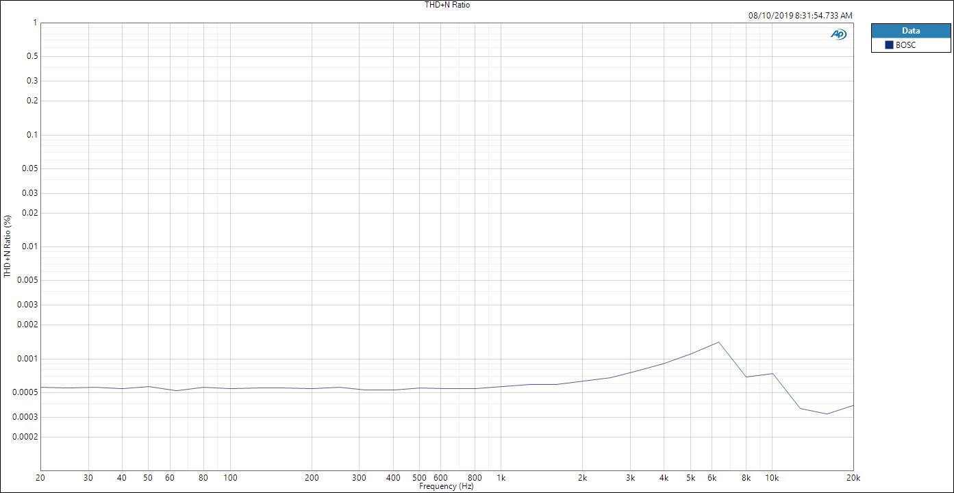

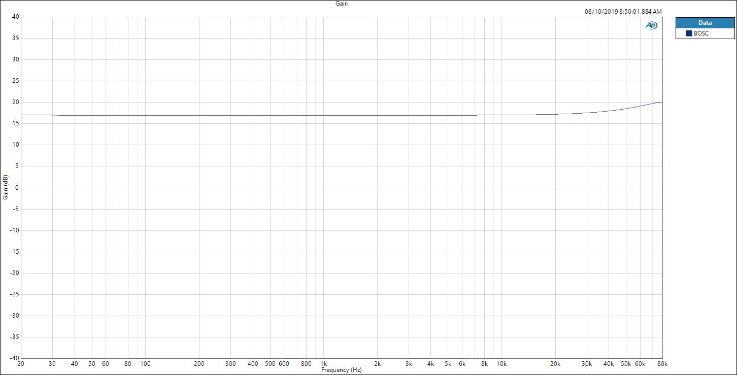

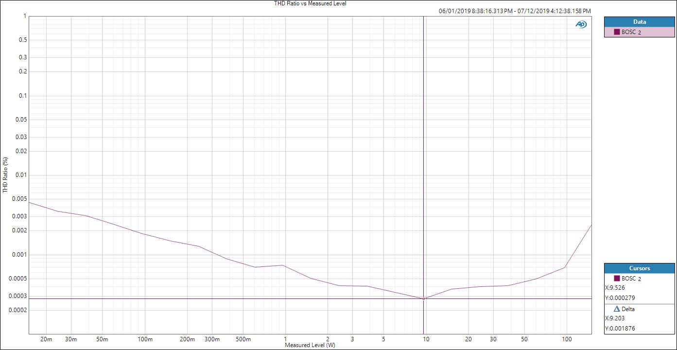

See attached images for some additional test results.
