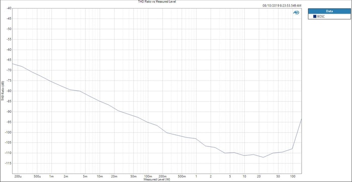

BOSC test results

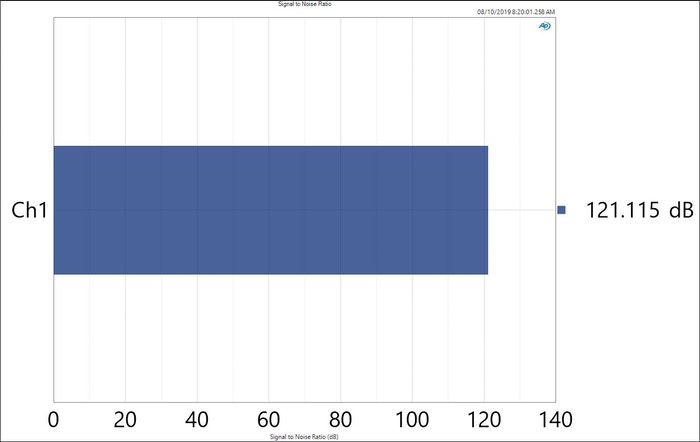

SNR
THD vs output power

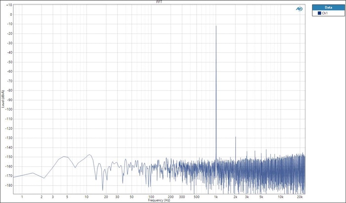

FFT of 1kHz 10W output

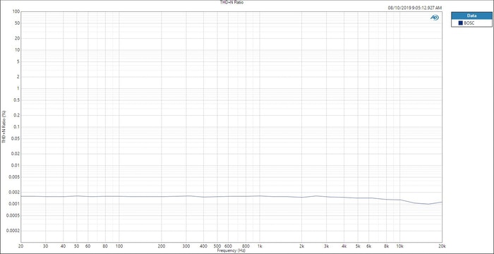

THD+N vs frequency at 1W
SNR
THD vs output power
H2 predominant. H3 about 15 dB less.
I know, the H2 harmonic is too low, inaudible, but I like to see this harmonic profile! 🙂

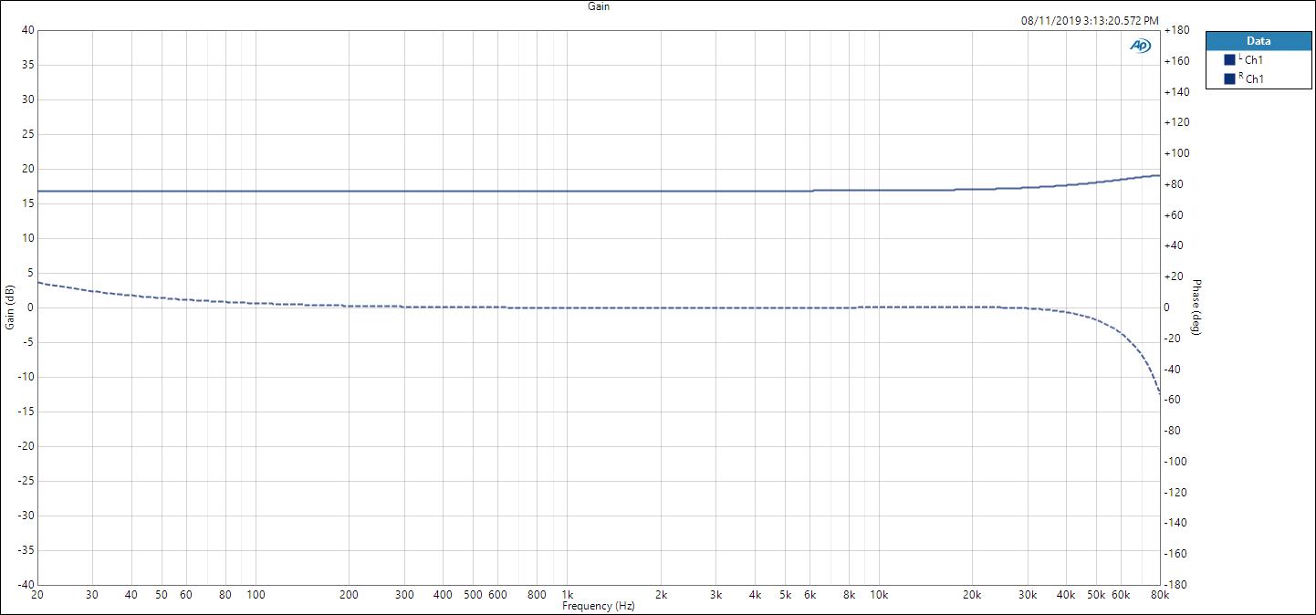

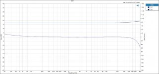

BTW, phase graph?
No phase shift till 30kHz. At low frequencies the phase shift is not there and an artifact of the analyzer's AC coupling.
