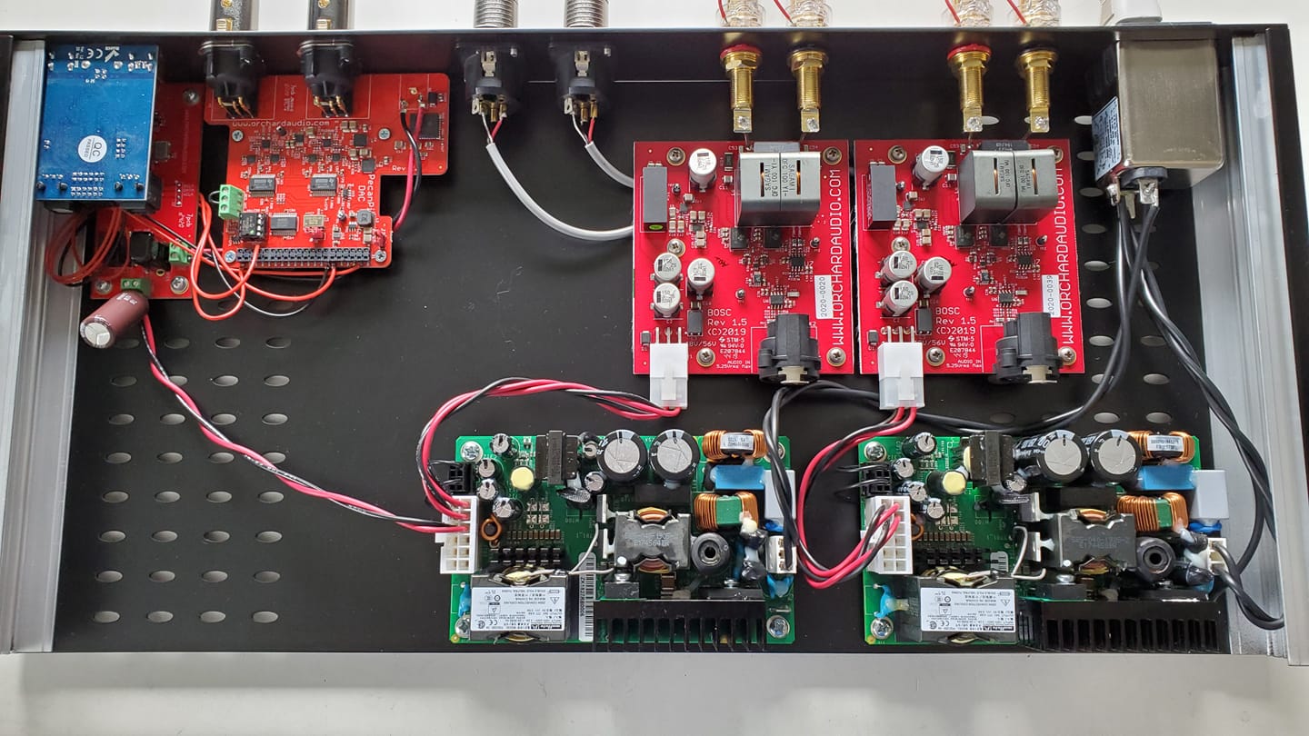

Hi, first post here, just place an order for 2 of these amp modules (these could be in stock soon). I plan on building these as mono blocs but in slightly larger cases. I'm just trying to decide on the power supplies; cui 56v vs murata 54v, both have similar specs. Tending towards cui as that's the one Leo uses plus its plug and play (the murata could be a neater one box solution). Are there any other reasons for choosing one over the other?
First amp/electronics build so I'm on a learning curve, one question I have is regarding stand off height, would 8mm be sufficient?
Yes 8mm is sufficient for standoffs.
The Murata power supplies are the ones I use inside my integrated amp (see picture). Both CUI and Murata deliver the same performance.
