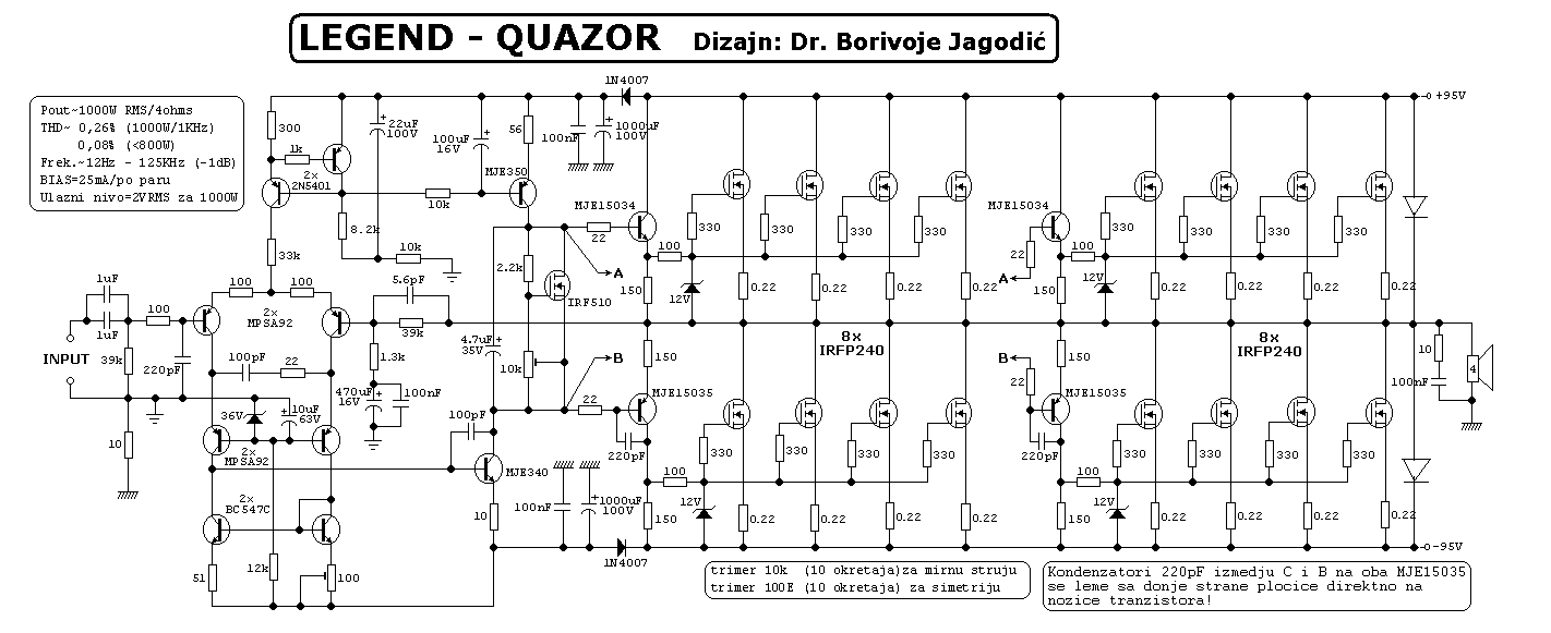

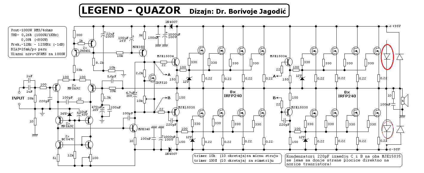

Dear all,
The amplifier is working good now, clear and very strong. I added 2 more pair of cap at PSU total now is 100,000uf per rail. In addition, I installed 6amps 1000 volts diodes at the output to rails in reverse polarity to avoid loading the amp from speaker
what does he mean by this?
Dear all,
He means that the diodes do not pass Power Supply rail current directly to Zero Volts.
Reverse polarity requires the diodes to block current flow.
alex,
Dear all,
Engel,
the diodes are there to protect the collector emitter of the output transistors from back emf of the speakers.....these diodes return the energy back to the psu rails....if those diodes were not there, these back emf have nowhere to go but thru the output trannies....
