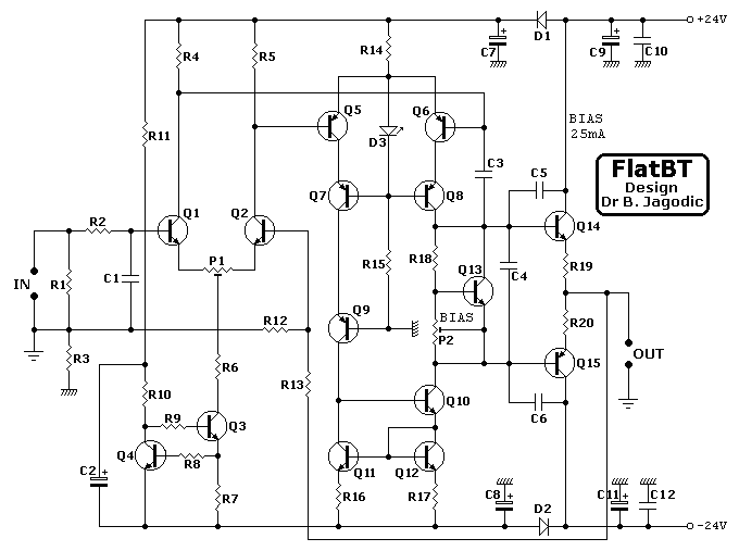

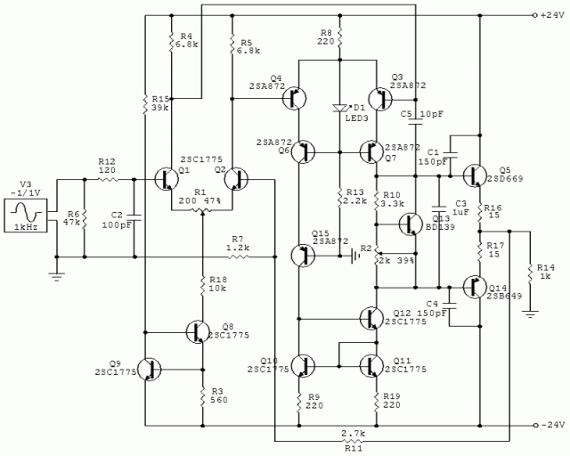

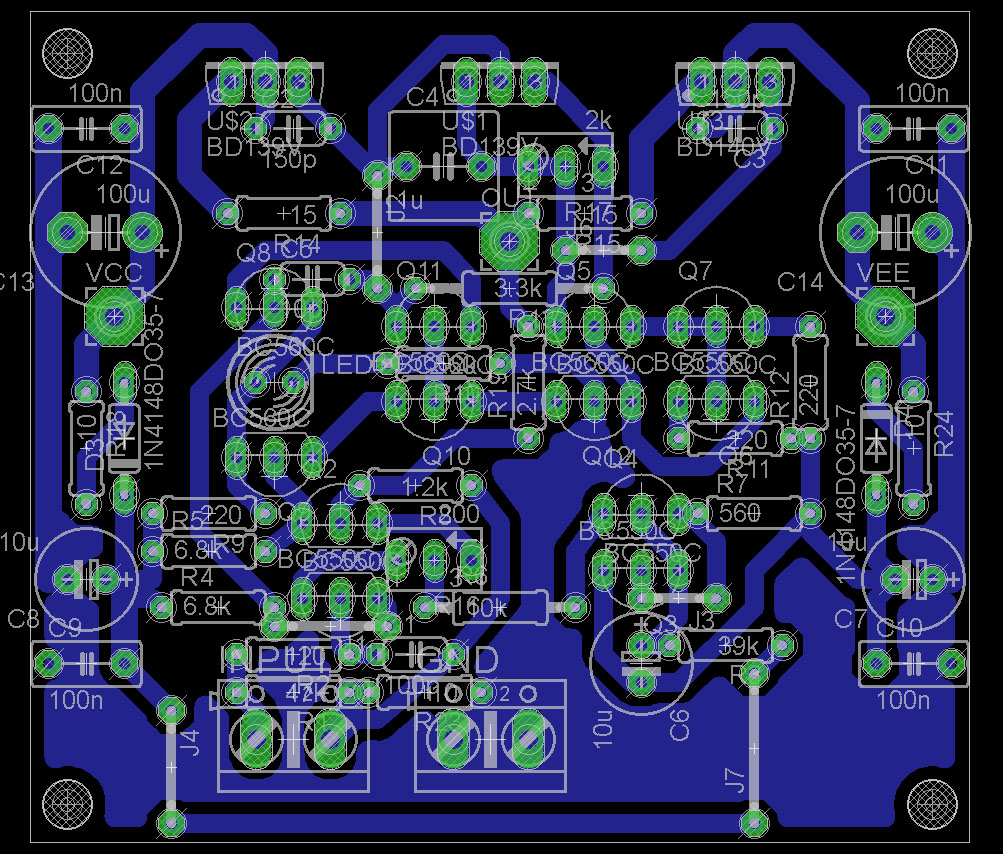

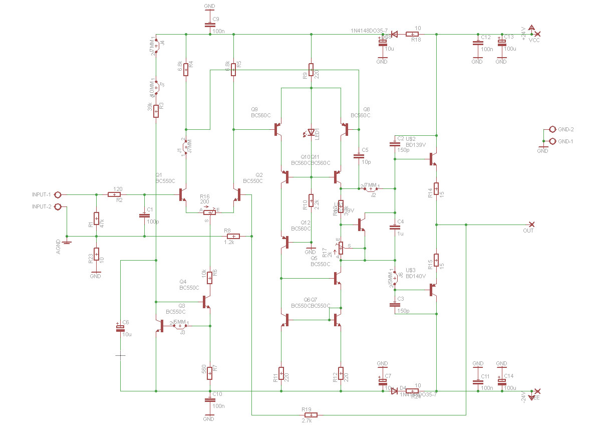

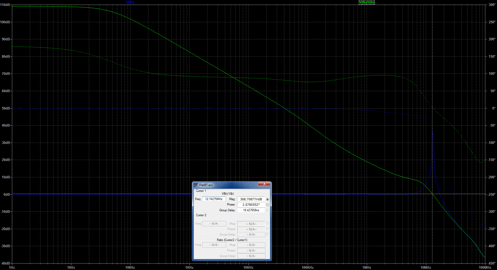

I would like to open some projects by Dr. Bora, among others FlatBT.

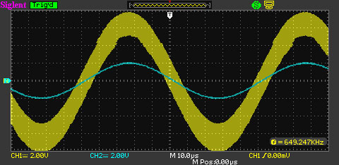

I have already built a live prototype, but on the original as far as the transistors in the entrance as well as Vas( BC550/BC560 instead of 2sa872/2sc1775).
I have oscillations at the output 5.31MHz, adding small capacitors to the base / collector almost does not change anything. So I turned on the simulations, which also shows oscillations, and it's hard for me to do something about it myself.
I will try to place pictures, and simulations.

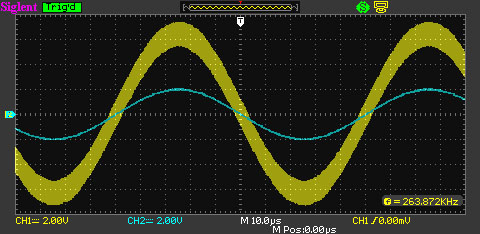

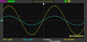

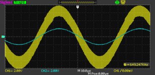

I think i got it.
Without any changes, pic1.
With 220p and 100ohm resistor on front end collector pic2(BC550).
And add 12p on feedback resistor pic3.
If Im wrong correct me.

The feedback resistor R11 is 10 times too big in value.
On your LTSPICE schematic, Q15 has collector/emitter swapped.
For stability I found the circuit is stable with C6 = 33pF, a 10pF capacitor across R17, and a 10R/100nF Zobel on the output. However, I dont like the look of the phase/gain margin and would tweak it further...
