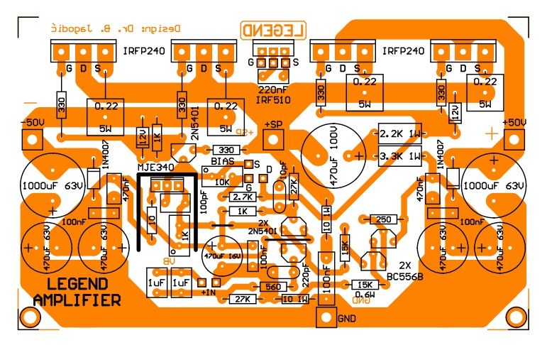

the output devices are mounted on the inside of the L angle aluminium bracket.
It is extremely difficult to ensure a flat face here for the devices to contact for good Thermal Conductance (low Thermal Resistance).
If the PCB and output devices are turned upside down then the devices contact the outside face of the L. This face can be checked and altered to ensure it has a goof flat surface for good heat flow.
A further advantage of using the outside face it that the devices can be mounted much closer to the heatsink. Maybe as much as 8mm closer. That reduces the Thermal Resistance considerably. This helps the output stage to run less hot and more reliably.
After reading this I checked the L aluminium brackets I am using in my amps and, of course, you are right. In a next amp I will follow your advice and mount output devices on the outside face of the L, it looks better but not perfectly flat.

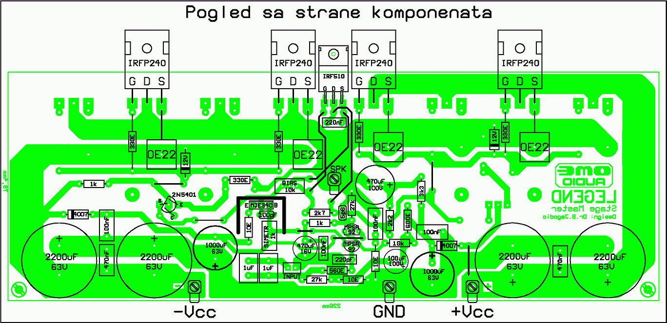

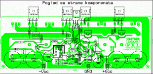

About Legend basic amplifier you post no. #636
Please send me schematic of "Legend raspored", because I see components are different with "Legend basic rev.5 by Dr. Bora".
Dear Victor !
About Legend basic amplifier.
Why "Legend raspored" and "Legend basic rev.5 by Dr.Bora" are different components? (Please see attach files)
Please send me schematic of "Legend raspored".

Dear Victor !
